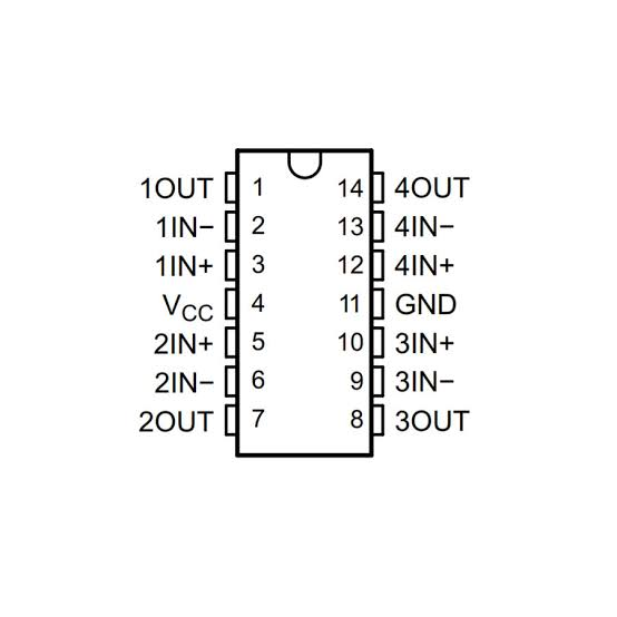

LM324 Pin Layout
The LM324 is a 14-pin quad operational amplifier (Op-Amp) IC that contains four independent op-amps within a single package, making it ideal for a wide range of analog applications such as amplifiers, comparators, filters, oscillators, and sensor circuits. The IC is powered through Pin 4 (VCC) and Pin 11 (GND), while the remaining pins are divided into four identical amplifier sections. The first op-amp uses Pins 1 (Output), 2 (Inverting Input), and 3 (Non-inverting Input), the second uses Pins 5 (Non-inverting Input), 6 (Inverting Input), and 7 (Output), the third uses Pins 8 (Output), 9 (Inverting Input), and 10 (Non-inverting Input), and the fourth uses Pins 12 (Non-inverting Input), 13 (Inverting Input), and 14 (Output). Each operational amplifier functions independently, allowing multiple analog operations to be performed simultaneously within the same IC while operating from a single supply voltage ranging from 3 V to 32 V, making the LM324 a compact, economical, and highly versatile choice for electronic circuit design.

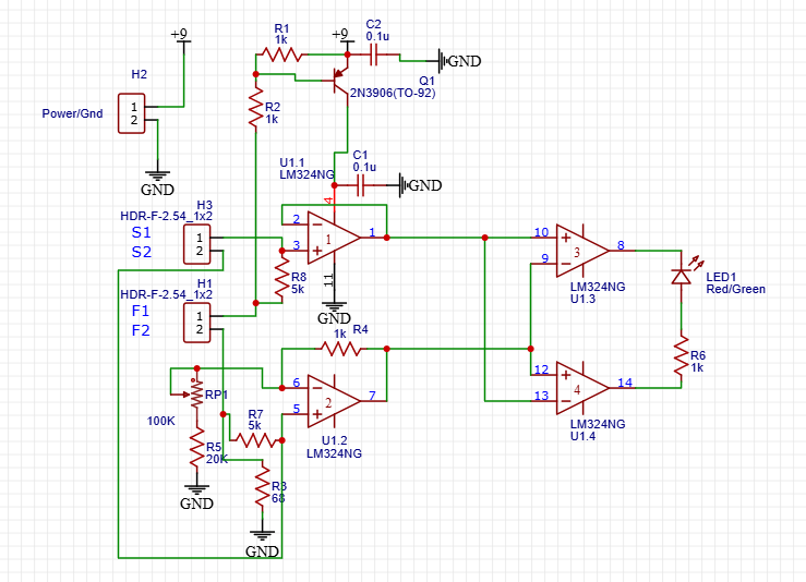

Circuit Working Principle
The LM324-based touch sensor circuit uses the four operational amplifiers inside the LM324 IC to detect the tiny electrical signal produced when a user touches the sensor pad. The circuit is powered from a +9 V supply connected through header H2, while the 2N3906 PNP transistor (Q1), together with R1, R2, C1, and C2, provides a filtered and stable reference voltage for the sensing stage. The touch electrodes are connected through headers H1 (Force lines) and H3 (Sense lines). The first two op-amps (U1.1 and U1.2) amplify the extremely small signal generated by the touch sensor and compare it against an adjustable threshold. Potentiometer RP1 (100 kΩ) allows the sensitivity of the touch sensor to be adjusted, while resistors R7 and R8 provide biasing and enable the circuit to operate with either a two-wire or four-wire touch sensor configuration. The outputs of these stages are then processed by U1.3 and U1.4, which act as comparators to produce a clean digital output that drives the red/green LED (LED1) through resistor R6, indicating when a touch has been detected.
The notes included in the schematic explain the sensor...
