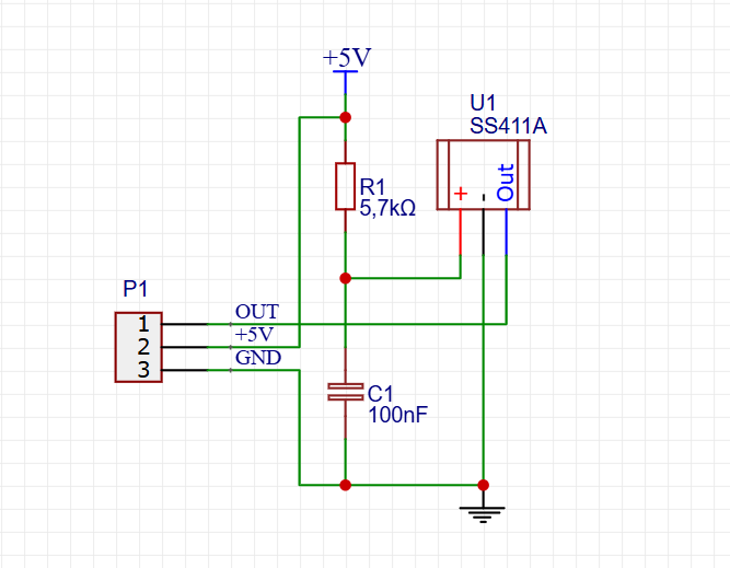

Circuit diagram
The circuit shown is a simple magnetic sensor module built around the SS411A Hall Effect sensor, designed to detect the presence of a magnetic field and provide a digital output. The module operates from a +5 V power supply, which is connected through the P1 header. The three pins of the header provide +5 V, Ground (GND), and the Output (OUT) signal, making it easy to interface the module with a microcontroller such as an Arduino, ESP32, or Raspberry Pi. The SS411A Hall Effect sensor (U1) continuously monitors the surrounding magnetic field. When a magnet of the correct polarity is brought close to the sensor, the internal Hall element detects the magnetic flux and changes the state of the output pin, producing a digital signal that can be used to trigger LEDs, relays, alarms, or other electronic circuits.
To ensure stable and reliable operation, the circuit includes a 5.7 kΩ pull-up resistor (R1) connected between the +5 V supply and the sensor's output....
