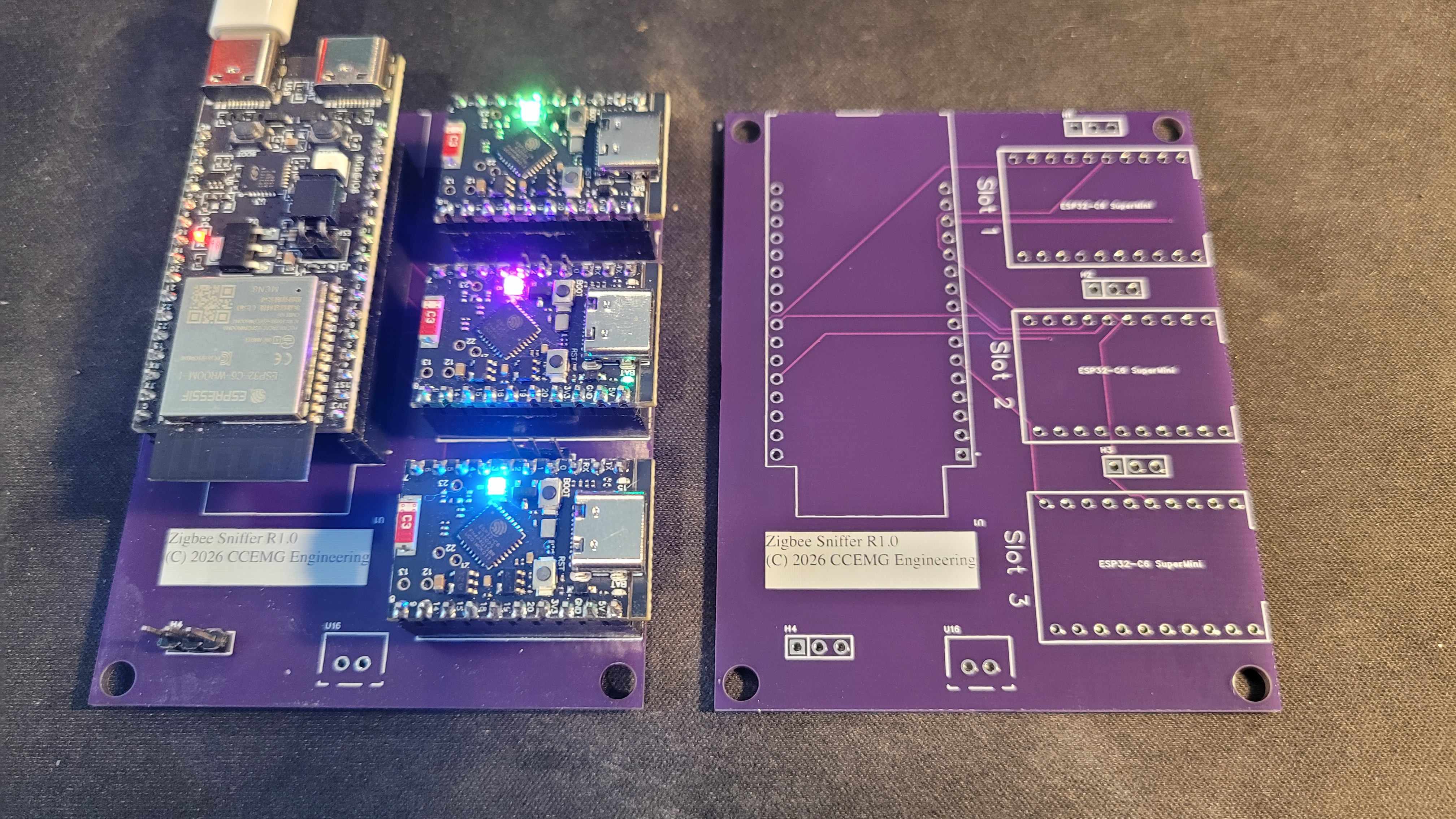

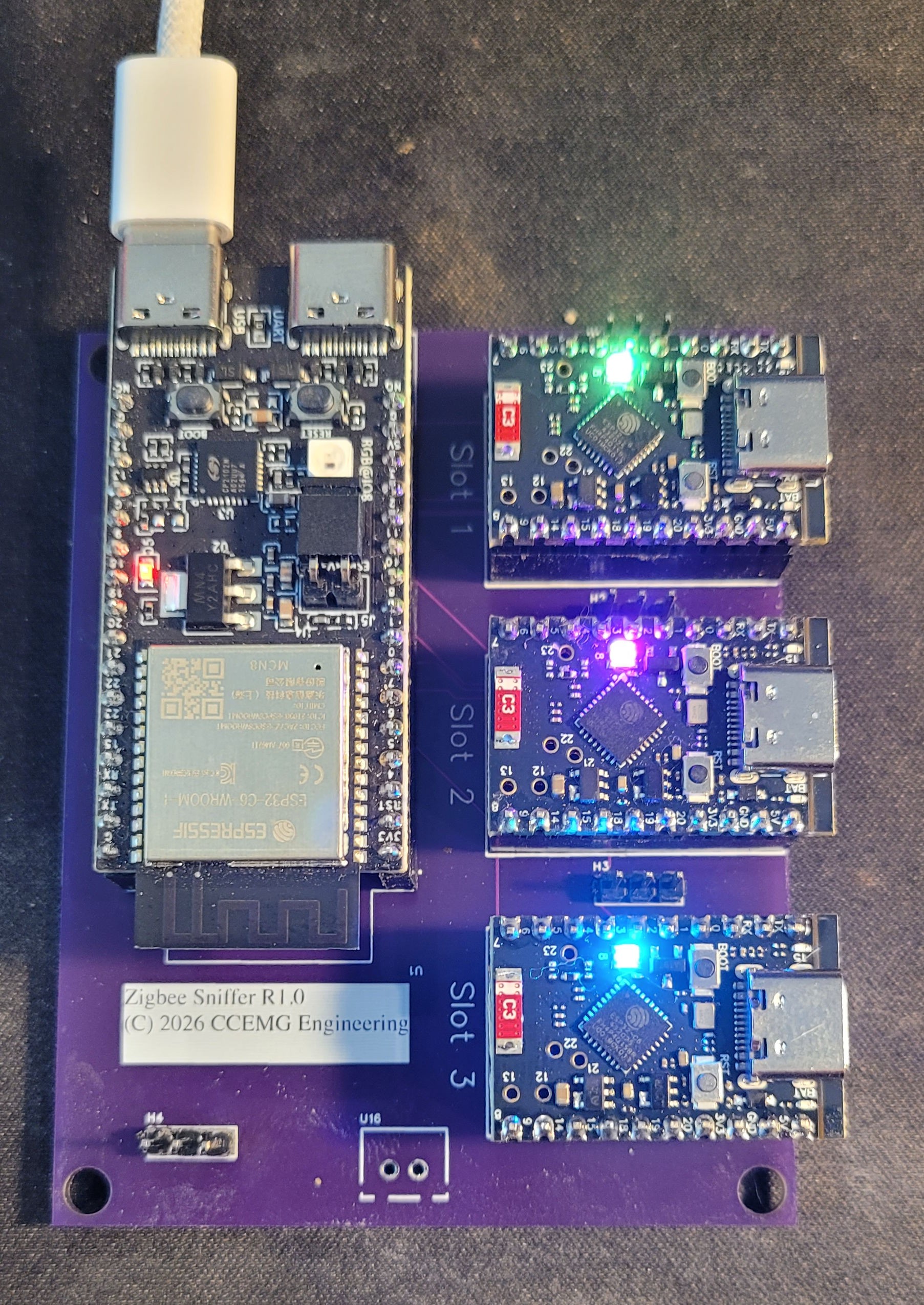

    # The Board Comes Home
    There's a specific kind of nervousness that a schematic review can't fully cure. You can catch a
    mislabeled part number, a missing control line, two satellites wired to each other instead of back
    to the primary, a satellite with no path to power — all of that got found and fixed pin-by-pin
    against the firmware's actual GPIO definitions before this board ever went to a fab (the full
    story is in [project-story.md] (project-story.md#from-schematic-to-silicon-verifying-the-carrier-board)).
    None of that tells you whether the *physical* board will do what the verified one on paper says it
    will. Today it came back from the fab, and it does.
    Purple soldermask, "Zigbee Sniffer R1.0 (C) 2026 CCEMG Engineering" silkscreened right onto the board — CCEMG Engineering being the actual contract-engineering work I do when I'm not chasing Zigbee dropouts, so the silkscreen isn't a joke, just a company mark showing up on a personal project for once instead of a client's. Primary on the left with its two USB-C ports, three ESP32-C6 SuperMinis socketed into Slot 1, Slot 2, and Slot 3 on the right, each one lighting its own status LED a different color the instant power came up — green, magenta, blue — with no reflow rework, no bodge
    wires, no "well it mostly works." Power came up clean, all three satellites enumerated, and frames
    started flowing on the very first try.
    The second shot is the one that actually matters more than the pretty one: a bare, unpopulated
    board sitting next to the populated one, silkscreen outlines for all three `ESP32-C6 SuperMini`
    footprints, header pads, and the shared SPI/SYNC bus traces visible and exactly where the netlist
    said they'd be. That's the payoff for every one of those schematic-review catches — the board
    that came back isn't just *a* board, it's *the* board that was checked.
    ## The one thing that wasn't quite right
    Bring-up did turn up one real surprise: satellite **slot 1** and **slot 2** had their CS/DATA_READY
    selector lines physically reversed relative to the verified design — the socket silkscreened
    "Slot 1" was actually wired to what firmware expected to be slot 2's lines, and vice versa. Slot 3
    was untouched. Everything still worked; it just meant the board's own labels and the firmware's
    `radio_id` assignment disagreed about which physical socket was which.
    There were two ways to handle that: respin the board, or make the firmware agree with the board
    that's actually sitting on the desk. A respin for a two-pin swap felt like the wrong instinct —
    so firmware and docs now treat the as-built wiring as correct going forward. `radio_id` 1 and 2 map
    to the physically-reversed lines on purpose, the pinout table and netlist reference note the swap
    explicitly, and nobody has to remember it's "backwards" because as of now it isn't. One reversed
    pair out of every net on the board, caught in the first ten minutes of bring-up instead of after
    weeks of confusing debug sessions — that's a good trade for a two-line firmware change.

    ## A schematic almost went to fab wrong
    The carrier board design has existed on paper for a while — netlist, pinout table, the works — but
    a document isn't hardware, and the real test arrived this week in the form of an actual PADS
    schematic export to review before it goes anywhere near a fab house.
    Good thing it got a second look. One satellite's module was tagged under a part number for a chip
    with no 802.15.4 radio at all — an easy mix-up buried in a component library, and exactly the kind
    of thing that's invisible until a board comes back and one radio just doesn't work. A third
    satellite was missing one of its two required control lines back to the primary entirely — present
    on paper, absent from the actual net. Two satellites had gotten wired directly to each other instead
    of each going back to the primary the way they're supposed to. One satellite had no path to power
    at all. Every one of those got caught, fixed, and then re-verified pin-by-pin against the actual
    firmware GPIO definitions, using the real schematic symbol's pin diagram rather than guessing from
    a generic reference. In the process, a leftover reference file in the repo turned out to still
    document an *old* pin assignment the firmware had quietly moved away from months ago for good
    reason — fixed that too, so it can't mislead the next pass.
    None of those were exotic bugs. They...

    ## Satellites, not separate tools
    The design that makes sense: keep one primary C6 as the "brain" of the setup — the one talking USB
    to the host — and let up to three additional C6 boards act as satellites, each free to sit on its
    own channel, each relayed back through the primary over a shared SPI bus instead of needing their
    own USB connection. One host, one dashboard, one coherent view — it just happens to be assembled
    from up to four radios instead of one.
    That means an actual SPI relay layer: the primary as SPI master, each satellite as an SPI slave,
    a wire protocol for commands going out and captured frames coming back, in both directions, without
    either side blocking the other. And because this now has to be real hardware, not just firmware —
    a carrier board: one PCB to host a primary and up to three satellites with clean shared power and a
    defined pinout, instead of a nest of loose jumper wires that falls apart if you look at it wrong.

    The carrier board design is drawn up, the pin assignments are set, and the firmware side — the SPI
    relay, the per-satellite command routing — compiles and runs against real hardware on a bench. Next
    is actually getting a satellite to take a firmware update over that link instead of needing to be
    plugged into USB by hand every time something changes.
