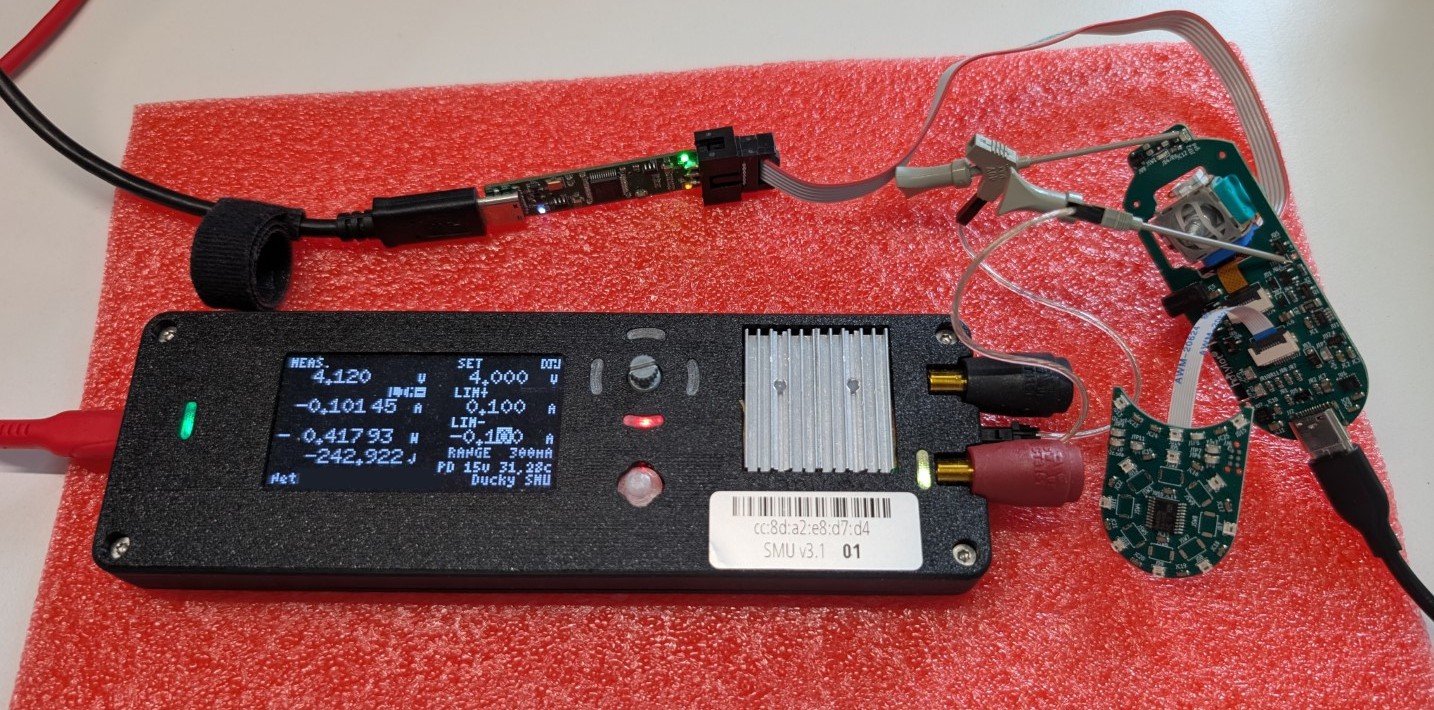

Here is the bring-up of the latest device, a three-board assembly (two rigid, one FPC) of a BLE joystick / air-mouse device.
Actually, ALL the boards in the photo, including the power supply (a 2-quadrant source-measure unit), SWD probe, were designed in this HDL!
