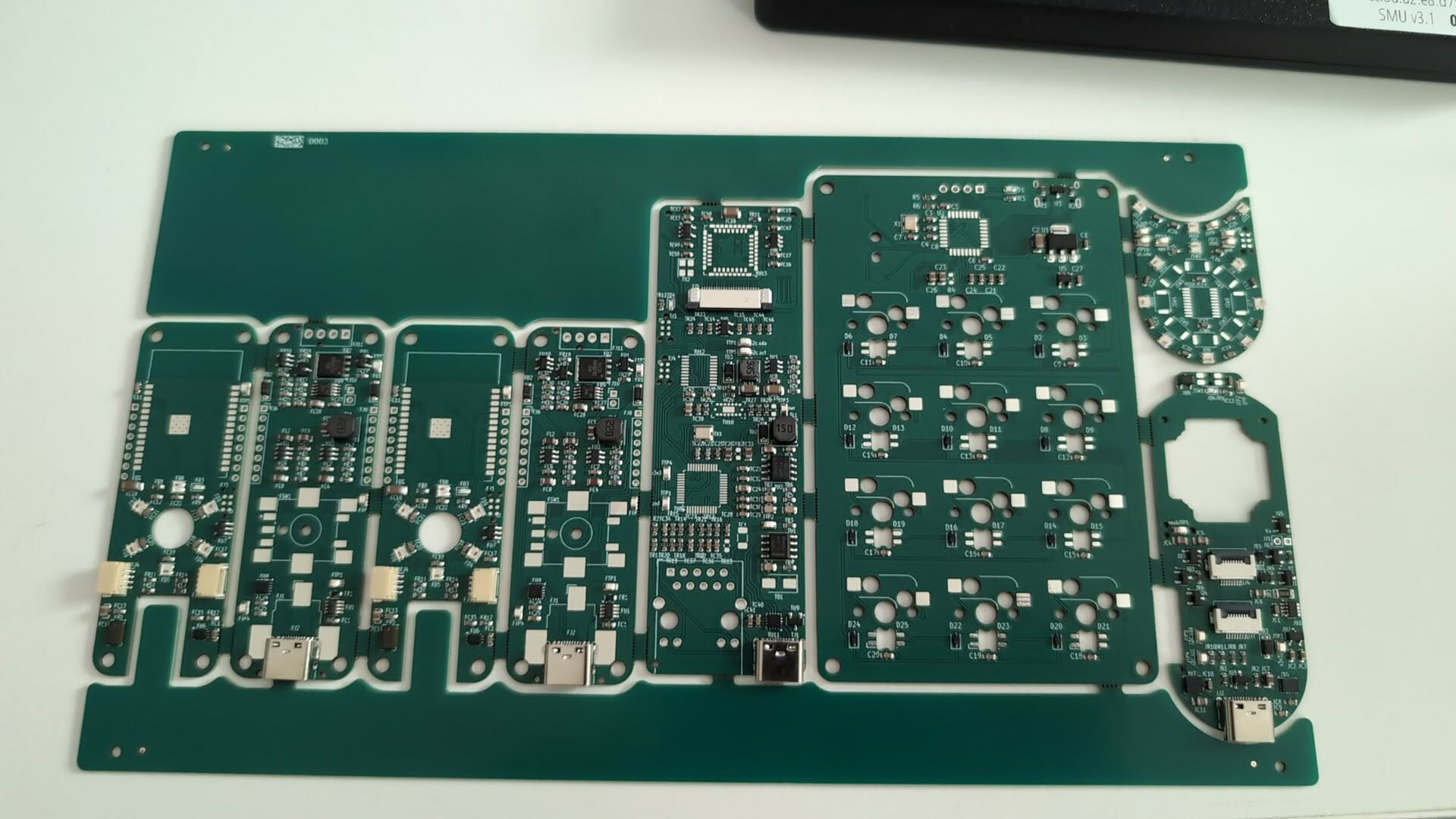

Here is the bring-up of the latest device, a three-board assembly (two rigid, one FPC) of a BLE joystick / air-mouse device.
Actually, ALL the boards in the photo, including the power supply (a 2-quadrant source-measure unit), SWD probe, were designed in this HDL!

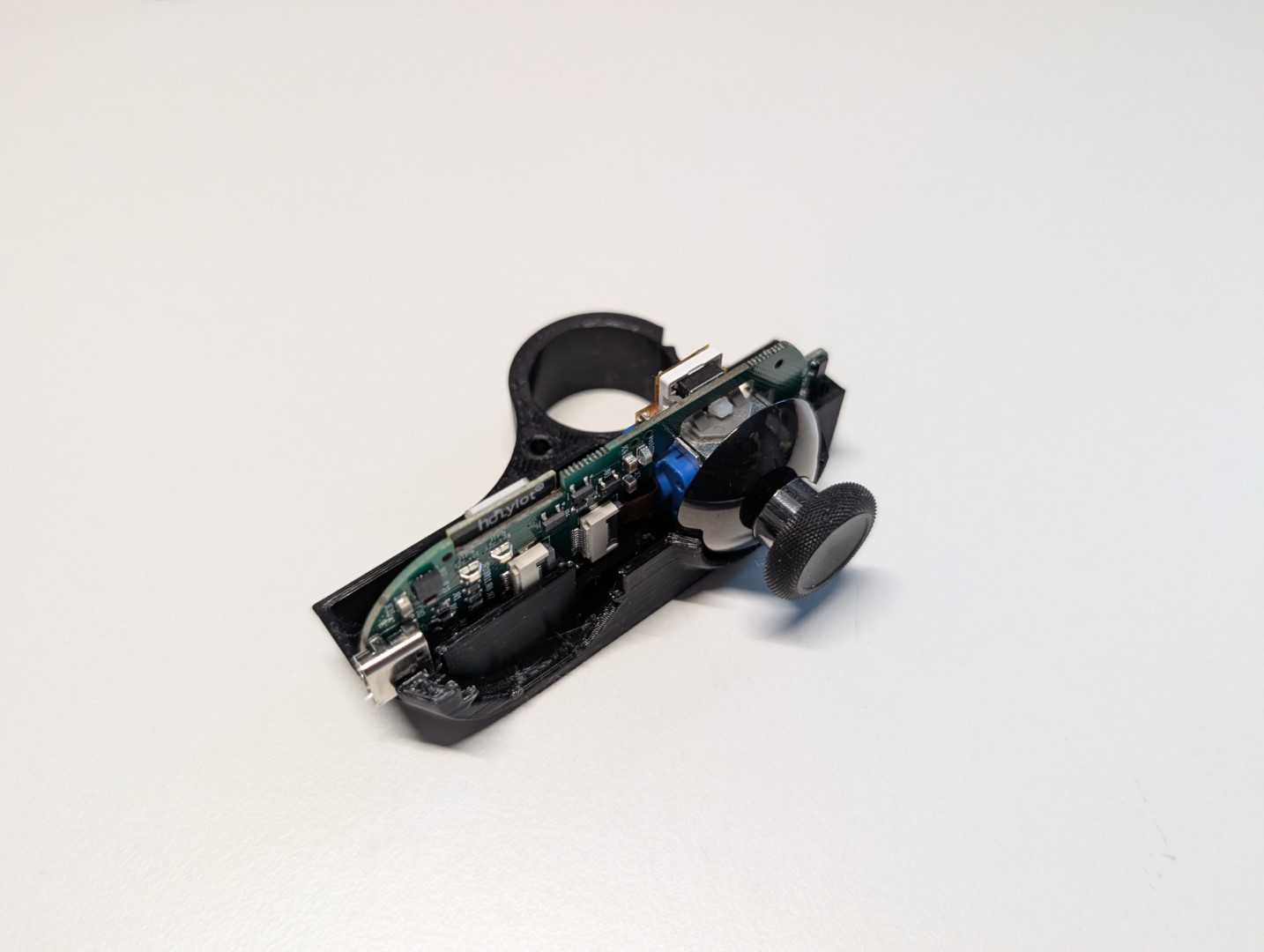

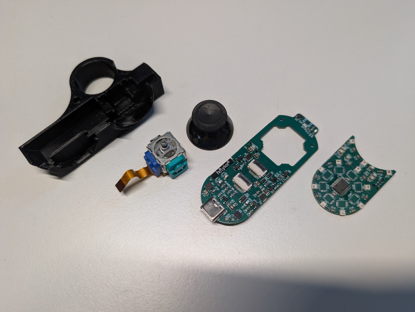

    One of the more complex projects on the mega-panel is the BLE joystick, an battery-powered BLE device with an Xbox joystick and IMU for air mouse capabilities. The idea is a configurable remote controller, such as a presentation remote or generalized gamepad but for general mouse uses.
    This device has a nRF52840 main and a CH32V003 coprocessor as the buttons board. The coprocessor allows the inter-board connection to be simple (single 8-pin FPC) by aggregating multiple IOs (including ws2812-style smartleds) over a common I2C bus. The coprocessor is also, kind of surprisingly, cheaper than a fixed-purpose I2C IO expander. Though draws way more sleep current.
    The sub-boards and managed connector pairs feature of the HDL allowed the FPCs to be correct-by-construction, and the multi-board assembly worked the first time around. This includes a custom FPC for the XBox joystick itself (so it can sit lower than the PCBs, allowing vertical space for the battery) as well as the FFC to connect the buttons sub-board. Yay!
    This board was an iteration from a prior version that used a ESP32-C3 on a single board, but ESP32 on Rust lacks advanced power management which makes it impractical for a battery device. The first revision was also mechanically more simplistic, as one rigid board with the joystick directly mounted, which is poor use of vertical space for a handheld device. Porting the firmware to this version was a bit of work, but because of vendor-neutral Rust embedded HALs, most of the existing code could be directly re-used.
    The coprocessor code had to be written from scratch, and while there isn't a standard embedded-hal I2C target API, there is an I2C target HAL for the CH32 series, which works fine.

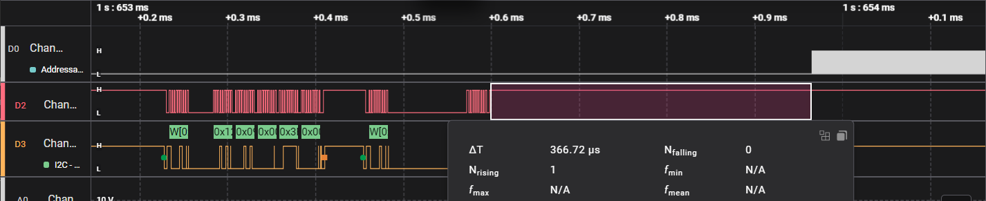

    However, the CH32V003 SPI module, used to generate the smartled signals is ... finicky. The existing smartleds crates make a lot of assumptions, for example that the processor is fast enough to keep the SPI module fed without inter-byte delays, or that there is no glitching before the first byte. Smartleds crates also typically generate the waveforms by using 4 SPI bits per smartled bit, either 1000 or 1110. This technically violates the ws2812 timing spec (not enough low time during a high bit) at some timing configurations. The combination of these cause quite a bit of glitching on each smartleds transaction. So I built a custom smartleds SPI driver with configurable patterns: https://github.com/ducky64/smartleds-spi-lut. This seems to work robustly on the CH32V003 and is as optimized as far as reasonable with standard Rust code.
    All the processing does take some time, about 366us from the end of the I2C transaction to when the first smartleds bit gets shifted out. But it works!
    Next step is to get the accelerometer working for air mouse functionality. But before that, it needs a USB bootloader, since the case and battery obscure the debugging ports. The yak shaving continues.
    Firmware and mechanical (FreeCAD) sources are here: https://github.com/ducky64/blejoystick-rs

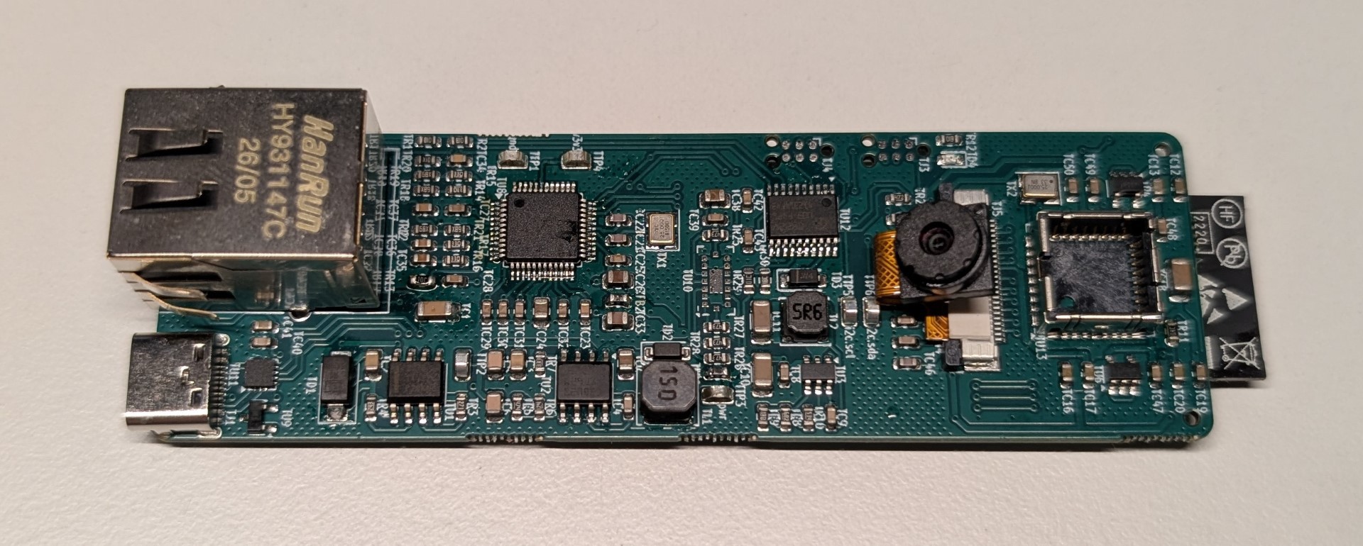

    This monster panel came back a few weeks ago and is a test of several new HDL features, notably sub-boards support and the Ethernet port / link types. It's been slow work bringing these boards up.
    One of the more complex designs is this Ethernet + PoE thermal / RGB camera. It has a ESP32-S3 on the back, and the FLIR Lepton and RGB camera blocks have been tested before, so the main new blocks are the W5500 SPI MAC/PHY, and non-isolated PoE interface.
    Bringing this up was surprisingly straightforward, since wired Ethernet is just a ESPHome config away. It even does the RGB camera too, with an interface to Home Assistant! Sadly, no Lepton support in ESPHome, maybe a future project will try to get that properly integrated.
    The camera works, though its low(ish) light performance is not great. Plush duck says quack.

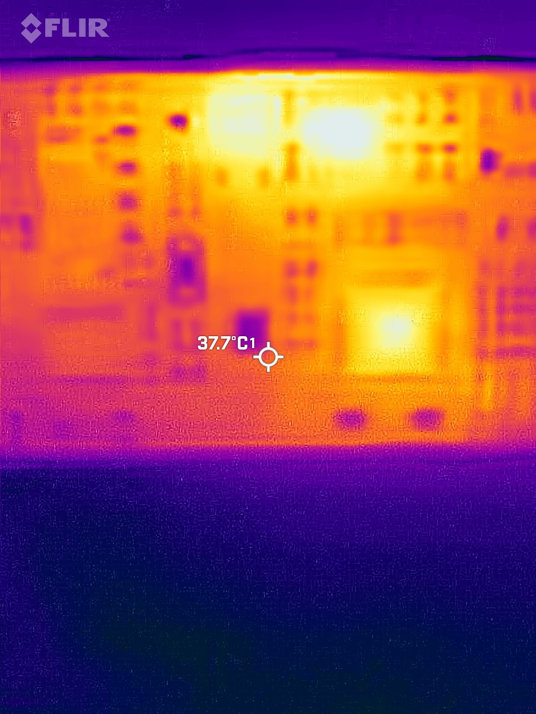

    PoE just worked once firmware was loaded, the device draws enough power with ESPHome and the camera running to keep the PoE source active. That being said, the 48v PoE -> 5v converter probably isn't too happy with the 10% buck ratio and gets a bit toasty. About 50C on the buck IC and inductor, not dangerous but would probably be nice to have a heatsink in sustained use. Such is the drawback of a simple converter without step-down provided by a transformer, but isolated topologies (typically flyback for this application) were more complexity than I wanted for this panel.
    In any case, with the blocks tested in hardware, the Ethernet ports and links, W5500, and TPS2378 blocks are now mainlined and on pypi as edg 0.5.2.
