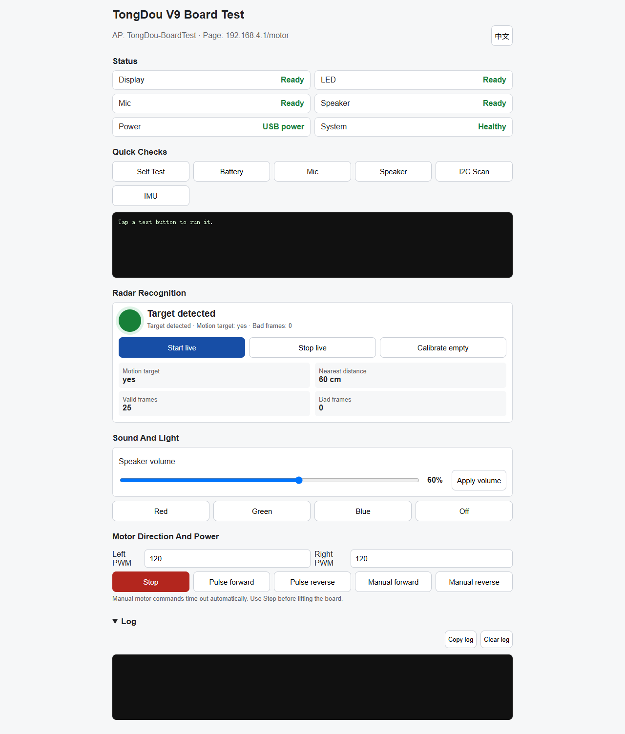

    I’ve just published the TongDou V9 Hardware Test Firmware v1.0.
    This is not a cleaned-up demo firmware written for GitHub afterward. It is the same engineering firmware I actually use on my workbench while bringing up, diagnosing, calibrating, repairing, and debugging TongDou V9 hardware.
    TongDou V9 hardware diagnostics page running directly on the ESP32-S3 at 192.168.4.1.
    The firmware grew together with the hardware, so it still contains traces of the real development process: experimental commands, calibration tools, low-level diagnostics, and a few things that were written simply because I needed to find out why something was not working.
    I decided not to clean all of that away before publishing it.
    If you are a developer looking through the source, you can see much more clearly what I actually tested and how I worked through the V9 hardware.
    It includes things such as:
    • OLED and addressable LED testing
    • microphone recording and audio loopback
    • speaker diagnostics
    • battery and power diagnostics
    • QMI8658A IMU testing
    • capacitive Logo touch testing
    • LD2412 presence radar diagnostics and engineering tools
    • individual motor testing and driver diagnostics
    • motor direction, calibration and saved configuration
    • gyroscope-assisted straight-line experiments
    • shipping discharge testing
    • low-level LED data-pin debugging
    • other small workbench tools that accumulated while building V9
    There are even a few experiments that are not strictly “hardware tests,” such as gyro-assisted movement and a small Logo-triggered movement experiment. I kept them because they are part of the actual development history.

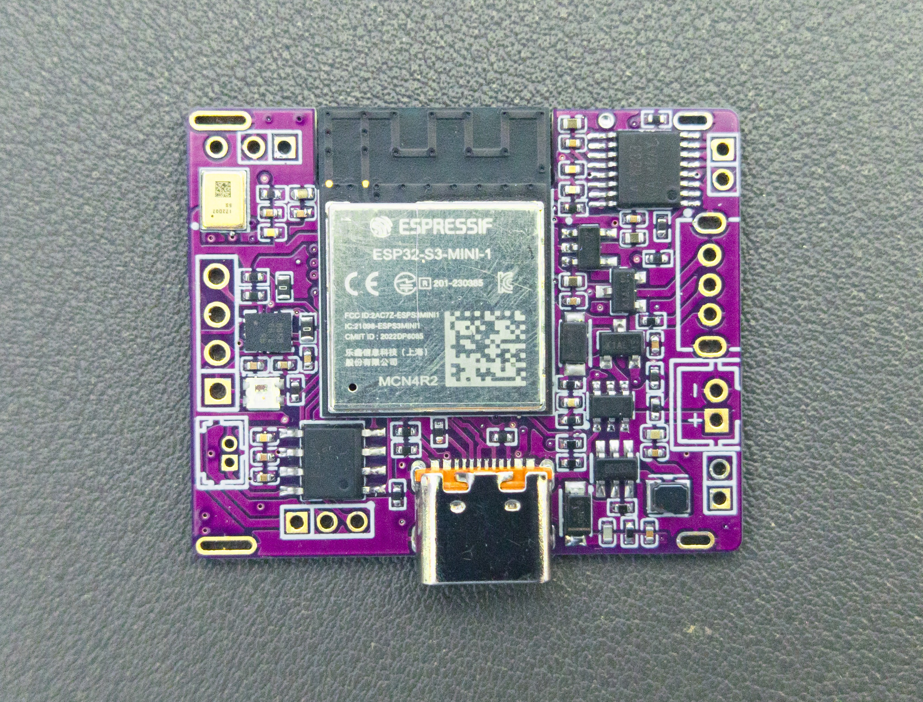

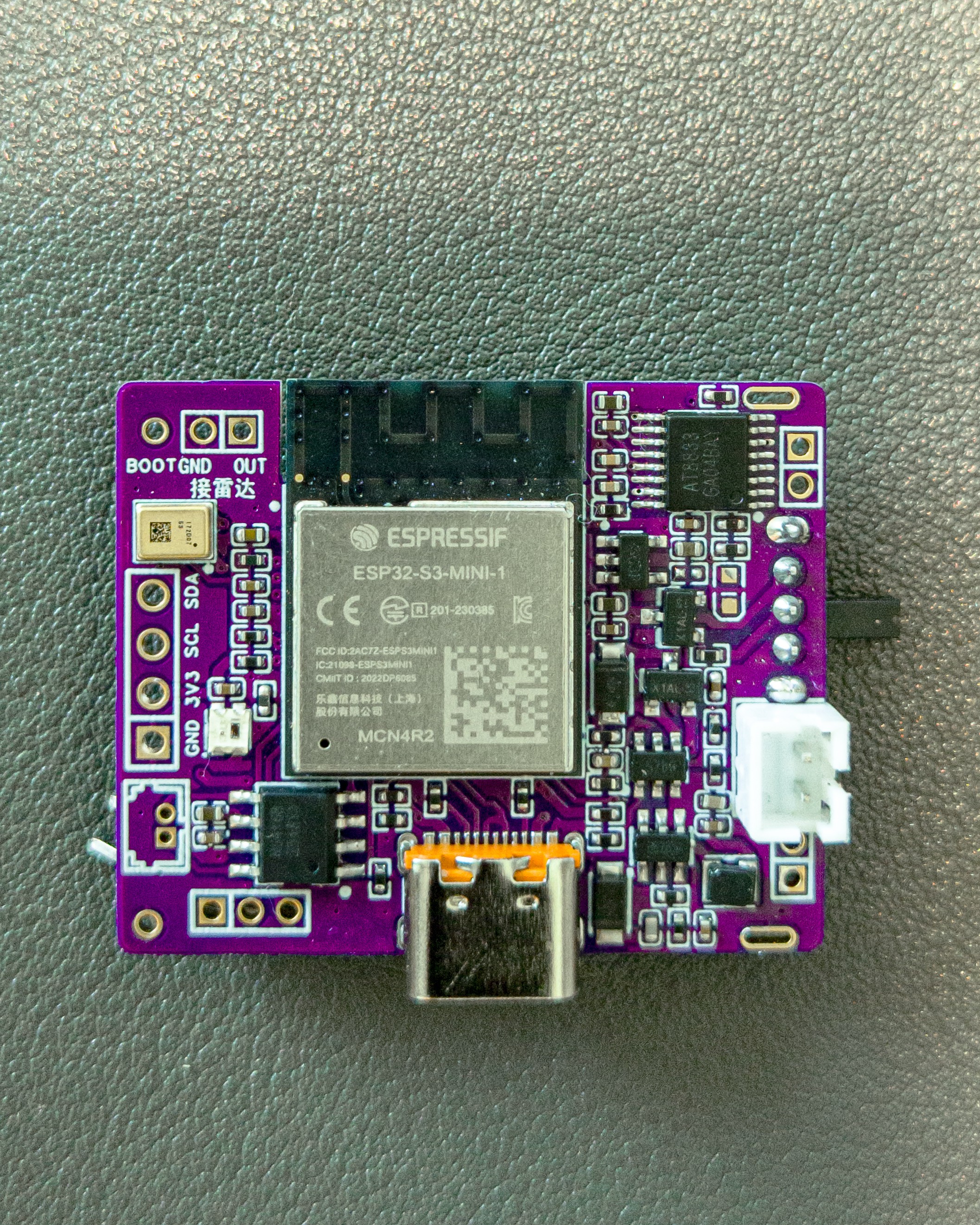

    TongDou has moved from the V8 prototype board to V9.
    TongDou V8 prototype PCB
    TongDou V9 prototype PCB
    This is not just a layout cleanup. V9 adds two new ways for the little machine to understand its own body and interact with people:
    - a capacitive touch input built into the gold TongDou logo
    - a QMI8658A 6-axis accelerometer and gyroscope
    The logo is now more than decoration. A tap or hold can be used as a physical input without adding another mechanical button.
    The IMU is mounted directly on the PCB. TongDou uses two small geared motors without wheel encoders, so wheel alignment, friction, motor differences, and the surface under him can all affect how he moves. The IMU gives me a way to measure the motion of the body itself.

    TongDou V9 browser-based hardware diagnostic page
    The radar diagnostics were tested on a real V9 board:
    - empty scene: 25/25 frames reported no target
    - hand wave: 25/25 frames reported a target
    - 23 frames correctly identified a moving target
    - nearest distance was about 60 cm, matching the test setup
    - bad serial frames: 0
    If the radar module is replaced or its mounting direction changes, the empty-scene background calibration should be run again.
    The public test package is here:
    https://github.com/solitary-dev-50/tongdou/tree/main/hardware_test_firmware
    This is hardware bring-up and diagnostic firmware, not the complete TongDou application firmware. The PCB source files, mechanical files, character behaviors, audio assets, and complete production firmware are still being prepared for a later phased release.
    For now, V9 is assembled, the new sensors are responding, the radar diagnostics are working, and the hardware test tools are public.
  • First wake-up prototype
    solitary dev • 07/20/2026 at 05:35 • 0 comments
    This is the first public TongDou prototype.
    The current build uses an ESP32-S3, brass frame, custom PCB, OLED eyes, audio output, LEDs, two geared wheels, sensors, and an AI-connected personality layer.
    The first demo scene synchronizes prerecorded voice, OLED expressions, lights, and wheel gestures to the same audio timeline.
    Next step: improving the “confused accountant” scene and documenting more of the hardware and firmware.
