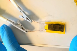

On the other side I needed something fast enough to follow a 5 MHz signal. A solar panel is way too slow, so I used a BPW34 photodiode, and I run it in reverse bias to make it even faster. The photodiode only makes a tiny current, so I turn that into a real voltage with an op-amp wired as a transimpedance amplifier.
I used an LM318N op-amp because it's fast — normal audio op-amps are too slow and smear the picture. The important parts are in the feedback: a 2.2k resistor sets how big the output is, and a small 8.2pF capacitor stops the amplifier from ringing. The whole thing runs off two 9V batteries so the signal can swing both above and below zero.
