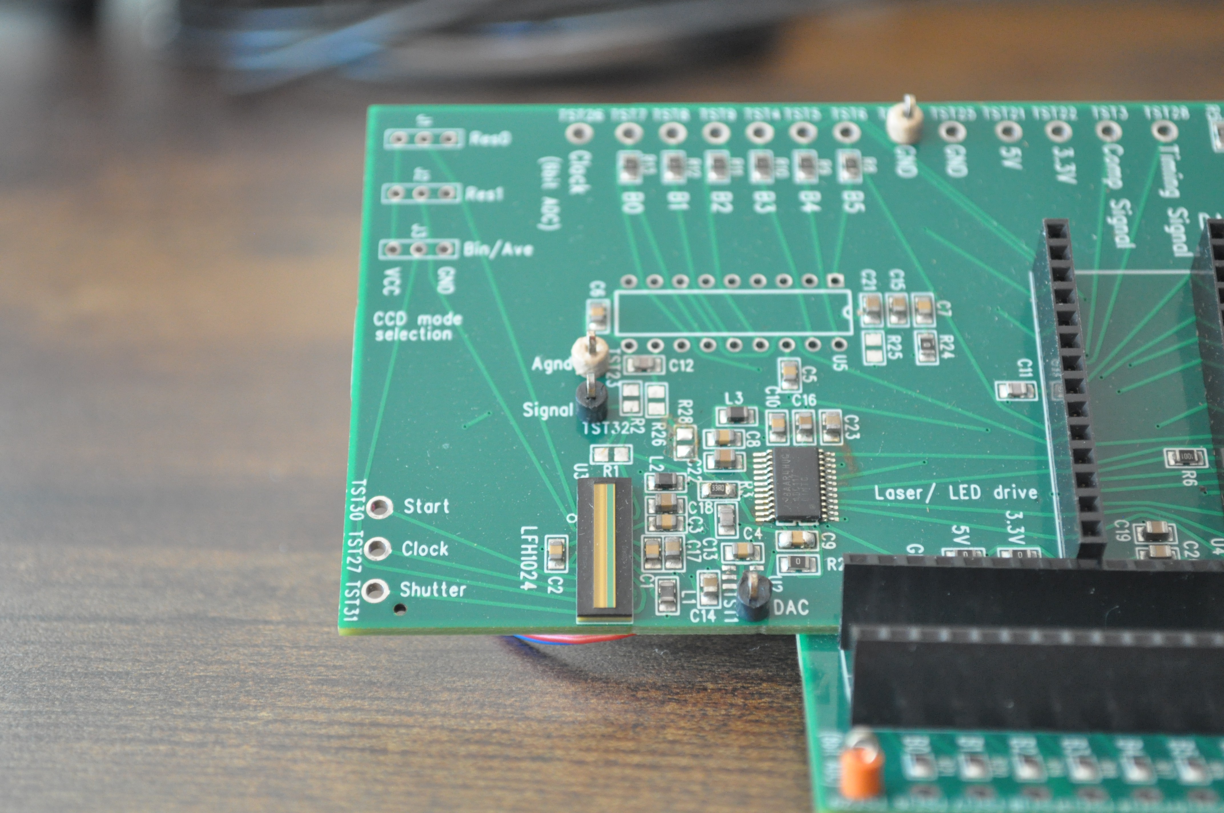

The LFH1024's pixels are 12.7 µm wide and 600 µm tall, a 50:1 aspect ratio. This allows enough light gathering that a lens-less slot aperture works at full speed. It also supports a 5 MHz pixel clock, which works out to about 4,800 full-resolution scans per second, or around 18,000 using the sensor's on-chip binning. It costs $20–35 and comes in a ceramic BGA coarse enough to hand-solder.

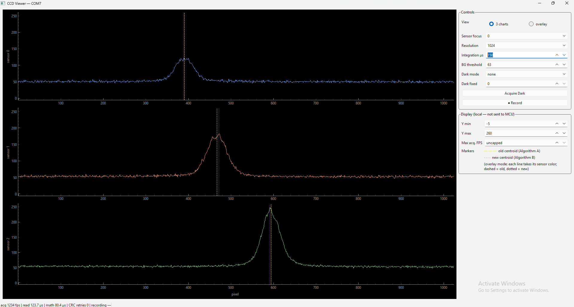

Each scan is a row of 8-bit samples with a bump in it somewhere. The pipeline: subtract a dark frame, find the peak, then take an intensity-weighted center of gravity over the half-max window.

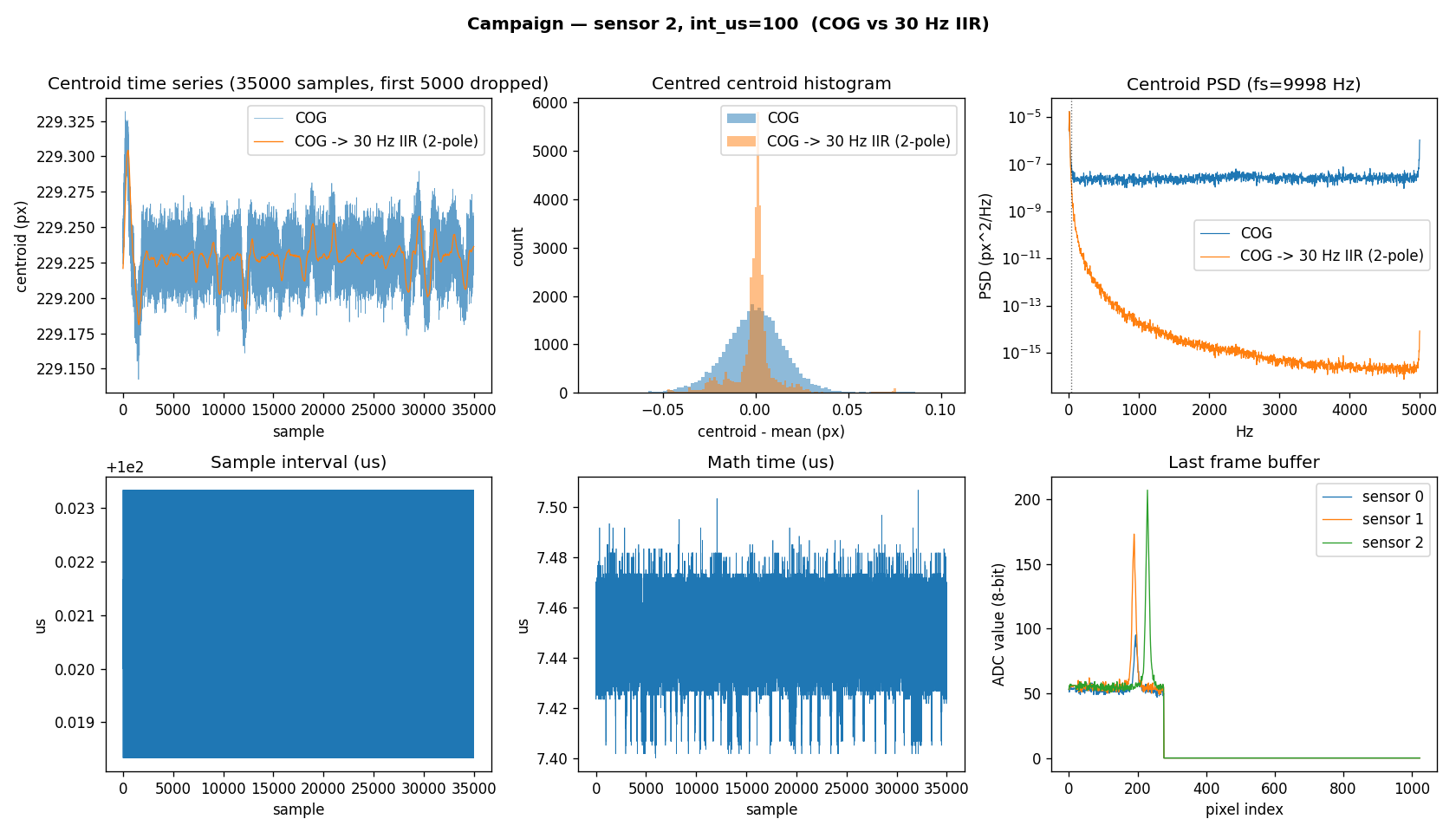

The noise figures come from 40,000-scan campaigns on real hardware.
Sensor Noise Measurement
One 40,000-scan campaign: centroid time series, noise histogram, spectrum, and the raw spot.

Host link: USB serial, with a live viewer (PySide6) and NPZ recorder

There's a PC-side Python program included in the repo for viewing the raw sensor data and collecting runs.

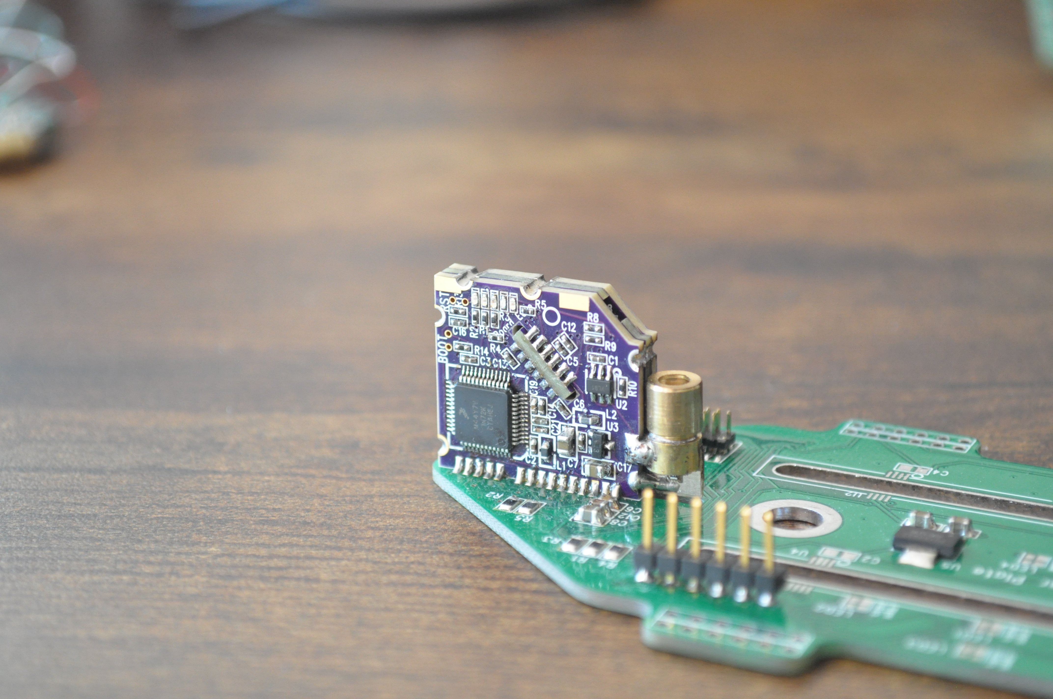

LFH1024 ceramic CMOS linear imager shown without laser diode or mechanical assembly

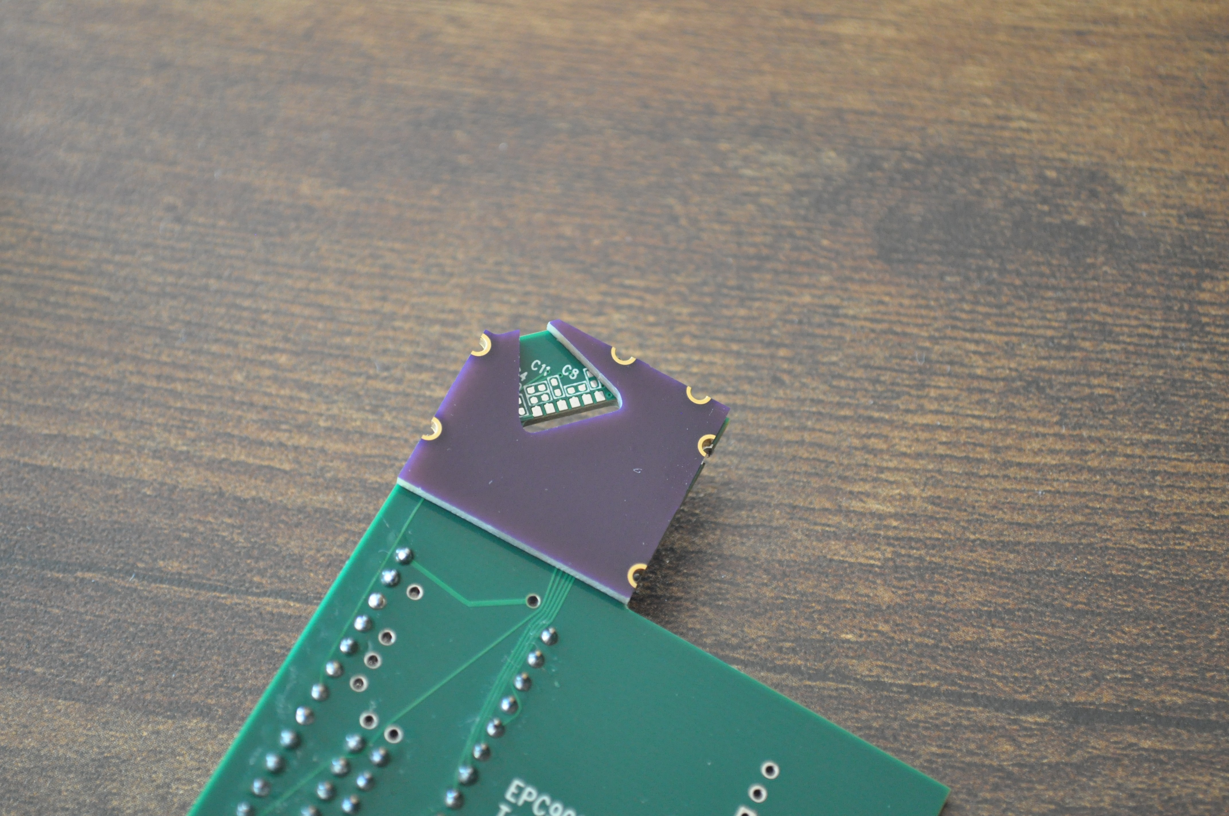

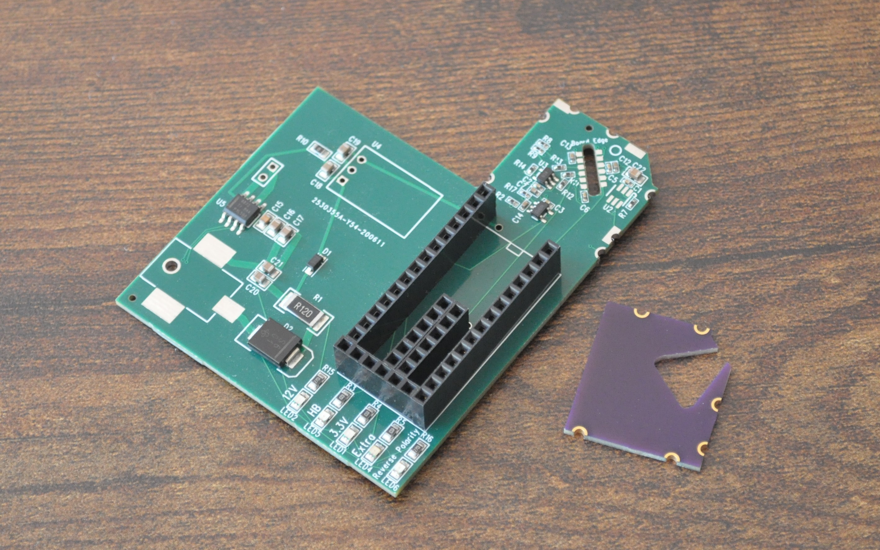

Optical cavity PCB shown
Optical cavity PCB assembly shown

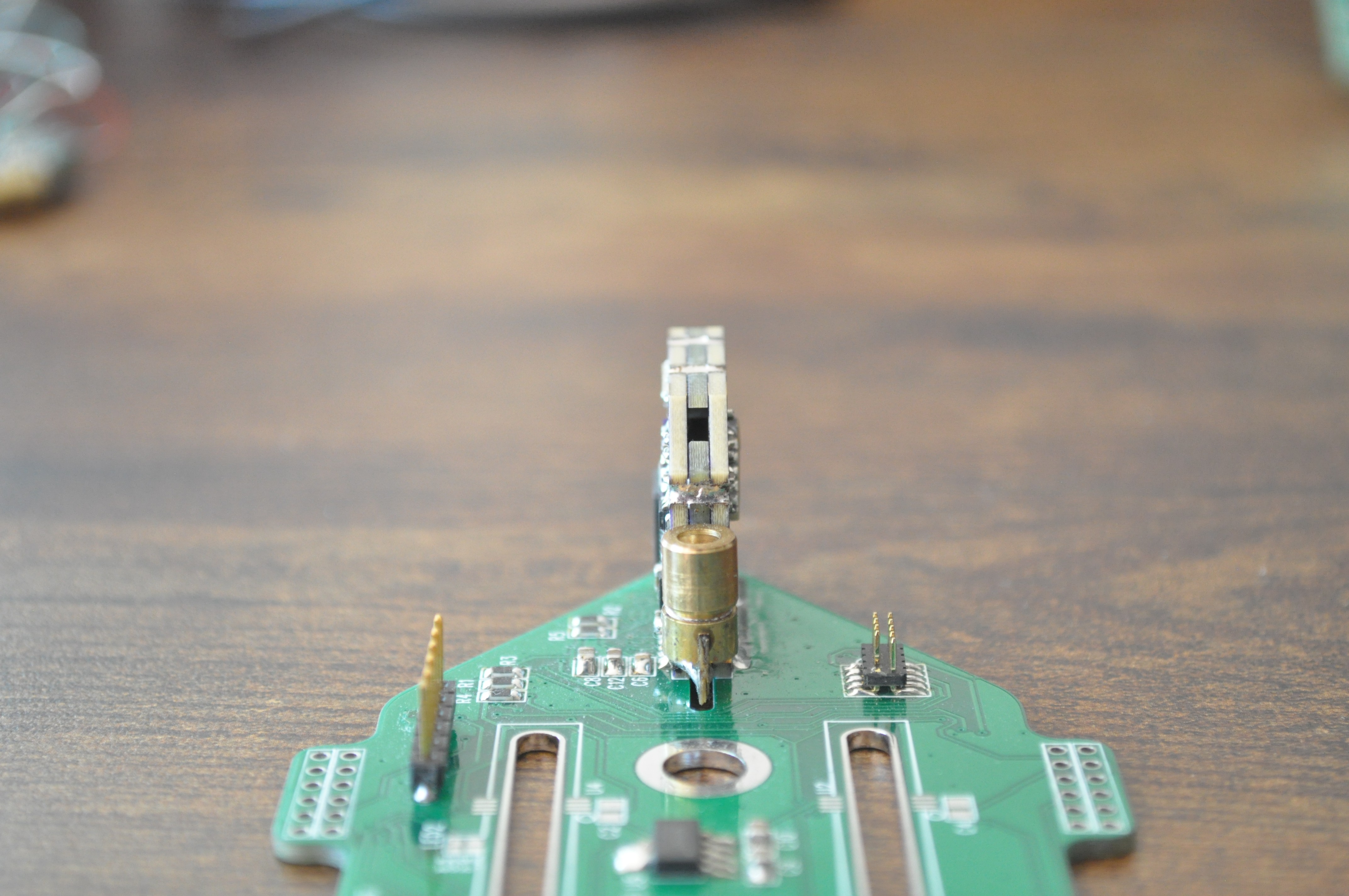

Fourth prototype with EPC901 sensor and Kinetis microcontroller
Fourth prototype viewed edge on, showing optical cavity opening (no slot lens shown)
