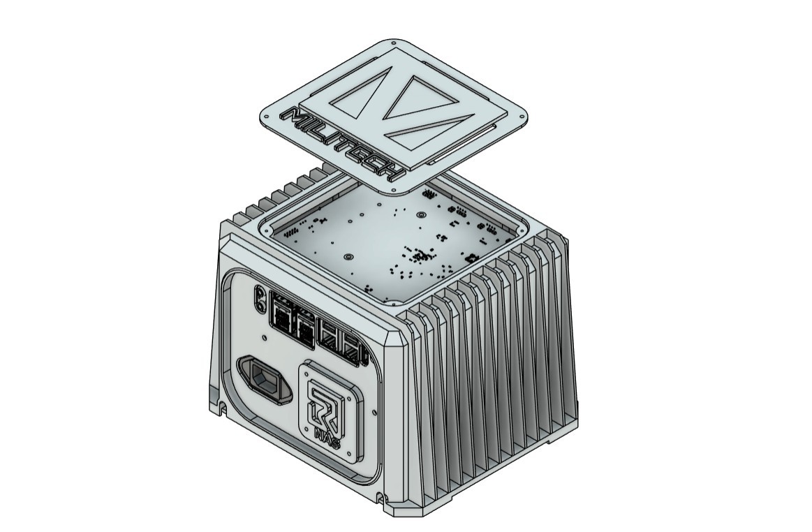

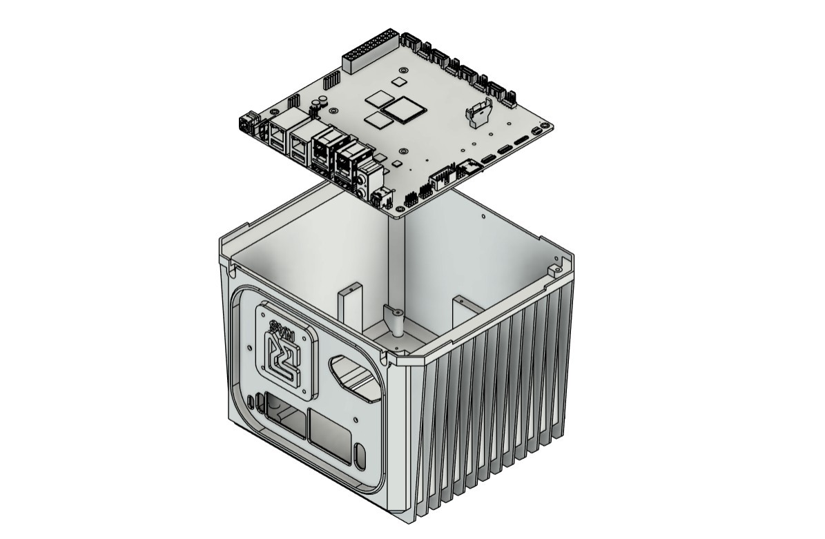

For the design of this project, my goal was simple: create a single enclosure that could house both the Radxa ROCK Pi 5 ITX board and a standard ATX power supply.

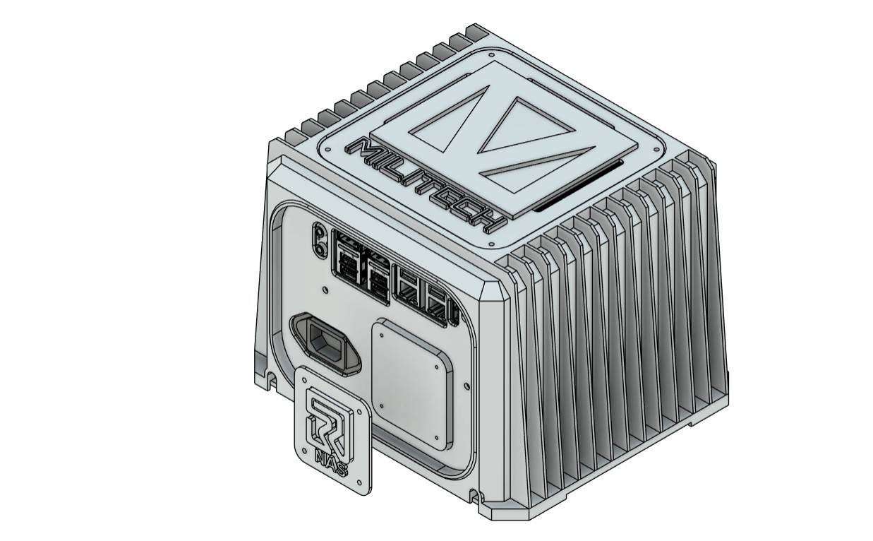

I designed a box-style enclosure with fins running all around the outside. These fins resemble the ones you'd typically find on metal fanless enclosures, where they're used to dissipate heat. In my case, however, they're purely aesthetic—they're added because they give the enclosure a rugged, industrial look.
The enclosure consists of two main parts: the main body, which holds the Radxa board and the ATX power supply, and a bottom cover that closes everything up and gives the build a clean finish.
On the left side, I added cutouts for all of the Radxa's I/O ports, along with the AC input for the power supply, making everything easily accessible from the outside.
The top panel serves two purposes. First, it improves airflow with ventilation openings, and second, it ties the whole design together aesthetically.
I had recently been playing Cyberpunk 2077, so I borrowed some inspiration from its futuristic industrial design language. That's why you'll notice the Militech logo on the top panel and the Relic logo below the I/O ports—just a couple of small Easter eggs for anyone who's played the game.

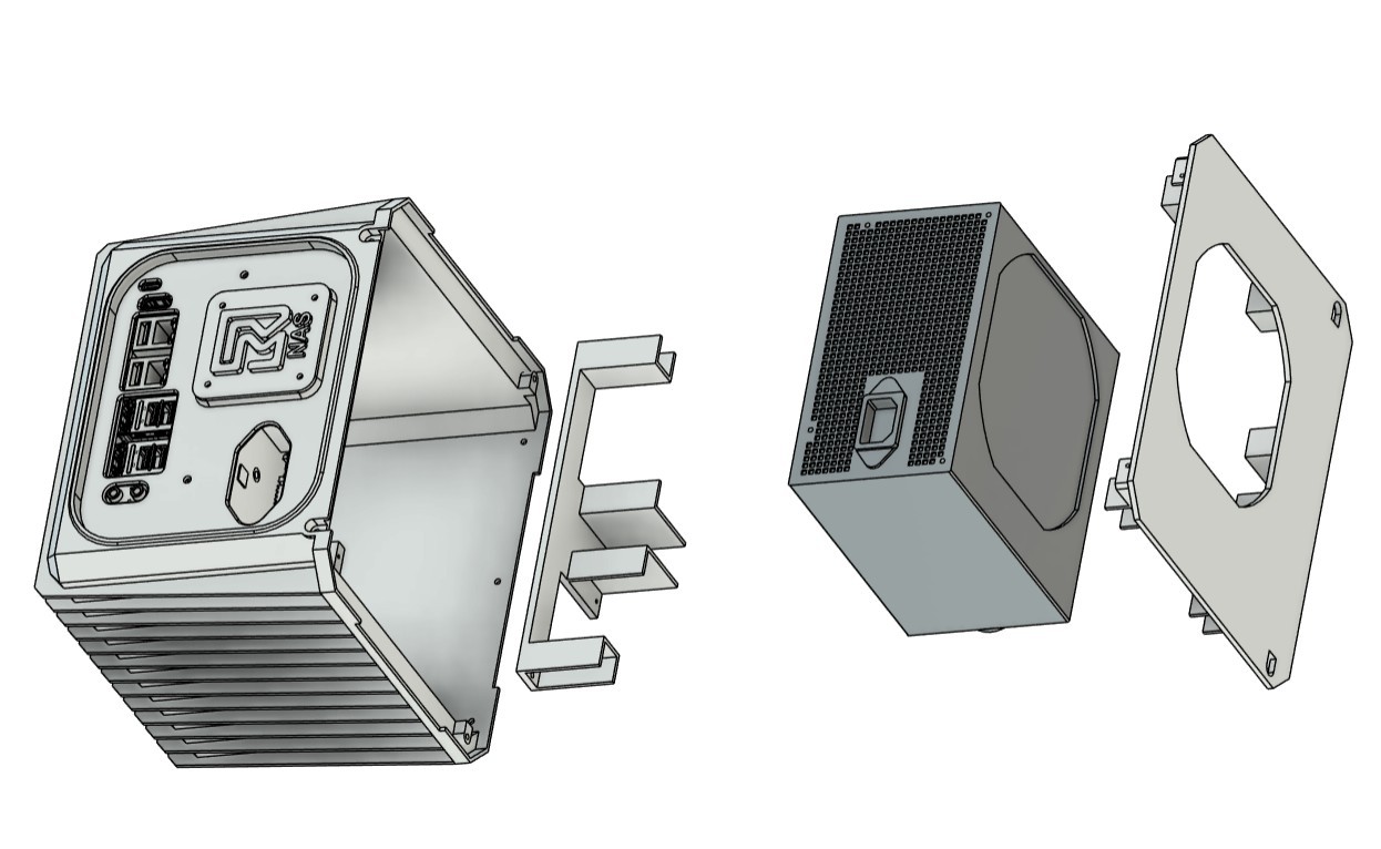

Inside the enclosure, I also designed a dedicated PSU mounting bracket. It sits above the Radxa board and securely holds the ATX power supply in place, preventing it from moving around inside the case.

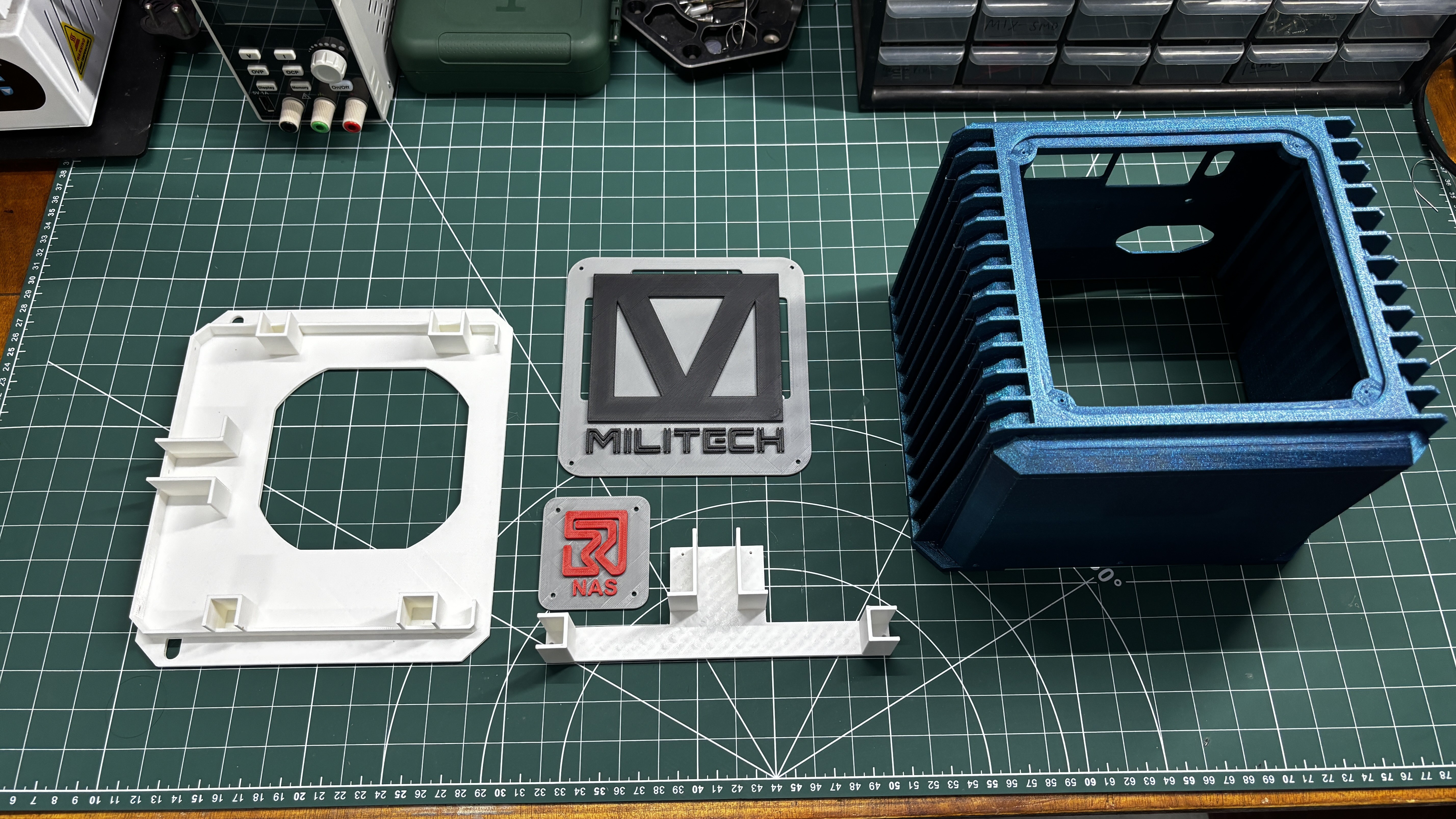

After completing the 3D model, all the parts were exported as mesh files and printed on my Anycubic Kobra S1 3D printer.
The main enclosure was printed using Galaxy Peacock PLA, which gives the NAS its distinctive metallic-looking finish. The bottom lid and PSU mounting bracket were printed in White Hyper PLA.
For the finishing touch, I wanted the Militech and Relic logos to be printed in two colors. The interesting part is that my printer doesn't have a multi-material system, so here's the trick I used.
I first printed the base of both logos in Grey Hyper PLA. Once the printer reached the layers where only the raised logo remained, I paused the print and manually swapped the filament. I switched to Black Hyper PLA for the Militech logo and Red Hyper PLA for the Relic logo. After resuming the print, the result was a clean dual-color print, all on a single-extruder printer.
It's a simple trick that works surprisingly well if you're patient.
That said, I'd still recommend using a multi-color printer if you have one, as taking too long to swap the filament can sometimes reduce layer adhesion between the color changes.
