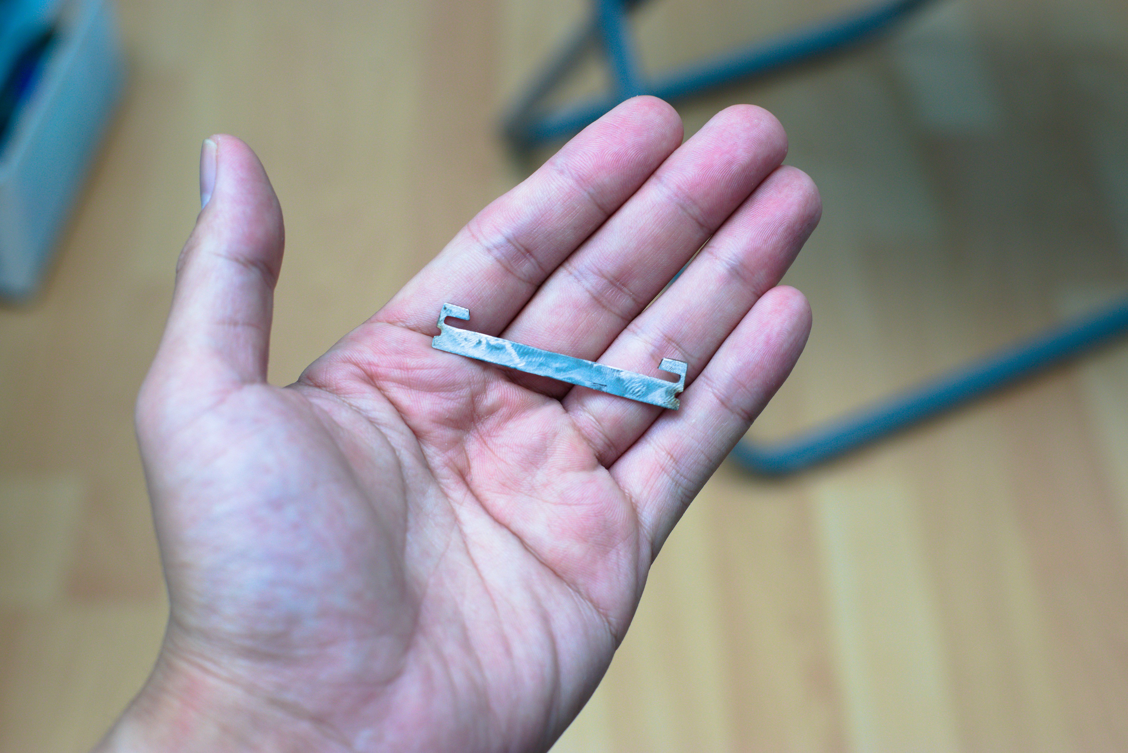

Fabrication of Metal Clips
*** Before you begin, this requires a bit of metal working, cutting some thin 1mm sheet metal with a Dremel and an appropriate cutting disk, if you are uncomfortable with that, consider asking for help to fabricate.
ADDITIONALLY DO NOT USE THE 3D Printed Template provided as the clip, it is too weak and could result in a dropped digital back.
When working with Metal fabrication the workpiece WILL get hot and there will be metal shavings flying about, USE PPE, thick gloves and goggles are a minimum. Plus whatever other safety is recommended with whatever tool you are using to cut the piece.
Ensure you have a sheet metal that is at least 12mm by 52mm more is recommended to give you a spot to hold onto.
When fabricating make sure the notches in the side are as close to the template as possible, these are where M2 screws will slot between to hold the clips in and thus the back on.
When testing the clips, do so on a level platform with the back supported, and test it before and after you install the clip onto the print, ensure the back locks in! Gravity is not our friend.

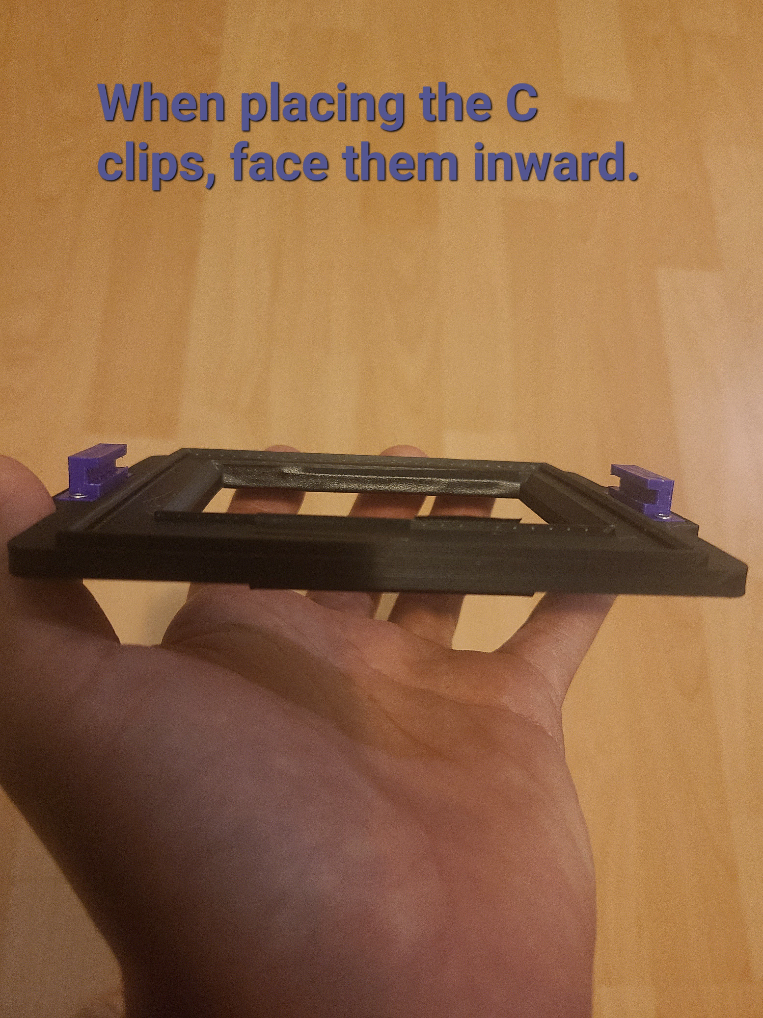

The 3D printed parts can be affixed using 4 M2x10mm screws and nuts, the channels in the smaller prints are to be facing inward to allow for the back to lock into the camera.

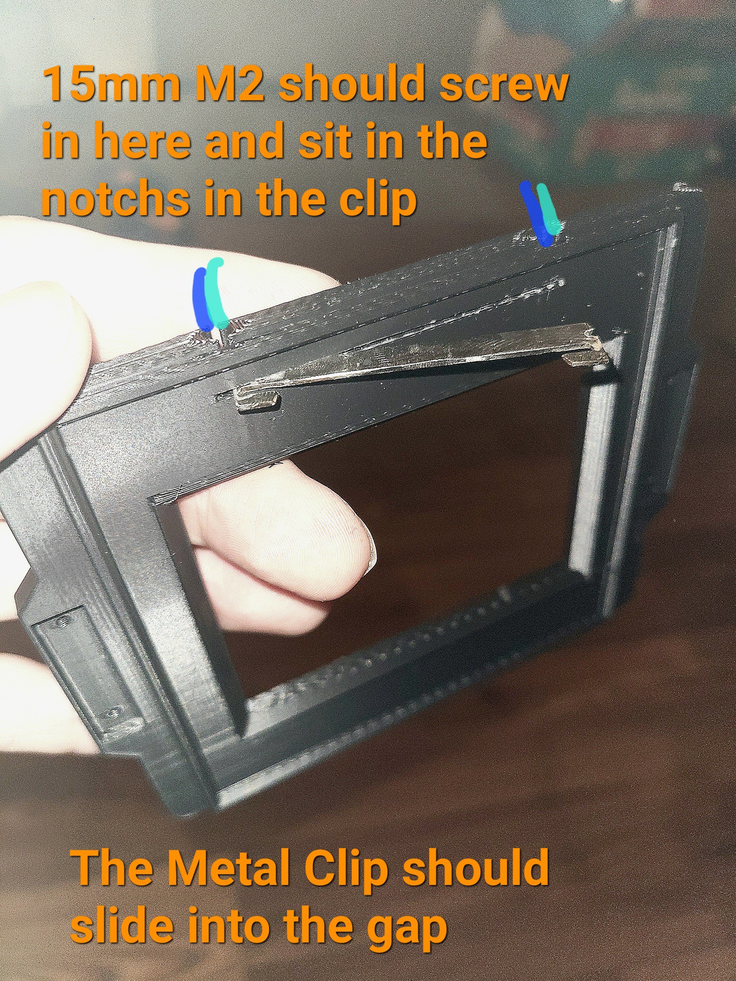

The Metal digital back clip slides into the gap in the middle of the print, once in screw in longer M2x15mm screws slowly through the print and the clips, make sure the screw actually sits between the notches, and doesn't just press into the plate as it'll likely cause you to strip the screw or the PLA hole, providing poor fixation. There is no hexnut used to fix the screw as I just treated the screw like a self tapper and just screwed it directly into the PLA slowly.

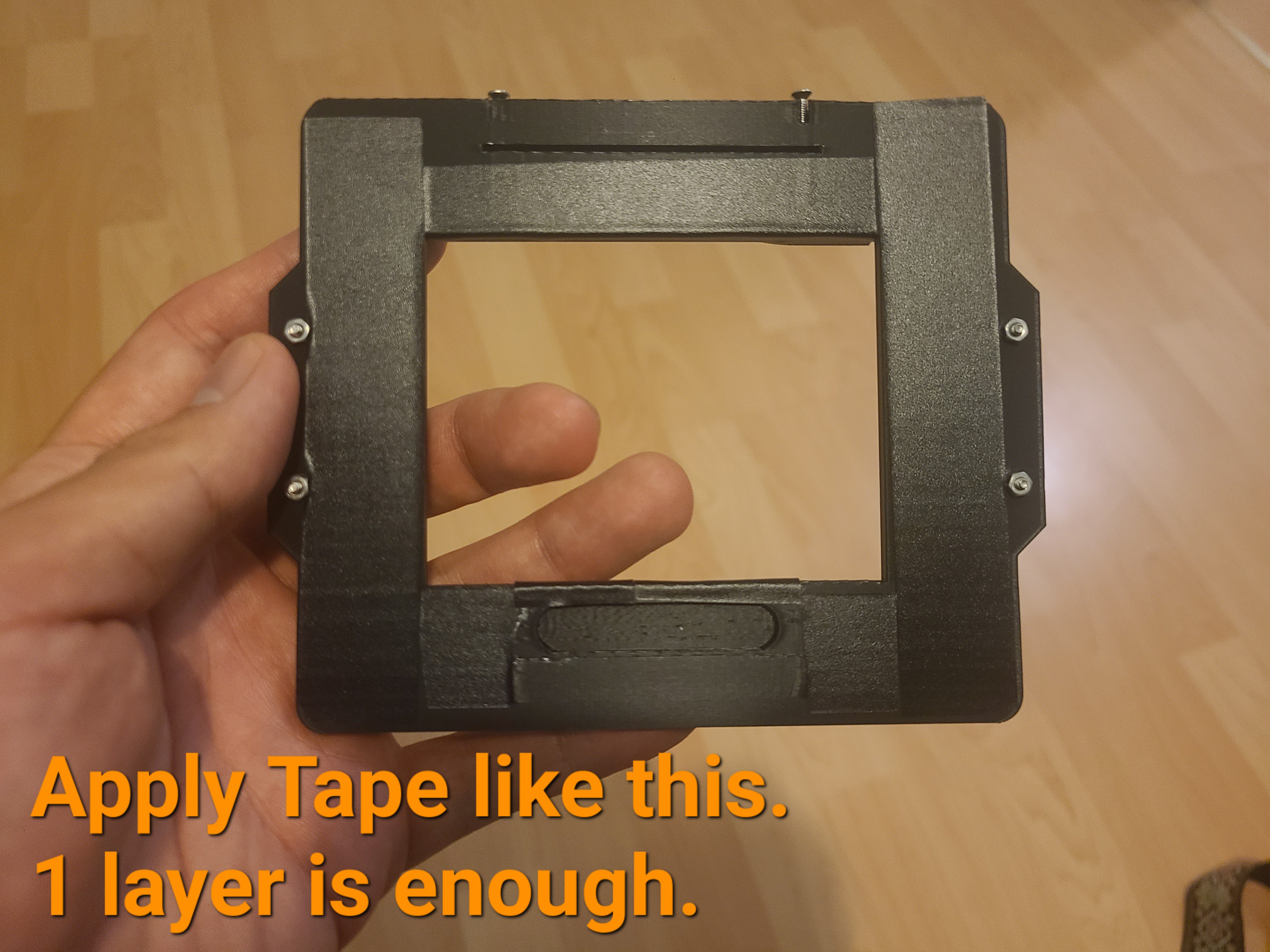

Last step requries use of some thin but supple tape, I used Black bicycle handlebar finish tape, but electrical tape should work, apply a thing layer to the side where the back will sit, this should be enough to seal the back to the adapter. If the back appears loose try a second layer.
