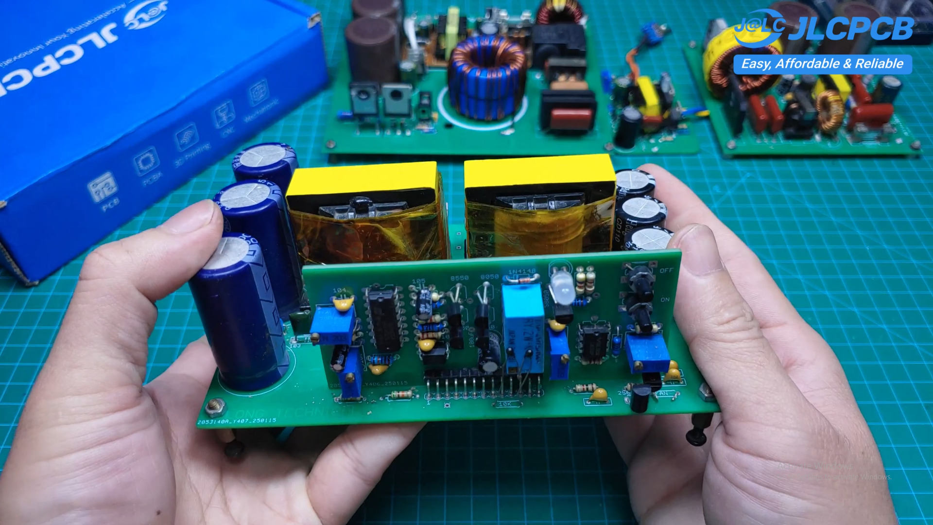

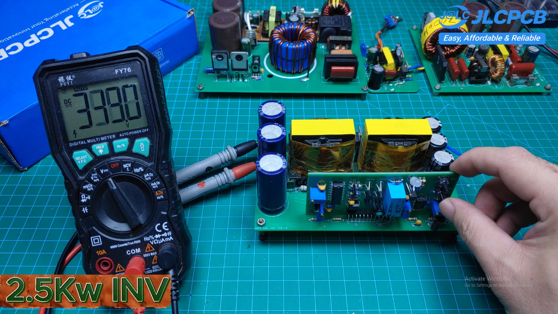

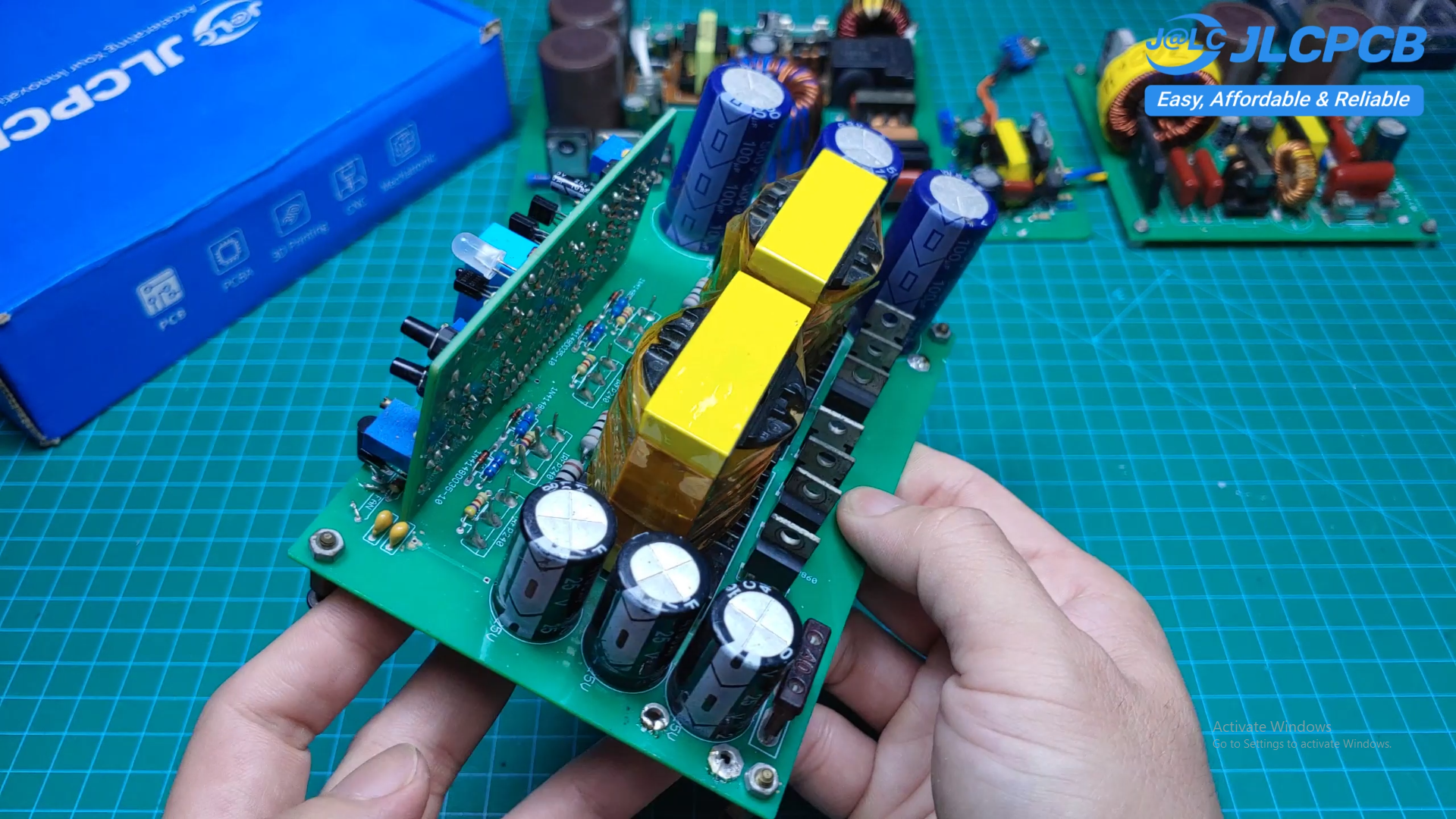

    2.5 Kilowatt Inverter
    The second project is a much larger inverter capable of delivering up to 2.5 kilowatts.
    Instead of using a single transformer, the design employs two transformers together with an H-bridge PWM output stage, allowing the inverter to handle much heavier loads.
    Several protection features are included:
    • Soft start / soft shutdown
    • Input overvoltage protection
    • Input undervoltage protection
    • Over-temperature protection
    The inverter can comfortably power motors, fans, power tools, and many other high-power AC loads.

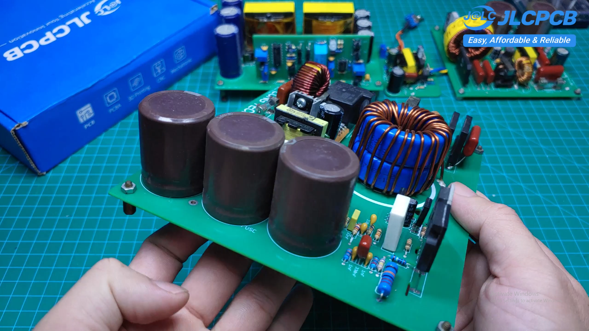

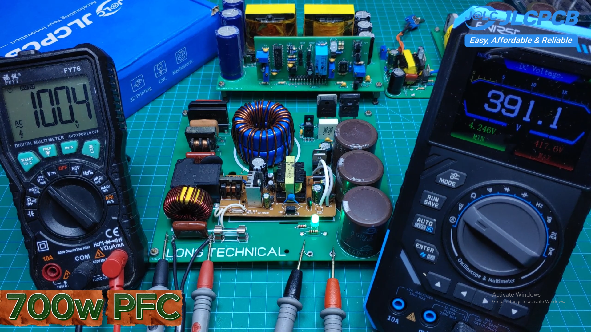

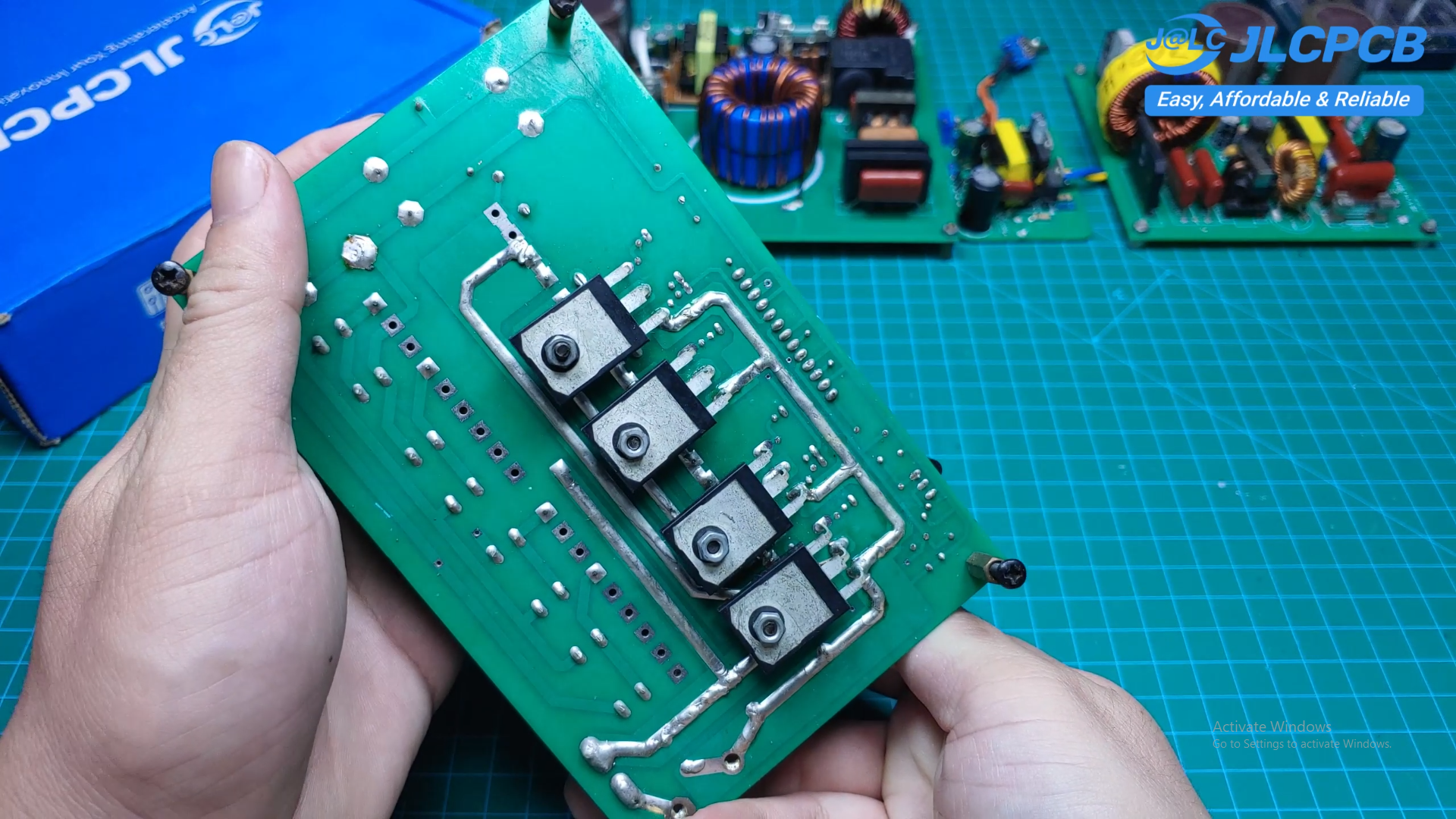

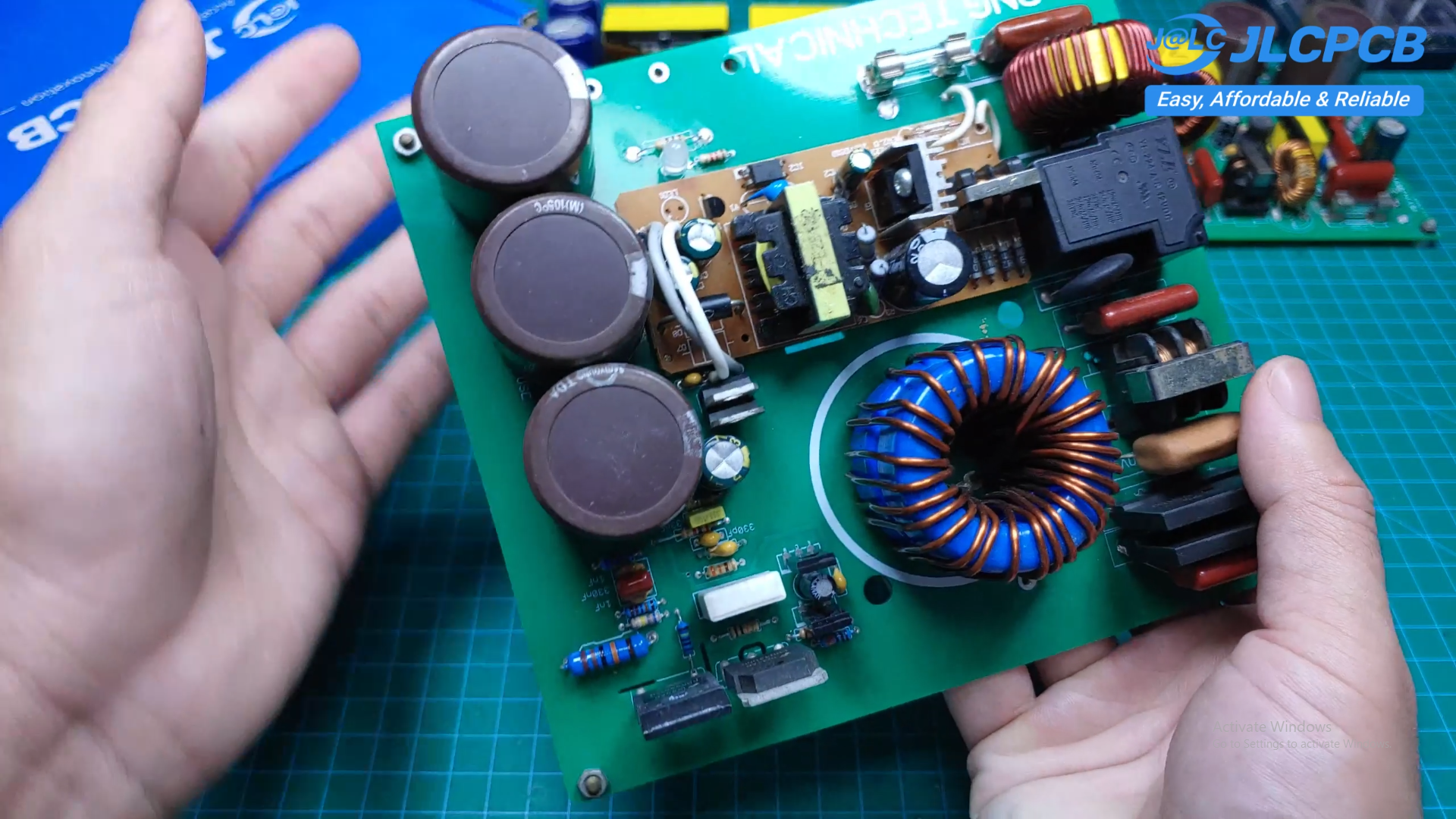

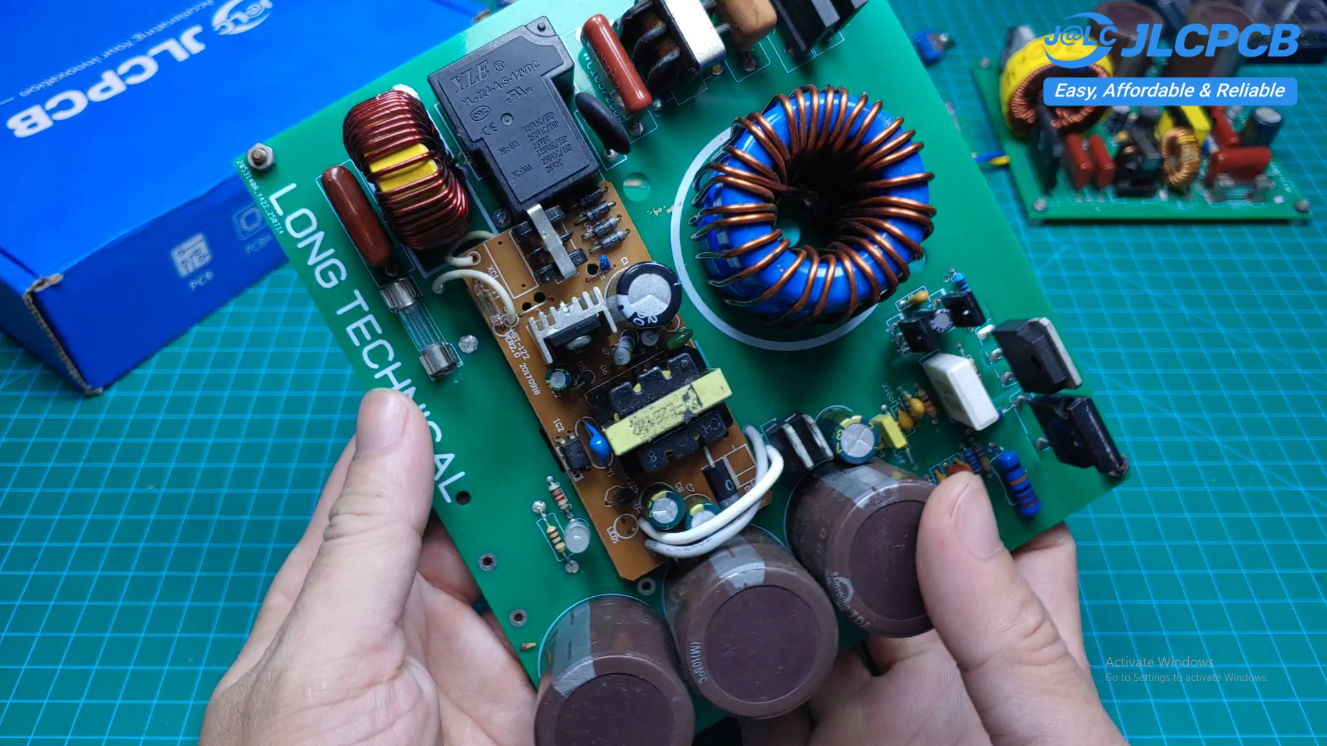

    2.5 Kilowatt PFC
    The final project is a high-power 2.5 kilowatt PFC converter.
    It is based on the same NCP1653 controller but uses a totem-pole MOSFET driver to achieve significantly higher output power.
    The control circuit is powered by a separate 15–24 volt auxiliary power supply, while the boost inductor is constructed using two stacked ferrite cores to support the higher current without sacrificing efficiency.
    This design has proven to be very stable during testing and is suitable for demanding high-power applications
