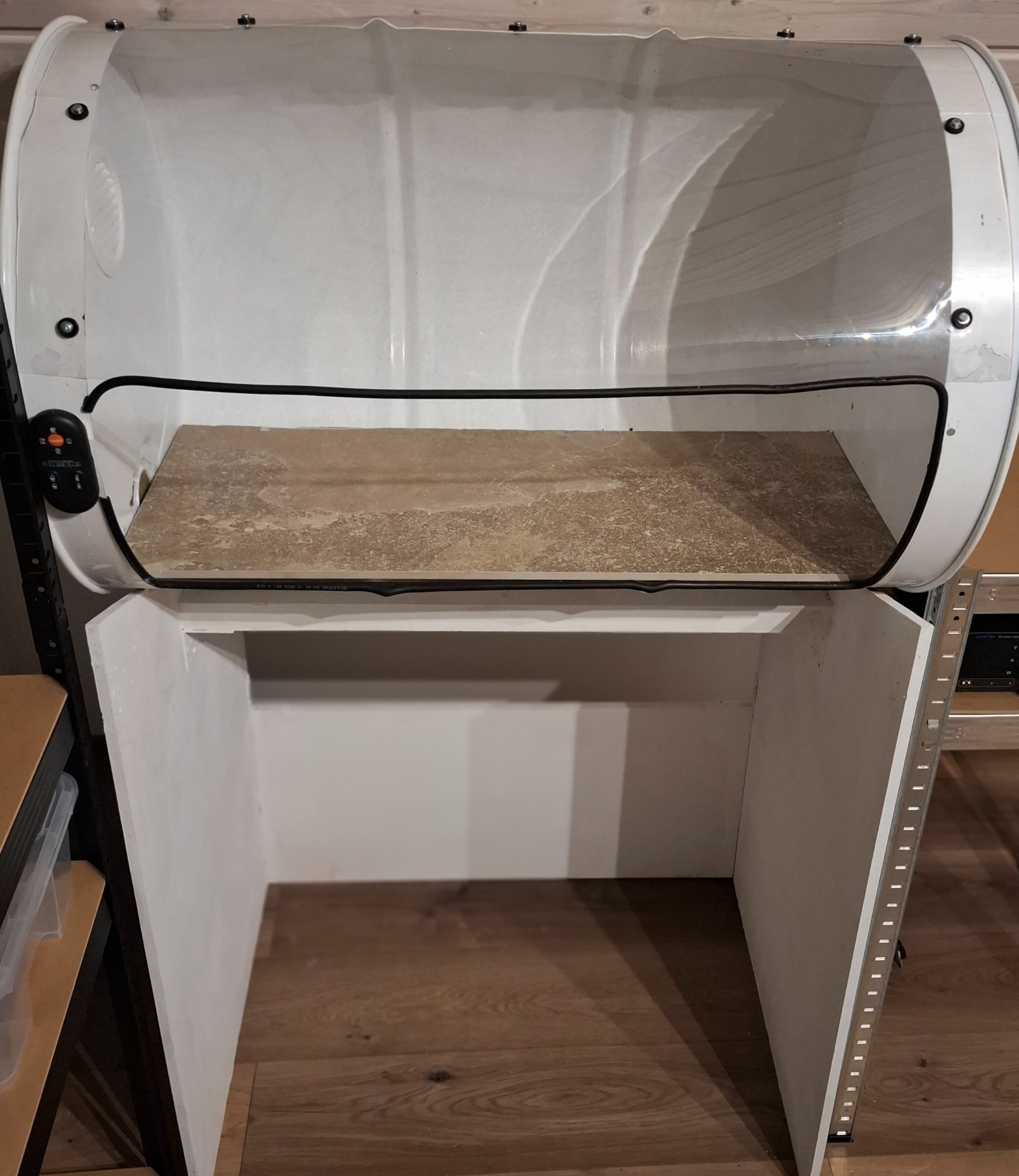

  • Final touches
    Jakob Spindler5 hours ago 0 comments
    Finally a wooden board was cut to length, to 45° angle cuts were done alonge the long edges, and the board was insertet into the barrel as the base for the tabletop. Later I repurposed an huge old tile I already had and cut it with anglegrinder with a diamond disk into shape, put it on top of the wood, for better resistence against heat (soldering) and everything around the edges was sealed with a high quality silicone to prevent the possibility of any chemicals like cleaning solutions and resin reaching the wooden board (not yet shown in the picture). Finally I screwed the  remotecontrol onto the side, so I always have it where I need it and don't Lose it😅.

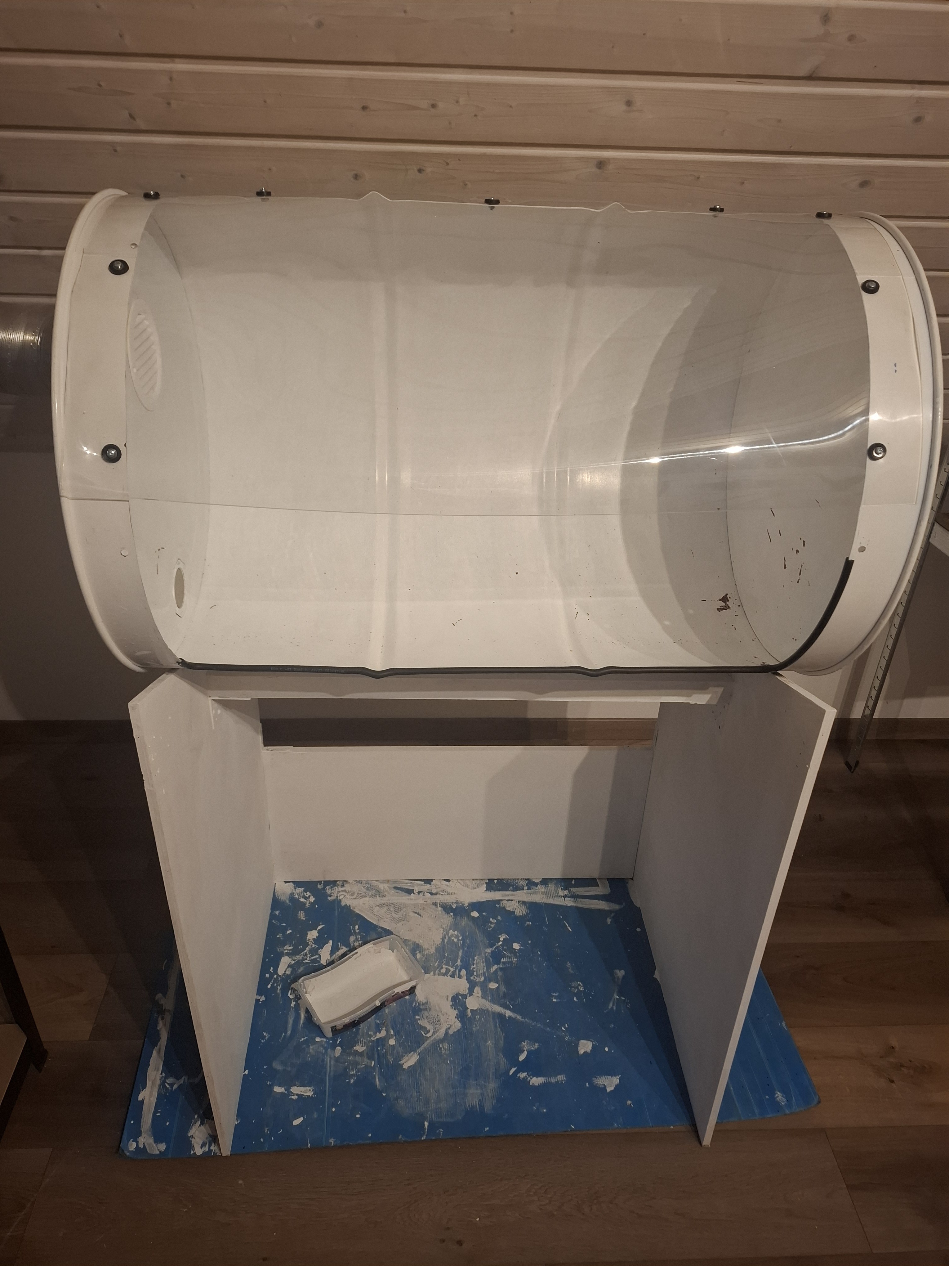

  • Baseframe
    Jakob Spindler08/19/2026 at 07:59 0 comments
    I constructed a simple Baseframe made from wooden boards and some scraps i still had in the workshop, the top was cut triangular, so the barrel couldn´t roll of. Everything was painted white, mainly for the looks of it. The fumehood got even better secured, by screwing it onto the frame.

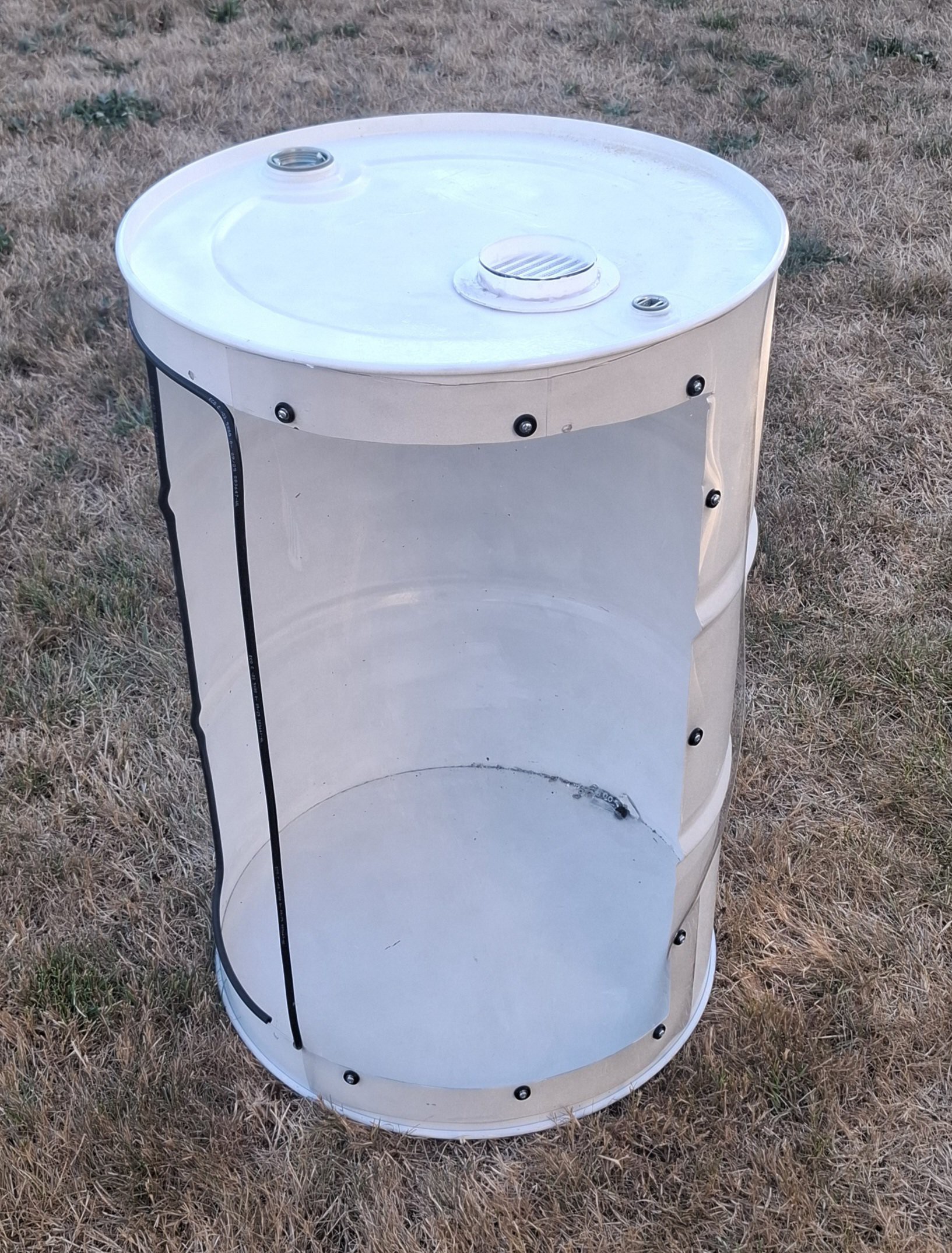

  • Modifications
    Jakob Spindler08/19/2026 at 07:39 0 comments
    i drilled the needed holes with an m4 Drill, cut out the exhaust port, deburred everything, and spraypainted it white. The thick transparent tablecloth was placed in a way that most of the previous cut opening is covered but there ist still enough room to work inside with your arms, and screwed in place with the screws and nuts, the rubber sealing rings where used, so i wouldn't damage the clear PVC. A rim was added, made from the gasoline tube for extra safety. An the exhaust Cover was glued into the opening i cut for it

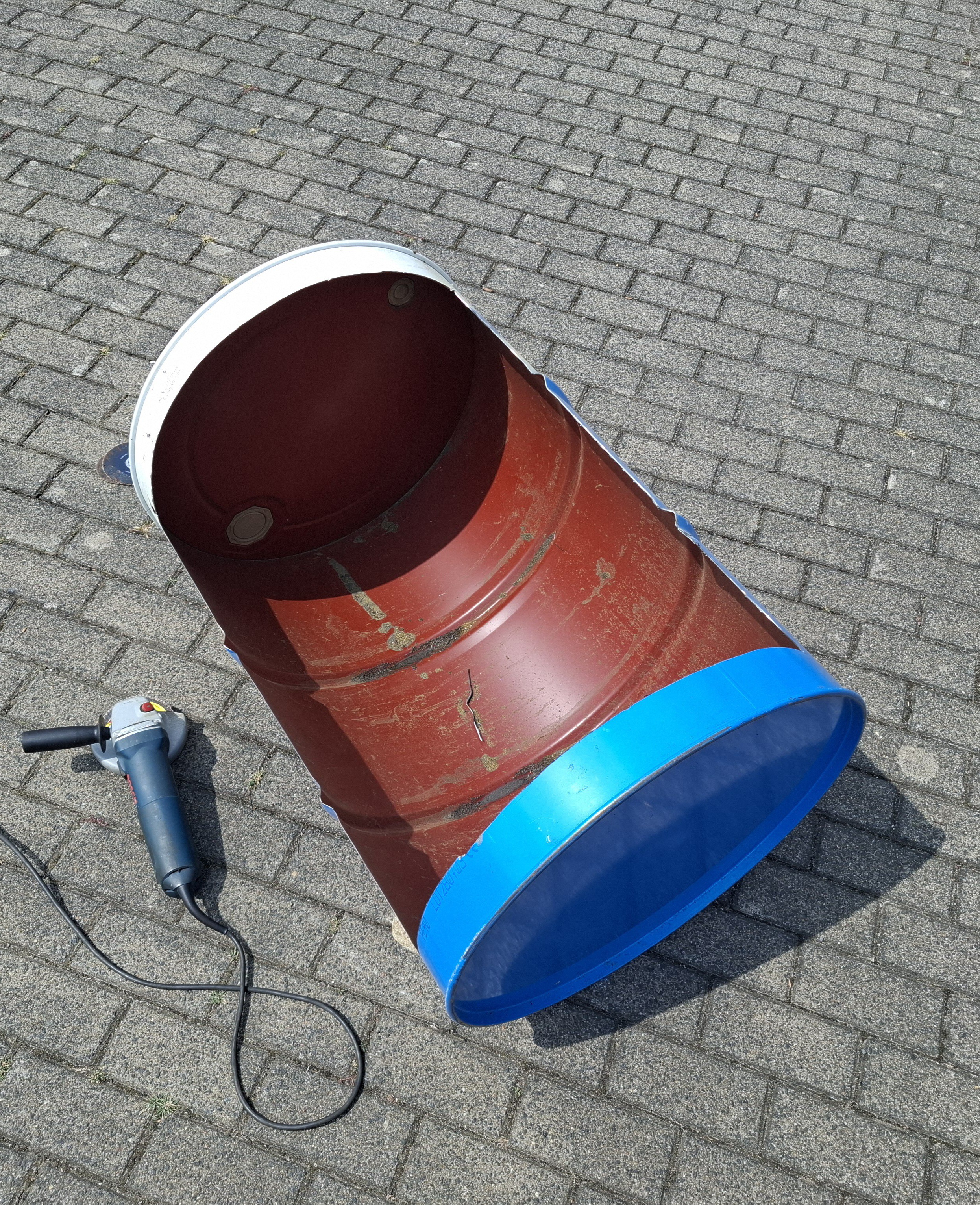

  • Cleaning, cutting an deburring
    Jakob Spindler08/19/2026 at 07:28 0 comments
    the barrel was cleaned thorougly, dried, and the marked pieces were cut out with an angle grinder, as well as deburred with a sanding disk.
