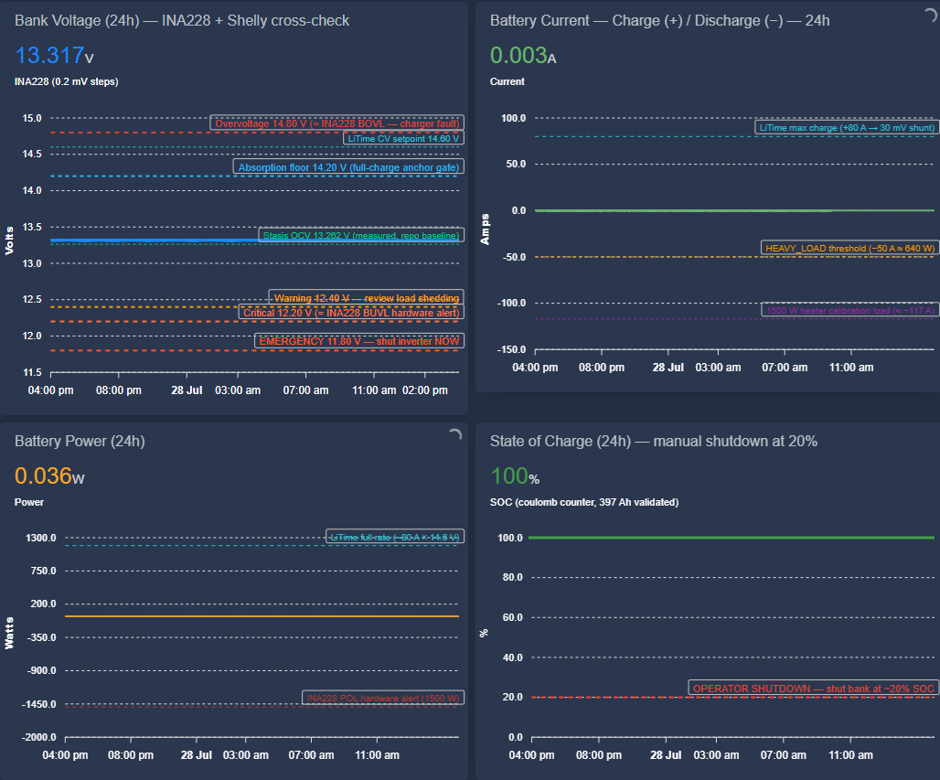

- Sensor: Adafruit INA228 breakout, on-board 15 mΩ shunt removed, 20-bit, ADCRANGE 0 = ±163.84 mV, 4120 µs x 128 averaging, 2s poll, Kelvin taps to DROK 200A / 75mV manganin shunt (375 µΩ) in negative leg, low-side
- Voltage: Fused VBUS lead from positive busbar — 195.3125 µV LSB survives end-to-end to HA CSV export, σ ≈ 0.10 mV (half an LSB)
- Brain: Seeed XIAO ESP32-C3, ESPHome
- Temp: DS18B20 on pack case, isolated mount
- UI: SSD1306 OLED STEMMA + wake button + status LED (slow-flash proof-of-life / solid active / fast FAULT)
- Power: Pololu D24V7F3 3.3v regulator
Firmware V1.21 at commissioning: 2s integration (stale-bus watchdog 10s, 8-16V and ≥350A plausibility guards), coulomb-counted SOC anchored at confirmed full-charge (≥14.20V sustained 60s + charger-stop edge), true signed mW power.
Independent hardware alerts written to INA228 at boot and latched on GPIO5: BUVL 12.20V, BOVL 14.80V, SOVL +250A, SUVL -250A, POL 1500W — decoded to alert_reason with operator acknowledge, independent of firmware.

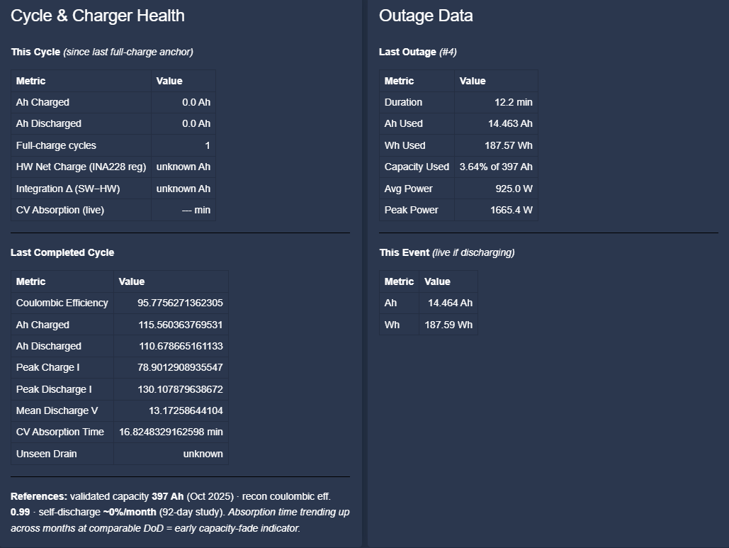

Efficiency Ladder | Inverter 90.3% @440W avg only | Voltaic 95.8% (13.17V dis / 13.745V chg), Round-trip ∼94.8%, Charger AC→DC 95.7% ±2.5% (1586 Wh DC / 1657 Wh AC), Inverter 87-94% provisional + 127W self-consumption @1kW measured |
Voltage Sag | 300 mV tracked, but offset | 3.5% sag at nameplate (∼130A), Vmin 12.851V quantified |
BMS Balancing | Detected as ∼80-90s oscillation | Countable metric: 10.7 min above 14.4V, 183 mV pk-pk, 8 reversals, baseline absorption 16.82 min |
OCV Metrology | No | OCV slope 6.0 mV/%SOC, τ63 ≈7 min, 95% ≈34 min relaxation fit, thermal +2.7°F @0.157C charge |
Protection | HA-dependent | Hardware BUVL/BOVL/SOVL/SUVL/POL + firmware 12.40/12.20/11.80/14.80V — live-validated with genuine over-power alert and double inverter-overload trip during commissioning |

Deliberate discharge ladder 41W → 70W → ∼1kW → nameplate, then full LiTime 12V 14.6V 80A charge:
- CC 80 min at 78.6A (98.3% nameplate) → CV entry 14.20V → Vmax 14.584V (-16mV of spec) → taper 66.7→6.48A (≈C/77) → stop. 115.39 Ah in 98 min @0.157C.
- Ledger closes: 110.71 Ah discharged, 115.39 Ah charged = 4.68 Ah excess = ≤1.1 Ah true CE loss + balancing + ∼3.5 Ah pre-commissioning deficit (bank rested since July 5 full charge, 5x BMS standby 1.3-2.6 Ah + lamp session).
- First-cycle CE 95.78% is an accounting floor, not a measurement. True CE ≥98.5% expected cycle 2+.
- All 8 commissioning defects (3 hardware, 5 firmware) closed without carrier respin — e.g. F3 idle flatline, F4 outage duration desync, F5 Ri phase scatter from 5s dwell at 20 mV/s.
