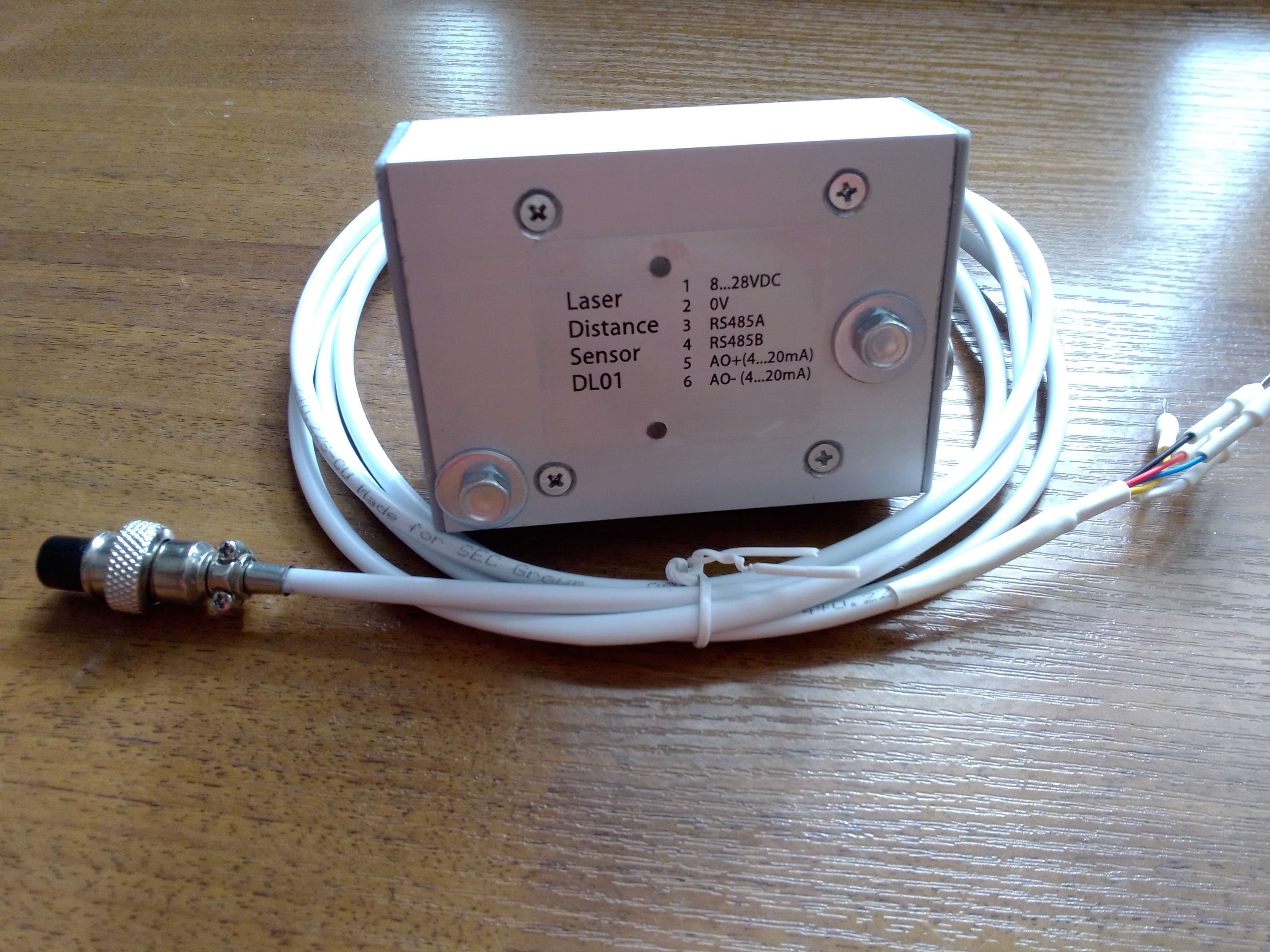

   However, the TF-Luna module itself is not designed for industrial use. Therefore, almost everything else had to be developed from scratch, including the controller electronics, firmware, RS-485 Modbus RTU interface, 4–20 mA analog output, digital filtering, calibration system, and enclosure.
    The goal was not simply to build a device around the TF-Luna module, but to create a complete industrial sensor that could be installed in an existing control system without requiring any changes to the machine control logic. The result is an industrial instrument designed for continuous operation in demanding production environments.

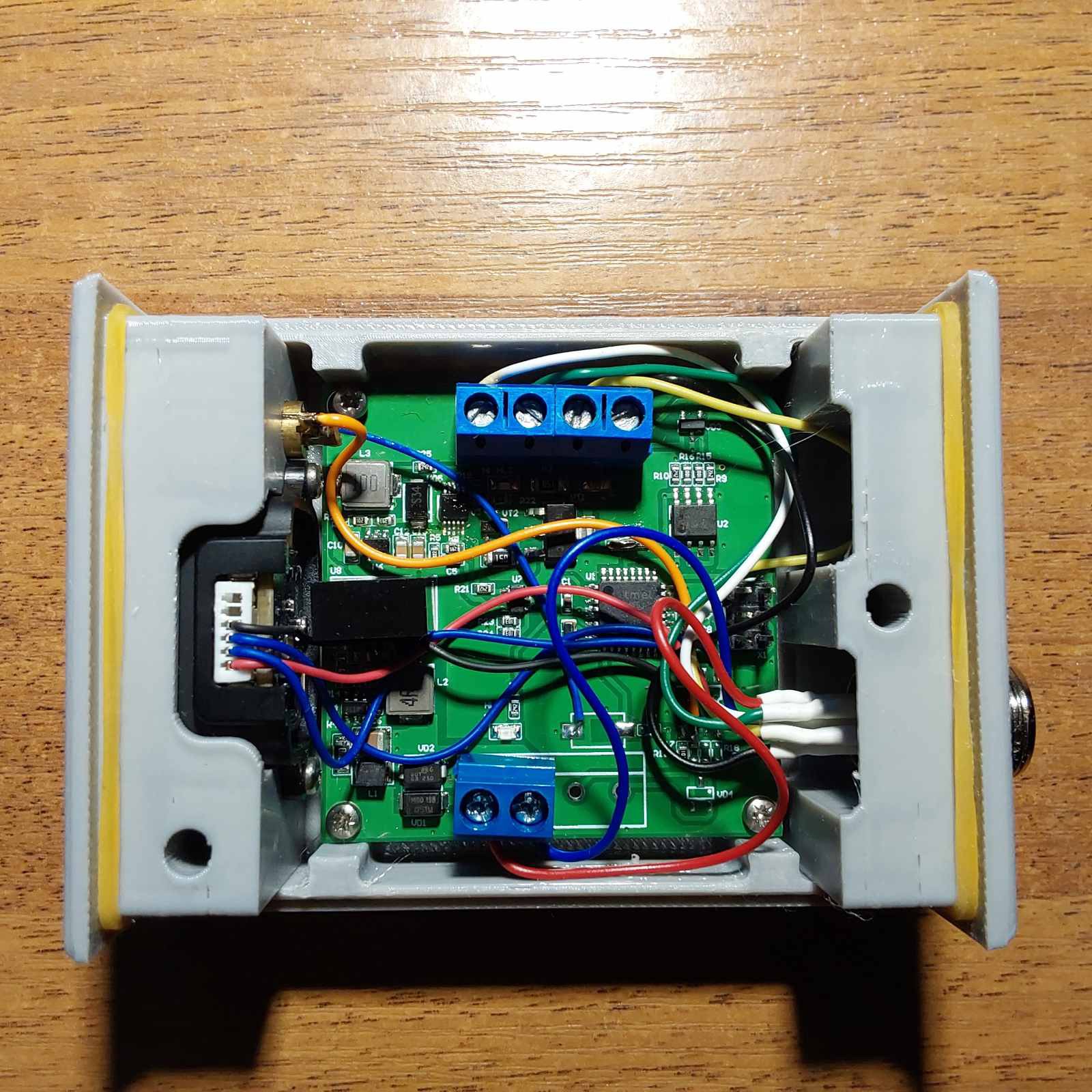

                                               Electronics

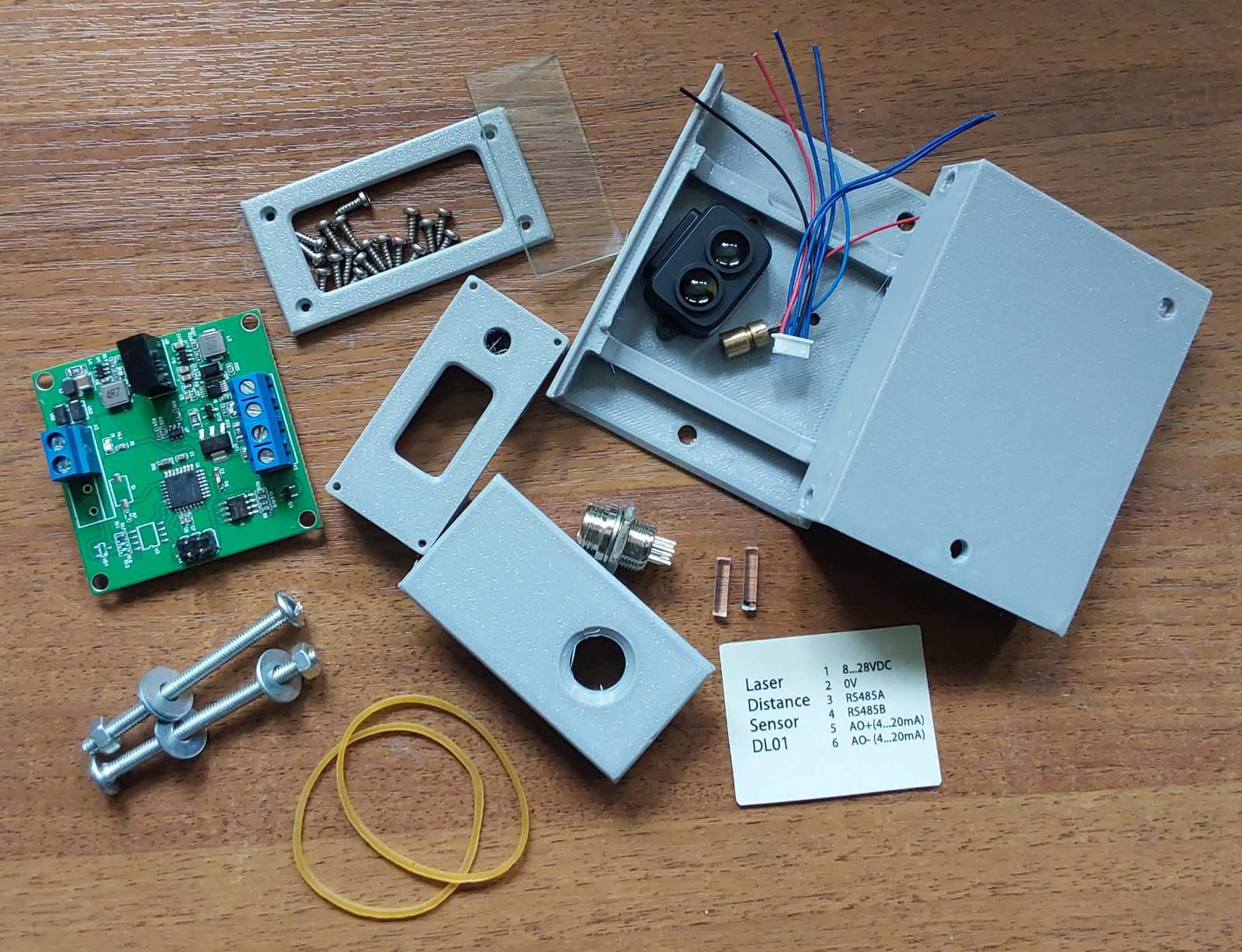

   To integrate the TF-Luna module into an industrial control system, a custom controller board was developed around the ATmega328PB microcontroller. It receives measurement data from the TF-Luna via the UART interface, performs digital filtering and calibration, and provides two industrial output interfaces: RS-485 (Modbus RTU) and a 4–20 mA current output. All calibration parameters and configuration settings are stored in the microcontroller's internal EEPROM.

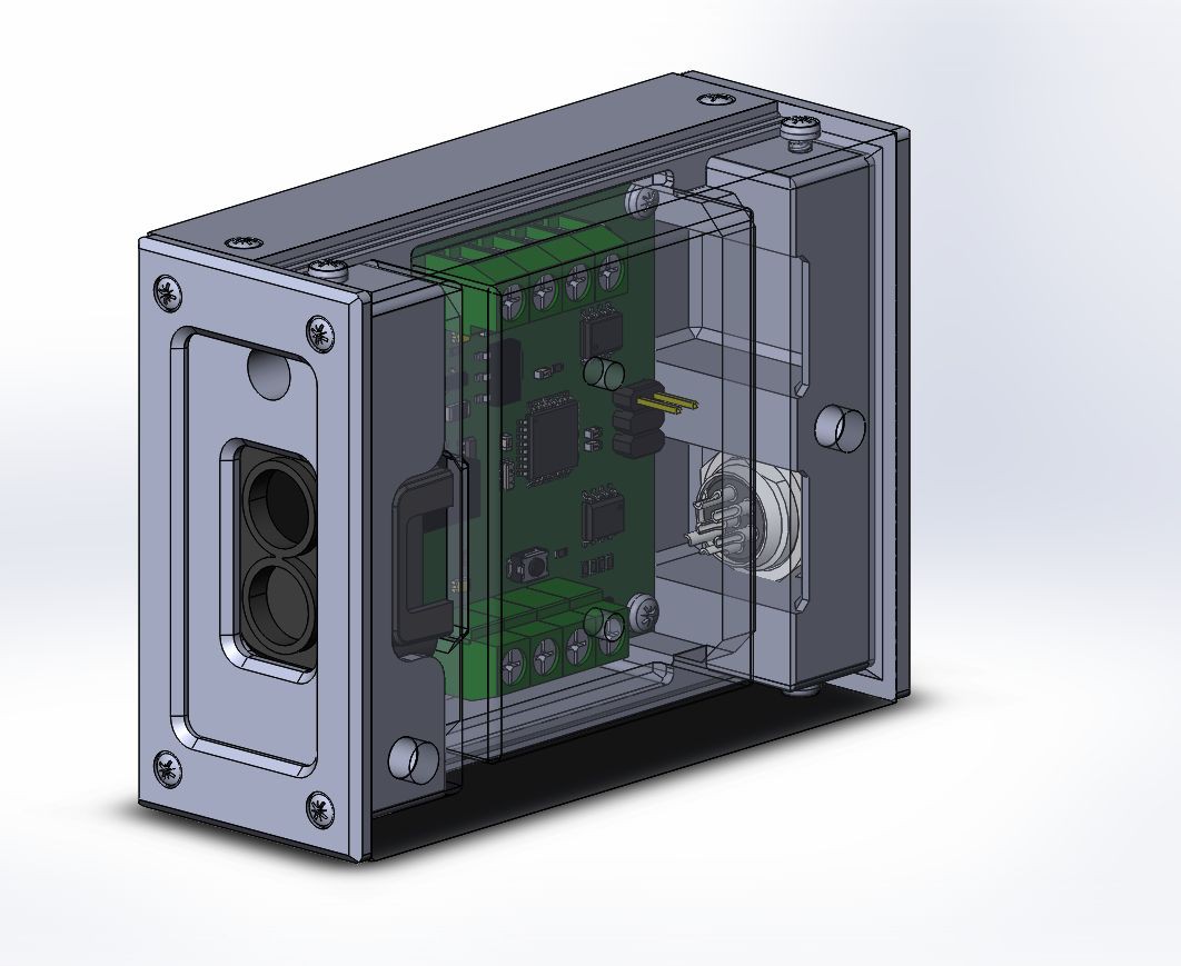

                                          Mechanical Design
   The enclosure design also evolved through several iterations. Development began with a machined aluminum prototype used for laboratory testing.

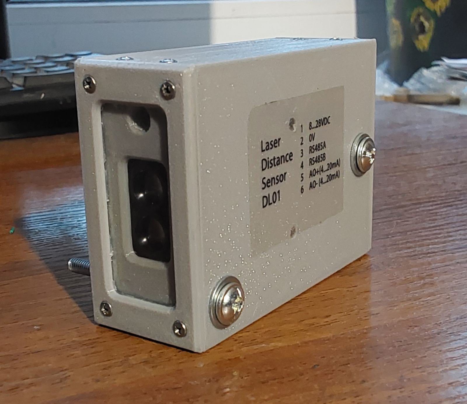

   To simplify manufacturing and reduce production costs, the enclosure was redesigned in SolidWorks and produced using 3D printing with PETG.

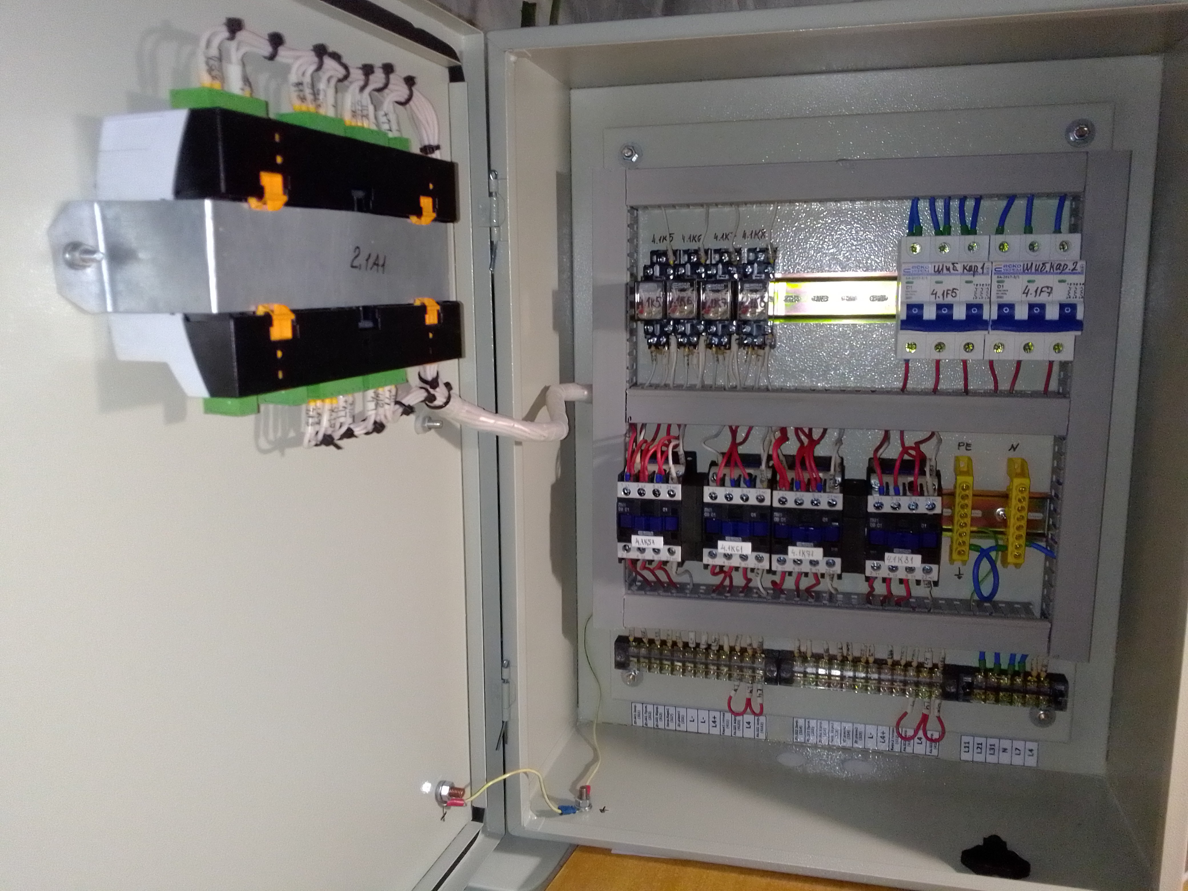

                                                 Real Production
               Control cabinet of the automatic dosing system installed on the production machine
