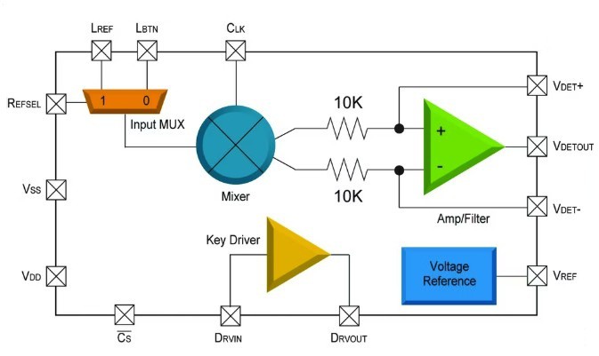

The idea was promoted long ago in the journal Funkamateur by Dr. Martin Ossmann and entitled "Circuit for Inductive Sensors as a Receiver Front End". While its primary purpose is measuring tiny changes in coil inductance for touch interfaces, its internal architecture—containing a high-frequency driver, multiplexer, mixer and synchronous detector—allows it to function as a low-frequency RF front end.

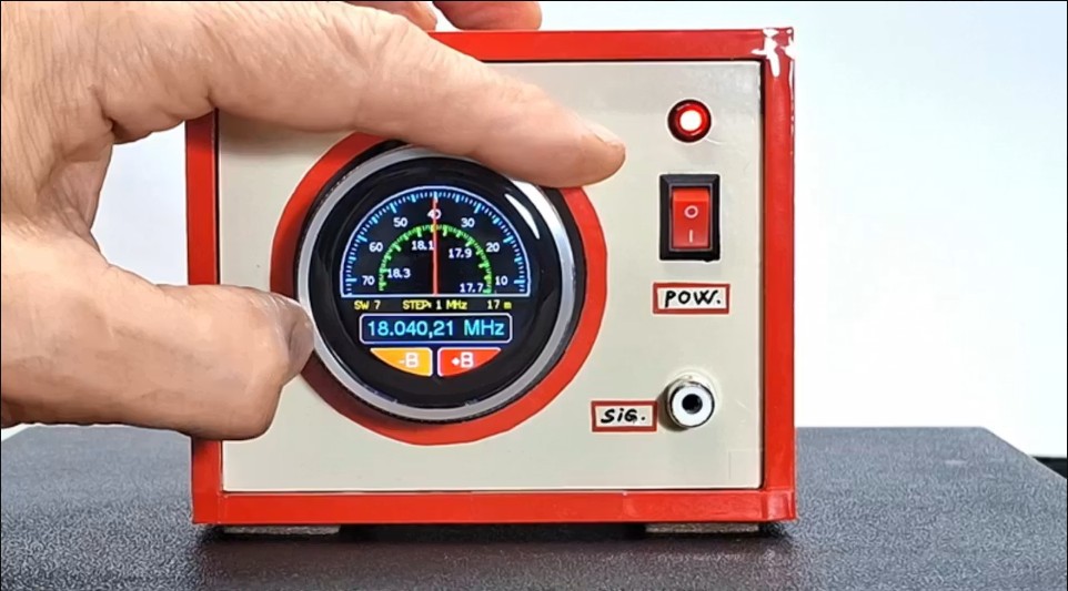

We only need a few passive components and an external oscillator to select the desired frequency. For this purpose, I use my VFO with a 1.28 inch circular display, the construction of which is described in one of my previous videos.

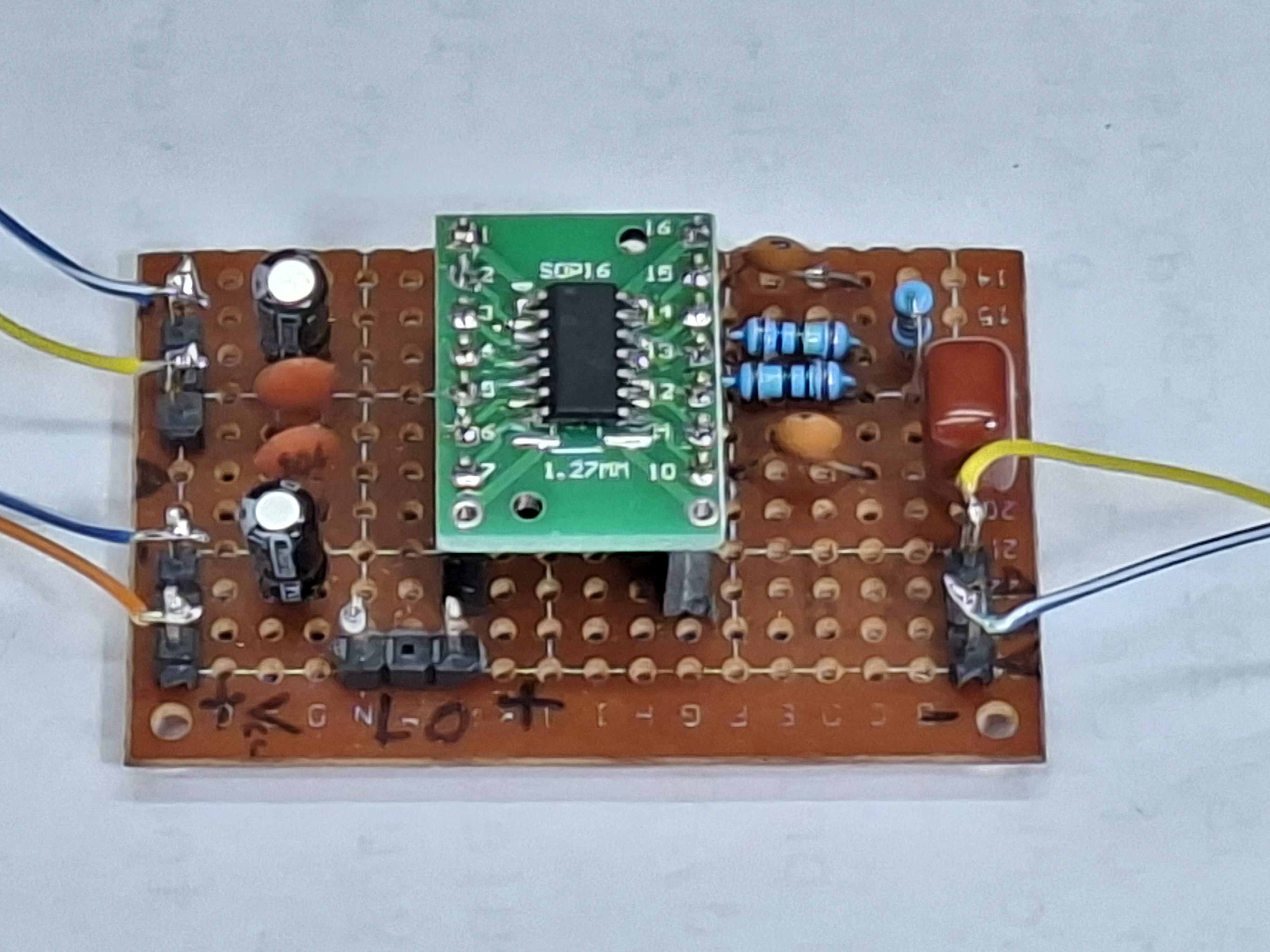

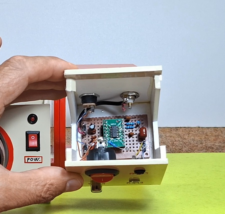

I mistakenly got an mcp2036 chip in a SOIC package, otherwise it is much simpler to make it with a chip in a DIP package. Here is the antenna connector, the VFO signal input, and the audio output. The other device is a Variable Frequency Oscillator.

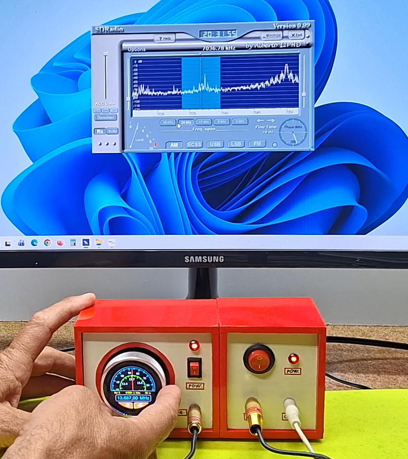

Now let's see how this SDR radio works in real conditions. For reception I will use my long wire antenna mounted on the roof of the house.
And finally a short conclusion. In this project I demonstrate an extremely simple Direct Conversion SDR Receiver based on the Microchip MCP2036 IC. With only a handful of passive components and an external VFO, this unusual circuit becomes a surprisingly capable SDR front-end covering frequencies up to approximately 10–15 MHz. The receiver is tested on several HF amateur and shortwave broadcast bands using SDR software running on a PC. Despite the simplicity of the circuit, the results are impressive and make this a fascinating experiment for every radio electronics enthusiast.
