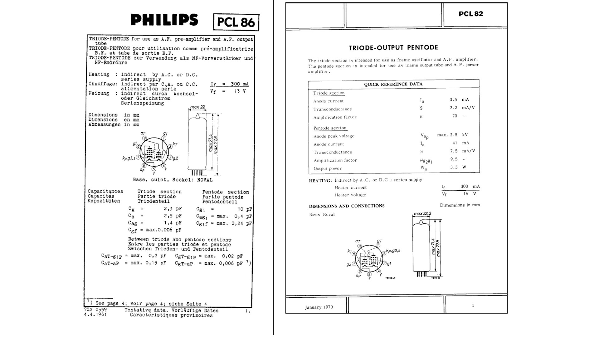

At the time of building this project, I had several PCL82 tubes available, so I decided to modify the original design to work with the PCL82 instead of the PCL86.

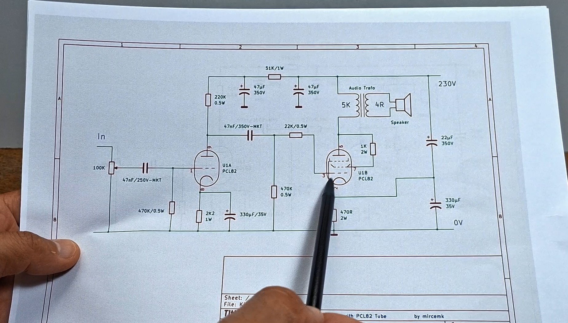

Although both tubes contain a triode and a power pentode, they differ significantly in their electrical characteristics, pin configuration, and heater voltage requirements. Because of these differences, several modifications were necessary to achieve operating conditions and performance similar to those of the original PCL86 amplifier. The most important changes included rewiring the tube socket to match the different pinout of the PCL82, adjusting the cathode bias components, modifying the screen grid circuitry, and optimizing the operating points of both the triode and pentode sections. These changes allowed the amplifier to operate reliably while maintaining performance close to the original design.

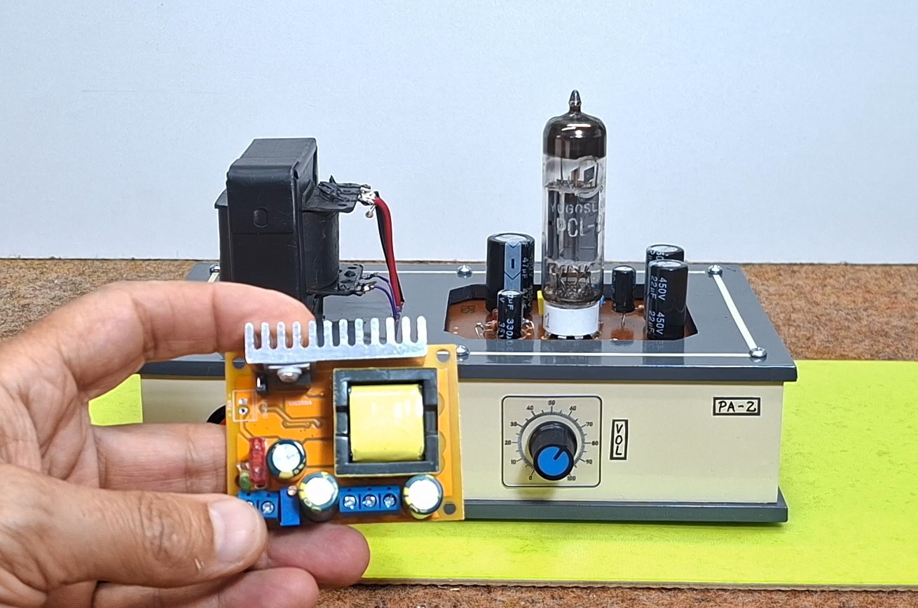

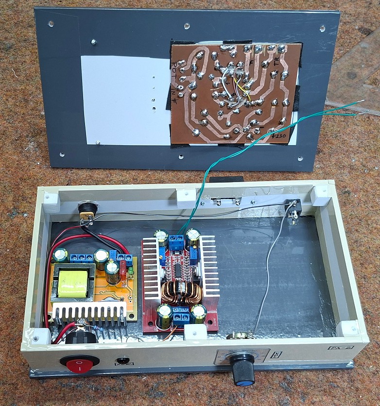

Inside the enclosure, the amplifier is built around a compact and modern power supply arrangement. Instead of using a bulky and often expensive mains power transformer, the entire amplifier is powered from a 12V DC source. A small DC-DC boost converter generates approximately 230V for the tube's anode supply, while a second boost converter provides the required 16V heater voltage for the PCL82. This approach significantly reduces size, weight, and cost while keeping the project simple and practical.

The circuit itself is straightforward and follows the classic single-ended tube amplifier topology. The triode section of the PCL82 operates as a voltage amplifier, increasing the level of the incoming audio signal. The amplified signal is then coupled to the pentode section, which provides the power amplification required to drive a loudspeaker through an output transformer. The output transformer, salvaged from an old non-working tube radio, matches the high plate impedance of the tube to the low impedance of the loudspeaker.

One particularly interesting aspect is the power supply. Despite using switching DC-DC converters, the amplifier is completely free from audible hum and switching noise, even with the volume control set to maximum and no input signal connected.
The switching converters operate at frequencies above 30 kHz, well beyond the audible range, and careful grounding and layout techniques ensure silent operation.
