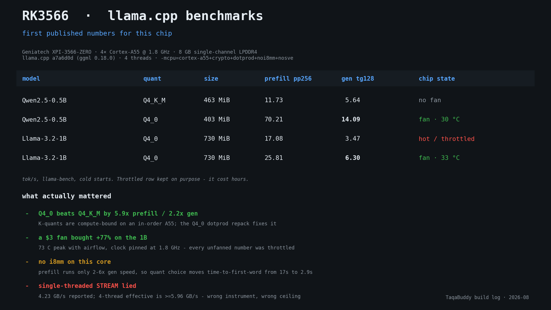

    I couldn't find a single published llama.cpp benchmark for the RK3566, so here's the first set. Geniatech XPI-3566-ZERO, 4× A55 @ 1.8 GHz, 8 GB single-channel LPDDR4, llama.cpp with cmake auto-detected -mcpu=cortex-a55+crypto+dotprod+noi8mm+nosve this core has dot-product but no i8mm, so ignore any guide telling you to add +i8mm.
    Headline numbers, 4 threads, cooled: Llama-3.2-1B Q4_0 generates at 6.30 tok/s (pp256 25.81). Qwen2.5-0.5B Q4_0: 12.31 tok/s — and note Q4_0 vs Q4_K_M matters enormously on this core (68.88 vs 11.73 prefill on the 0.5B; the Q4_0 repack path is 2–6× faster here).
    Two measurement mistakes worth confessing: a single-threaded STREAM triad understated real bandwidth (llama.cpp's four threads extract more via memory-level parallelism), and an early 1B run was silently thermally throttled. The two errors briefly agreed with each other, which looked like validation. It wasn't. Full table attached.
