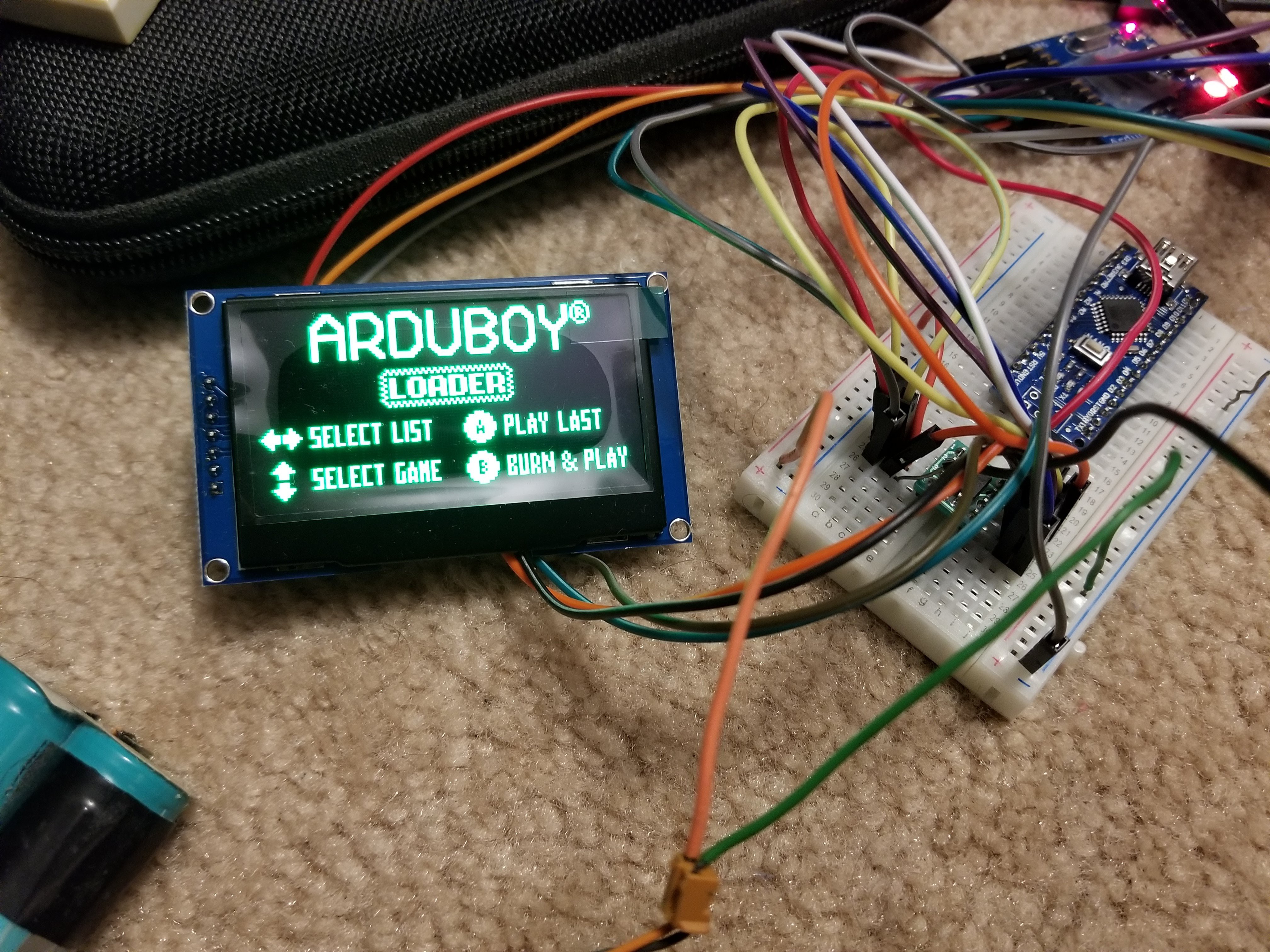

The FX and FX-C models have an external 16MB SPI flash memory to store hundreds of games which can flash the internal ATMEGA memory at any time. Game saves are stored in the ATMEGA's internal EEPROM, with the caveat that some games will overlap saves so you do have to be a little careful if you don't want to overwrite or corrupt saves. Flashing games to the flashcart (the SPI flash chip) is handled by either Mr. Blinky's python script or now via several online webtools that use Chrome's ability to connect USB serial devices (this one is my favorite: https://www.bloggingadeadhorse.com/cart/CartBuilder.html?file=flashcart-index&list=BigFX).

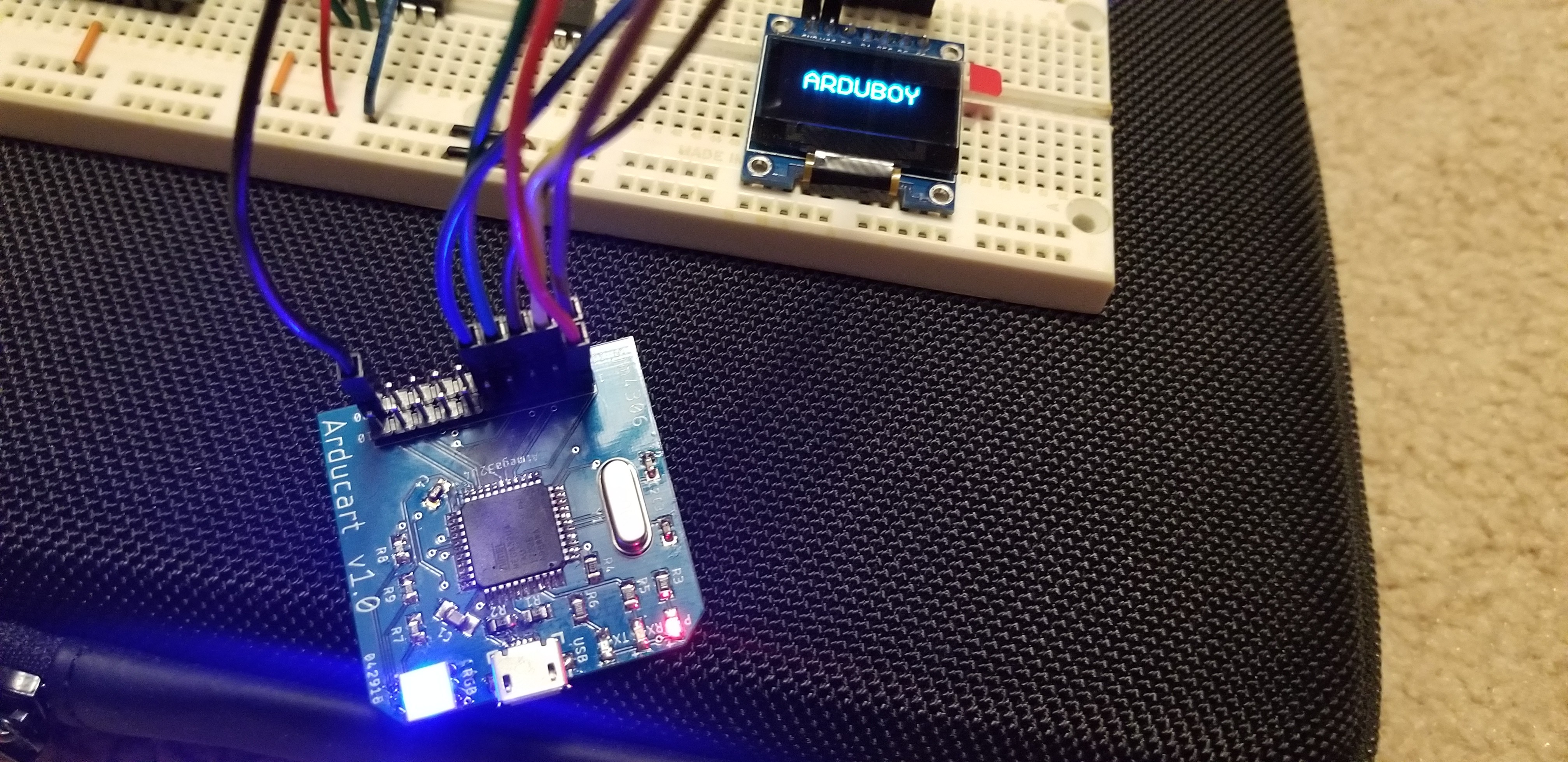

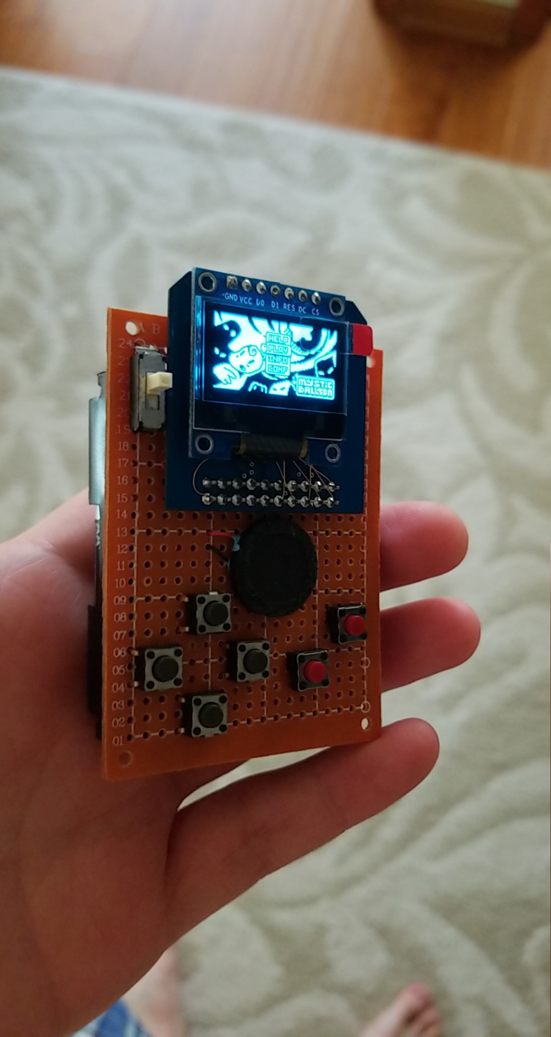

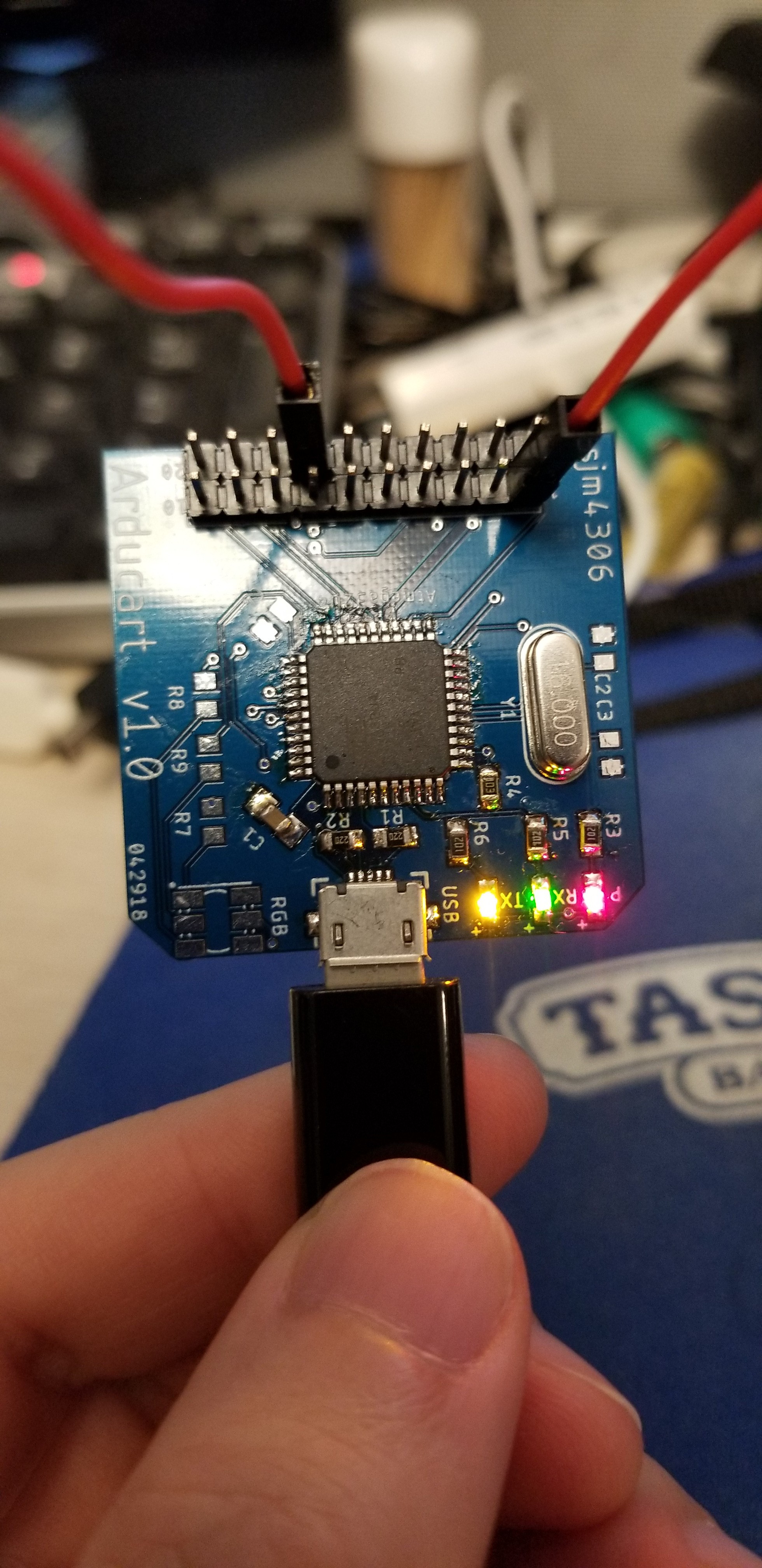

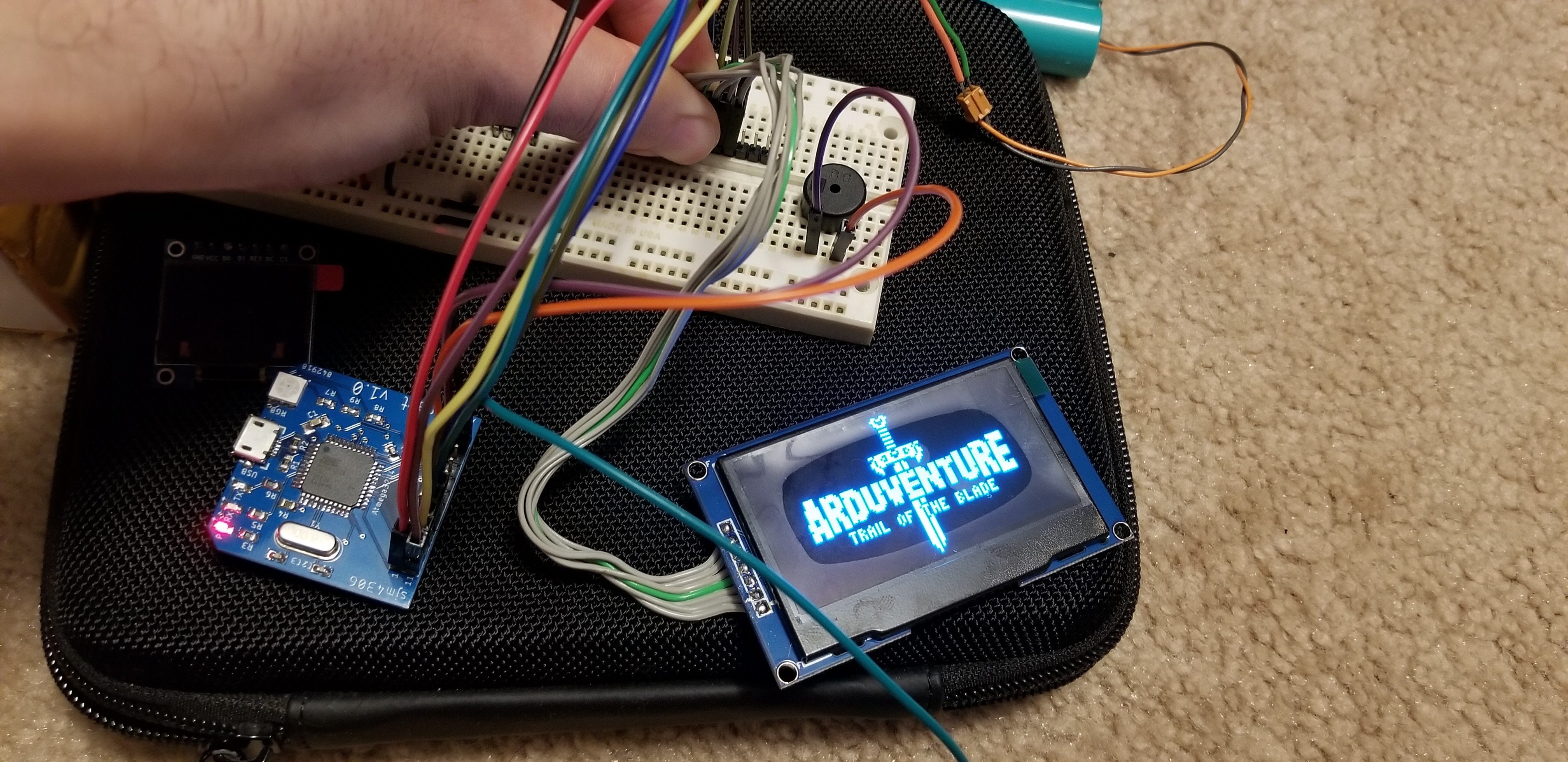

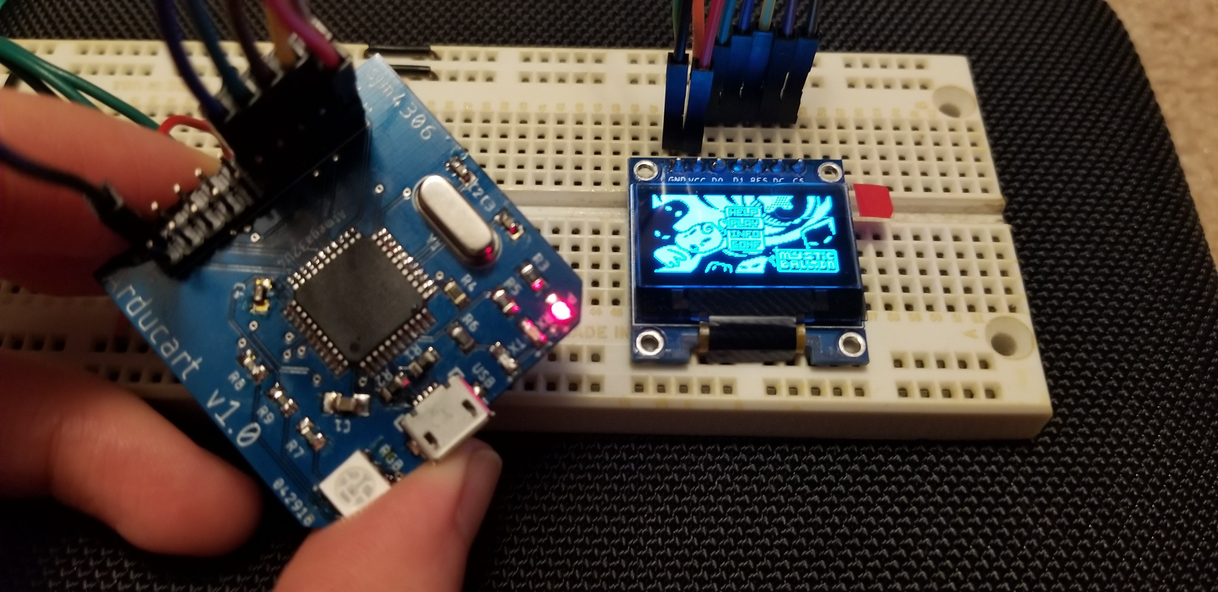

My homebrew clones served to improve on what I felt were a few shortcomings of the official hardware. Namely the original model's lack of swappable games and adding a much larger SD1309 display through my ArduCart Project:
The idea was to move the processing to a removable cart and the main console would only need power...
