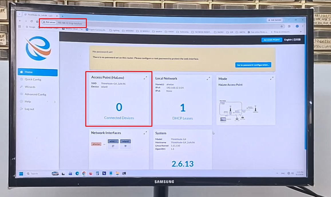

 In my case it is 192.168.12.1. Now we type that address into the web browser, then login and the status display appears.

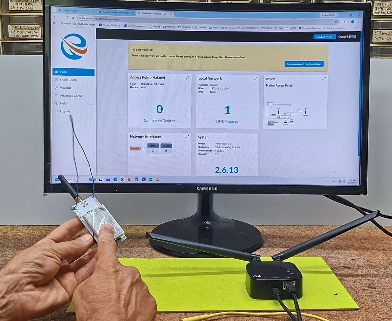

 Now, we need to connect the Halow device to this AP and that's the camera halo module. Next is the setup of the ESP32 WiFi Halow Module with Camera: First of all, let me mention that this module comes factory pre-installed with the camera web server firmware needed for this particular example. However, if we connect the module, we will notice that the blue LED on the gateway remains off, which means that it is not connecting to the gateway. We will see the reason for this below.

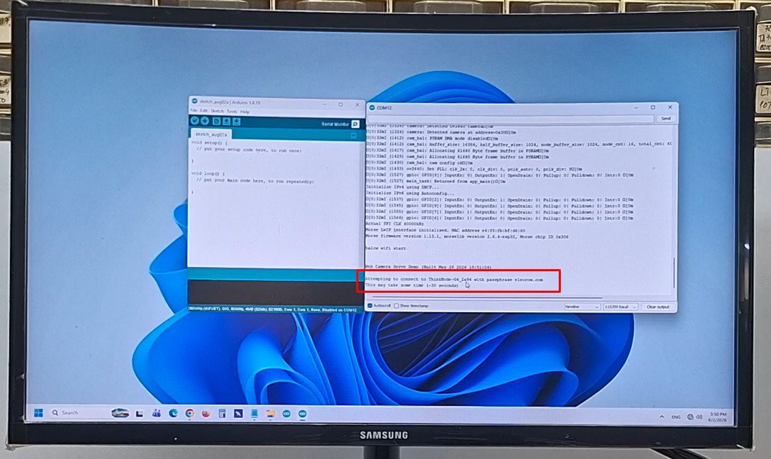

 I connect the device with a USB cable to the PC. In the Device Manager, I look at which port the device is connected to (in my case it is COM6). Now I start Arduino IDE and select COM6, then activate the serial monitor with Baudrate 115200.
There appears a longer text that shows that the camera is trying to connect to the Gateway with the name: "ThinkNode-G4_2a94" and password: "elecrow.com", and as we saw previously when setting up the Gateway, the name was different from this. So the simplest thing to do is to change the name of the Gateway through the wizard and confirm the password "elecrow.com". After this change, the camera should automatically connect to Gateway.

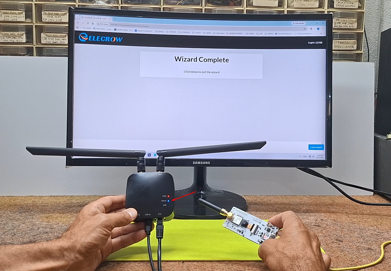

  In the web browser, enter the address 192.168.12.1 and in the menu go to "Wizards" and select "Standard WiFi Halow". There we change the SSID to "ThinkNode-G4_2a94" and enter the password "elecrow.com". After pressing Next, select NONE again, then next, next, and apply. Now I connect the camera module to power and for a short time the blue "Link" LED on the Gateway should light up.

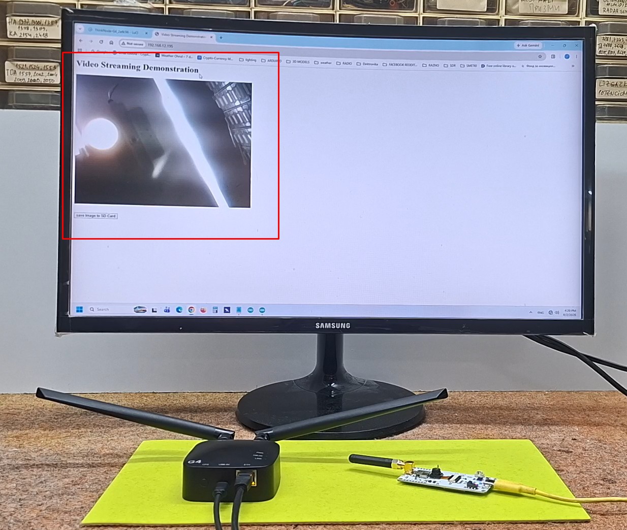

 This means that the camera is connected to the Gateway. Now we just need to open the serial monitor in the Arduino IDE, reset the camera module, and read what address the camera module is getting. In my specific case, the address of the camera is: 192.168.12.195. Now enter http://192.168.12.195/ in the Web Browser and the camera image appears on the screen.
 If we have an SD card installed on the module, by pressing "save image to SD Card" we save the current image. Now on the Wi-Fi Halow module, I mounted a Lithium battery that can be charged via the USB-C connector.

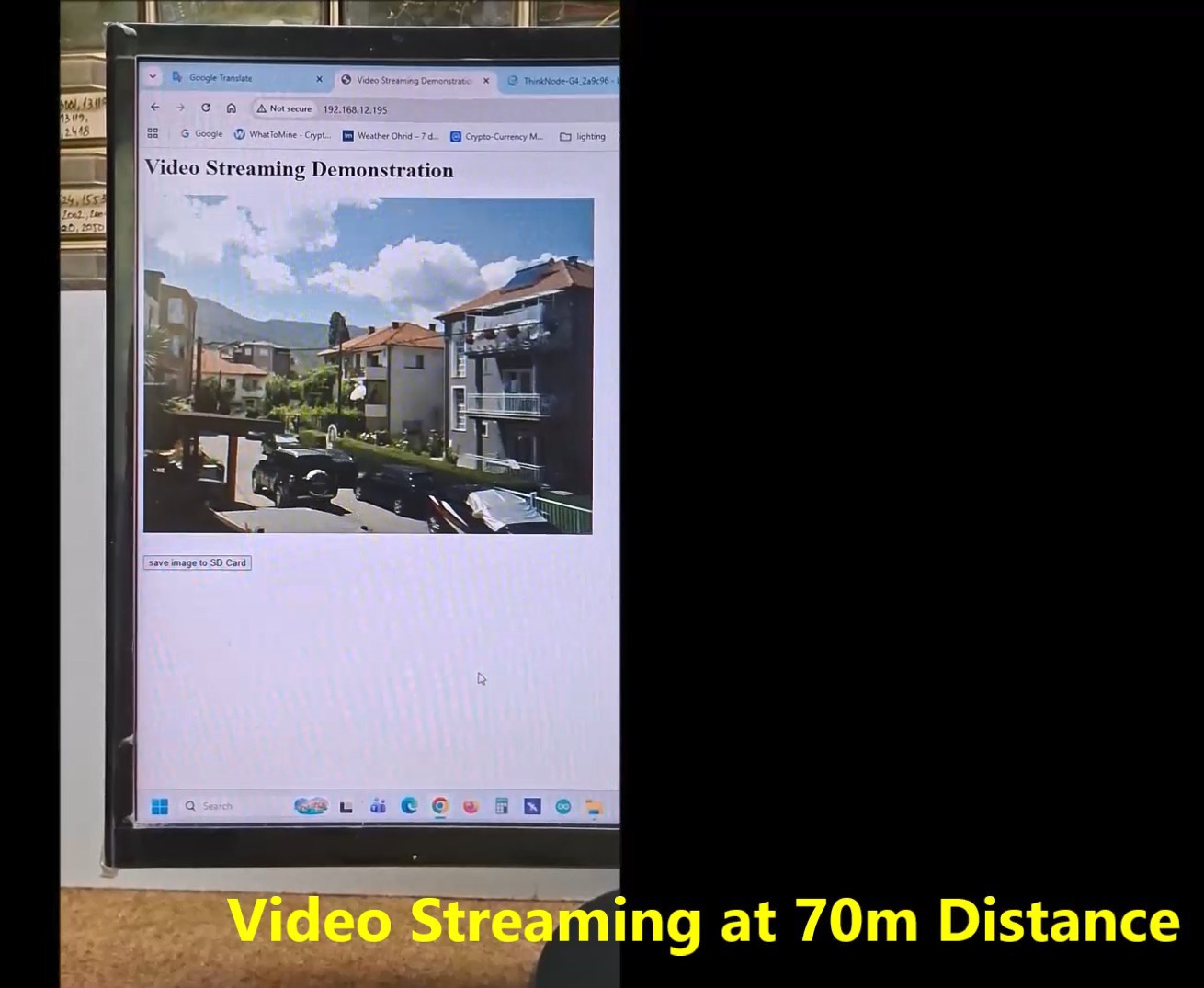

  This is a charging LED, then a power LED, and in the middle is a blue DATA LED that signals when the camera is connected to the Gateway. I also installed a wire as a support so that I can temporarily mount the module. Now I will take the camera outside at a distance of about twenty to thirty meters to test it. Next, I will mount the camera at a distance of 70m, with several obstacles between the camera and the Gateway, including a building to test how the signal passes through multiple walls. Here is what the received signal looks like
