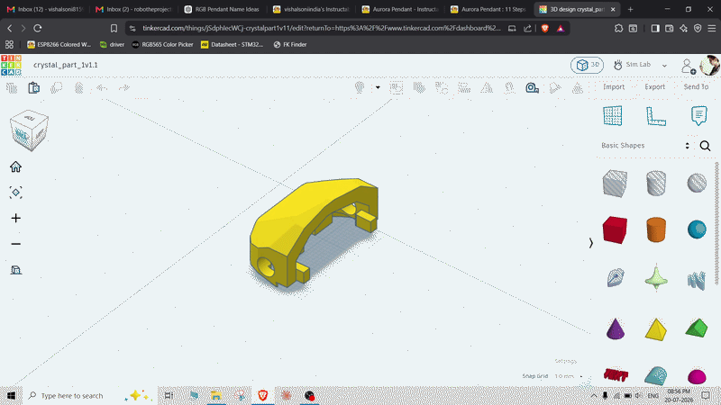

Designing the Pendant in Tinkercad

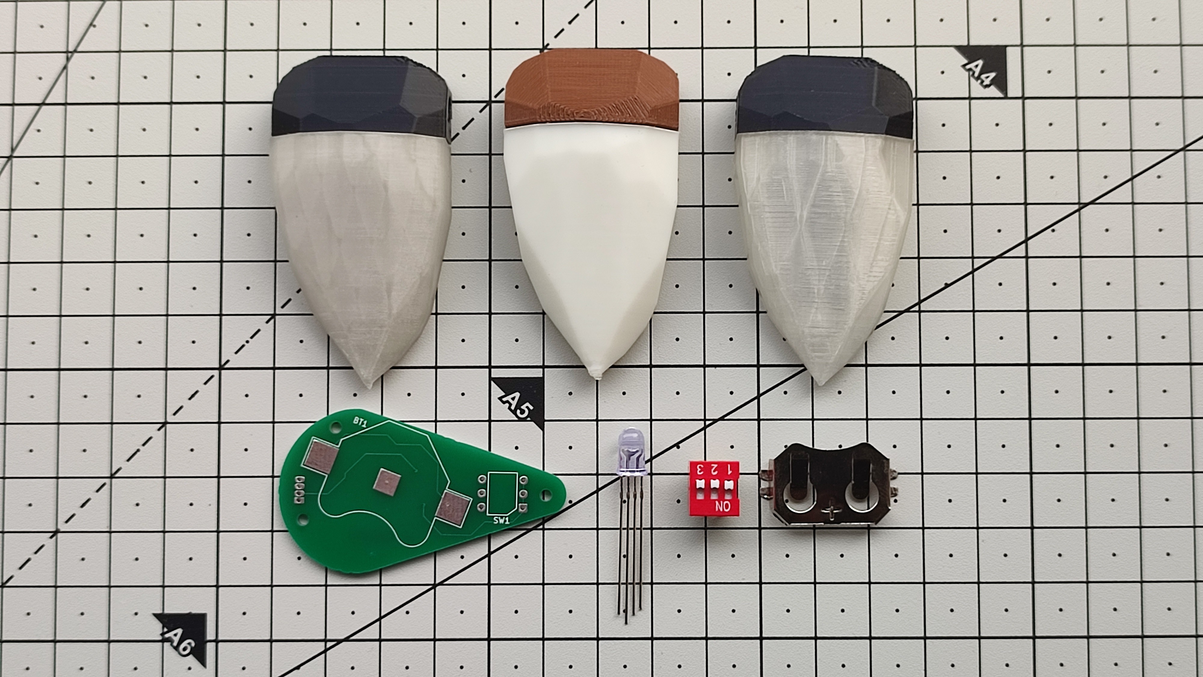

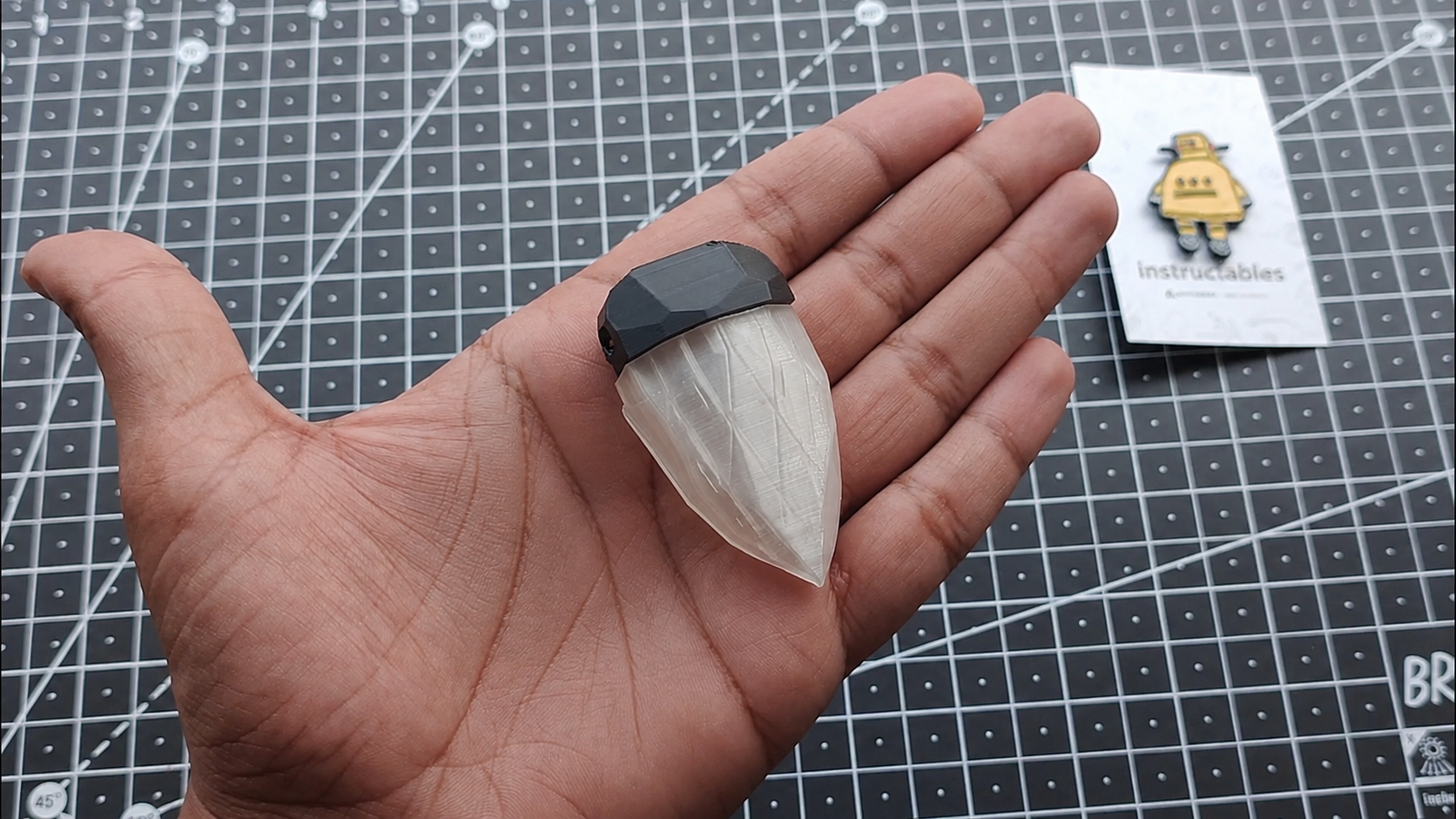

I designed the 3D enclosure for the Aurora Pendant using Tinkercad, a free, browser-based 3D design tool that is perfect for beginners. Its simple drag-and-drop interface makes it easy to create functional designs without any prior CAD experience, making it an excellent choice for makers and hobbyists.
The enclosure is designed in two separate parts, giving the pendant a cleaner and more premium appearance while making assembly straightforward. I chose a crystal-inspired shape so the finished pendant looks more like a piece of jewelry rather than an electronic gadget.
The upper part includes a small hole for attaching a string, chain, or necklace so the pendant can be comfortably worn. Inside the enclosure, I added dedicated mounting points for heat-set inserts, allowing the PCB to be securely fastened with screws. This not only keeps the electronics firmly in place but also makes the pendant easy to disassemble for battery replacement or future modifications.

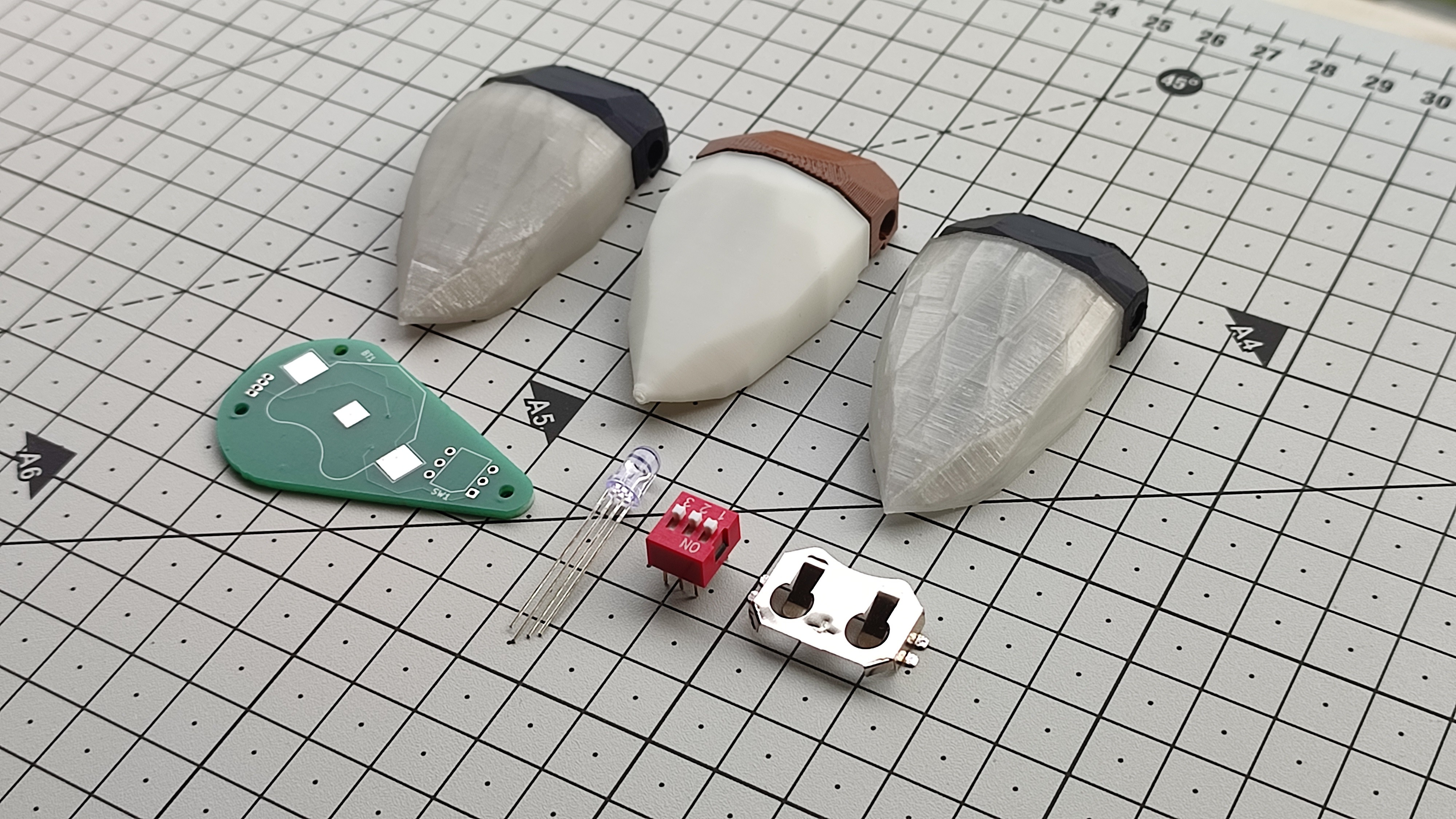

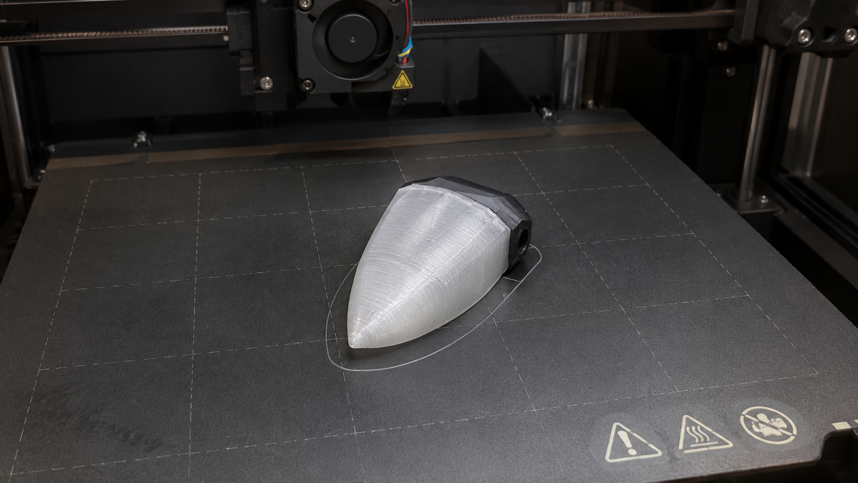

3D Printing the Enclosure
Printing Details:
- Nozzle: 0.1 mm (for fine detail and smooth finish)
- Infill: 20>#/b### (strong yet lightweight)
- Material: ABS – Black (durable, heat-resistant, and gives a professional look)
To see how the enclosure would affect the appearance of the pendant, I 3D printed it in two different materials. One version was printed in solid white PLA, while the other was printed in semi-transparent PLA to experiment with light diffusion.
The white enclosure gives the pendant a clean, modern look and hides the internal electronics completely. In contrast, the semi-transparent enclosure allows the RGB LED light to spread more evenly throughout the body of the pendant, creating a softer, crystal-like glow.
Printing both versions was a fun experiment that helped me compare their overall aesthetics, brightness, and light diffusion. You can choose the version you like best—or print both and decide for yourself!

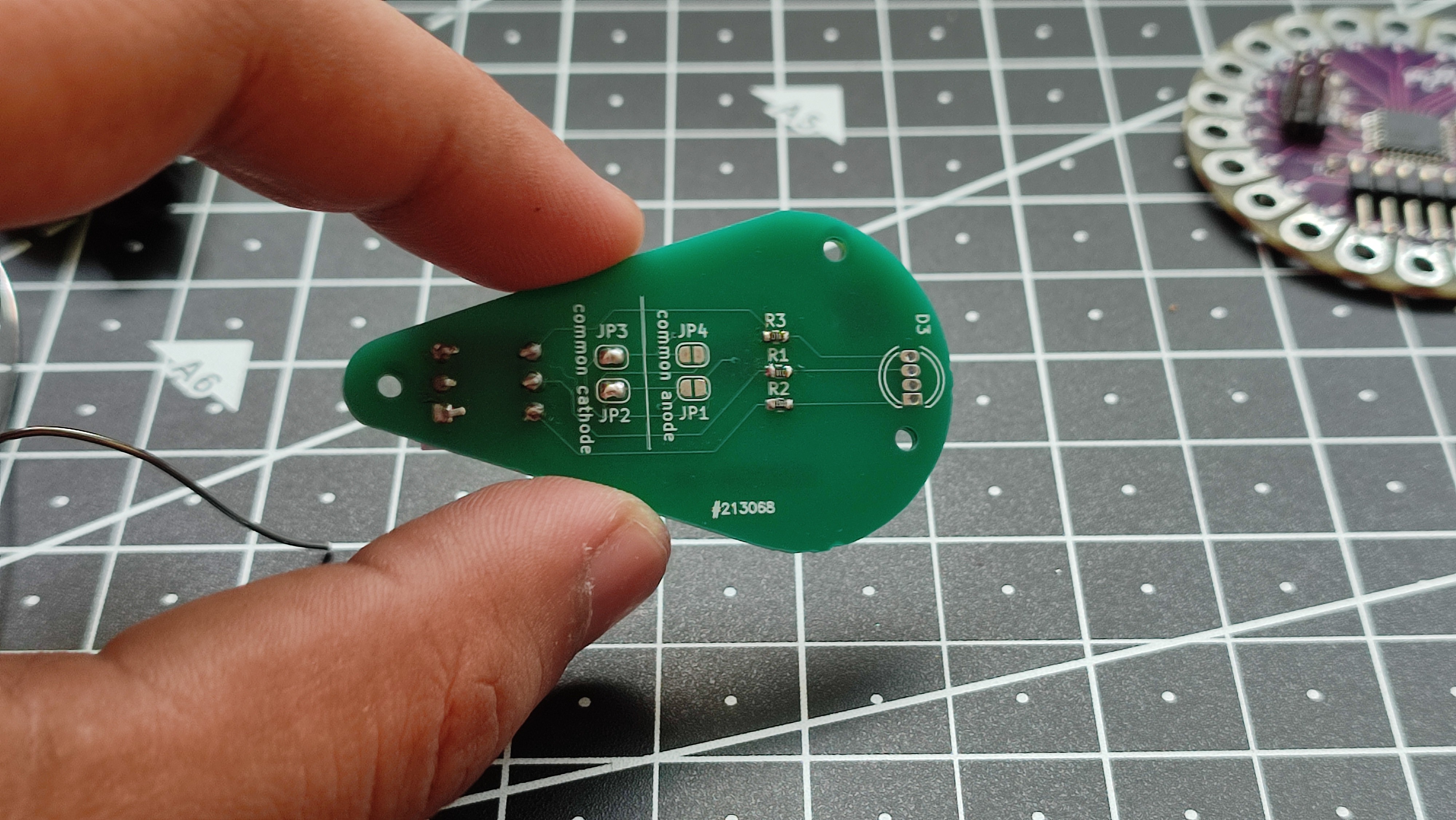

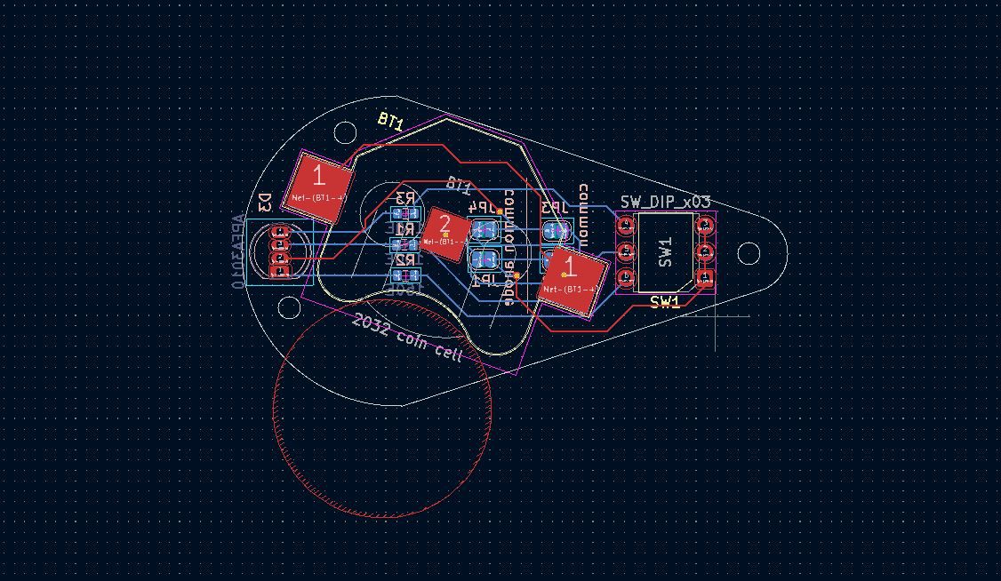

PCB Design

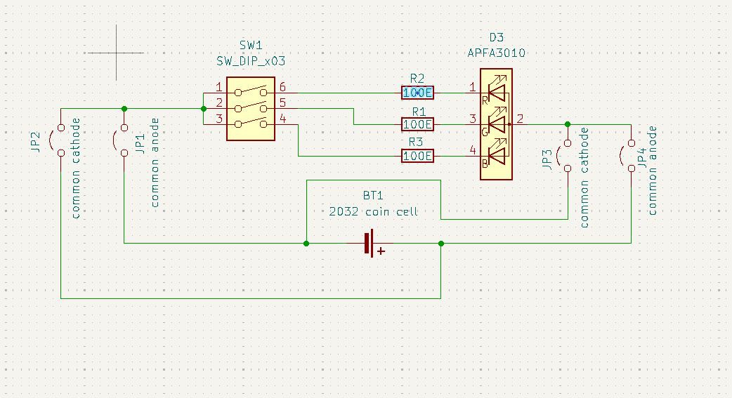

I designed the PCB for the Aurora Pendant using KiCad, a powerful and free open-source PCB design software. I started by creating the schematic, where I connected all the electronic components and verified that the circuit functioned correctly. Once the schematic was complete, I assigned the appropriate footprints to every component before moving on to the PCB layout.
One feature I really like about KiCad is its 3D modeling support. I imported the 3D models of the major components, which allowed me to visualize the completed PCB and ensured that everything would fit perfectly inside the 3D-printed enclosure. This made designing the enclosure much easier and helped avoid mechanical fitting issues before manufacturing the PCB.
To make the project as flexible as possible, I also added two solder jumpers for Common Anode LEDs and two solder jumpers for Common Cathode LEDs. By simply bridging the appropriate jumpers, builders can use either type of RGB through-hole LED, depending on what is available in their local market. This small addition makes the PCB more versatile and beginner-friendly, eliminating the need to search for a specific LED type.

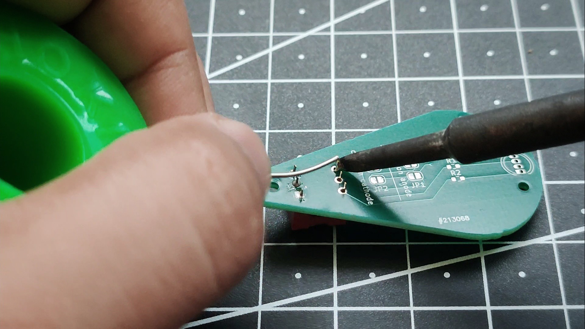

Dip Switch & Resistor Soldering
We'll begin by soldering the 3-position DIP switch. Insert the switch into the PCB as shown in the image, making sure it is oriented correctly. Pay close attention to the "ON" marking on the switch, as it should face the correct direction according to the PCB silkscreen. Once the switch is properly seated, flip the PCB over and solder all six pins, ensuring each joint is clean and shiny.
Next, solder the three 100 Ω resistors onto their respective resistor pads. These resistors limit the current flowing through the Red, Green, and Blue channels of the RGB LED, helping to protect the LED while providing balanced brightness.
If you find that the LED is too bright or too dim, feel free to experiment with different resistor values. Lower resistance will increase the LED brightness (while drawing more current), whereas higher resistance will reduce the brightness and extend the battery life. This gives you the flexibility to customize the pendant's appearance to your preference.

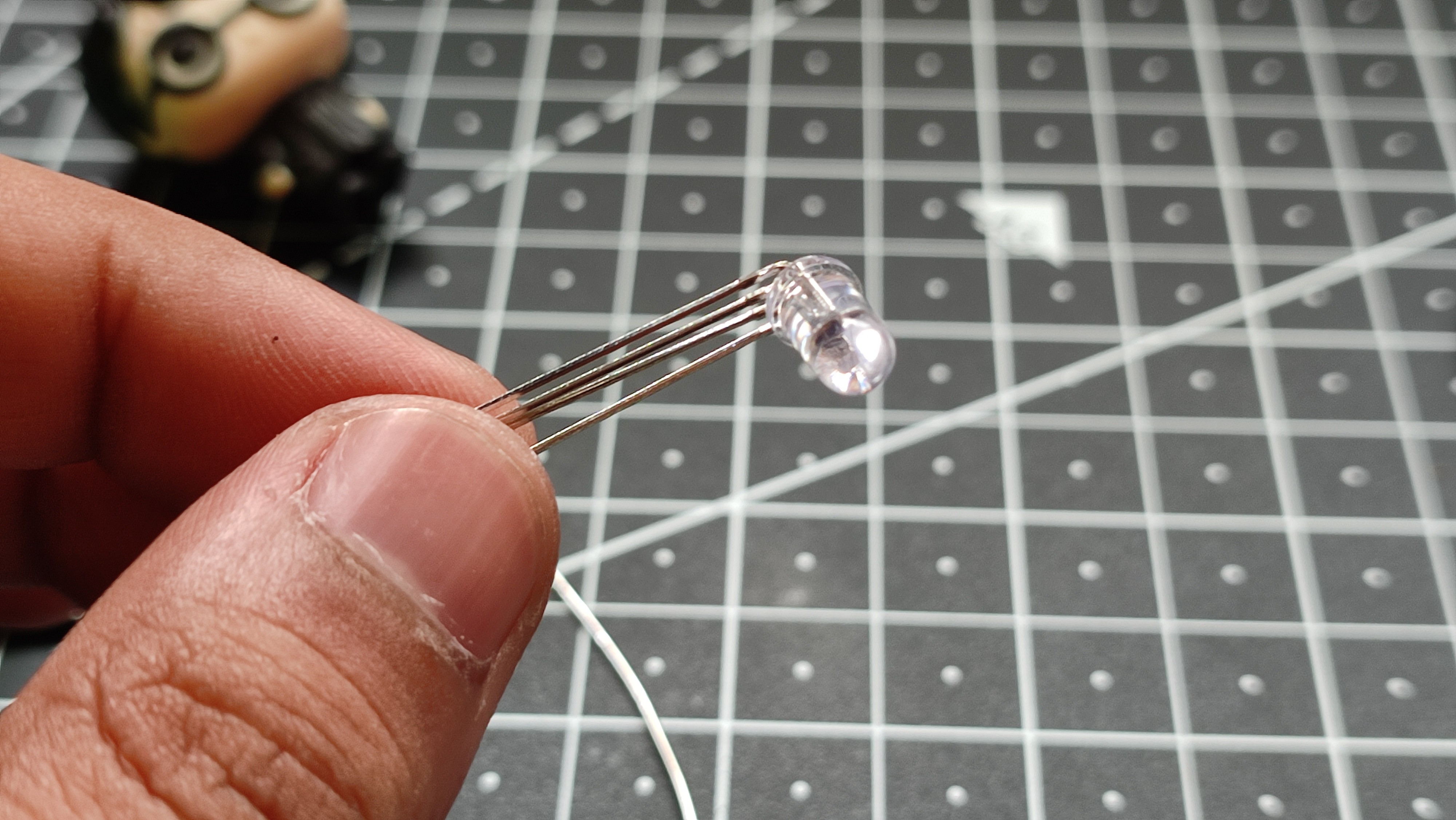

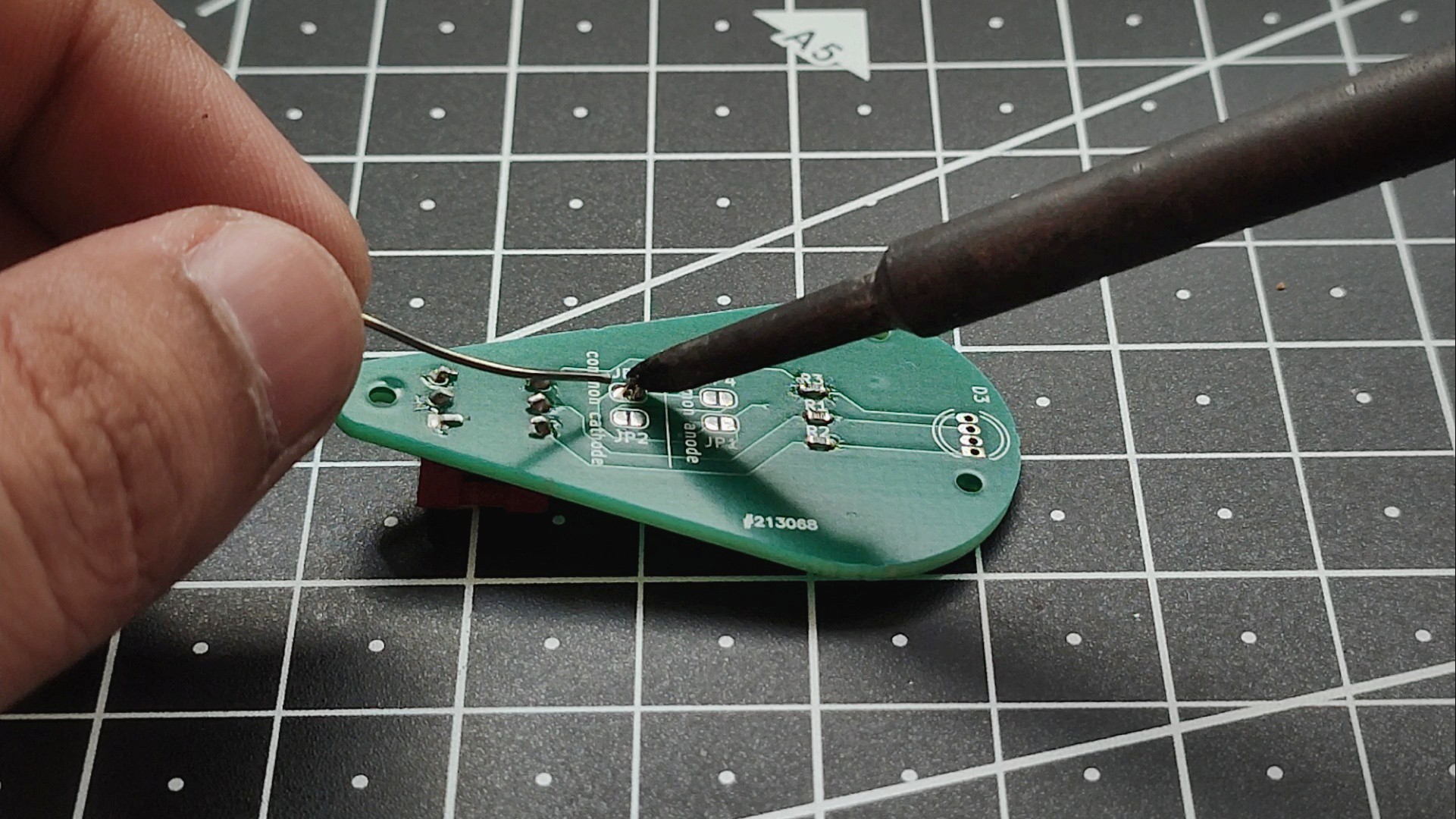

RGB LED Soldering
Before soldering the RGB LED, you must first solder the appropriate LED jumper pads on the PCB. Since I am using a Common Cathode RGB LED, I bridged the two Common Cathode jumpers, as shown in the image. If you are using a Common Anode RGB LED, simply solder the Common Anode jumpers instead. Selecting the correct jumpers is essential for the LED to operate properly.

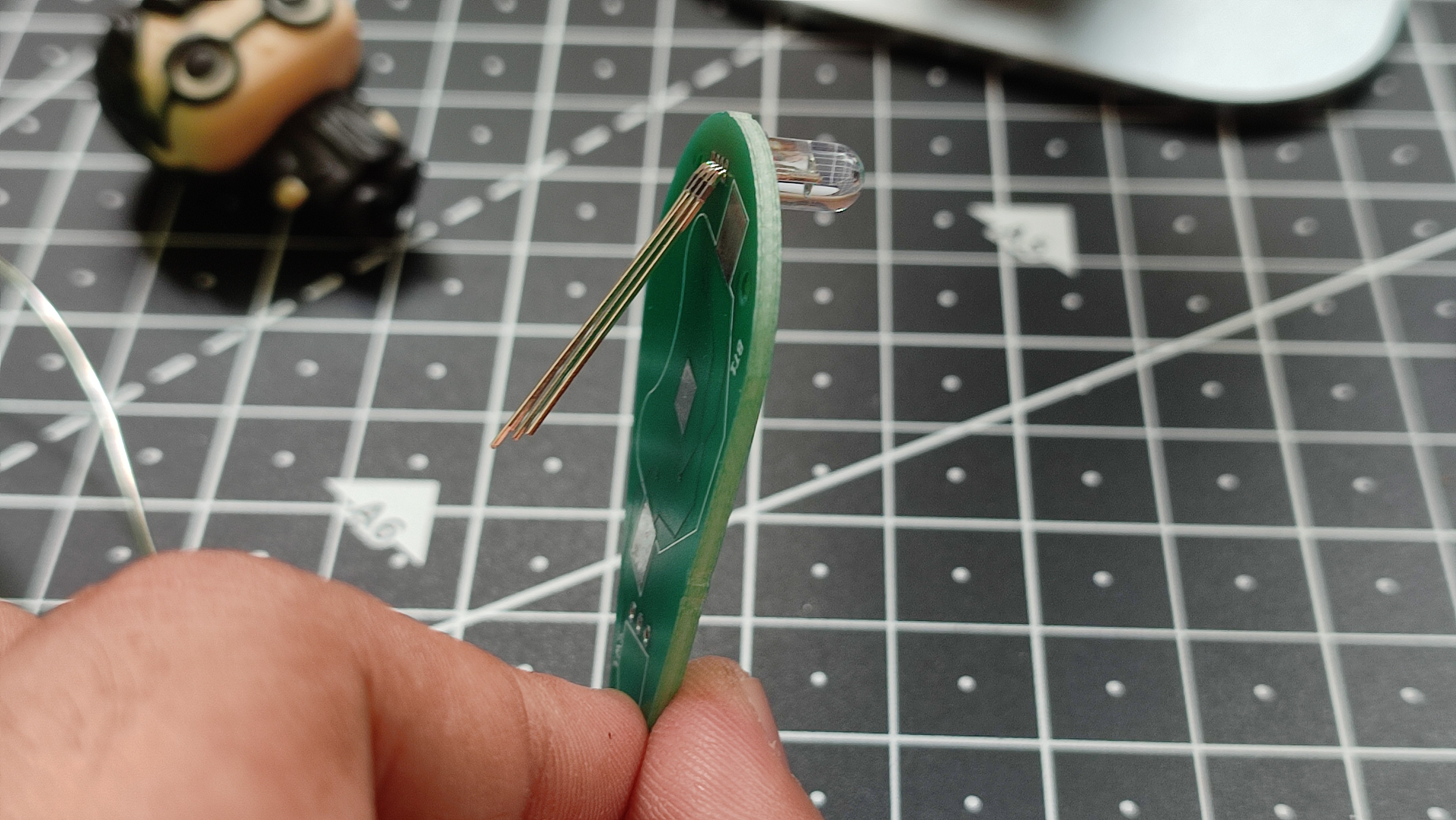

Next, prepare the RGB LED by carefully bending all four leads to a 90° angle, as shown in the image. This allows the LED to sit horizontally inside the pendant enclosure.
Insert the LED into the PCB with the LED dome facing downward, exactly as shown in the reference image. Double-check that the pins are aligned with the correct holes before soldering.
Once the LED is positioned correctly, solder each of the four leads one by one, making sure every solder joint is neat and secure. After all the connections are complete, use a flush cutter to trim the excess leads from the back of the PCB, leaving a clean and professional finish.

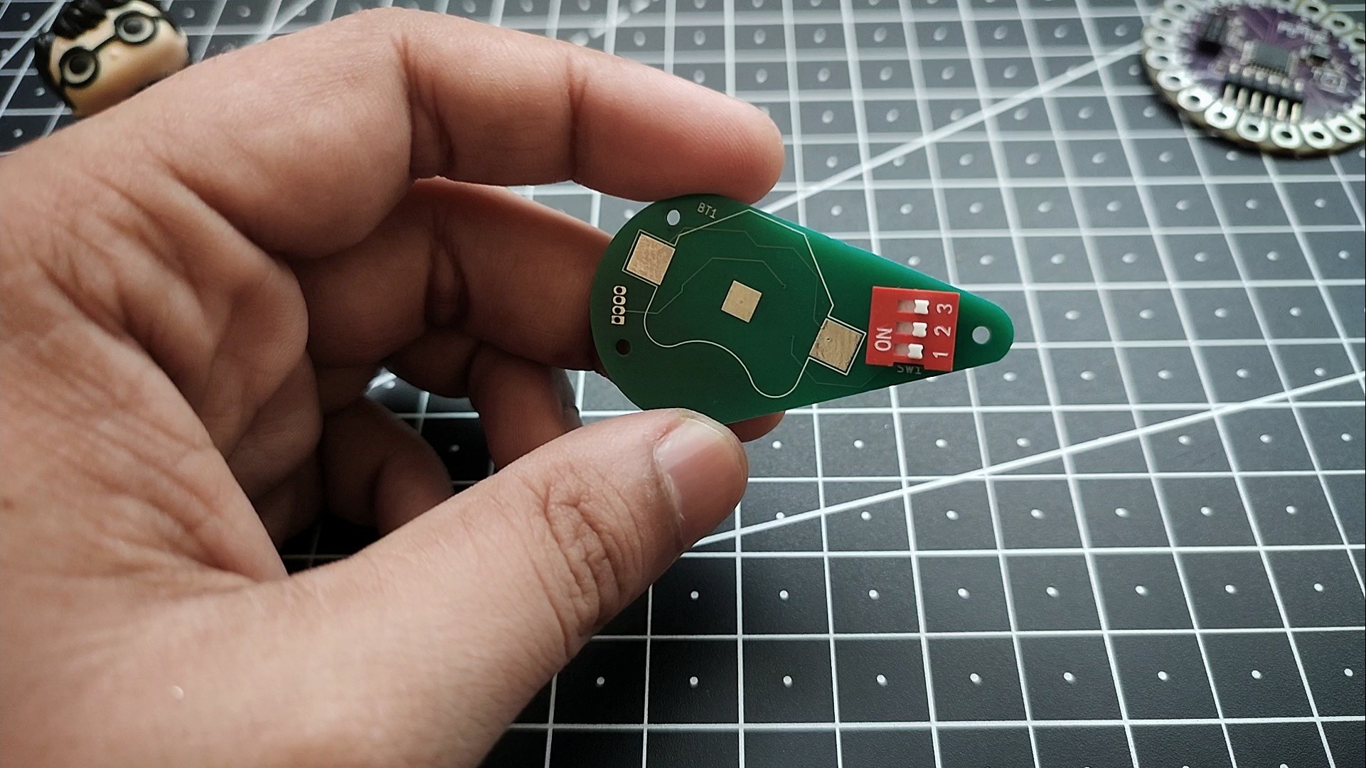

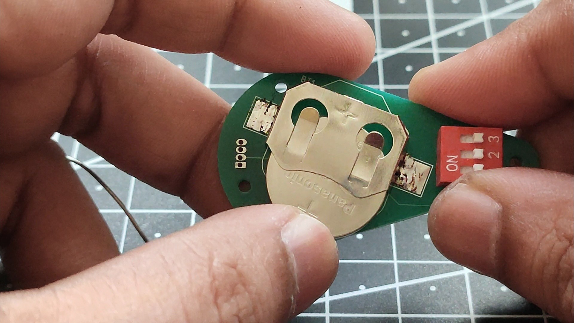

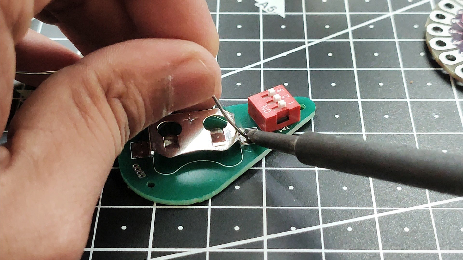

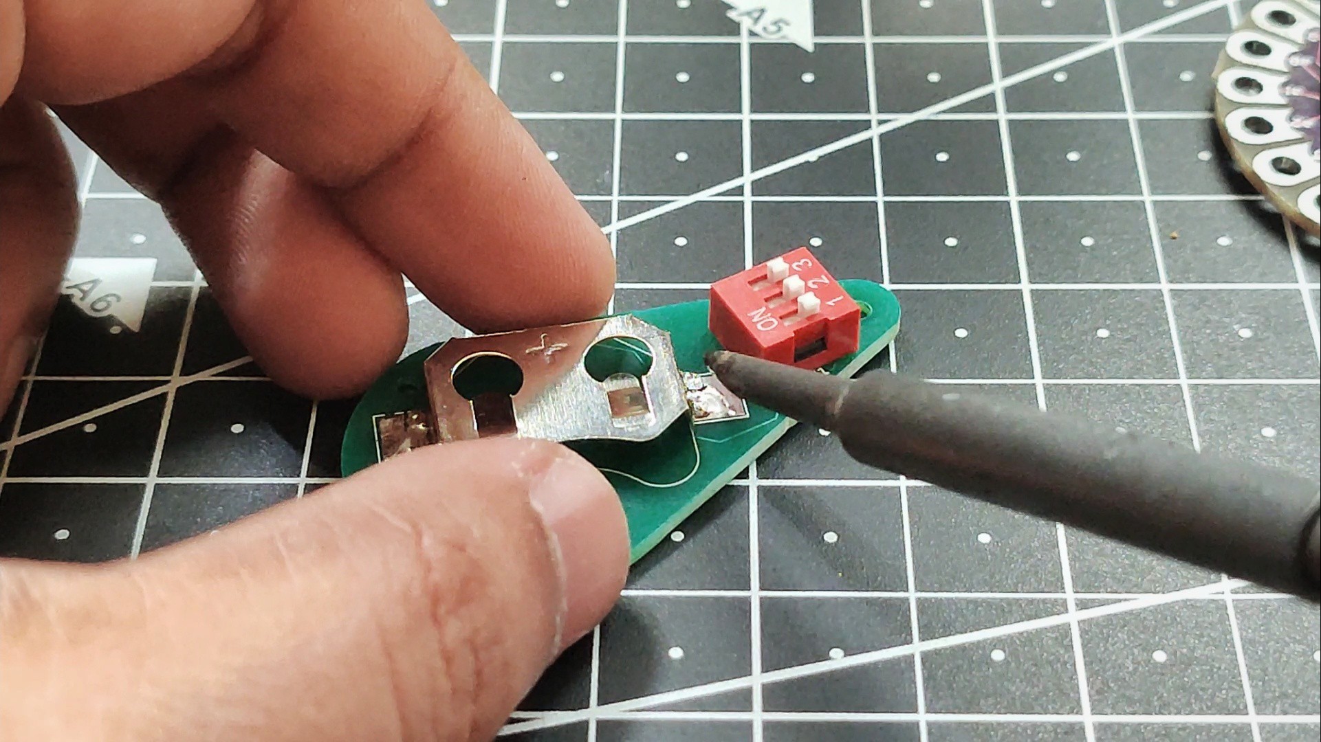

Cell Holder Soldering
The final component to solder is the CR2032 battery holder. Place the holder onto the PCB, making sure it is aligned correctly with the footprint and sits flat against the board.
To keep it securely in place, solder one of the mounting legs first. This will hold the battery holder firmly while you check its alignment. If necessary, reheat the solder joint and adjust the position before soldering the second mounting leg.
Once the holder is properly aligned, complete the remaining solder joints. Since the battery holder has large metal tabs, they can absorb a lot of heat, so you may need to keep the soldering iron on the joint a little longer than usual. Be careful, as the metal tabs can become very hot during soldering.
After all the joints are soldered, inspect them to ensure they are smooth, shiny, and securely attached. Your PCB is now fully assembled and ready for the battery and enclosure.

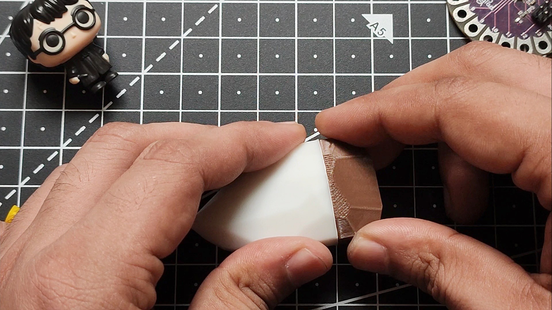

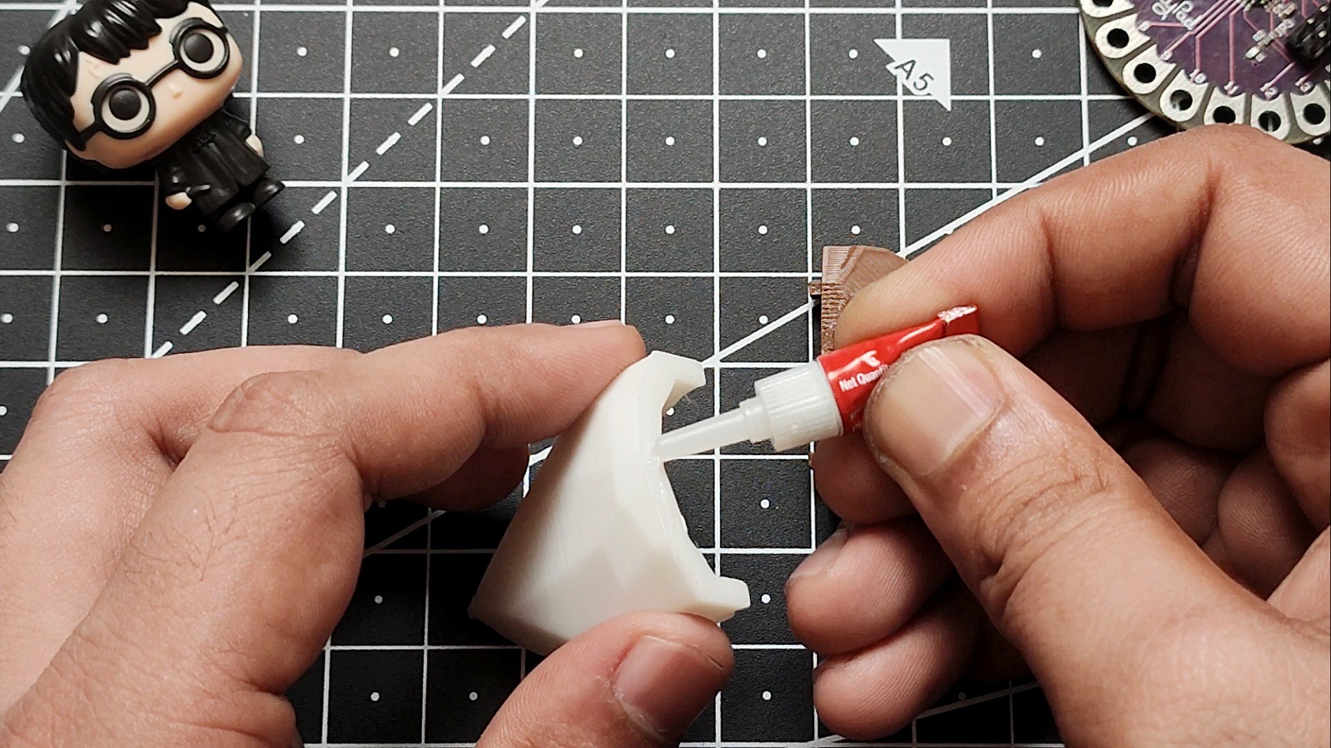

Glue 3D Printed Parts
Now it's time to join the two 3D-printed enclosure parts. Apply a small amount of super glue along the joining edge of the bottom part. Be careful not to use too much glue, as excess adhesive may squeeze out and affect the appearance of the pendant.
Carefully align the top part with the bottom enclosure and press the two pieces together. Make sure all the edges line up properly before the glue begins to set.
Hold the enclosure firmly for 20–30 seconds, or according to the curing time recommended for your super glue, to ensure a strong bond. Once the glue has cured, the enclosure will form a sturdy, crystal-shaped pendant ready for the final assembly.

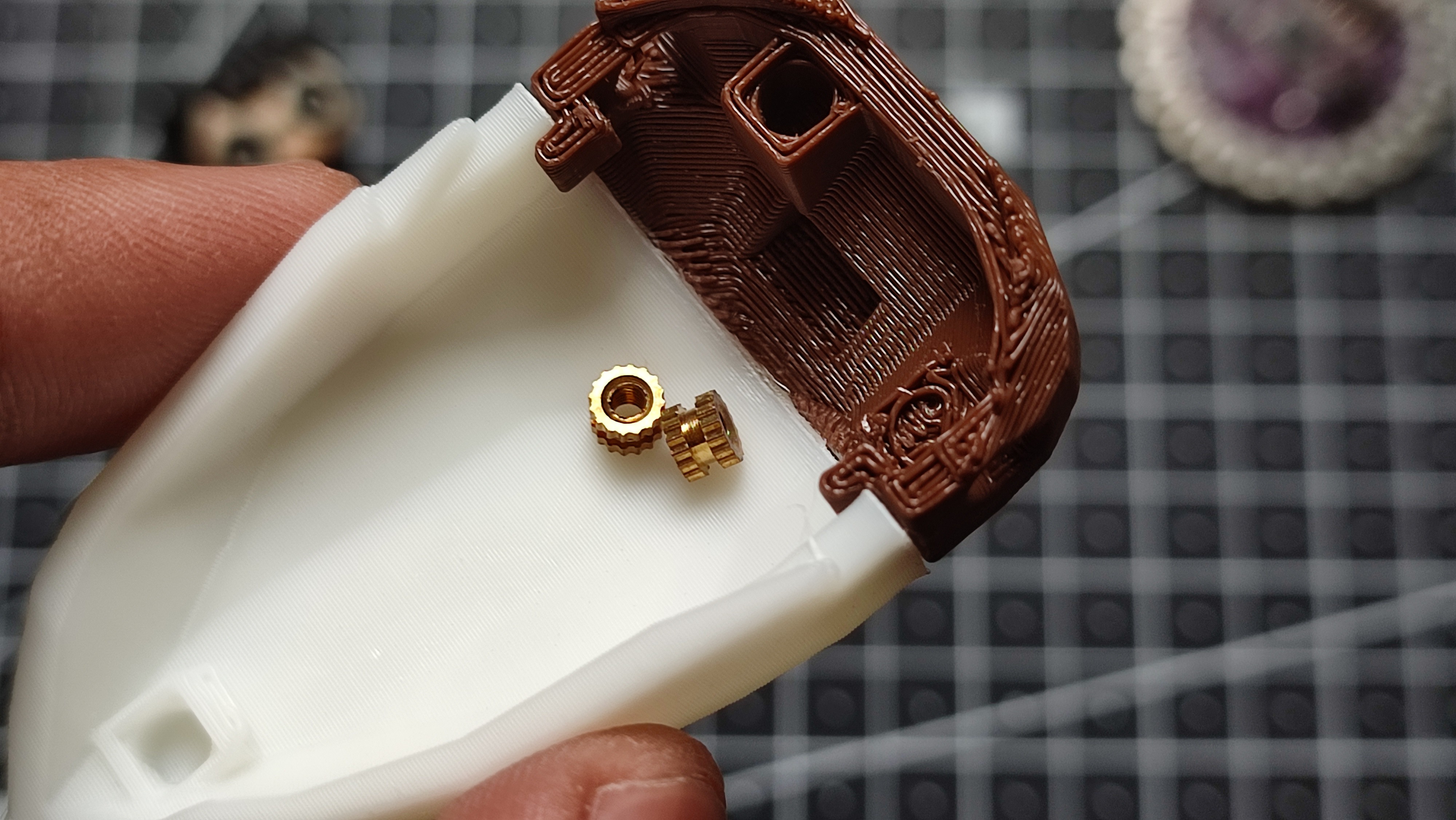

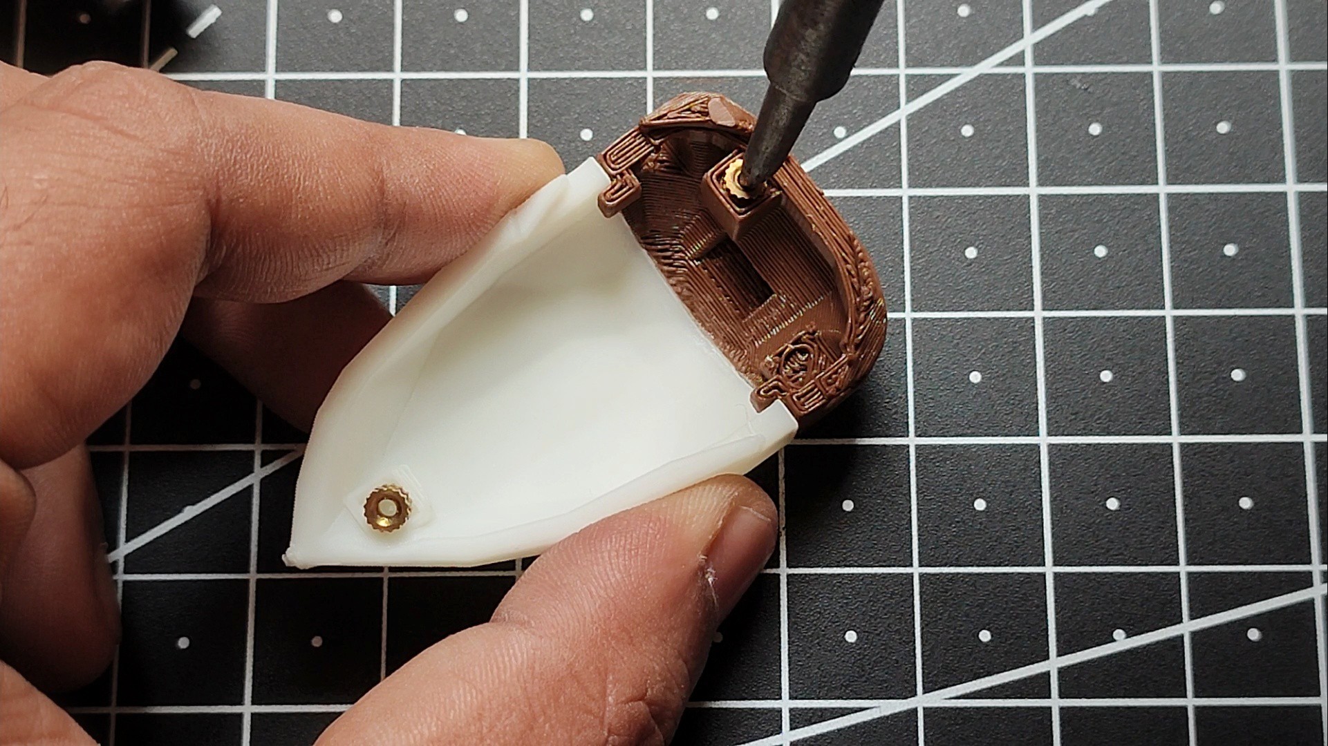

Heat Inserts

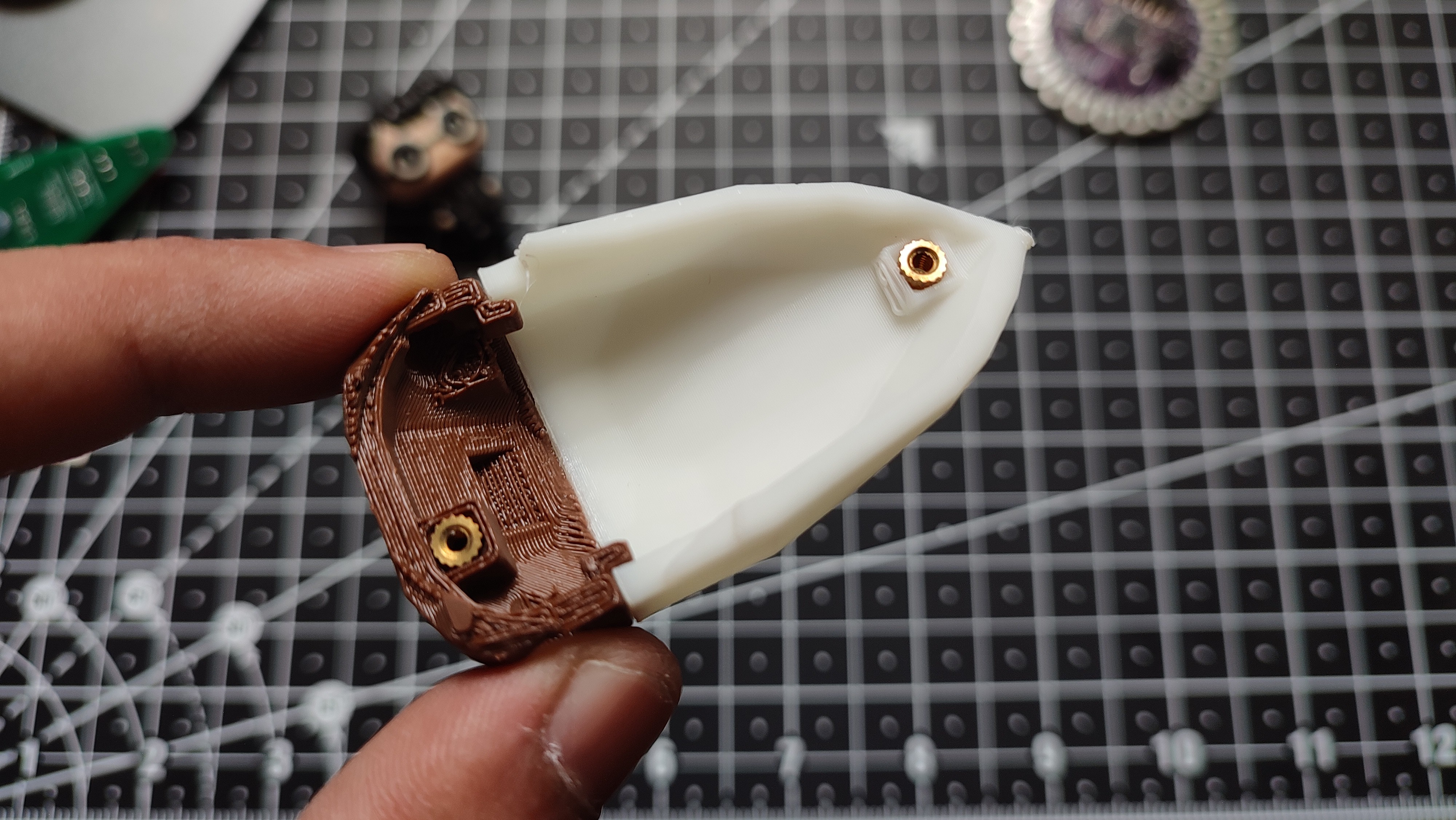

The next step is to install the heat-set inserts, which provide strong, durable threads for securing the PCB with screws.
Place a heat-set insert into each hole of the 3D-printed enclosure. Position the tip of your soldering iron on top of the insert and apply gentle, even pressure. As the insert heats up, it will slowly melt into the plastic and sink into its pocket.
Make sure to keep the soldering iron perfectly vertical while inserting it. If you notice the insert starting to tilt, gently adjust it before the plastic cools so that it sits straight and flush with the surface. A properly aligned insert will make it much easier to install the screws later.
Repeat the same process for the second heat-set insert, as shown in the image. Once the plastic has cooled, the inserts will be firmly locked in place, creating strong, reusable threads for the final assembly.

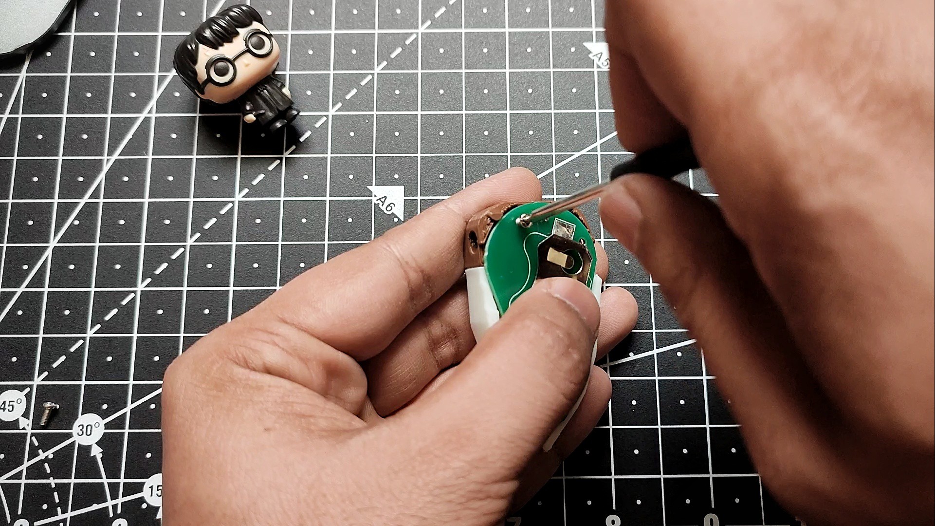

Screw PCB on 3D Print

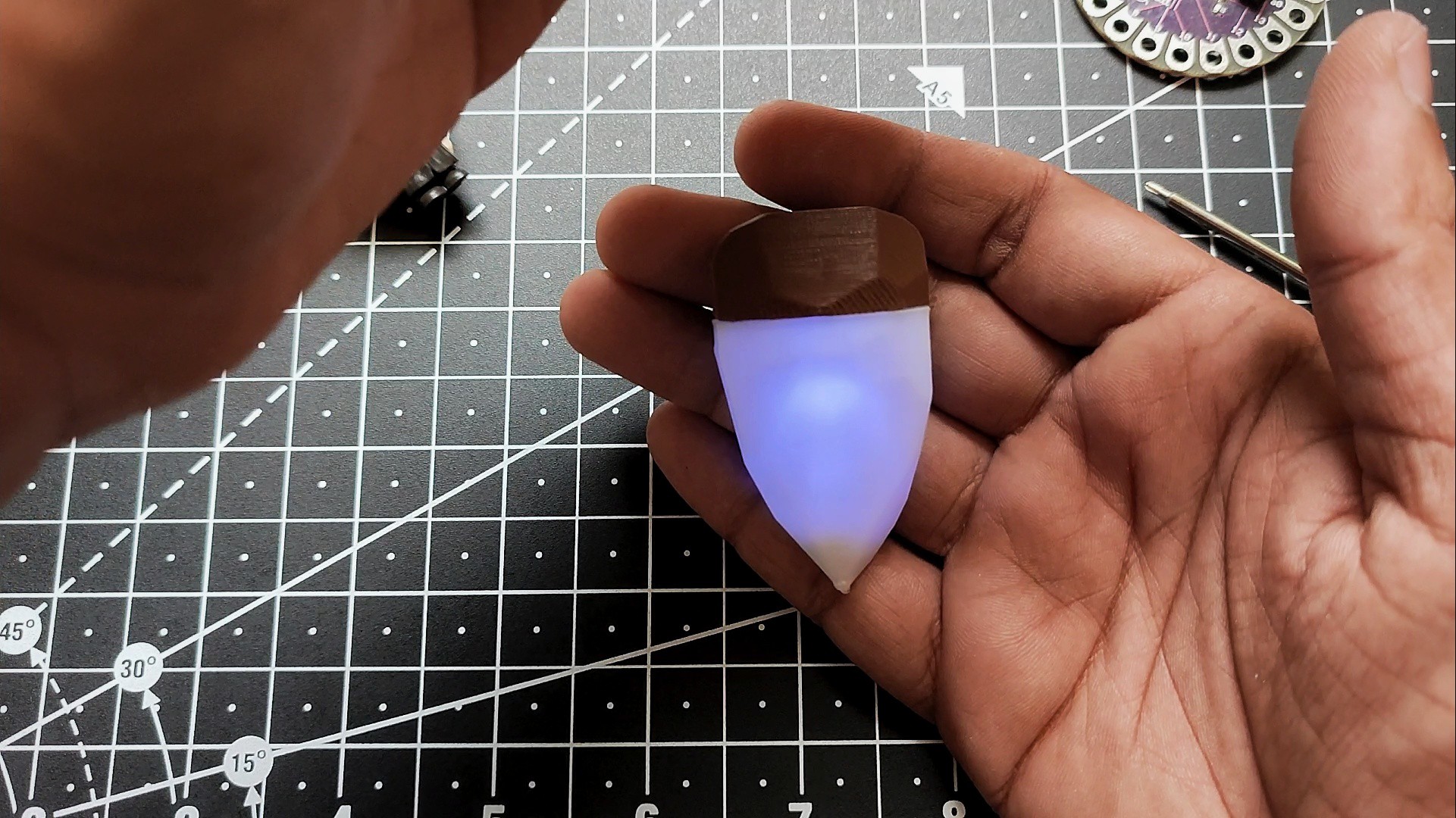

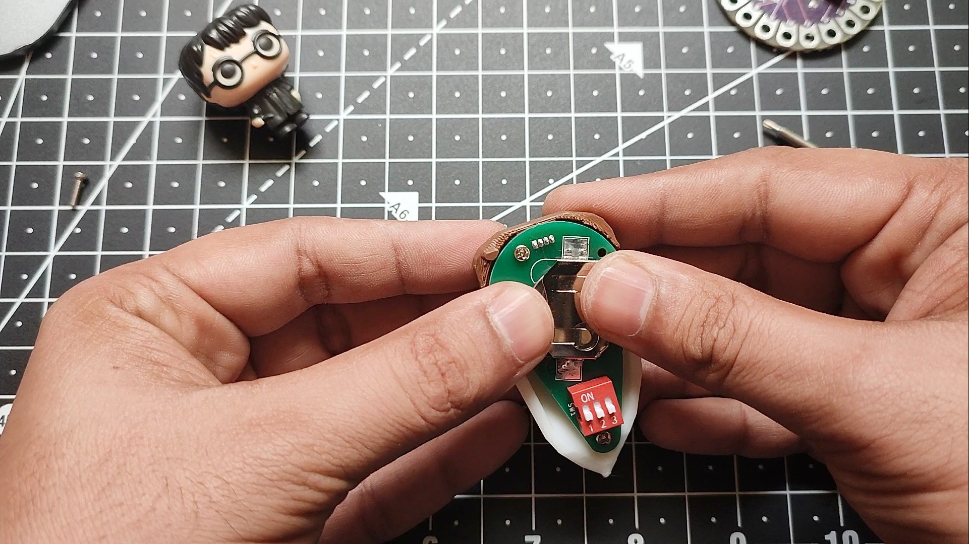

Now it's time for the final assembly of the Aurora Pendant.
Carefully place the assembled PCB inside the 3D-printed enclosure, making sure the RGB LED is properly aligned and the PCB sits flat on the mounting posts. Insert the M2 screws through the PCB mounting holes and tighten them into the heat-set inserts. Tighten the screws just enough to hold the PCB securely in place—avoid overtightening, as it may damage the enclosure or the PCB.
Next, insert the CR2032 coin cell battery into the battery holder, ensuring the positive (+) side is facing the correct direction, as marked on the holder.
Once the battery is installed, test the pendant by toggling the three DIP switches.

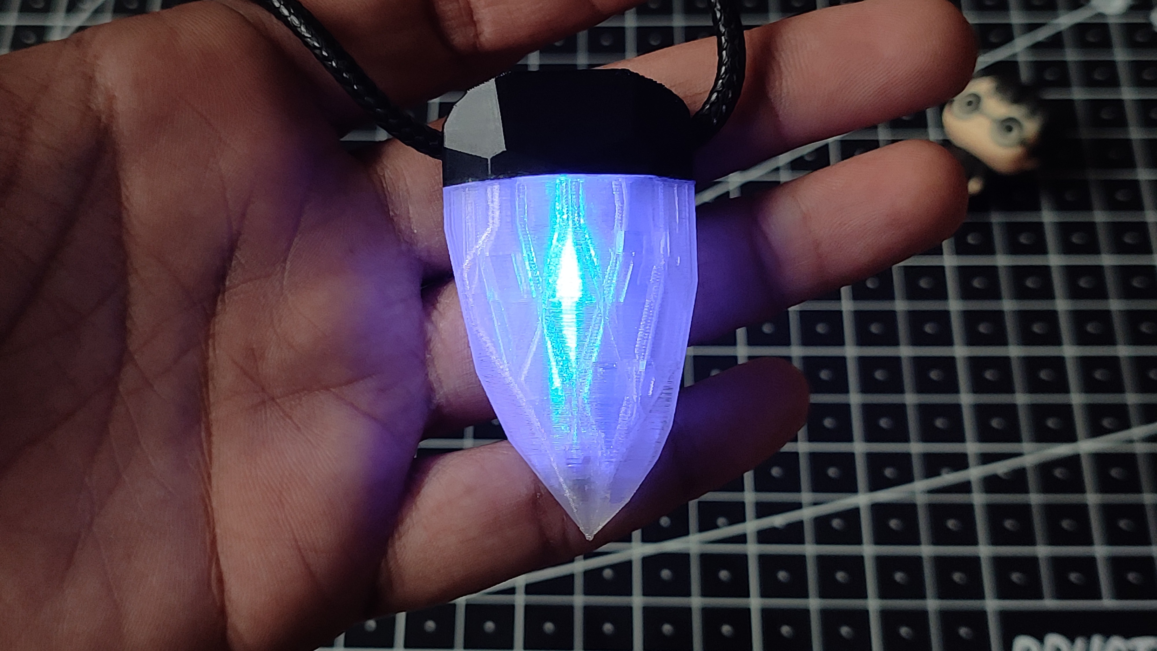

Using the Aurora Pendant is incredibly simple. On the back of the pendant, you'll find three DIP switches, with each switch controlling one color of the RGB LED:
- Switch 1 controls the Red LED.
- Switch 2 controls the Blue LED.
- Switch 3 controls the Green LED.
By turning the switches ON or OFF, you can mix the three primary colors to create 7 different color combinations (excluding the all-off state).
- Switch 1 ON → Red
- Switch 2 ON → Blue
- Switch 3 ON → Green
- Switch 1 + Switch 2 ON → Magenta (Red + Blue)
- Switch 1 + Switch 3 ON → Yellow (Red + Green)
- Switch 2 + Switch 3 ON → Cyan (Blue + Green)
- Switch 1 + Switch 2 + Switch 3 ON → White (Red + Blue + Green)
Simply flip the switches to create your favorite color combination and match the pendant with your outfit, mood, or occasion. There is no programming, mobile app, or charging required—just insert the battery, toggle the switches, and enjoy your custom-colored pendant!

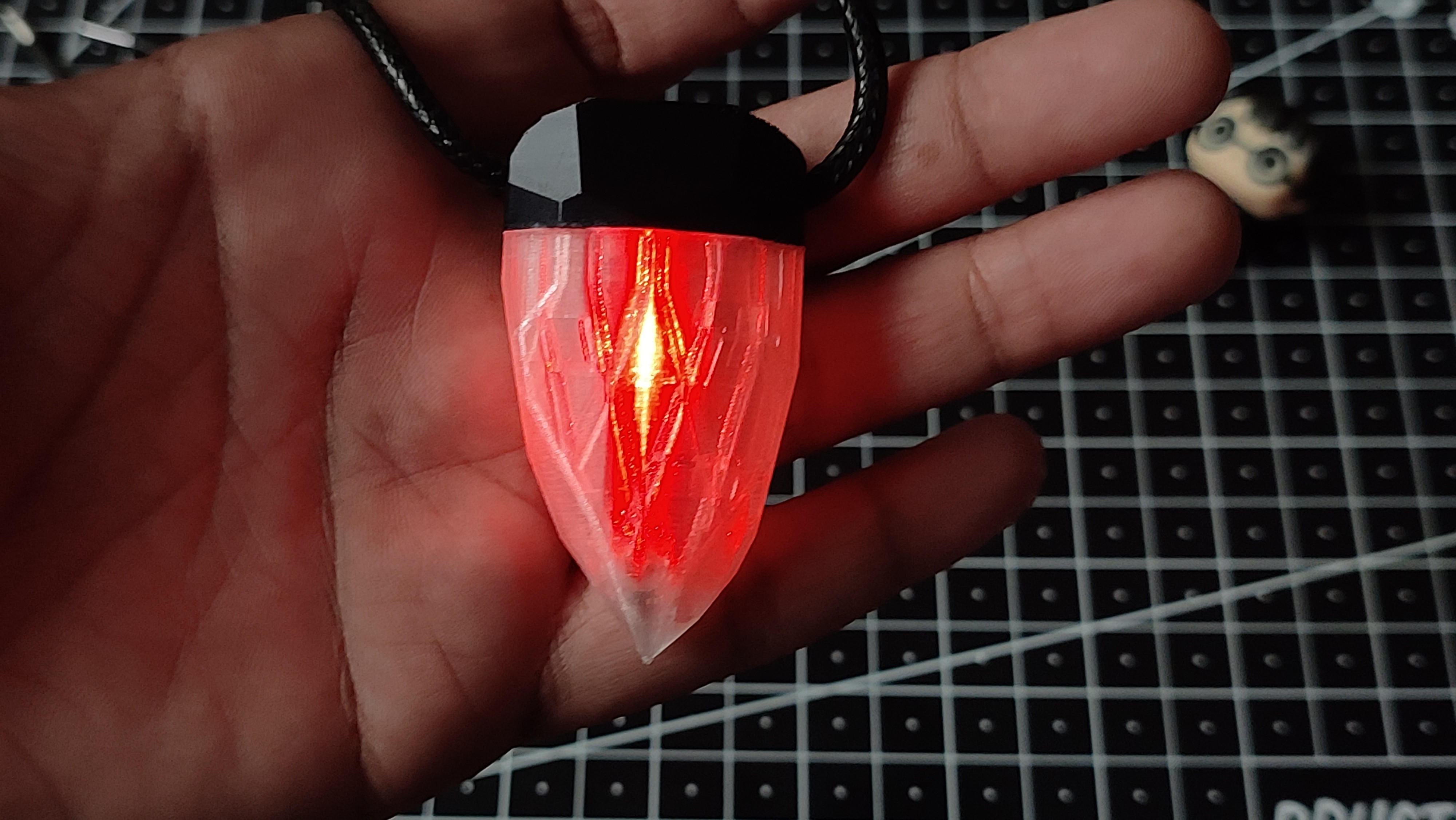

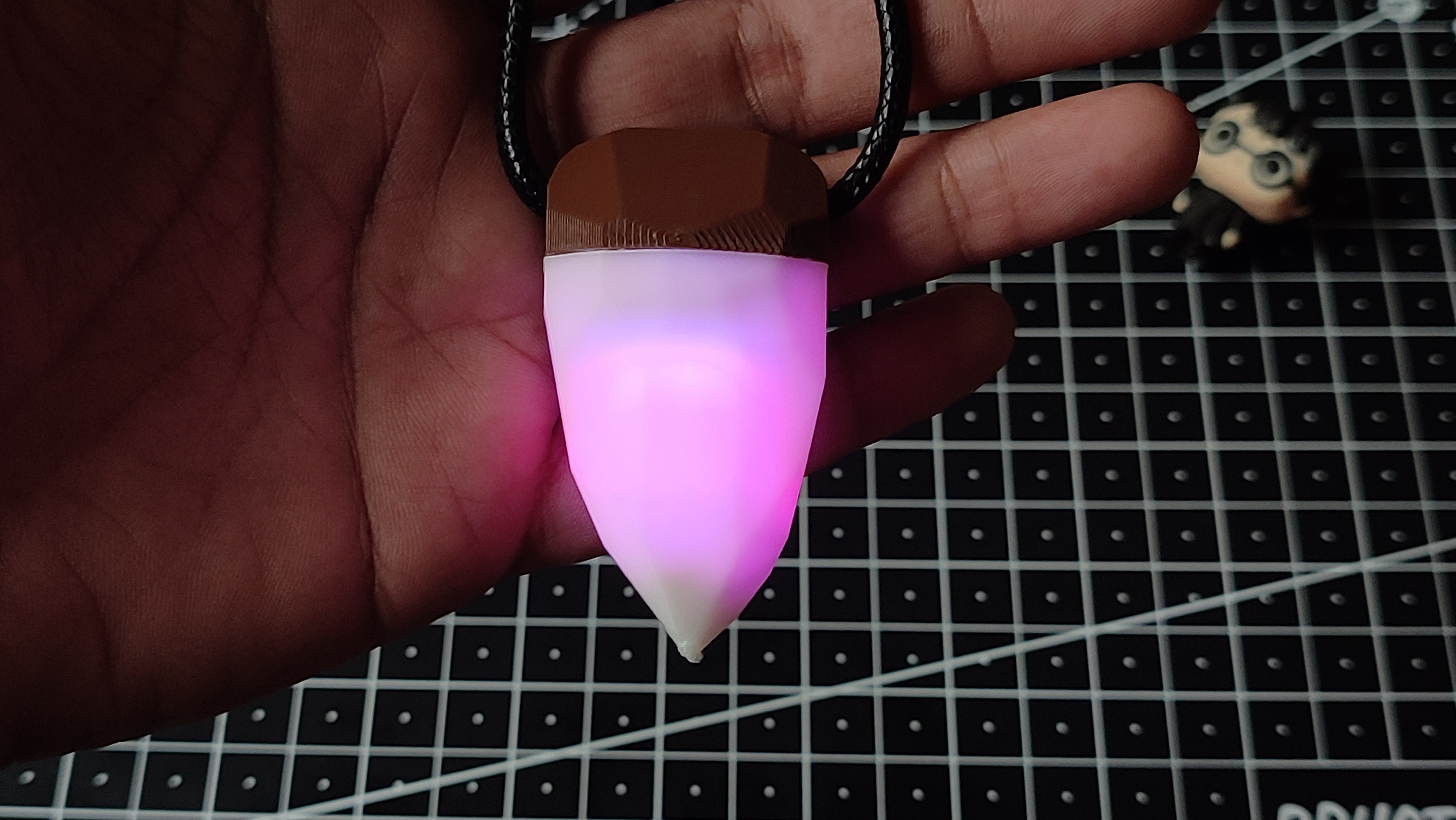

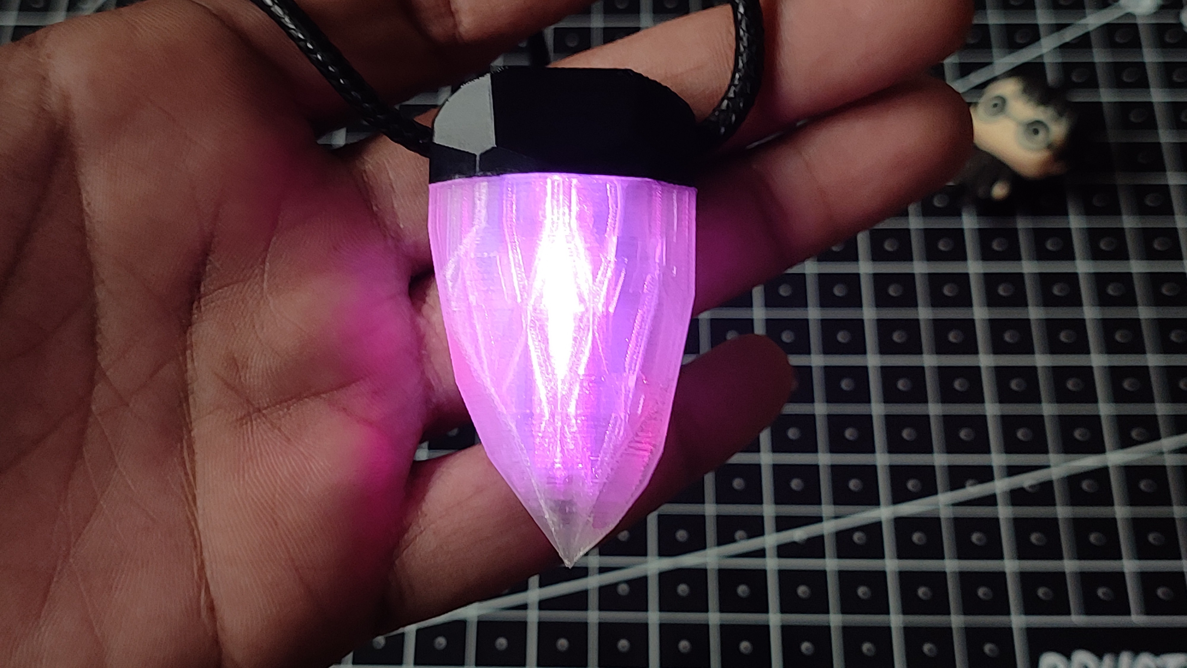

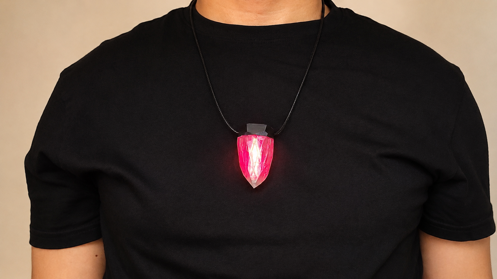

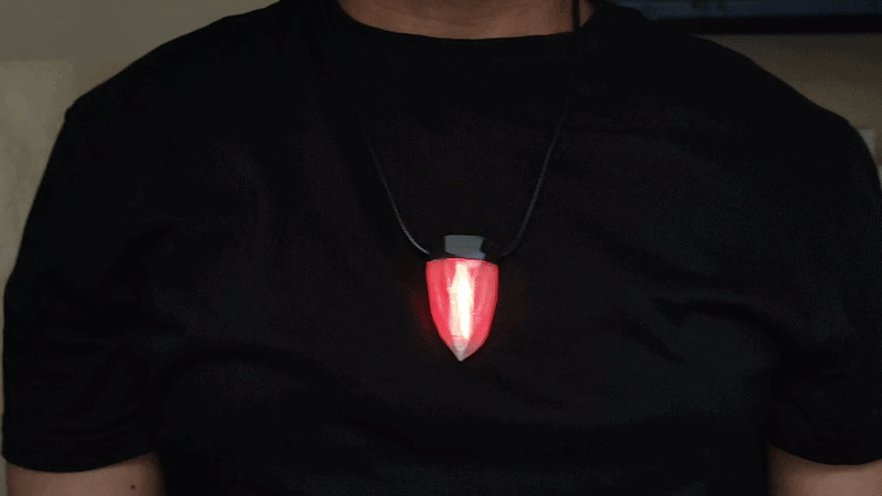

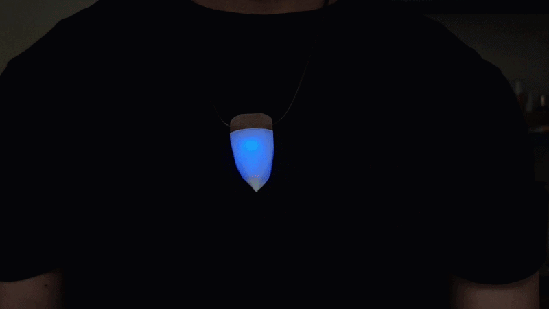

Which Looks Good?
As I mentioned earlier, I designed and printed two versions of the Aurora Pendant so I could compare their appearance and how they diffused the RGB light. You can see both versions in the image—one is printed in solid white PLA, and the other is printed in semi-transparent PLA.
The white version has a clean, elegant look and completely hides the electronics inside, making it resemble a traditional piece of jewelry. On the other hand, the semi-transparent version allows the light to spread throughout the enclosure, producing a brighter, softer, and more vibrant glow. The colors are much more noticeable and create a beautiful crystal-like lighting effect.
Personally, I prefer the semi-transparent version. The light diffusion makes the colors look richer and more eye-catching, especially in low-light conditions. It gives the pendant a unique appearance that really highlights the RGB LED and makes it feel more like a glowing gemstone.
