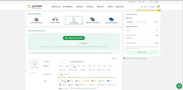

Uploading Your CAD Design
The ordering process is refreshingly simple.
Instead of exchanging multiple emails for quotations, you simply upload your CAD model directly through the online quotation system.
The platform supports several commonly used engineering formats including:
- STL
- STEP / STP
- OBJ
making it compatible with popular CAD software such as Fusion 360, SolidWorks, Autodesk Inventor, Creo, FreeCAD, and Onshape.
Once uploaded, the model is automatically prepared for quotation, allowing you to continue configuring the manufacturing parameters immediately.
For projects containing multiple components, several files can also be uploaded together, making it convenient to manufacture complete assemblies rather than individual parts.

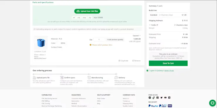

Configuring the Manufacturing Parameters
After uploading the model, the platform provides a detailed configuration panel where almost every manufacturing parameter can be customized before placing the order.
Material Selection
Depending on the manufacturing process, a wide range of materials is available.
For FDM 3D printing, commonly available materials include:
- PLA
- ABS
- PETG
- Nylon
- TPU
- Polycarbonate (PC)
- ASA
- Carbon Fiber Reinforced Materials
- Engineering-grade Thermoplastics
For CNC machining, users can choose from materials such as:
- Aluminum 6061
- Stainless Steel 304
- Brass
- Copper
- Titanium
- Engineering Plastics
Each material offers different characteristics depending on whether the priority is strength, heat resistance, flexibility, surface finish, or dimensional accuracy.

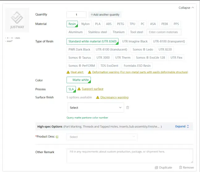

SLA Resin Printing Options
For projects requiring extremely fine details or presentation-quality models, JUSTWAY also offers SLA resin printing with multiple specialized materials.
Available resin options include:
- Standard White Resin
- Standard Black Resin
- Transparent Resin (UTR-8100)
- Translucent Resin
- High-Temperature Resin
- Flexible Resin
- Engineering Resin
- Tough Resin
- ESD-Safe Resin
- Dental and Professional Resins
These materials are designed for different applications ranging from display models and transparent covers to engineering validation, electronic fixtures, medical prototypes, and functional mechanical components.
