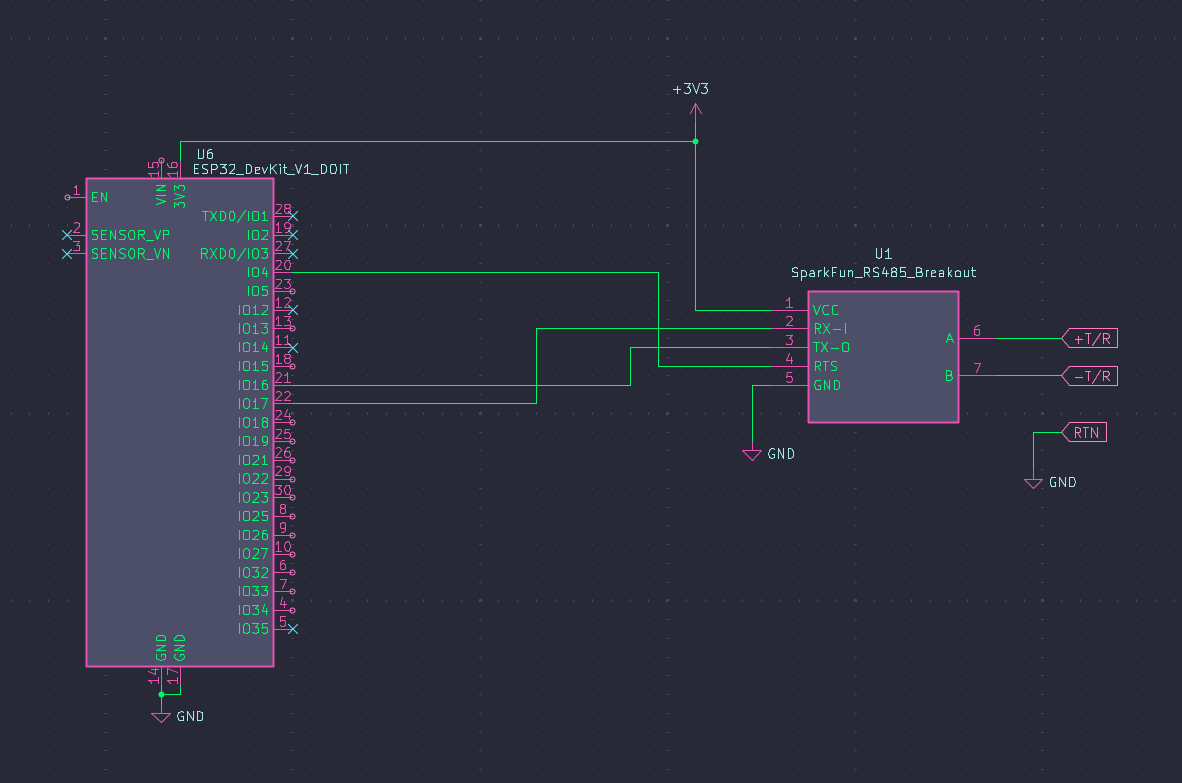

All we needed was a cheap SBC (a spare ESP32 board would do) and a RS-485 breakout board. We chose the Sparkfun RS-485 breakout board. It is a very simple circuit.
The ESP32 board is powered from a 5VDC wall wart. The ESP32 provides 3V3 to the RS-485 breakout board. No other components are required!
