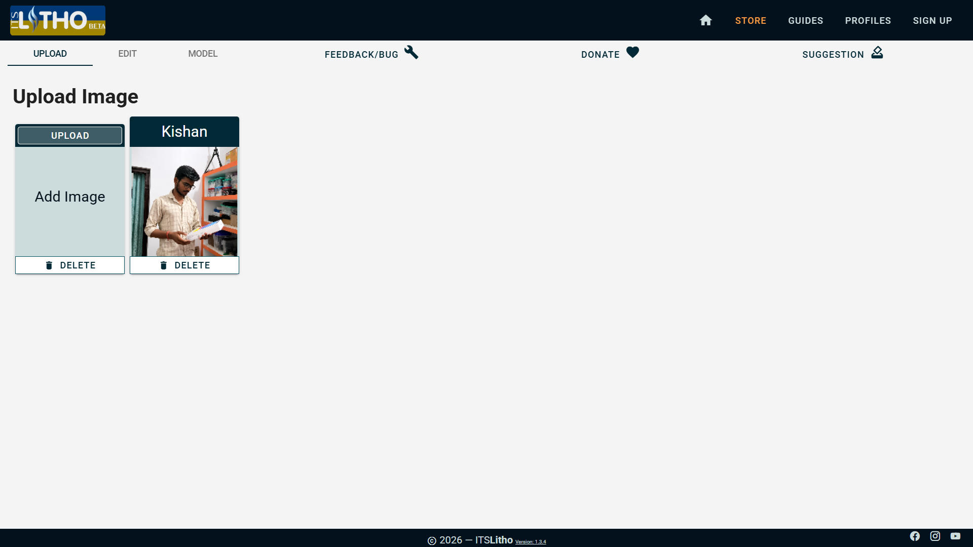

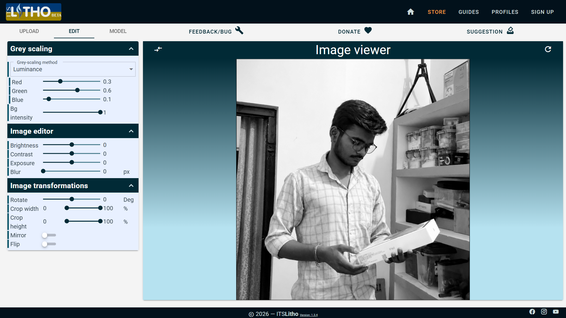

    Create Lithophane Model

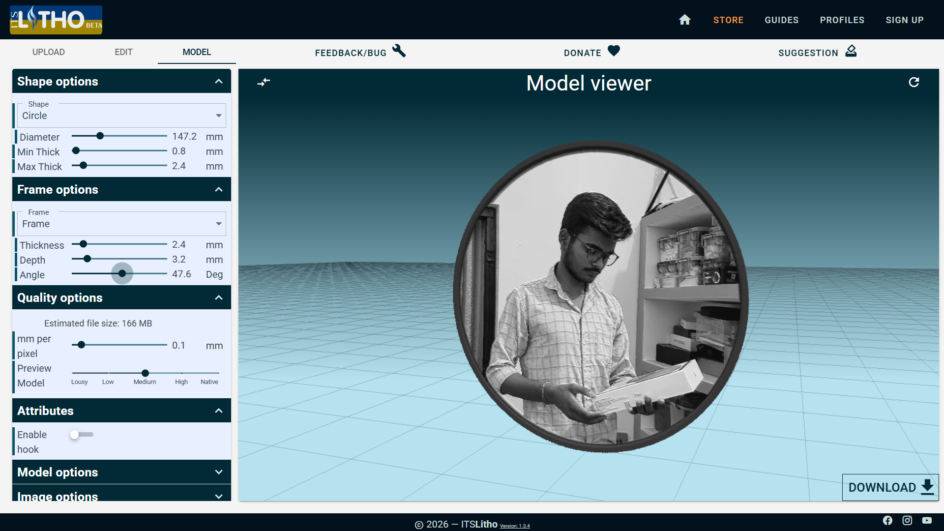

    I used ItsLitho to convert the selected photograph into a 3D lithophane. First, I uploaded the image and converted it to grayscale using Luminance. I kept the image adjustments at their default values and made sure the subject was properly positioned within the image.
    In the Model section, I selected a Circle and set the diameter to 147.2 mm. The lithophane thickness was set to 0.8 mm minimum and 2.4 mm maximum. I also added a frame with 2.4 mm thickness, 2.2 mm depth, and 47.8° angle.
    For the model quality, I used 0.1 mm/pixel resolution. After checking the model in the preview with backlighting, I downloaded the final STL file for 3D printing.

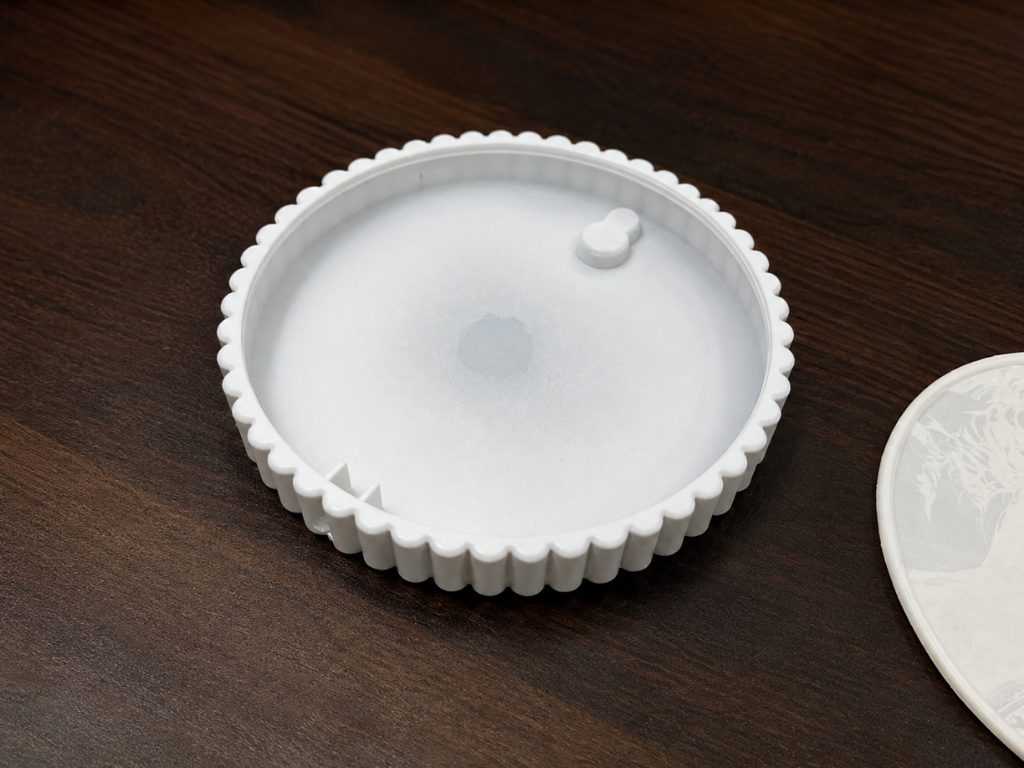

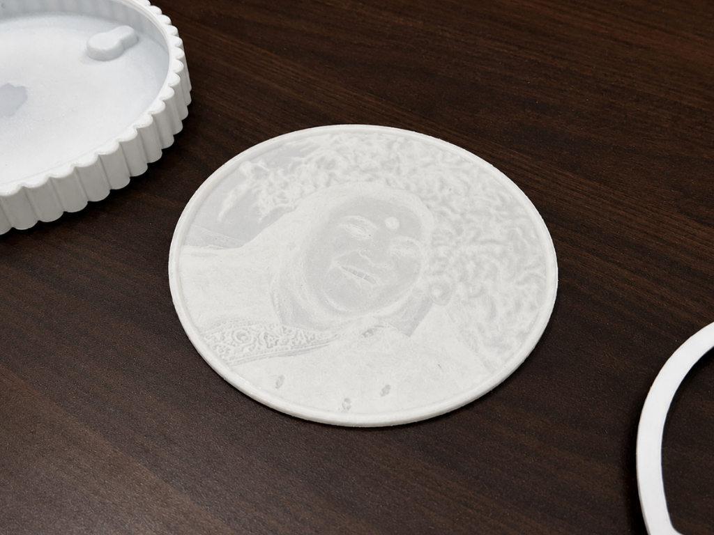

    3D Printing the Parts

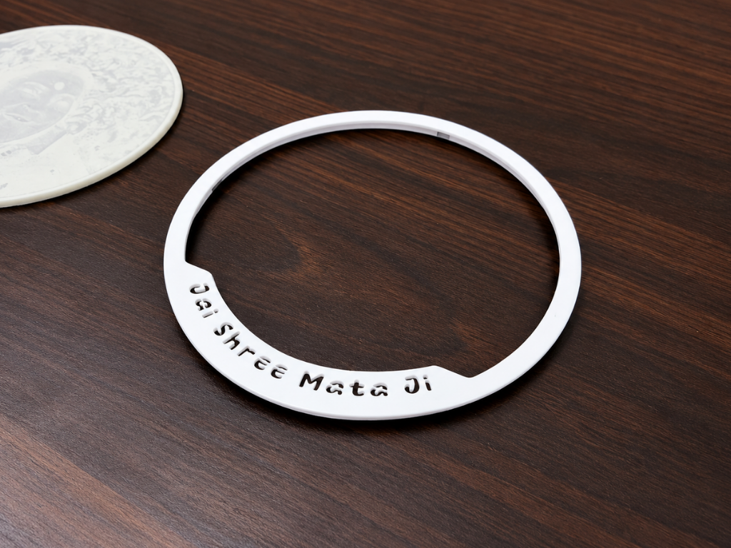

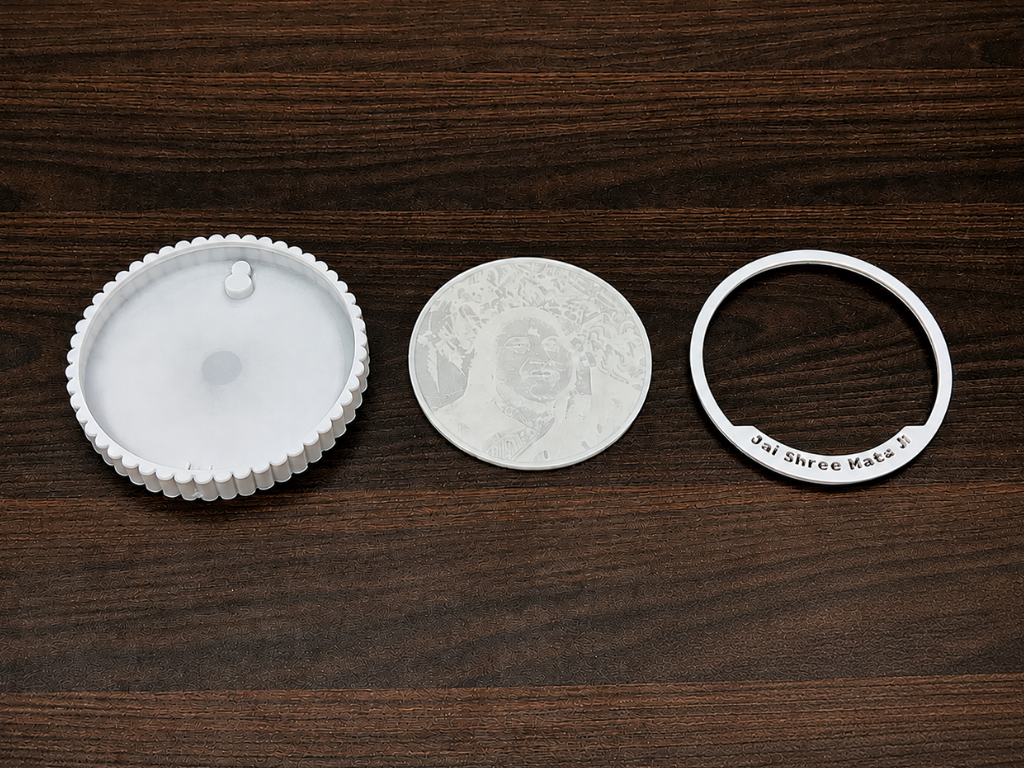

    After creating the lithophane model, I prepared and 3D printed the three main parts of the lamp: the lithophane model, photo frame, and text ring. Each part was printed separately so that they could be assembled accurately and give the lamp a clean, finished look.
    The lithophane was printed in white filament to allow the light to pass through the varying thickness of the image and produce a clear illuminated photograph. The photo frame holds the lithophane securely and provides the main outer structure, while the text ring adds the project name around the frame.
    For the photo frame and text ring, I used and modified a design originally created by 3DIEST. Credit to the original creator for the design.

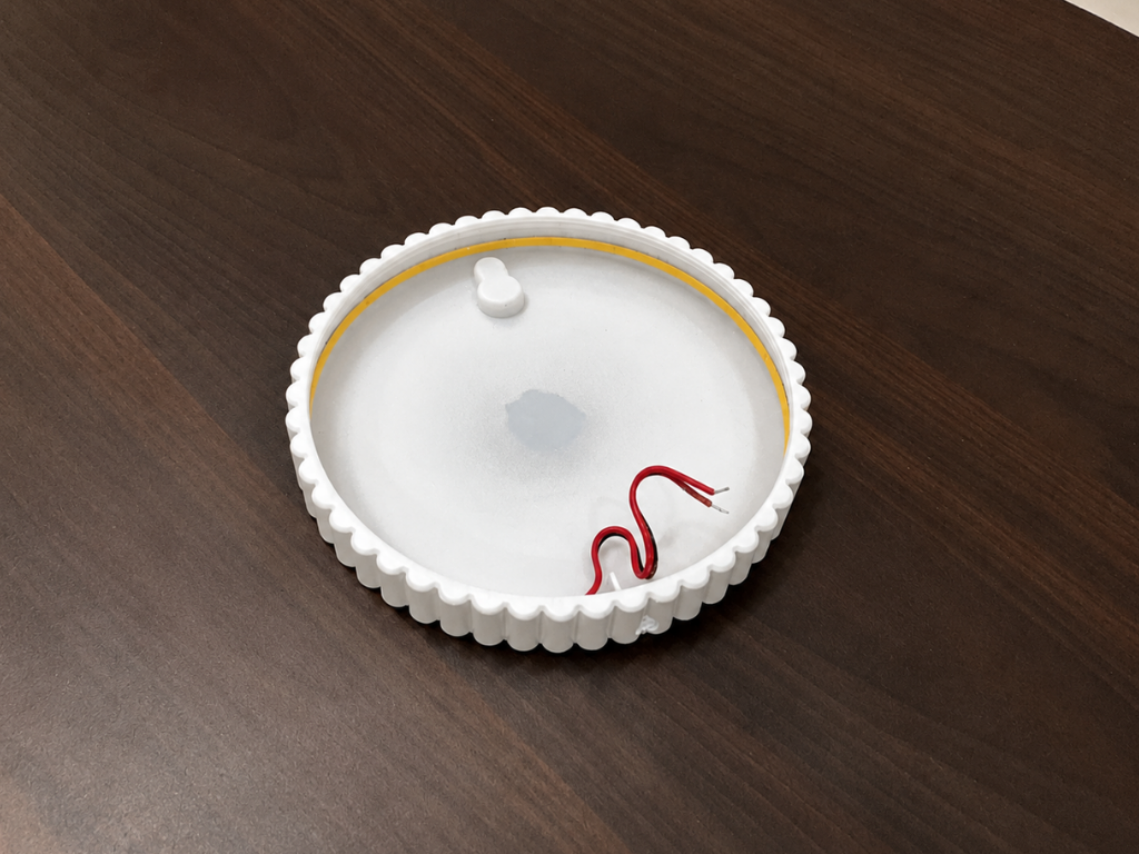

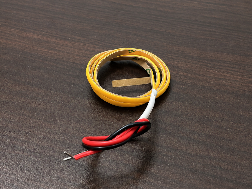

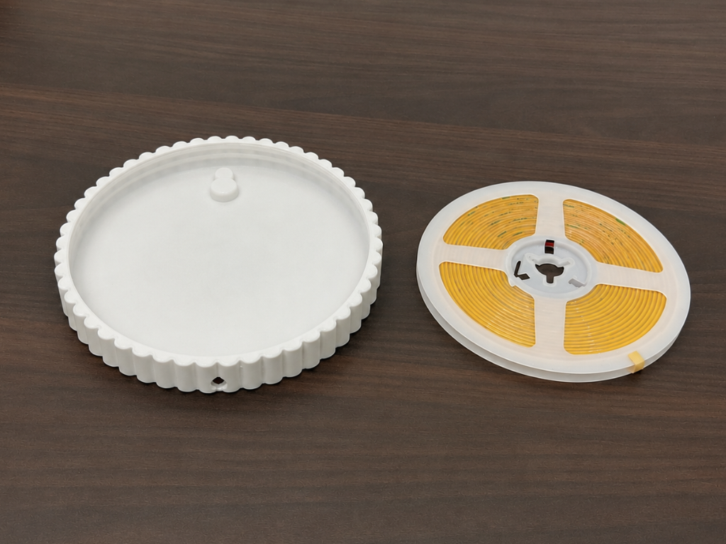

    Installing the LED Strip
    The next step is to install the LED strip inside the lamp. I used an ultra-thin, high-brightness LED strip from Waveshare, which is only about 4 mm thick but produces an impressive amount of light—making it ideal for evenly illuminating the lithophane.
    First, I cleaned the mounting surface to ensure good adhesion. Then, I peeled off the protective backing from the adhesive layer on the back of the LED strip and carefully positioned it around the inside of the lamp, keeping it evenly spaced for uniform illumination.
    Despite its extremely slim profile, the strip is surprisingly bright, providing enough light to clearly reveal the details of the lithophane without requiring a bulky lighting setup.
