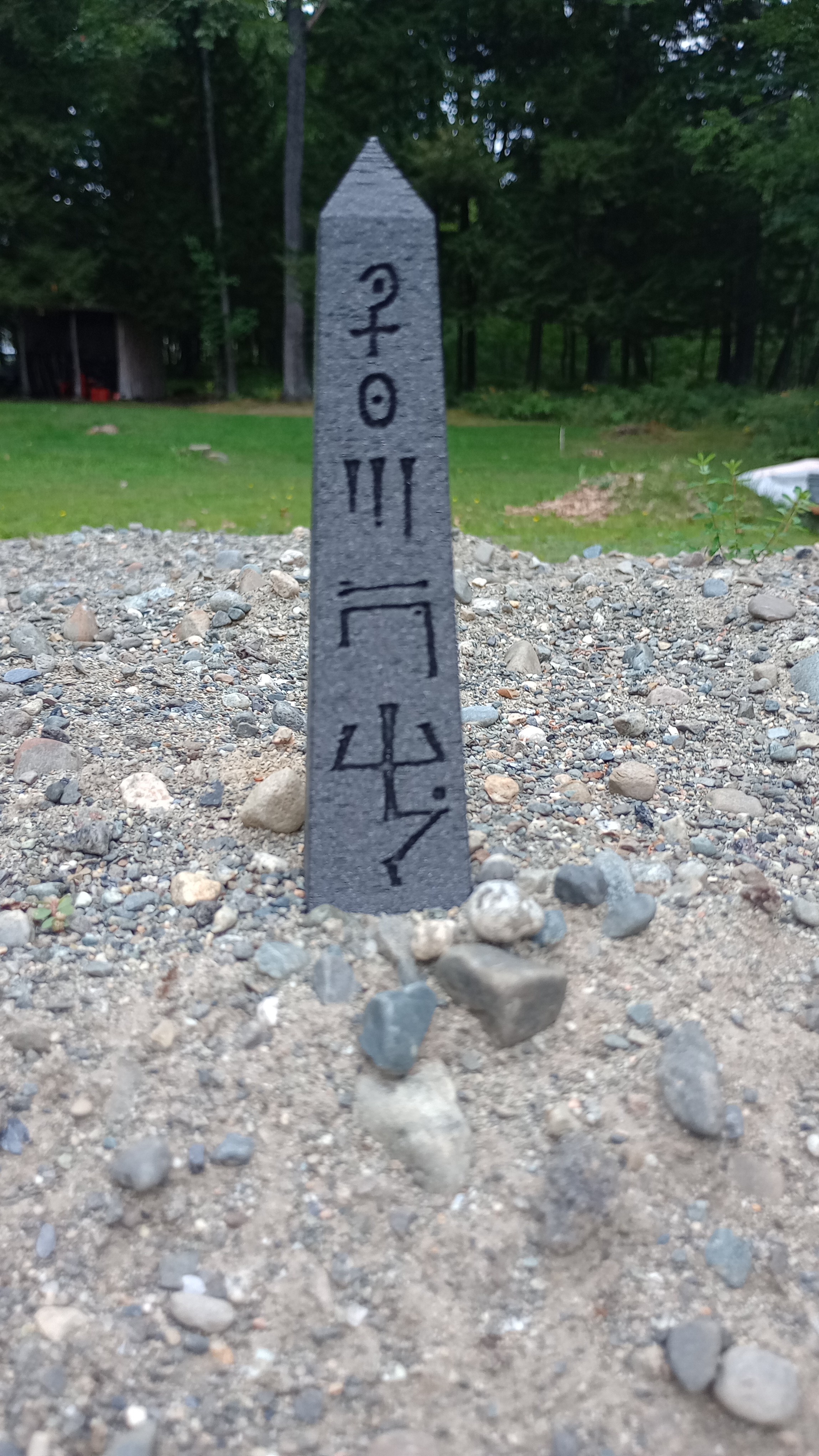

    The 3D printed proof

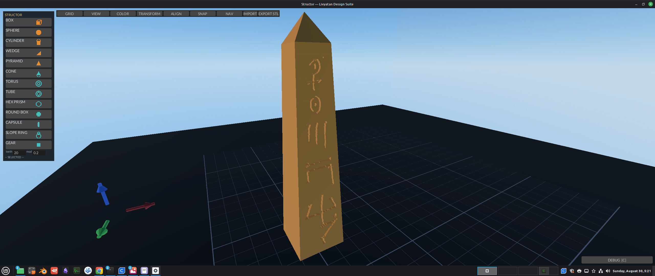

    Model on the plate in Structor
    Editable in suite

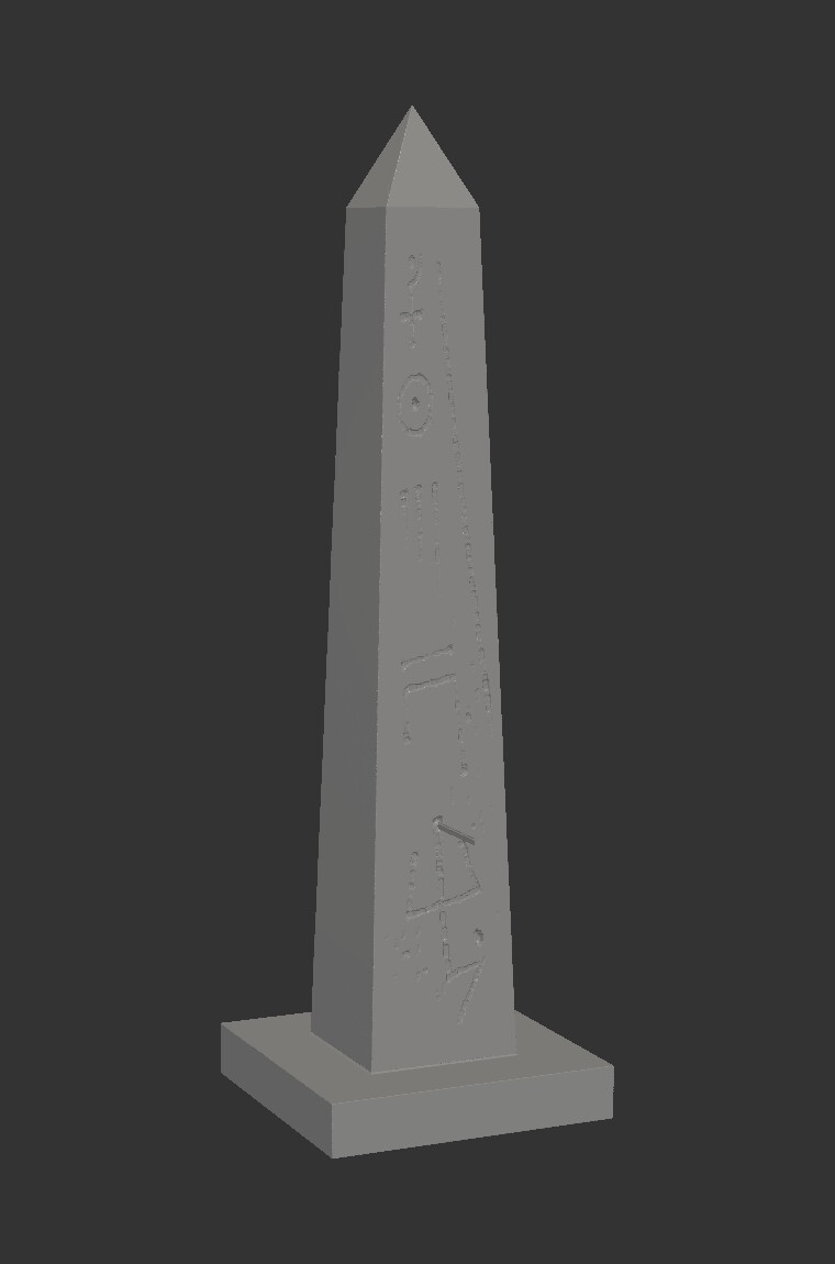

    Watertight STL

    Over the past week or so I've had that running the whole way through, to slicing and
    to a printed object I can hold: Ender-3 Max, 0.2 mm, about two and a half hours,
    galaxy black PLA. The weld stage returned one watertight body.
    Three of those stages ship today. Structor built the obelisk body. GilgaMESH did the
    weld — `gilgamesh remesh`, a voxel remesh that resolves the carve and the body into a
    single watertight solid, which is what makes it sliceable rather than merely
    correct-looking. The rectify, extract and emboss stages are Nazca, which unveils later
    in the rollout.
