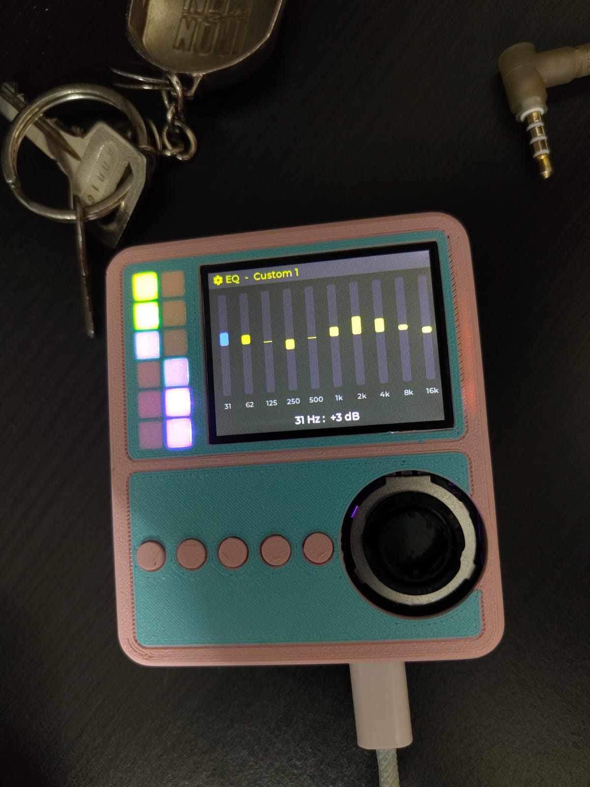

Rhythm is an open-source, high-resolution portable audio player designed to bridge audiophile-grade sound reproduction with distraction-free, minimalist hardware capable of playing all Hi-res audio formats like FLAC,WAV etc to MP3 too. Built around the ESP32-S3 and the ESS SABRE ES9038Q2M DAC with TPA6132A2 Headphone amp, Rhythm delivers lossless audio decoding, hardware-accelerated DSP, and high-current analog drive in a pocketable, tactile form factor featuring a 2-inch LCD display and physical rotary navigation.

  • True Discrete Datapath: No all-in-one codec shortcuts. An ESP32-S3 handles file parsing and DSP, pushing pristine I2S to an ES9038Q2M SABRE DAC, running into an active OPA1688 transimpedance stage.
  • Dual Isolated Power Domains: Digital logic and high-frequency switching lines are physically separated from the analog rails, regulated by dedicated ultra-low-noise LDOs to ensure the noise floor remains dead silent.
  • Tuned Analog Bandwidth: The I/V feedback network uses linear, high-frequency capacitors to place the out-of-band delta-sigma noise pole well beyond the audible band >150kHz, preserving phase coherence and high-end spatial reverb tails.
  • Twin Independent Outputs: Two TPA6132A2 DirectPath amplifiers provide ground-referenced, capacitor-free drive. No bass roll-off, no phase shift, and zero crosstalk between listeners.
  • Tactile, Distraction-Free UI: A responsive 2.0-inch color LCD display paired with a physical rotary encoder and tactile buttons for volume and track navigation that works seamlessly through your pocket.
