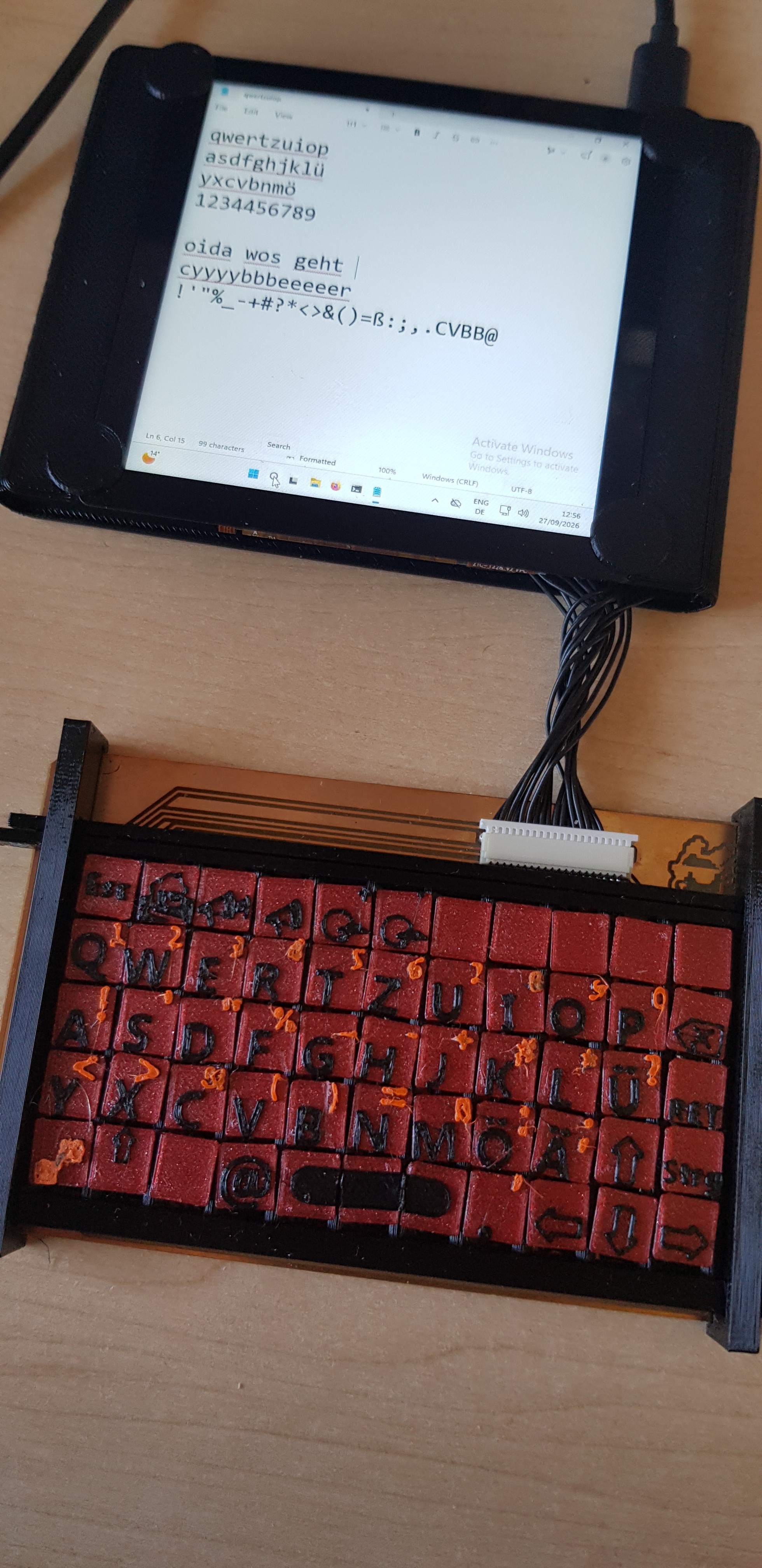

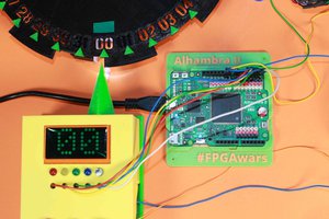

Streamer-(cyber)Deck
esp32s3 + custom-written video encoder/decoder pipeline integrated on a custom-made pcb streaming my PC content with up to 40 FPS from
I would say this is an 80% software and 20% hardware project — as is so often the case, the software work can't really be captured in photos. I have written a custom video encoder/decoder that is optimized for this exact task: low-latency, parallel-processable video encoding/decoding.
So far, it is possible to stream some Linux distros and Win11. Compression/encoding takes place as close to the source as possible, directly on the GPU, i.e. hardware accelerated. The encoder is written in DirectX on Win11 and OpenGL on Linux, plus a C++ server app.
Things I think are very cool: with this custom encoder, I am fully GPU-vendor-agnostic. I don't need a special GPU with dedicated encoder blocks using a video format that then forces me to find decoder ICs on the client side that have everything I need.
Instead, I'm fully flexible in rewriting my FPGA code and can drive whatever display I want: parallel RGB, LVDS, MIPI, etc.
  • Ugly Prototype Keyboard - But it's working
    gitzi • 09/27/2026 at 11:04 • 0 comments
    Experimenting with a self-etched keyboard and 3D-printed keycaps for my deck. The keycaps stay in place pretty well. I don’t have a multi-color extruder, but by using different layer heights it’s still feasible to print them in different colors.
  • Show&Tell
    gitzi • 09/20/2026 at 21:07 • 0 comments
    Made a short video to demonstrate the deck <3
View all 2 project logs
