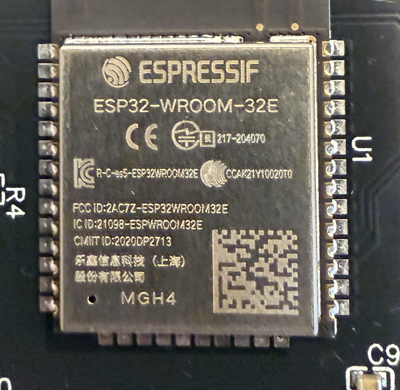

My first problem was figuring out how to get from an ESP32 to actual RS232.
I knew serial communications from the industrial side, but I wasn’t building embedded hardware every day. One of the early things I had to really understand was that the UART coming out of an ESP32 is not electrically the same thing as RS232.
That led me to the MAX3232 and eventually to a circuit with the ESP32, RS232 transceiver, DB9 connector, USB-C power, and the supporting components around it.
The current version of the board, GB-01, uses a simple three-wire RS232 connection: TX, RX, and ground. I did not route RTS/CTS or the other modem-control signals on this version.

I spent a lot of time going back and forth between datasheets, EasyEDA, component listings, and the physical layout.
Eventually I got to the point where I could send the design to JLCPCB and have the boards professionally made and assembled.
Seeing the first real PCB show up was a pretty big moment for me. Until then, everything existed on a monitor.
Then I had something in my hand that either worked or didn’t.

One of the more memorable problems was getting the serial communication path working correctly.
The ESP32 was running. The RS232 circuitry had power. I could measure about the kind of RS232-level voltage I expected on the transmit side, so the MAX3232 was clearly doing something....

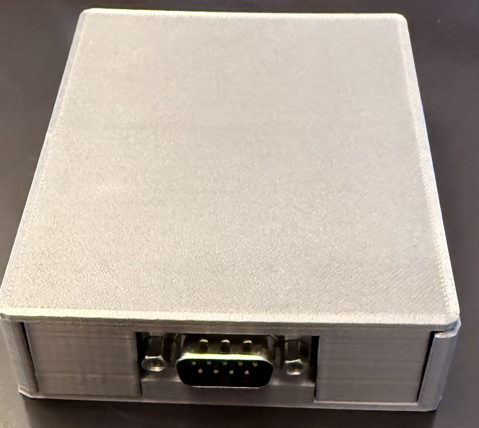

    I Would Think About the Enclosure at the Same Time as the PCB
    I treated the enclosure as something I would figure out after the electronics were finished.
    I probably would not do that again.
    Connector placement, board mounting, component height, programming access, cable clearance, and enclosure geometry all affect each other.
    Moving a connector a few millimeters on the PCB can make the enclosure much easier or much harder to design.
    Next time, I would probably work on both at the same time.

    There was a point in this project where GhostBridge worked.
    The PCB powered up.
    The ESP32 firmware was stable enough to move traffic.
    The RS232 side communicated reliably.
    GhostTune could talk through it to a real ECU.
    Technically, I had solved the original problem.

    Firmware Had to Become Predictable
    The same thing happened with the firmware.
    During development I could change a setting, reflash the ESP32, reconnect manually, or look at serial output if something went wrong.
    That is not a good user experience.
    I needed the bridge to power up and behave predictably.
    The current setup creates its own local WiFi network and exposes the serial connection through TCP. No router or Internet connection is required for the basic link.
    For my original use case that was exactly what I wanted.
    Turn the bridge on, connect the phone, and communicate locally with the ECU.
    The less setup required, the better.

  • Then I Had to Put It in a Box
    Crux Resolve2 hours ago 0 comments
    Once the electronics worked and GhostTune was talking through GhostBridge, I thought I was getting close to the end.
    I wasn’t.
    The enclosure ended up becoming a project of its own.
    I wanted something that looked like a finished device, not a PCB sitting loose in a generic electronics box.
    That meant designing around the actual board, the DB9 connector, the USB-C port, the component heights, and the way the PCB needed to be held in place.
    I also wanted the case to snap together instead of using screws.
    That sounded simple too.
    It wasn’t.
    My first enclosure ideas looked fine in CAD, but once I started printing them I found out pretty quickly that features that look strong on a screen can be weak in real plastic.
    Some locating features were too thin and broke.
    The snap geometry needed more material.
    The PCB could move more than I wanted.
    The connector openings were close, but not quite right.
    Then I started getting into the kind of adjustments I never expected to care about:
    0.1 mm here.
    0.15 mm there.
    Make this tab a little thicker.
    Move that rail outward.
    Reduce the USB-C opening slightly.
    I probably spent more time thinking about tenths of a millimeter than I had spent thinking about entire control panels in the PLC world.
    The process became pretty repetitive:
    change the model → print it → wait several hours → assemble it → find the next problem
    A full print could take around seven hours, so every bad revision had a built-in waiting period before I got to find out what I had done wrong.
    That made small changes feel surprisingly important.
    One version had small locating features near the DB9 that were too fragile and broke off.
    Those eventually got removed completely.
    The snap sections got thicker.
    The PCB retention changed.
    The centering rails changed.
    The connector openings changed.
    Even after the whole thing snapped together correctly, I still had a little bit of PCB movement inside the case and had to decide whether it was actually a problem or just me trying to make everything perfect.
    Eventually I got to a version that snapped together, held the board securely enough, lined up with both connectors, and looked like something I would actually be comfortable handing to someone else.
    That was another milestone for me.
    The project had gone from:
    jumper wires and an idea
    to
    custom PCB + firmware + iPhone app + custom enclosure
    At that point, GhostBridge finally looked like a product instead of a prototype.

  • The First PCB Showed Up
    Getting a PCB manufactured was one of those steps that felt bigger than it probably should have.
    Up to that point, almost everything could still be changed instantly.
    If the schematic was wrong, I could fix it.
    If a footprint was wrong, I could replace it.
    If routing looked bad, I could move things around.
    Once I placed the order, that changed.
    Now I had committed the design to actual copper, fiberglass, solder, components, and money.
    I used JLCPCB for manufacturing and assembly, which meant I also had to learn a whole new set of details around BOMs, part availability, assembly options, component substitutions, board files, and what the manufacturer actually needed from me.
    That was another part of the project I had never dealt with before.
    In the PLC world, if I need a controller, an input card, or a relay, I usually buy a finished product that already exists.
    Here I was the one creating the finished product.
    When the first boards finally arrived, I remember looking at them and thinking they looked far more professional than I expected.
    It was strange seeing something I had been staring at in EasyEDA suddenly sitting on the bench as a real assembled PCB.
    Then the excitement wore off and the real test started.
    Does it power up?
    Is 3.3 volts actually 3.3 volts?
    Is the ESP32 alive?
    Is the MAX3232 doing anything?
    Are the signals going where I think they are going?
    Does the DB9 behave like the schematic says it should?
    This was the point where I stopped being able to solve problems by moving things around on a screen.
    Now I had to measure them.
    I started checking power rails and signal paths and eventually confirmed that the RS232 side was producing real RS232-level voltages.
    That was a good sign.
    It also did not mean the board actually worked.
    That distinction became important pretty quickly.
    The board could power up, the ESP32 could run, the transceiver could generate the right kind of voltage, and communication could still fail.
    That ended up leading into one of the more useful debugging lessons of the entire project.
