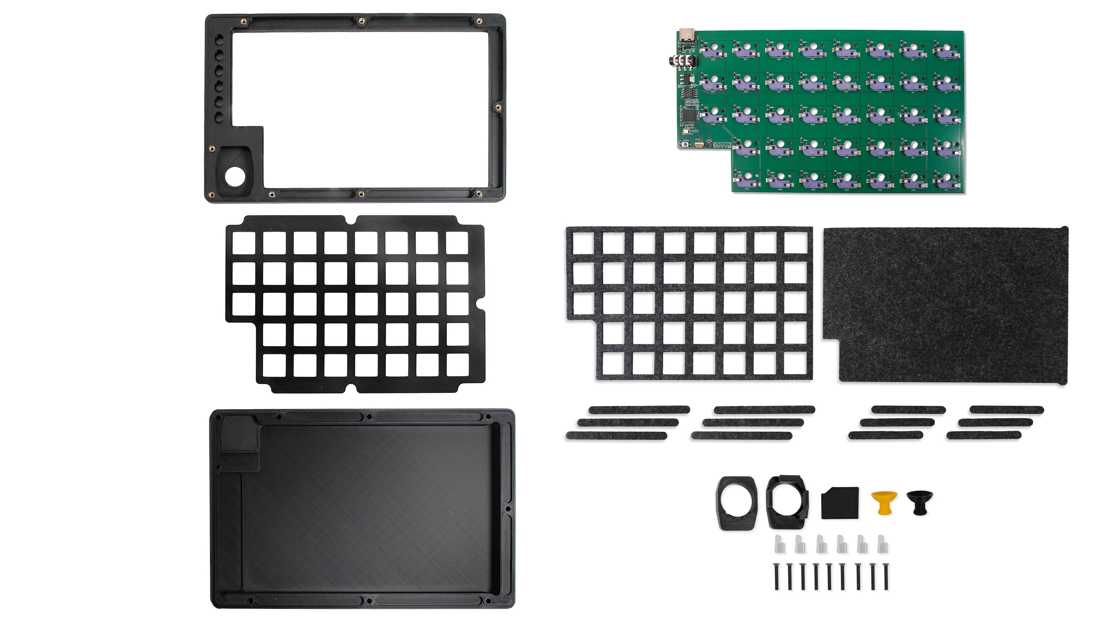

The Case
Speaking of the case, the keyboard is designed as a "gasket-mount" which enables the best noise reduction. This is further improved by additional felt damping sheets.
To highlight one special design principle: The case was designed with CNC manufacturability in mind. Meaning no sharp inside corners, only simple chamfers to round over outside corners, and tight tolerances. The last one requires a very dialed-in 3D printer, though.

PCB Design Desicitions
Going into detail about the PCBs design: The goal was to have minimal case borders, which the gasket-mount style of this keyboard does not really promote. So complact placment of all components was critical in my desicition making.
I started with the RP2040 for my MCU (as seen in these older images). After multiple protypes and testing revealed that the keyboard does not initialize (at all or fast enough) on a computers first boot to enter BIOS/UEFI, I switched to the STM32F401 MCU, which solved these problems.
The AUX (TRS) connector is not for headphones, but for connecting two halves. Only one half needs to be connected to a computer.
ESD, EMI, and backfeeding protection components complete the design.
