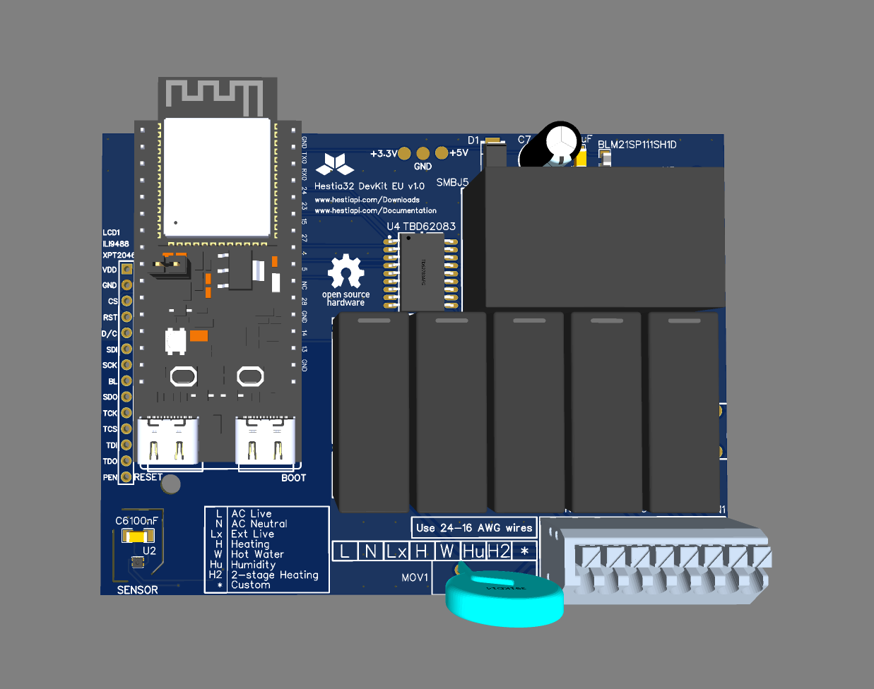

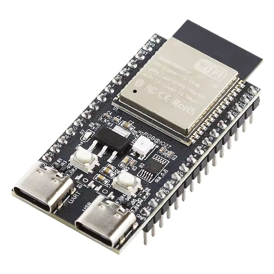

    One of the goals of Hestia32 is to keep the hardware as open as the software. That means more than publishing the source files: it also means giving people meaningful choices when building the device.
    The first Hestia32 designs use the Seeed XIAO ESP32-C5. I've now completed the HVAC and EU board designs using a generic 30-pin ESP32-C5 DevKit as well.
    https://github.com/MakeOpenStuff/hestia32/tree/develop/pcb
    Why support another board?
    The XIAO is a good fit for a compact design, but it shouldn't be the only way to build Hestia32.
    Some builders may prefer a generic development board, already have one available, or simply want to avoid depending on a particular module. Supporting both approaches makes the project more flexible and gives people another route to building their own thermostat.
    Same functionality, different hardware
    The generic DevKit variants are intended to offer the same functionality and feature set as their XIAO-based counterparts. The controller board changes, but the goal for the thermostat itself remains the same.
    The attached render shows the EU version with the generic 30-pin ESP32-C5 DevKit installed. The HVAC version follows the same approach.

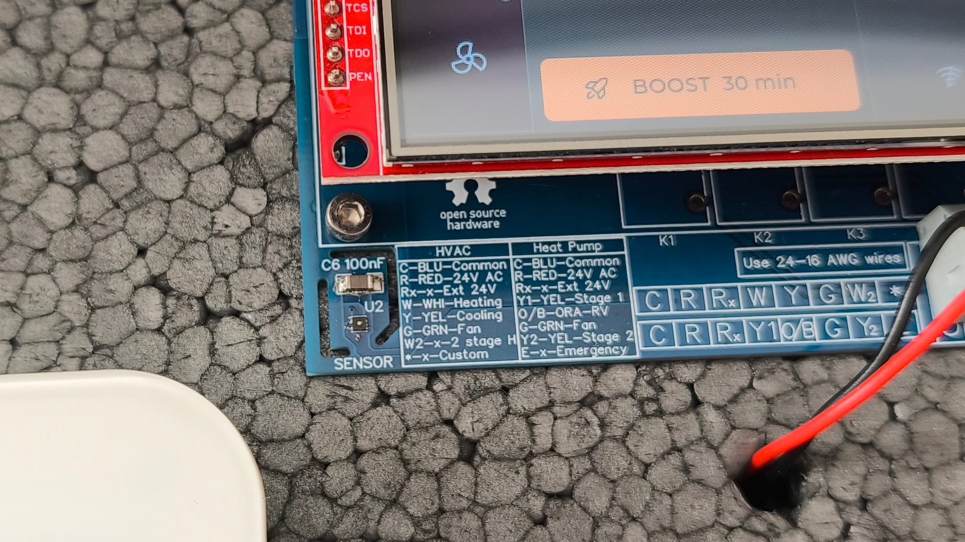

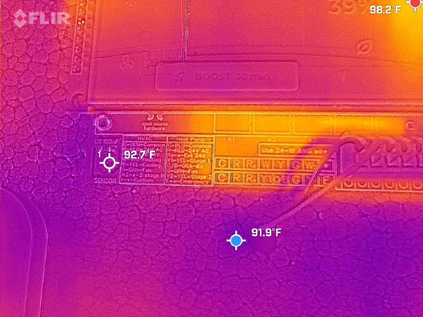

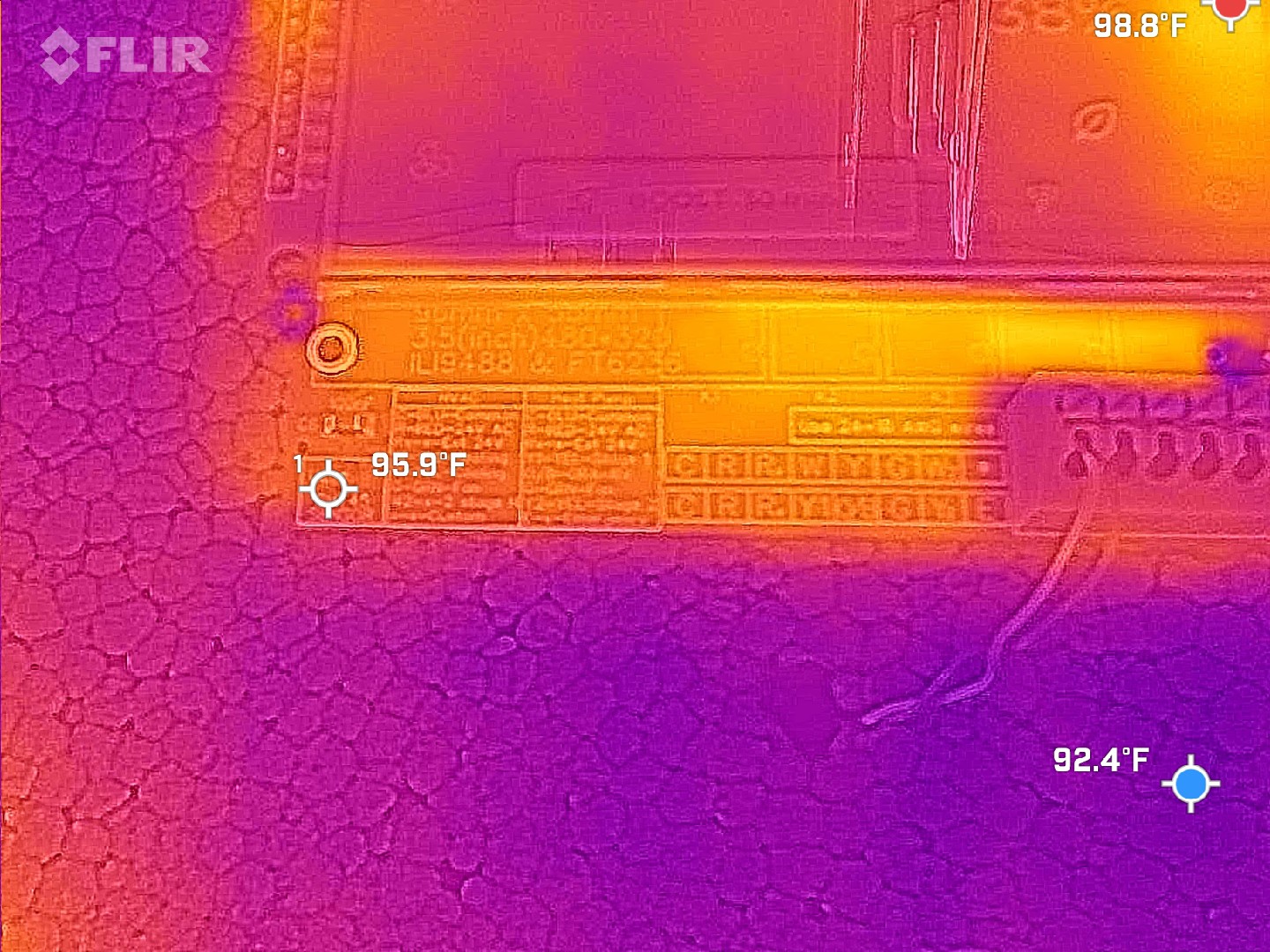

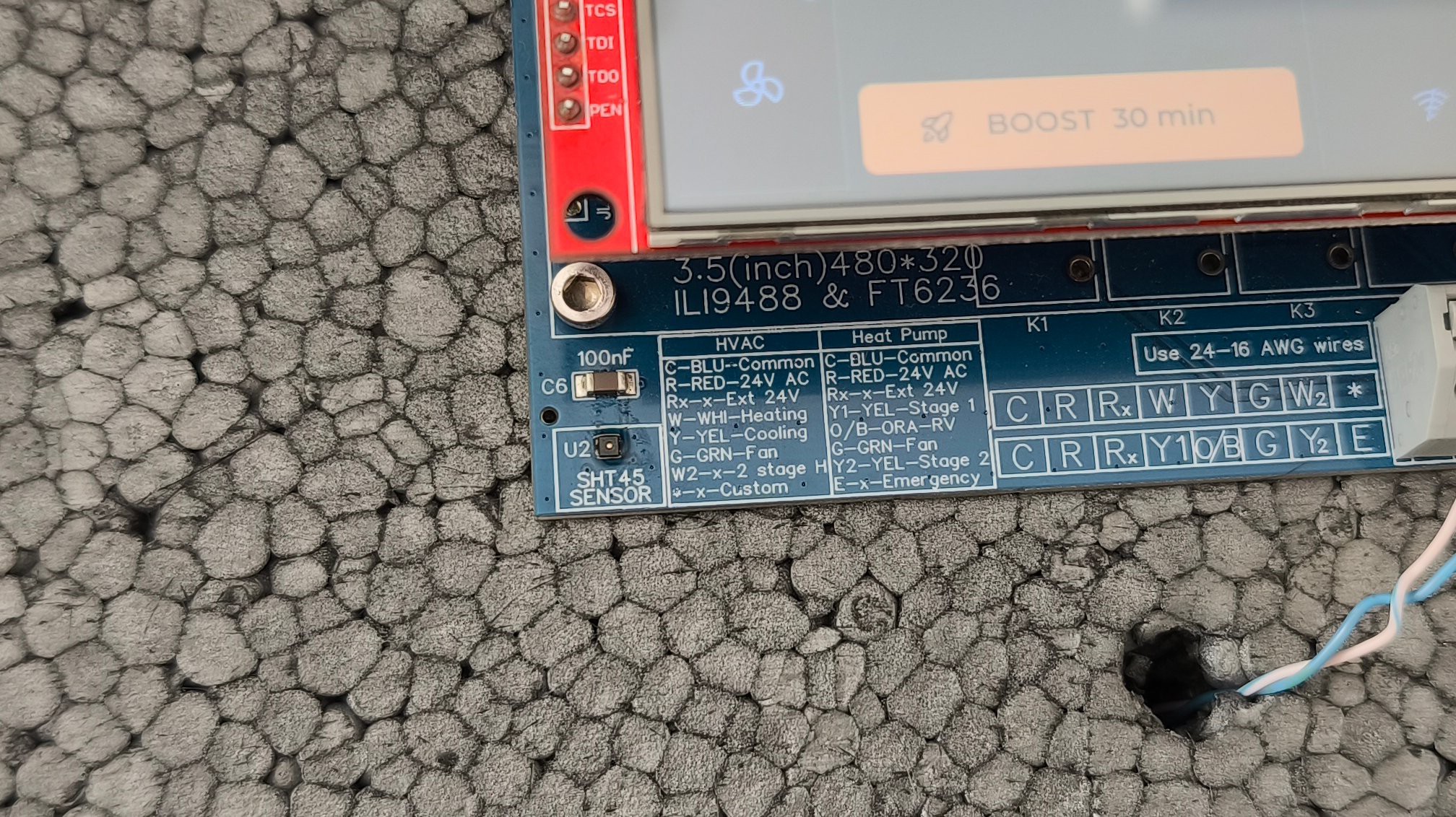

    During testing of the previous Hestia32 XIAO HVAC PCB, I found an unexpected problem: the SHT45 temperature sensor was consistently reading around 6-7°F higher than the actual ambient temperature after the board had been running for a while.
    The cause turned out to be heat traveling through the PCB copper planes from other components towards the sensor.
    For the next revision, I removed the copper fill around the sensor and added two L-shaped slots to create an air gap around that section of the PCB. I kept two narrow bridges: one carries the sensor connections while also providing mechanical support, while the other is purely structural.

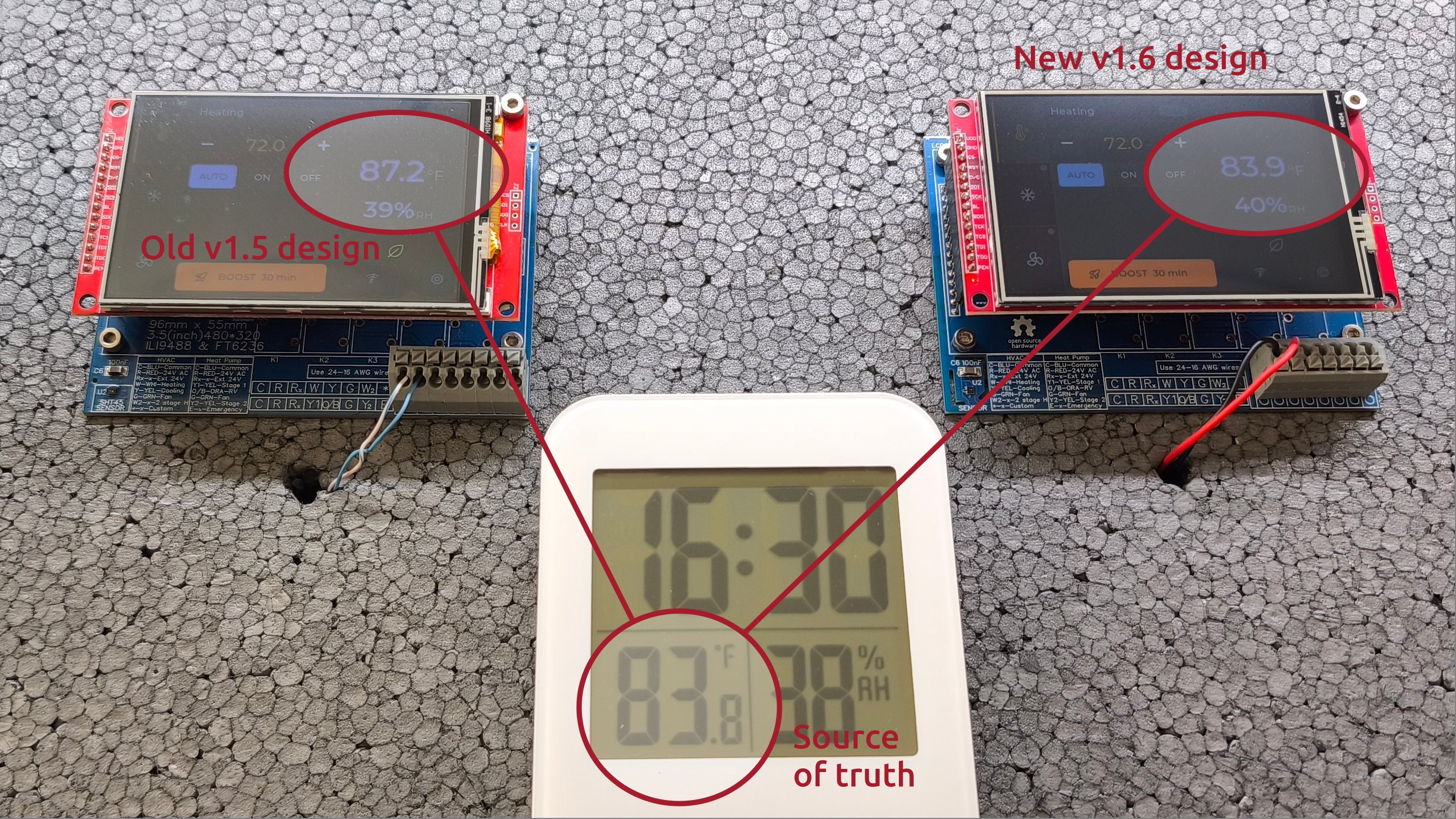

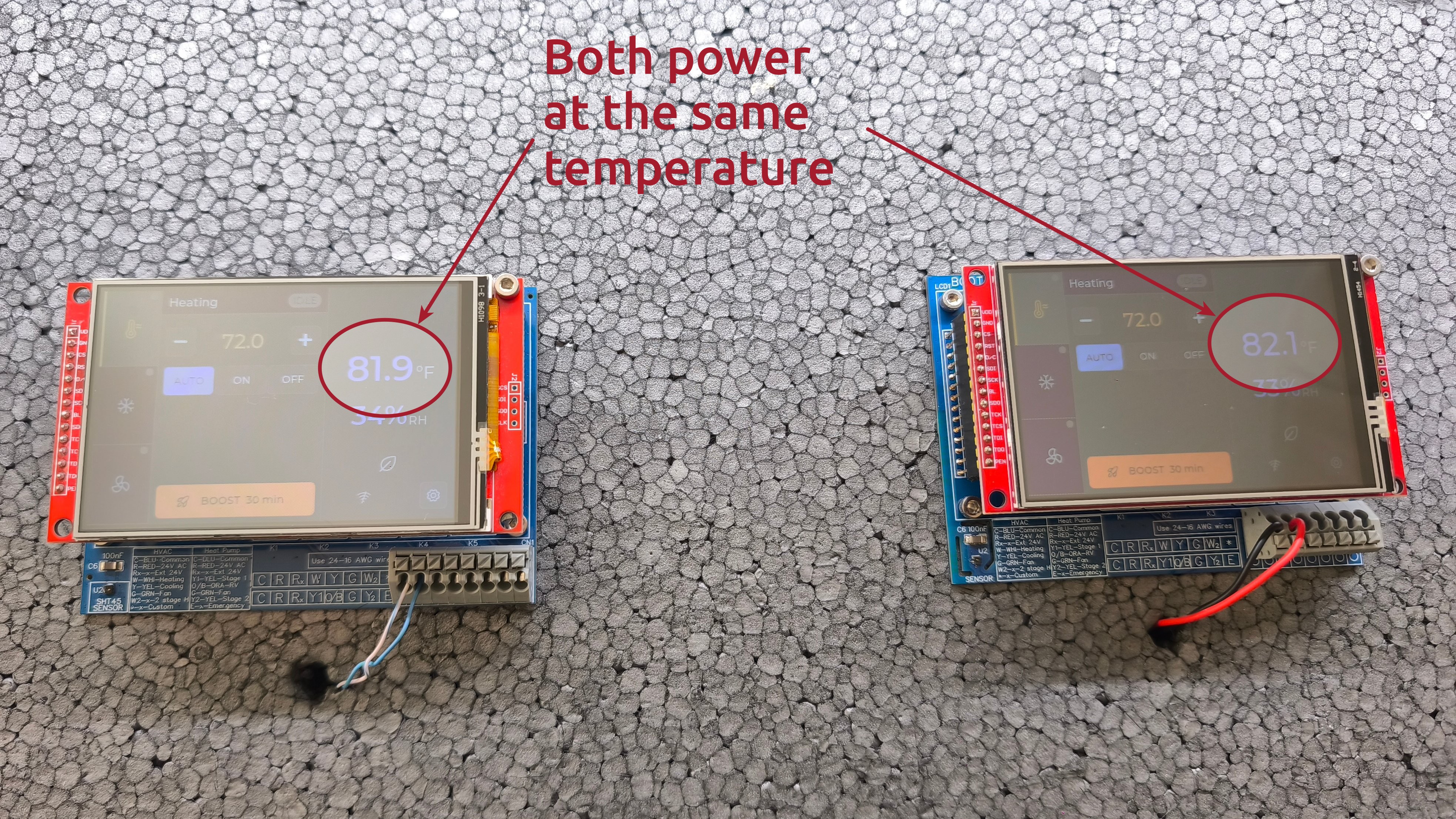

    I then tested the two revisions side by side on a 10 cm thick styrofoam "wall", powered from the same 24V AC source and connected to Wi-Fi. The displays were deliberately left on continuously to maximise power consumption and therefore heat generation.
    After two hours:
    • Old v1.5: 87.2°F
    • New v1.6: 83.9°F
    • Reference thermometer: 83.8°F
    That reduced the measured temperature error from +3.4°F to +0.1°F, or roughly a 97% reduction.
    A thermal camera made the difference particularly obvious. On v1.5, the copper fill creates a visible thermal path towards the sensor. On v1.6, the copper-free area and PCB slots substantially isolate the sensor from the rest of the board.
    There is still more validation to do, but the new design is behaving much closer to what I want: the sensor measures the environment rather than the PCB.
