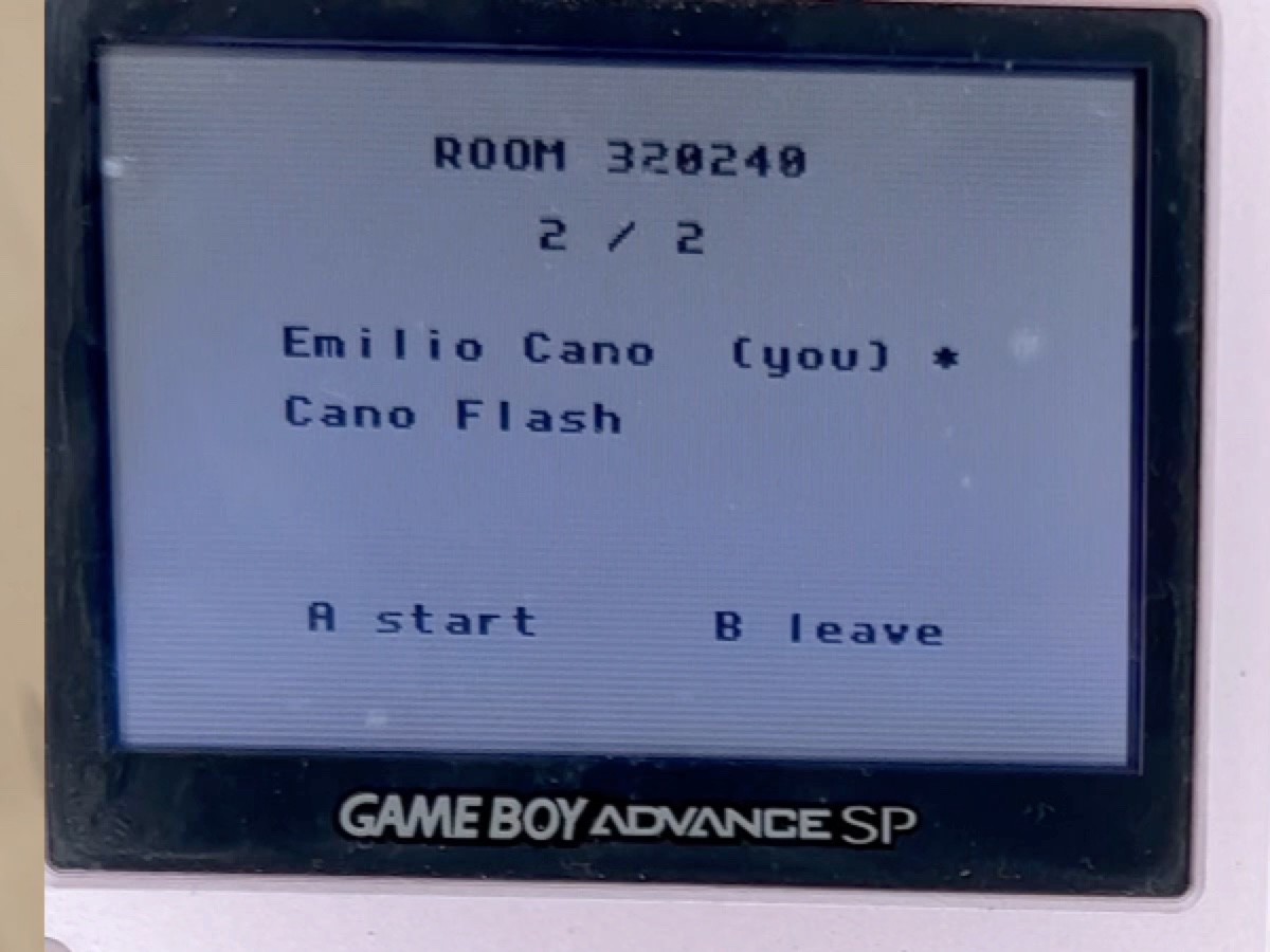

The SDK
Free and MIT-licensed: two C99 files with no engine dependency and no dynamic allocation, for devkitARM C and Butano C++.
  • Public matchmaking, or private rooms with a six-digit code
  • Lobbies with player names and a room host
  • State updates for positions and reliable events for turns and actions, up to 480 bytes each
  • Recovery from short Wi-Fi drops
The SDK lobby example on a GBA SP: a room with two players ready to start
The lobby example from the video ships with full source code. Source on GitHub · Documentation

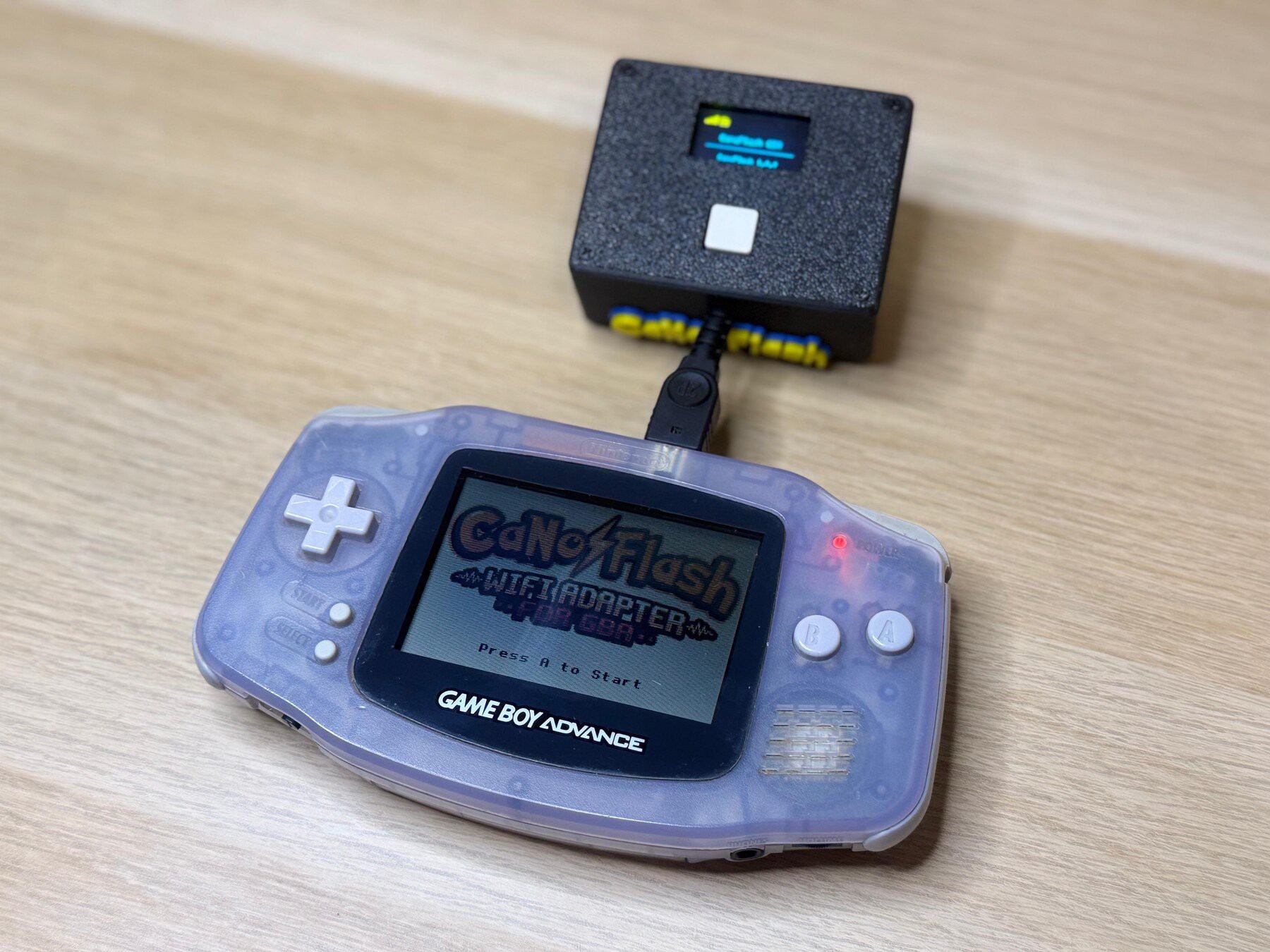

It also writes the games
CanoFlash connected to an original Game Boy Advance, with its menu and OLED status display

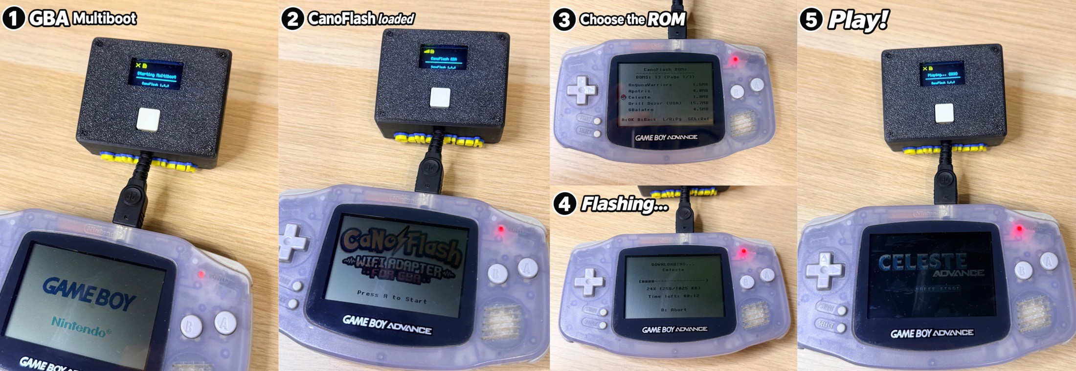

CanoFlash started as a Wi-Fi loader. It sends a native menu into the console's RAM through Multiboot, downloads authorized homebrew or your own backups, writes them to a compatible rewritable cartridge and backs up saves. The same device writes an online game to the cartridge and then connects it. No console modification is needed.
The Multiboot, selection, cartridge-writing and restart workflow

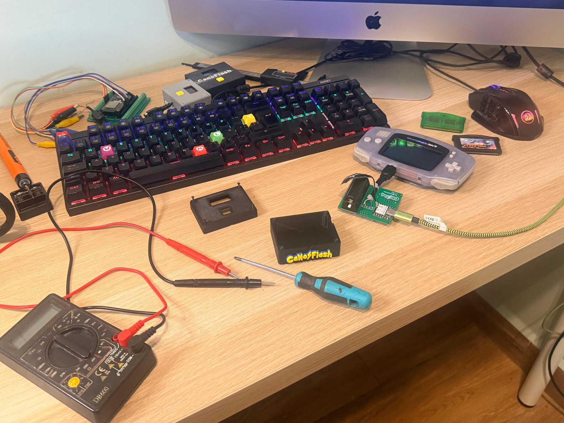

One thing that bit me
On the Link Port the GBA is the serial slave: it can't speak first, it can only leave a 32-bit word and wait for CanoFlash to clock it. At 256 kHz the last bit of every GBA→ESP32 word went missing, because the GBA releases its output line before the 32nd bit is sampled. More stories like this are coming in the project logs.
Status and limits
  • Tested with two players on real hardware; more consoles are still to be tested
  • Works in games made with the SDK, not in existing games
  • Built for turn-based and slower real-time games, not 60 fps action
  • No latency or online battery figures yet: they still have to be measured on the current firmware
  • A compatible flash cartridge is required, and the battery is not included
The CanoFlash prototype opened on the workbench during testing
