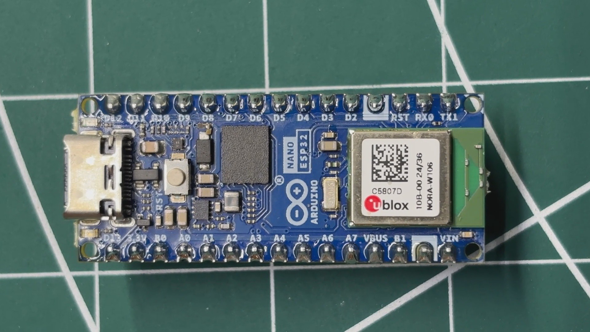

HARDWARE- ARDUINO NANO ESP32
The brain of this project is the Arduino Nano ESP32, which serves as the main microcontroller for the game controller.
For this prototype, I essentially replaced the Arduino Pro Micro clone used in my previous wired controller with the Arduino Nano ESP32. While the Pro Micro is based on the ATmega32U4, the Nano ESP32 is built around the ESP32-S3, giving the controller a significant increase in processing power, memory, and connectivity.
The Arduino Pro Micro uses an 8-bit ATmega32U4 AVR microcontroller running at 16 MHz. It has 32 KB of flash memory, 2.5 KB of SRAM, and 1 KB of EEPROM. Its major advantage for the original controller was native USB support, allowing it to communicate with a computer as a USB HID device.
The Nano ESP32 uses the ESP32-S3, a 32-bit dual-core microcontroller based on the Xtensa LX7 architecture, with a clock speed of up to 240 MHz. The ESP32-S3 includes 512 KB of SRAM, 384 KB of ROM, and additional RTC memory. The Nano ESP32 board also provides external flash memory for program storage.
The biggest advantage for this project, however, is connectivity. The ESP32-S3 includes an integrated 2.4 GHz Wi-Fi radio and Bluetooth Low Energy (BLE), eliminating the need for an external Bluetooth module.
