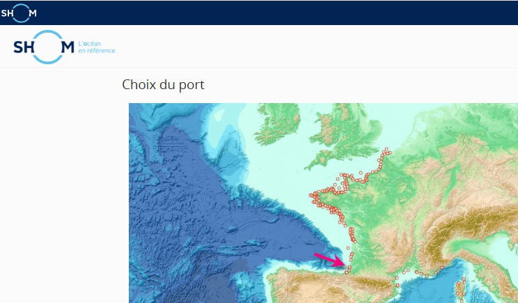

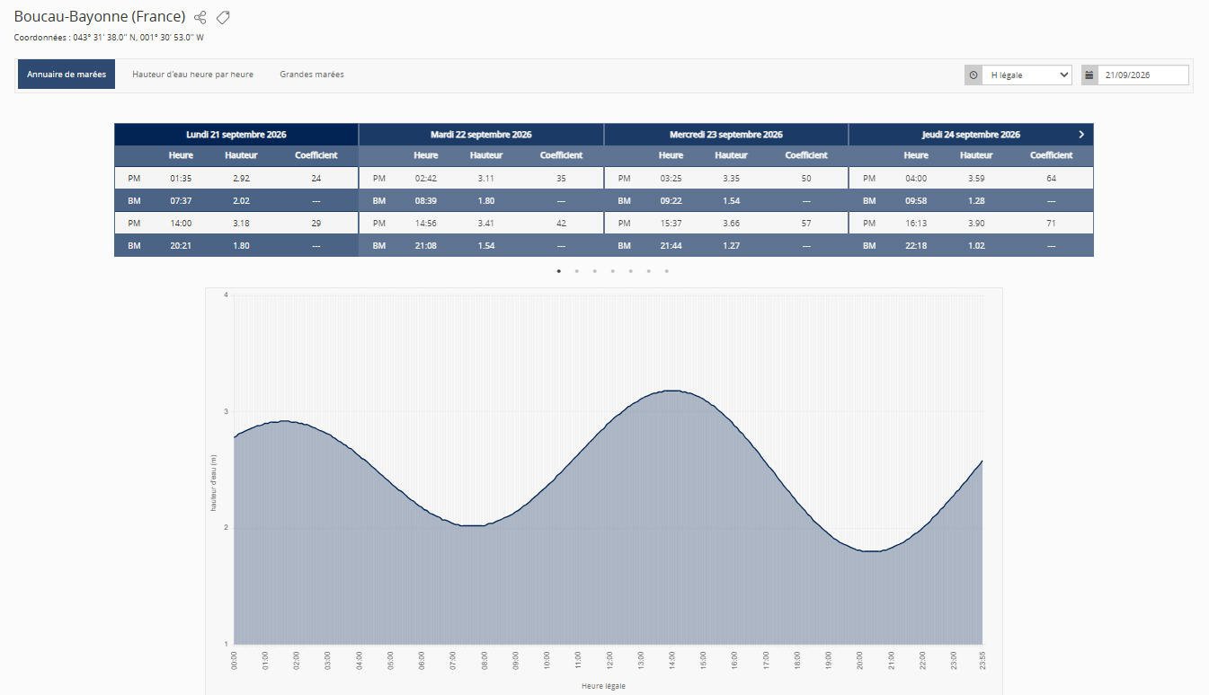

A water based tide clock
I wanted to "see" the tides so I built this tide clock
Specifications
Tide clocks are generally built from a quartz clock mechanism with an approximate period of 6h and 12 minutes (in France). So they are not very accurate nor fancy ...
I wanted to build a "real tide clock" that is a device showing the current sea level... with water !
The principle is rather simple and gives the basic specifications set of this project:
  • you just have to empty one bucket to fill another one at the exact cycle of the tides
  • to be "nice" one of the buckets must be fully hidden...
  • the pumps needed to fill/empty the buckets must be silent and tiny enough for the mechanism to be fully hidden
  • the device should be "artistic" (ie not ugly !)
  • And finally all this must be "smart" and connected to internet to follow the exact cycles of the tides at your local place and time
Here is a video of the project "almost finished". It should clarify how it works !
Tides in France and in the world
In metropolitan France, the tidal cycle consists of two high tides and two low tides each day, with an interval of approximately six hours and twelve minutes between each event.
The daily rhythm
  • Exact duration: This complete cycle lasts 24 hours and 50 minutes.
  • Shift: Tide times shift by about 50 minutes each day.
  • Alternation: The sea rises for nearly 6 hours (flood tide) and then falls for nearly 6 hours (ebb tide).
Amplitude and coefficients
  • Tidal range (the difference in height between high and low tide) varies according to the phases of the moon and the sun
  • Spring tides: During the new moon and full moon, the forces combine. Tides are stronger (high coefficients).
  • Neap tides: During the first and last quarters, the forces counteract each other. Tides are weaker.
  • Equinoxes: The year's largest tides occur around the spring and autumn equinoxes due to the optimal alignment of the celestial bodies.
Here is a daily cycle for Biarritz in France september 21rst 2026. It is provided by the French government institute SHOM  (Service hydrographique et océanographique de la Marine)
This almost sinusoïdal behavior is typical for France but not strictly identical for other countries (eg USA)
Tides main diffrences between France and USA:
Because both France and the United States have extensive coastlines bordering different bodies of water, comparing their tides depends on the specific region. However, there are key differences in tidal range (height), tidal cycles (frequency), and localized phenomena.
Tidal Amplitude (Height Differences)
  • France:
    • The Atlantic & English Channel: Northern and western France experience some of the largest tidal ranges in the world.
    •  During spring tides, water levels here can shift by as much as 12 to 14 meters (39 to 46 feet) between high and low tide.
    • The Mediterranean Coast: 30 to 40 cm (1 foot) due to the enclosed nature of the basin.
  • United States:
    • East Coast & Gulf Coast: Most of the US Atlantic coast experiences modest tides (typically 1 to 2 meters / 3 to 6 feet). The Gulf Coast has extremely small tides, often less than 0.6 meters (2 feet).
    • Exceptions (Northeast & Alaska): The US does have spots with massive tides. Northern Maine (near the Bay of Fundy) experiences ranges of 4 to 6 meters (13 to 20 feet), and parts of Alaska (like Anchorage's Cook Inlet) see tides exceeding 9 meters (30 feet).
Frequency and Timing (Tidal Cycles)
  • France: The entire Atlantic and English Channel coasts follow a semi-diurnal tide pattern
    • exactly two high tides and two low tides of roughly equal height every lunar day (about 24 hours and 50 minutes).
  • United States: The US features three distinct tidal patterns depending on the coast:
    • Semi-diurnal: Common along the East Coast (two equal high/low tides per day).
    • Mixed Semi-diurnal: Standard along the Pacific Coast (California, Oregon, Washington) and Alaska. This means two high tides and two low tides daily, but they differ significantly in height (e.g., one very high...
  • sealing and painting the model
    JP Gleyzes • 10/19/2026 at 08:57 • 0 comments
    Sealing the model
    Water will be put inside the hollow base. So the model must be totally water proof and sealed.
    I did paint the inside with liquid epoxy resin to seal it.
    Just wait one day for the resin to cure and you are now sure that potential porosity of the SLS powder has disappeared !
    You can now paint your model using acrylic paint.
    Allow it to dry for more than a day, then apply a two-component (2K) clear coat. This step is important for sealing the paint and adding a waterproof layer.
    I used the "SprayMax 2K" matte aerosol clear coat. It is a bit pricey, but well worth the cost! Apply it in very thin coats, paying special attention to the ladder, as it will remain submerged.
    Next, 3D-print the base using PETG filament.
    Insert the pump hoses into the designated openings; do the same for the LED. You can secure the hoses using B7000 glue, and the LED using clear epoxy resin.
    Viewed from underneath, two hoses are concealed within the rock, while two others are positioned on its rear side.
    The LED is hidden inside a small "cavern" created within the rock.
  • printing the 3d model
    JP Gleyzes • 10/19/2026 at 08:32 • 0 comments
    3d printing the 3d model
    Using FDM printer would give very poor results... So two options were open to me:
    • resin
    • SLS
    resin printing would have given the best details, but the model needs quite a lot of supports
    This is the reason why I prefered SLS powder printing
    Selective Laser Sintering (SLS)
    SLS 3D printing is an industrial additive manufacturing process that uses a high-powered laser to fuse polymer powder into strong, functional solid parts.
    How SLS Printing Works
    • Preheating: The printer heats a bed of fine polymer powder (usually nylon) to a temperature just below its melting point.
    • Sintering: A high-powered laser traces a digital CAD model's cross-section, selectively fusing the powder particles together.
    • Layering: The build platform lowers, a roller spreads a fresh layer of powder, and the laser repeats the process.
    Here are the main advantages of SLS 3D printing:
    1. No Support Structures Required
    • Because the part is constantly surrounded and supported by unsintered powder during printing, SLS requires zero support structures.
    • Allows complete geometric freedom (overhangs, deep channels, hollow interiors).
    • Enables printing fully assembled interlocking parts and moving mechanisms in a single build.
    • Saves time during post-processing by eliminating manual support removal.
    2. High Production Throughput & Part Packing
    • Without the need for support structures, parts can be nested closely together in 3D space throughout the entire build volume (known as 3D nesting). You can print dozens or hundreds of parts in a single build cycle, making SLS highly scalable for small to medium production runs.
    3. Superior Mechanical Properties & Isotropy
    • SLS parts offer high tensile strength, impact resistance, and durability. Because the laser melts layers together homogeneously, parts exhibit nearly isotropic mechanical behavior—meaning their strength is almost identical across the X, Y, and Z axes, unlike FDM printing, which suffers from weak layer bonding along the Z-axis.
    4. Industrial-Grade Engineering Materials
    • SLS primarily uses high-performance thermoplastics, most notably Polyamide (Nylon 11 and Nylon 12). These polymers offer excellent chemical resistance, heat tolerance, and structural integrity suitable for end-use functional prototypes and production components.
    5. High Accuracy and Detail Precision
    • SLS lasers achieve sharp edge definition and fine feature resolution. This allows for tight tolerances, making it well-suited for complex mechanical assemblies and precise enclosures.
    PCBWay SLS service
    PCBWay is well-known for high-quality PCB manufacturing. However, they also offer a wide range of prototyping services, such as CNC machining and 3D printing.
    For my tide clock, I was able to test their impressive SLS manufacturing service.
    Ordering is very simple, you just have to select the right options and upload the .3mf file. Then the order goes into the Request For Quotation process and you will enter into contact with your Sales Representative to evaluate technical feasibility.
    All this lasts less than one day, which is great !
    Wait a few days and you will get your part!
    Result is impressive !
View all 2 project logs
