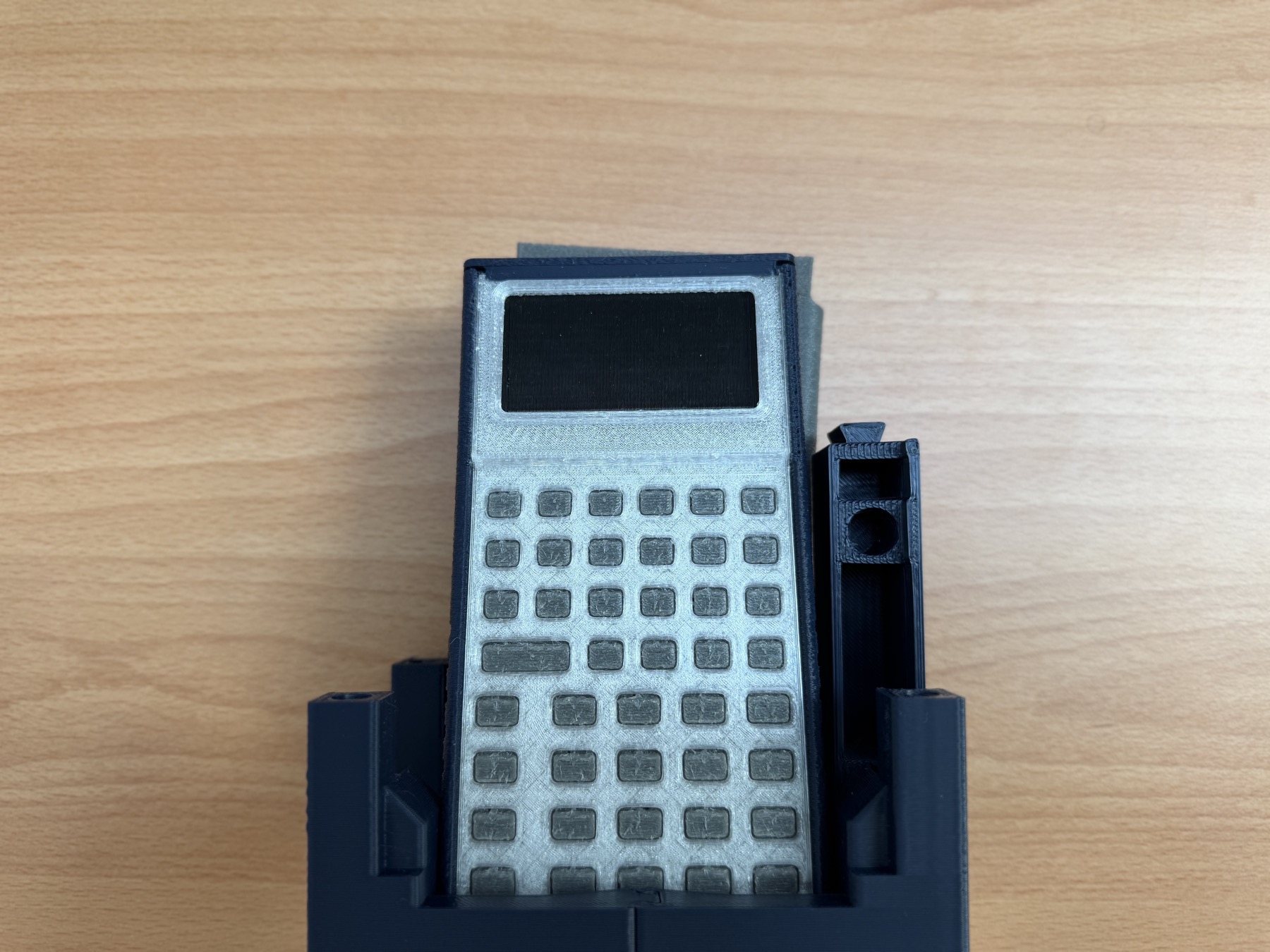

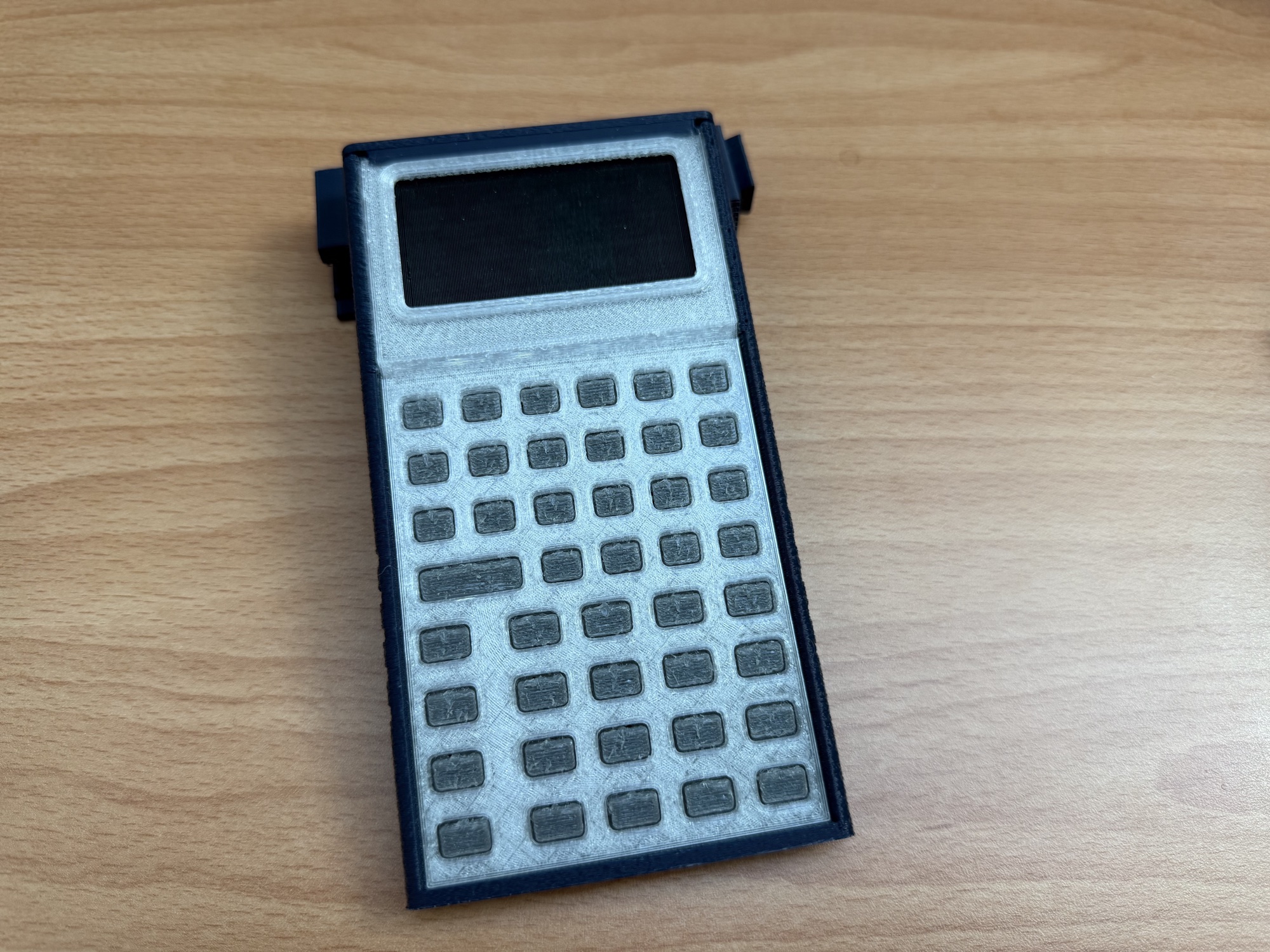

Printed StackCalc mechanical calculator prototype
What is on the desk now
The current physical prototype is a four-part mechanical assembly: a tapered chassis with internal rails, a unified faceplate, a TPU keypad membrane with a wide ENTER key, and a snap-retained top cap. The parts slide and close without screws, glue, or a separate fastener kit. We printed earlier button fixtures with print-in-place springs, then moved to the TPU membrane because it gives us one continuous alignment layer and a faster way to change key geometry.

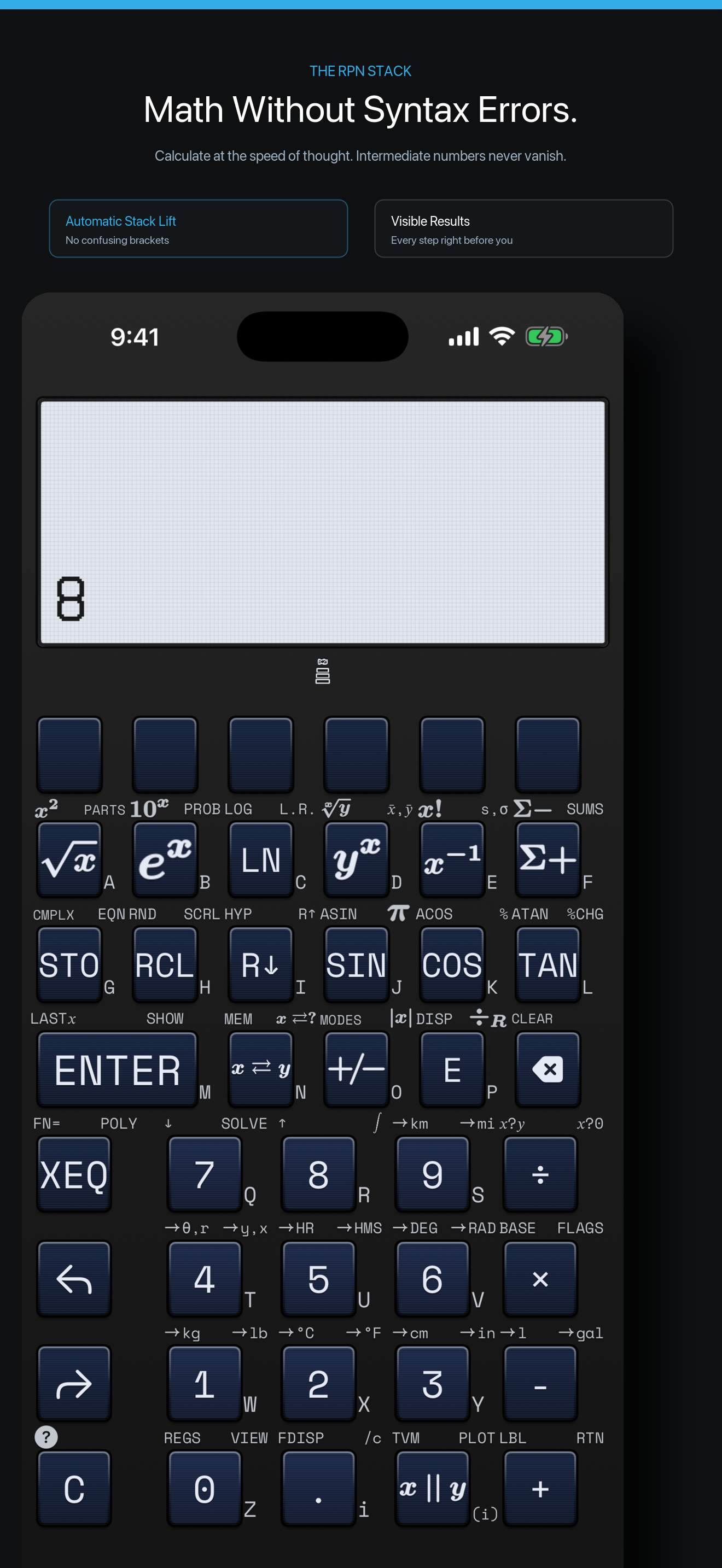

The companion app is live on iPhone, iPad, and Apple Watch. It shares an RPN calculation model with the project’s other surfaces: values enter onto a four-level stack, ENTER controls the stack transition, and operations consume the visible values. The firmware path compiles the embedded calculator image, feeds it row-and-column matrix contacts, and reads the 132 × 65 framebuffer back from an RP2350 emulator. That lets us exercise key routing, display rendering, state persistence, and idle-loop behavior before board bring-up.

Printed StackCalc prototype in its shelf stand

The photographs show unlabelled fit prototypes. Button legends are a separate engraving step after the mechanical iteration, so the blank key faces in these images are intentional. The KiCad RP2350 board design is complete and in fabrication; it is not installed in the pictured mechanical assembly. Watch the 24-second proof reel for the prototype, app, and simulation sequence.
