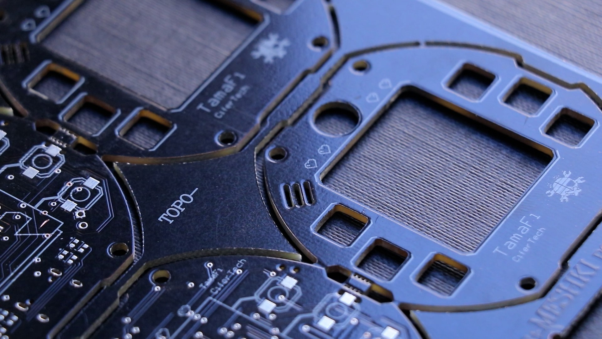

🔩 The Hardware
The board runs on an ESP32-S3-WROOM-1. Dual core, WiFi and Bluetooth built in, native USB.
The single most important constraint on this board is memory. It has no working PSRAM. That limits the display to one memory buffer for the entire face, 240 by 240 pixels. A second buffer fails to allocate, full stop.
The original TamaFi used a sprite sheet for its face, pre-made bitmaps swapped in and out. That needs more memory than this board has room for. So this version builds the face directly from code instead, drawing it fresh every frame rather than loading stored bitmaps. That one memory limit is the reason the entire face system had to be rewritten.
The rest of the board:
- Display: ST7789, 240 by 240, SPI
- Microphone: INMP441, listens for nearby speech
- Speaker: MAX98357A amplifier driving a real speaker, replacing the old basic buzzer. If free memory drops too low, sound disables itself automatically
- Motion: MPU6050 accelerometer and gyroscope, tilt and gestures, shake, tap, flip
- LEDs: four WS2812 addressable RGB LEDs for status feedback
- Buttons: six total, three for menus, three for direct shortcuts to pet status, environment, and a short activity log
- Power: single-cell lithium battery through a TP4056 charge controller, stepped down to 3.3V by an LF33 regulator
- Backlight control: SI2302 MOSFET, switched under firmware control
- Connectivity: USB-C for charging and flashing
There's also an OV2640 camera connector on the board, wired through a 24-pin FPC connector, the same camera used on ESP32-CAM boards. It doesn't work right now, and not because the firmware skips it. After building the library setup in Altium and following the camera's documentation, it wouldn't respond. Hours of debugging the actual hardware later, a closer look at the schematic against the real OV2640 module showed the connector's pin arrangement is reversed. That's a board-level mistake, not something firmware can fix, so it stays unused until a future revision corrects the connector layout. Several of its signal lines also share GPIOs with three of the buttons, so even once the pinout is fixed, the camera and those buttons still can't run at the same time.
An LDR light sensor and capacitive touch pins are planned for a future revision. Neither is on the current board.

💻 Code & PCB
Everything is open source. Code, schematic, and firmware are all on GitHub.
GitHub repository: github.com/cifertech/TamaFi
🧡 Sponsored by NextPCB
Thanks to NextPCB for supporting this build. If you're making your own TamaFi, the Gerbers are in the GitHub repo, upload the zip, default settings work fine. www.nextpcb.com
