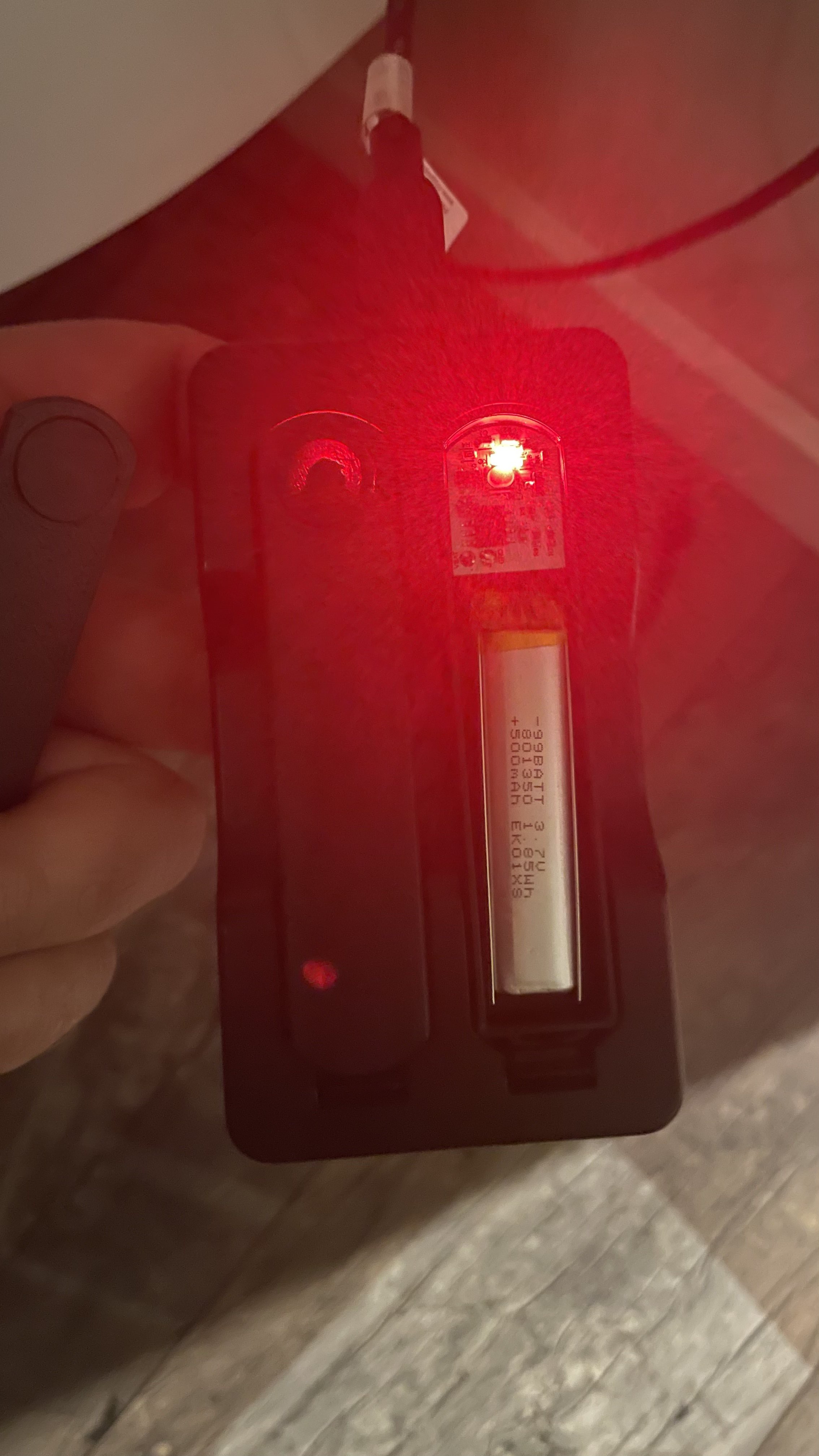

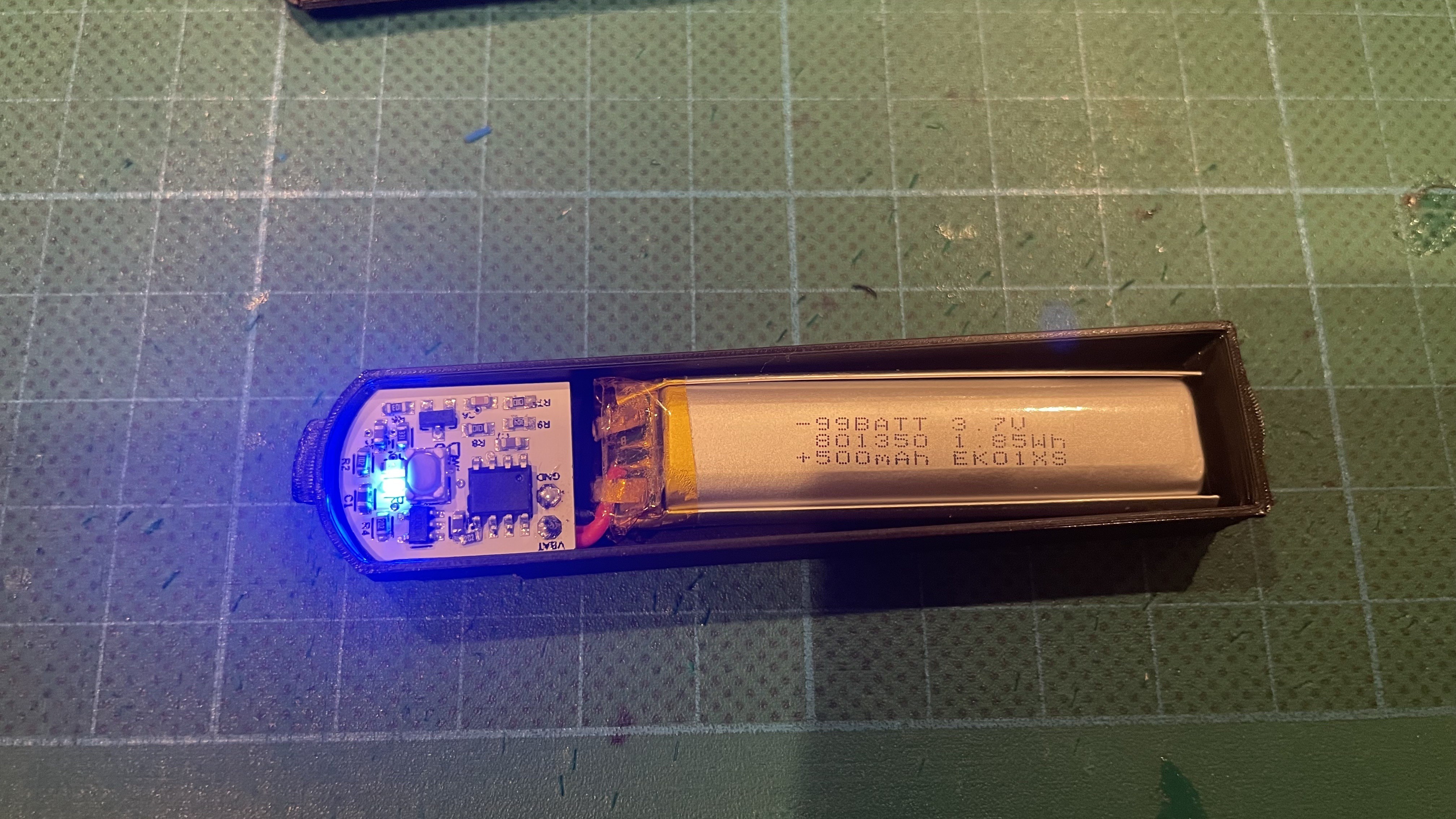

I love my Revolights Eclipse bike light. Unfortunately the company went down long time ago and nearly all remaining systems should struggle with the battery now. I tried to exchange the battery cell itself but I turned out the charging board itself was damage. So I decided to create a new one to bring the Revolights back to life.

  • Out for a ride...
    CF • an hour ago • 0 comments

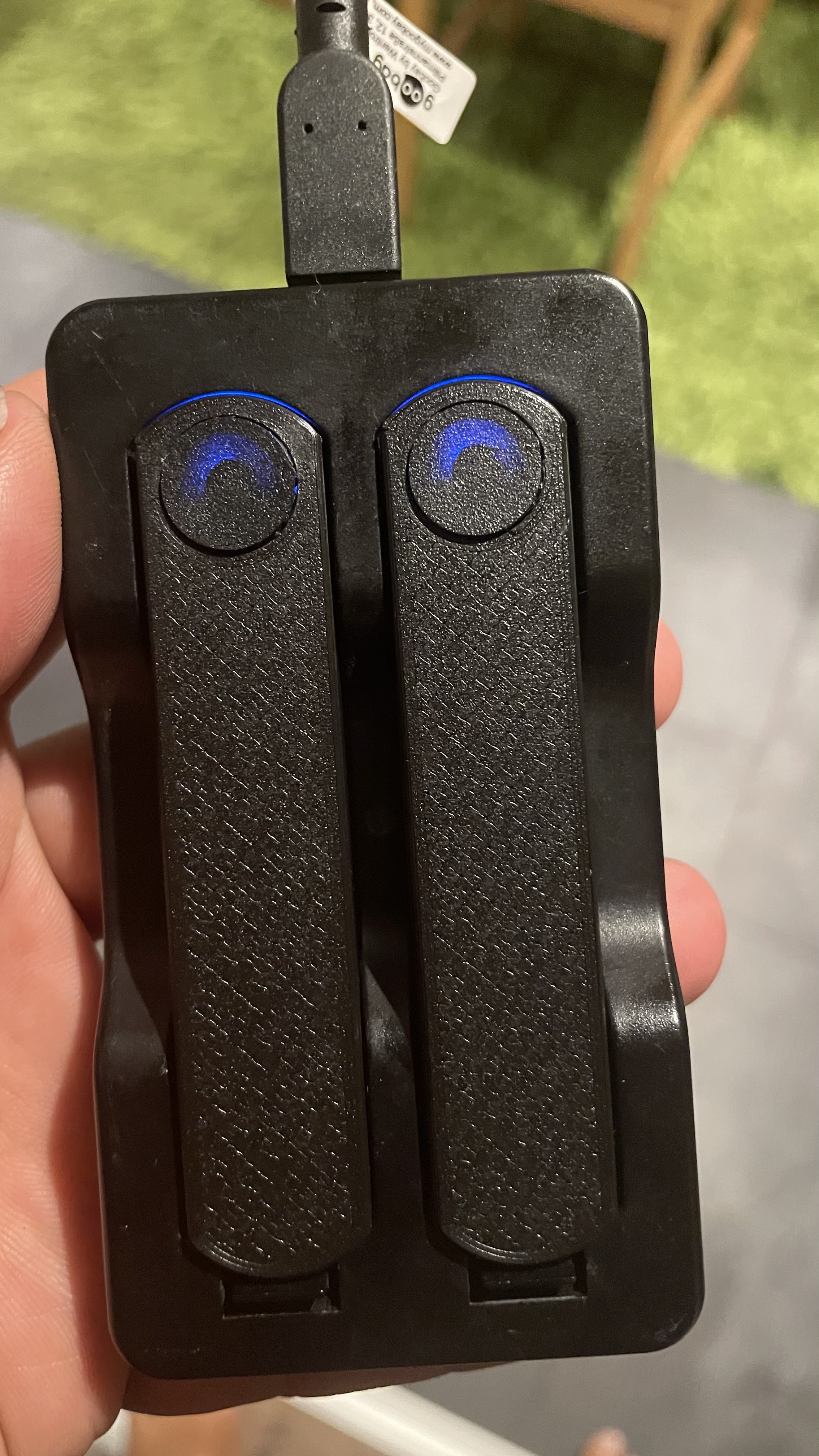

  • All parts together
    All parts together with a first test of running and charging.

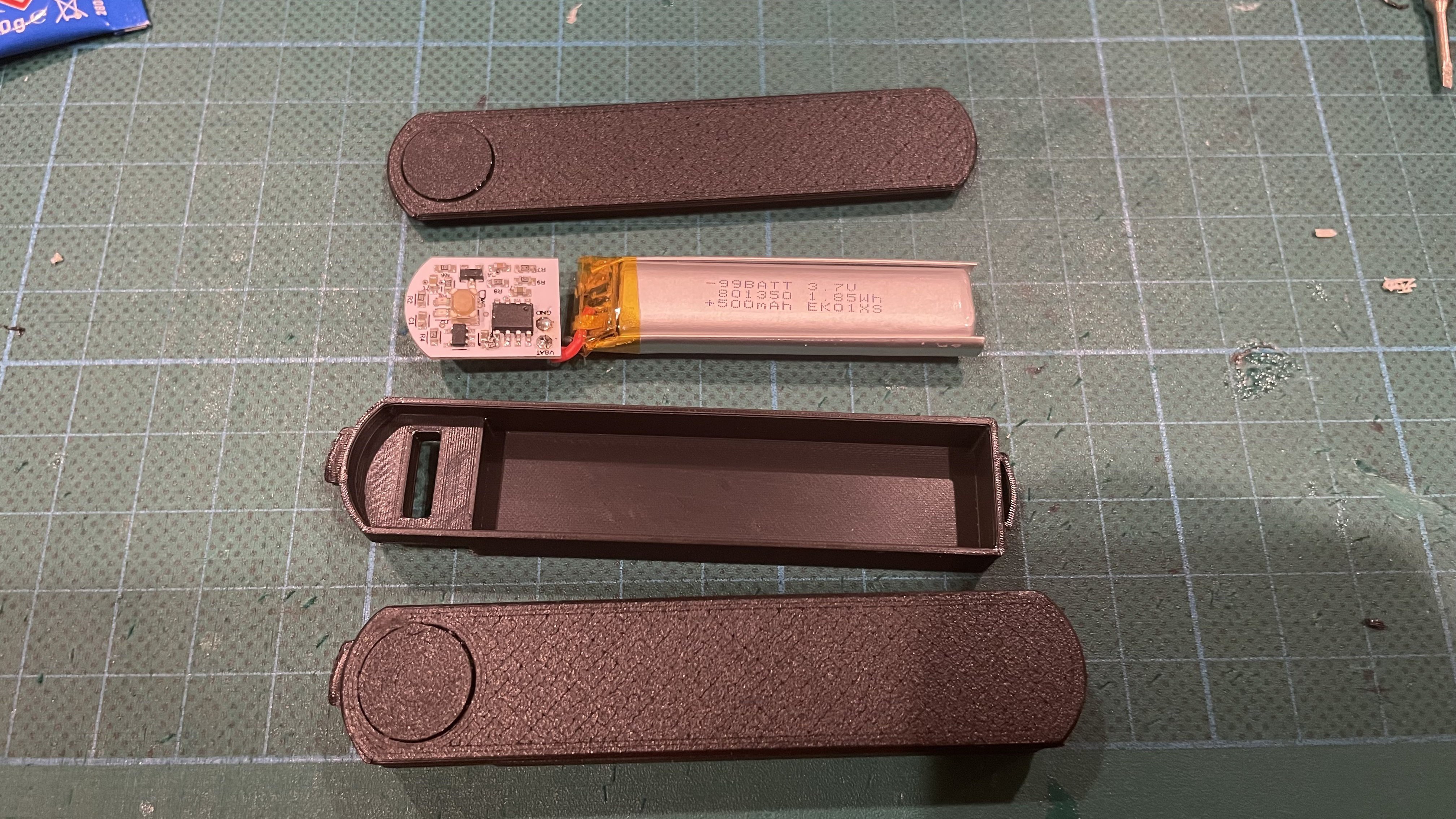

  • New Housing
    The new housing printed in PLA. The button cover is made of TPU.

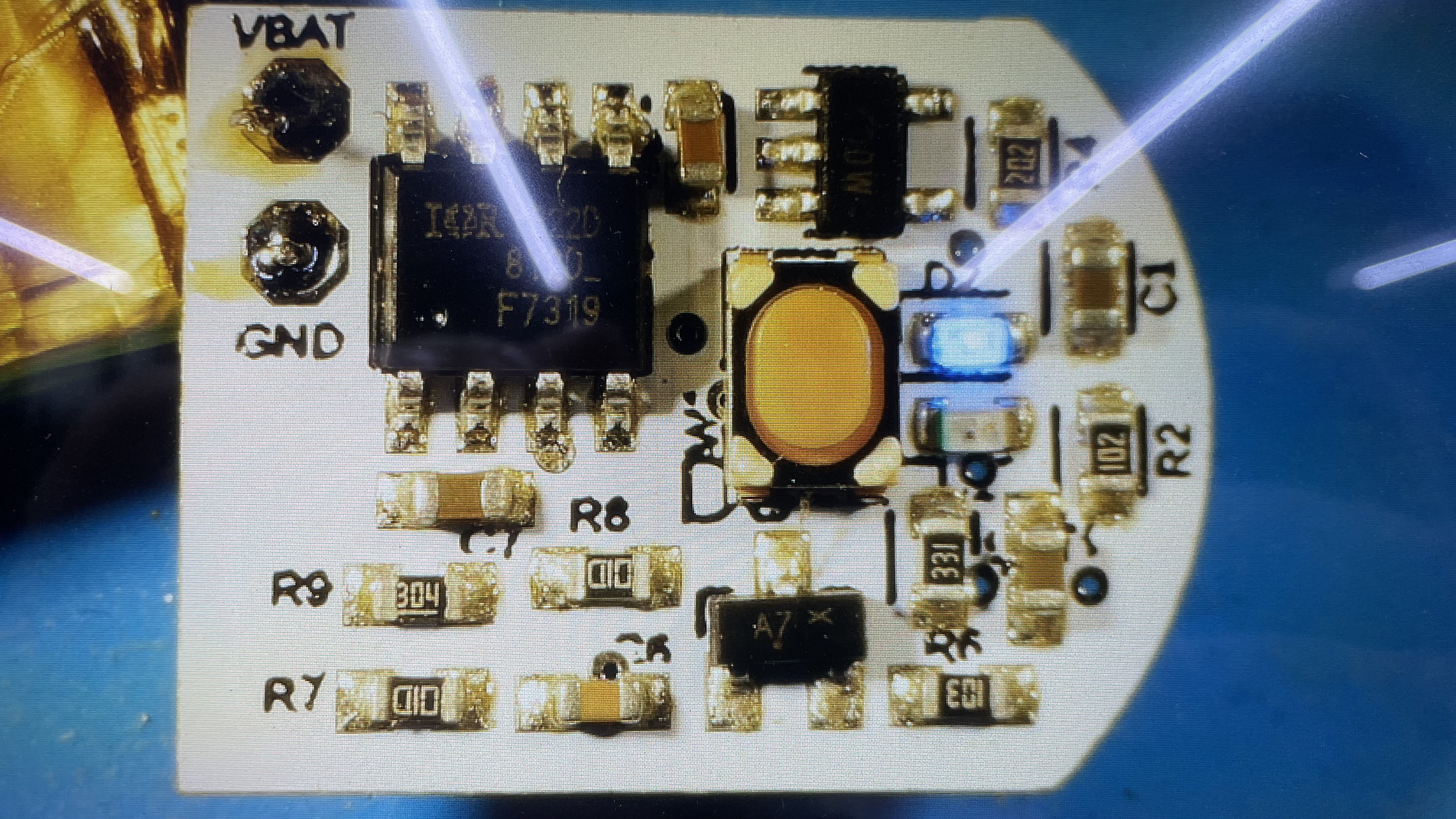

  • New PCB
    My new PCB comes with a charging circuit using the very common MCP73831 IC, two LEDs (red and blue) showing either the charging or the power status and a push-button to turn the battery on and off. I short push will start the lights, a longer one will turn them off.

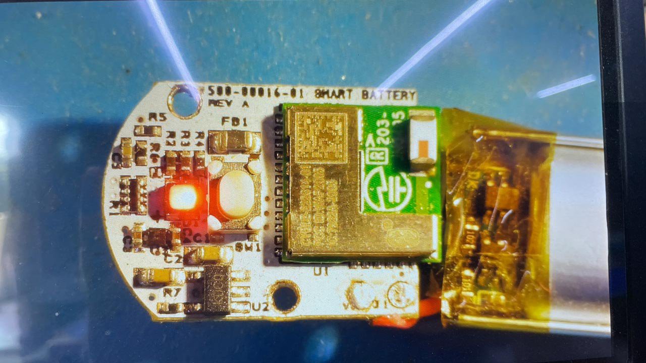

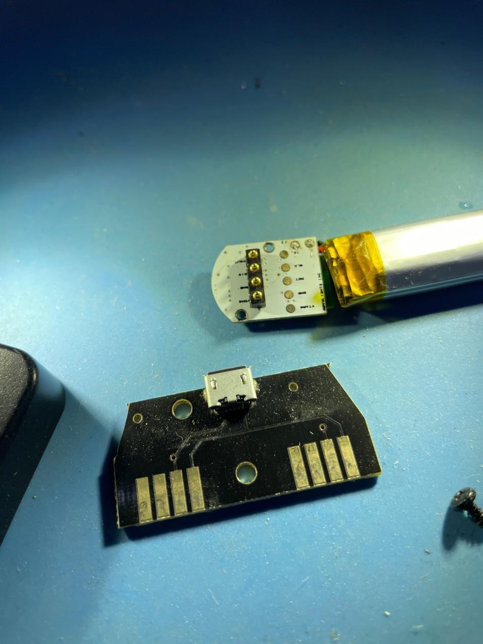

  • Original Battery
    After opening the original battery this is what you'll find inside. I bought the plus-version including bluetooth connectivity. Since the App is not available anymore this feature was not necessary anymore.
    The charging board itself is rather simple:
