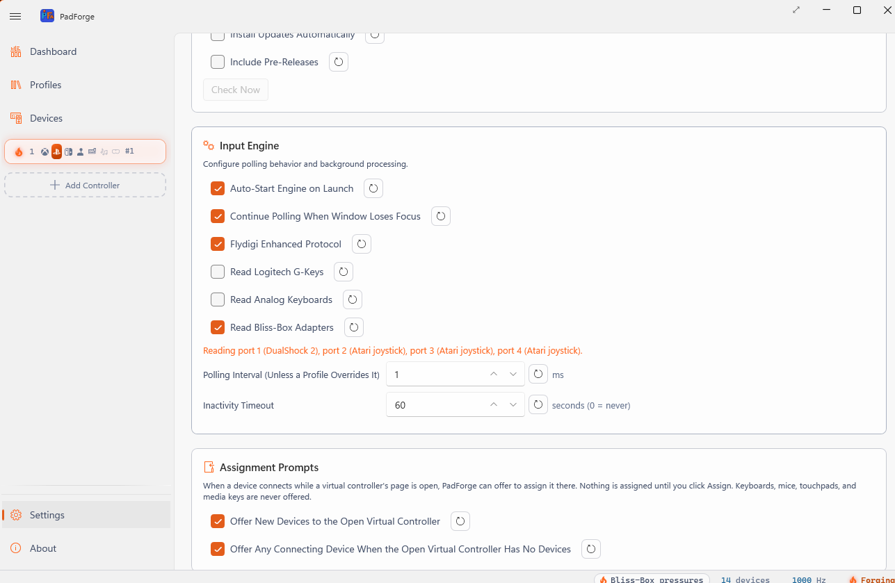

4) Go to setting and scroll  down to input engine and check Bliss-Box
If the Bliss-Box is attached it will see the devices.

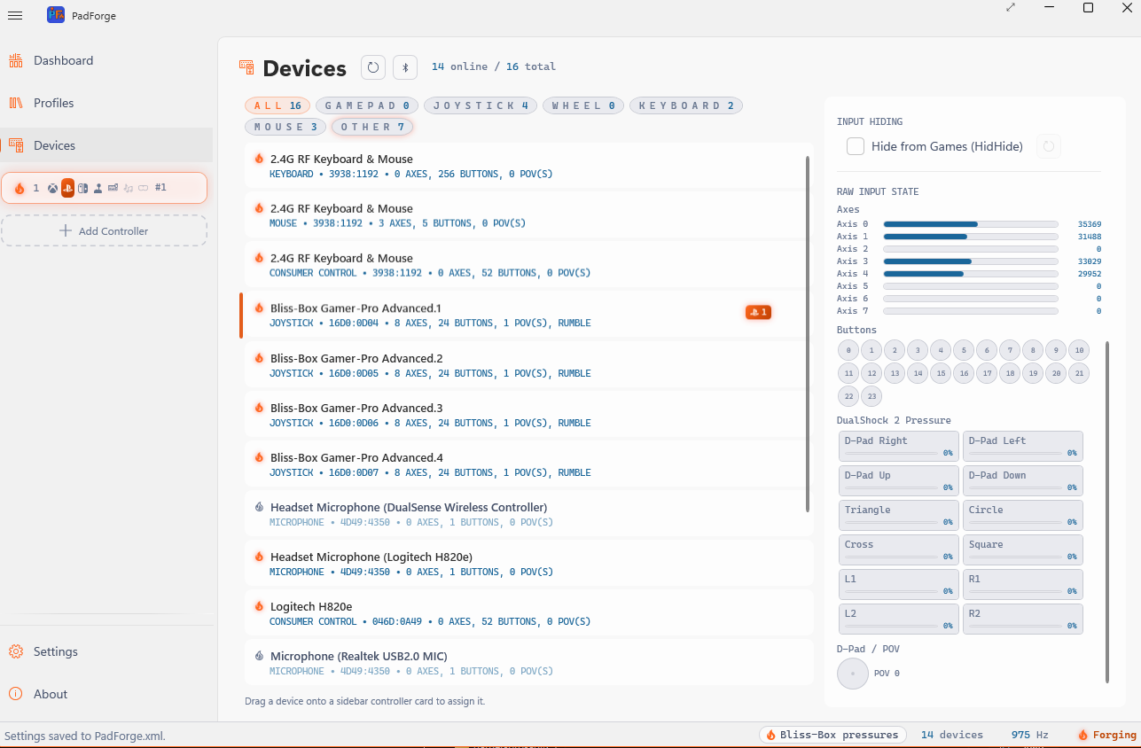

5) go to the devise section and click on the  Device, here you can test the pressures.
Make sure to add  virtual device.

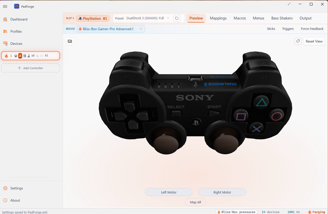

6) go to dash board and double click the virtual slot you made, in there go to preview and select ps3 full

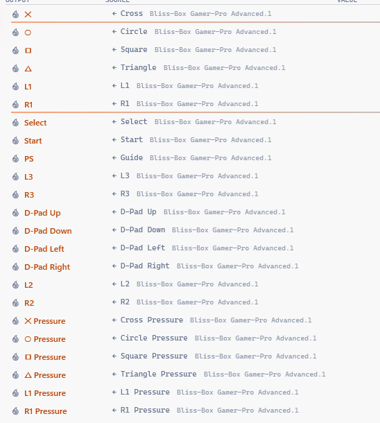

7) Go to mapping and use one of the various way to map each button do not for get the pressures at the bottom.
Once finished you can test the basics mappings in the preview. Make sure to leave pad forge running and close any other application using Bliss-Box. Pad forge runs in the back ground to simulate a ps3.
