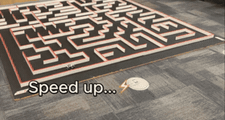

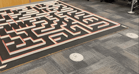

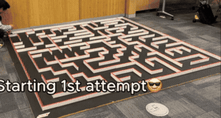

On the organizers' results sheet, Neuromouse is ranked 3rd Overall: maze complete, 54 cells visited, 59.715 s. Three teams completed the maze; ours was the third. The UCLA IEEE livestream's results panel shows the same numbers, plus our other two runs: 86 cells in 180.856 s (complete) and 7 cells in 8.166 s (incomplete). My own video labels the 59.7 s run as our third attempt.

Explore run on the AAMC 2026 maze, from my run video.
Fast run with straight-chain acceleration, from my run video.

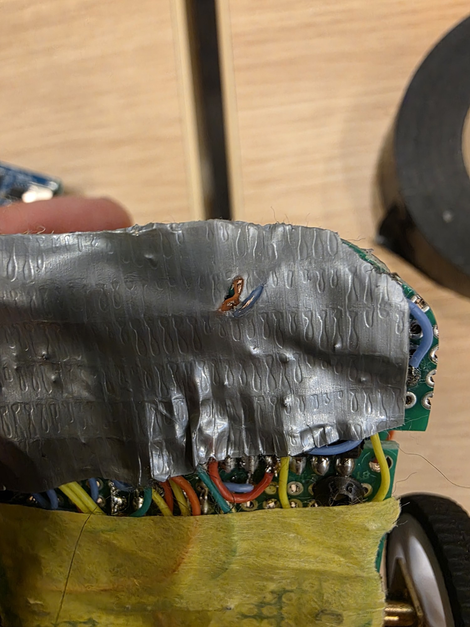

CELL_TICKS = 1373. - Some ideas failed on site. Fusing straights during Explore, tried at UCLA the day before, let lateral drift build up, so the outbound leg brakes every cell. Right-hand single-wheel pivots bumped side walls, so the planner dropped pivot turns.
- Put a screen on the robot. You get about five minutes between runs. Plug in, read the OLED, go again.
Wiring taped down during the overnight fixes before the contest.
