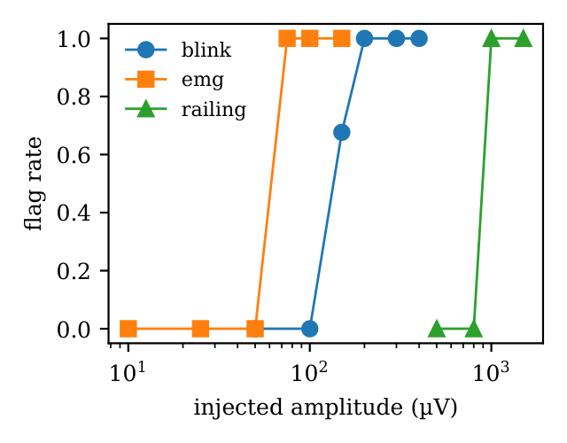

Real data caught a problem the synthetic tests missed. The amplitude-only blink detector fired on 39.5% of eyes-closed occipital windows, and large alpha almost certainly set it off. The flag doesn't lower confidence, but it still tells the model something false.
Artifact flag rate against injected amplitude for blink, EMG and railing.
