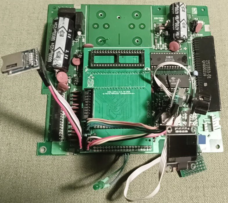

The project started as an experimental daughterboard mounted on an original Commodore 1551 mainboard that I bought off ebay. I only had this mainboard with the original 6510T and ROM, but without the TPI chip, without drive mechanism and any kind of enclosure.
That early version reused the original CPU, RAM and ROM while the Pico 2 emulated the floppy electronics and the CPLD replaced parts of the original interface logic.
This prototype was used to verify the TCBM communication, the idea to reduce part count by generating CPU clock and IRQ signals from Pico as well as checking if 6523 and glue logic for ROM/RAM generated by CPLD works correctly.
After the experimental board proved that the approach was viable, the design evolved into a complete standalone motherboard.
