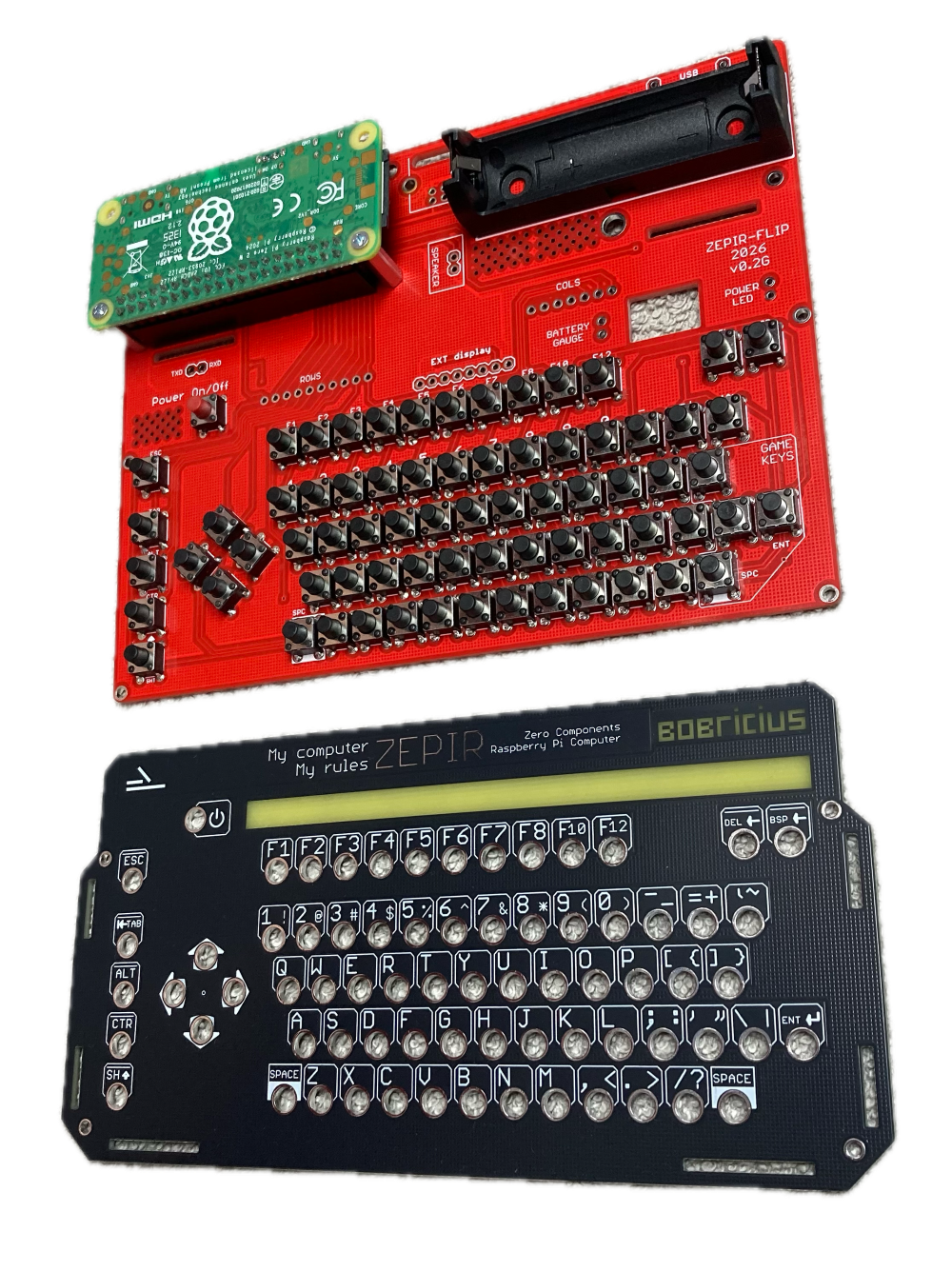

Zepir is more than just a small computer. It is an experiment in simplicity, accessibility, and user control. No exotic chips, no complicated firmware modifications, and no unnecessary layers between the hardware and the person using it. The keyboard is read directly through GPIO using a Python script and Linux evdev input emulation. Sound is generated using PWM instead of a dedicated I²S audio chip.

  • Keyboard: Full physical keyboard with direct GPIO scanning
  • Keyboard software: Python and Linux evdev input emulation
  • Audio: PWM-generated sound, without a dedicated I²S audio chip

The keyboard does not require a specialized keyboard controller. Instead, its keys are scanned directly through the Raspberry Pi's GPIO pins, with a Python script translating the input into Linux events.
Sound generation follows the same approach, using PWM rather than adding a dedicated I²S audio chip.
The design avoids components that require complicated soldering, proprietary firmware modifications, or elaborate configuration procedures. Fewer specialized parts mean fewer barriers to understanding how the machine works.
