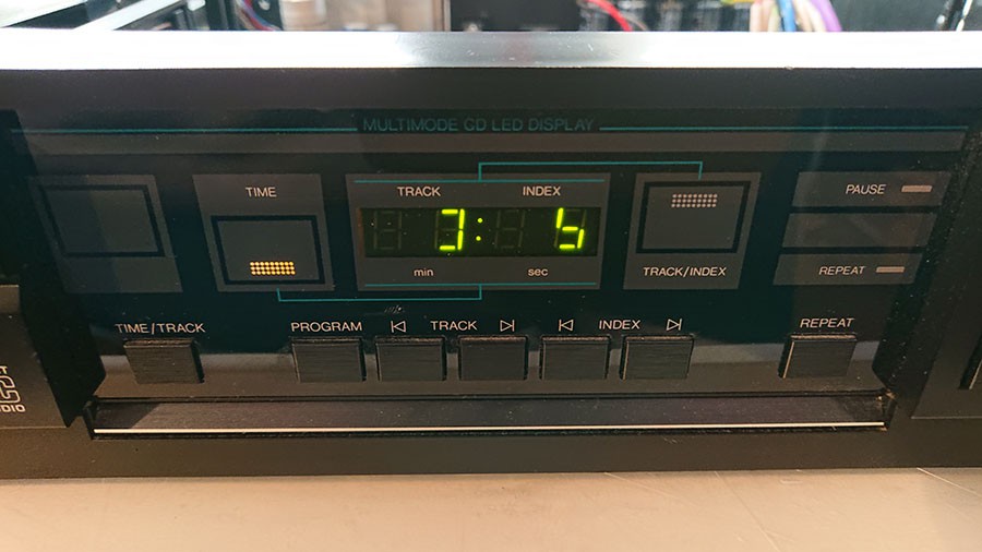

The CD480's original LED display is one of the weak points I kept hearing about from other owners. It can fail, and replacements are not easy to find.
I found an existing replacement approach, but I wanted to try a different one. My goal was to make a board that fits the original display area, brings the modules closer together, and uses a modern driver. I also wanted to keep the door open for experimenting with custom display patterns later.

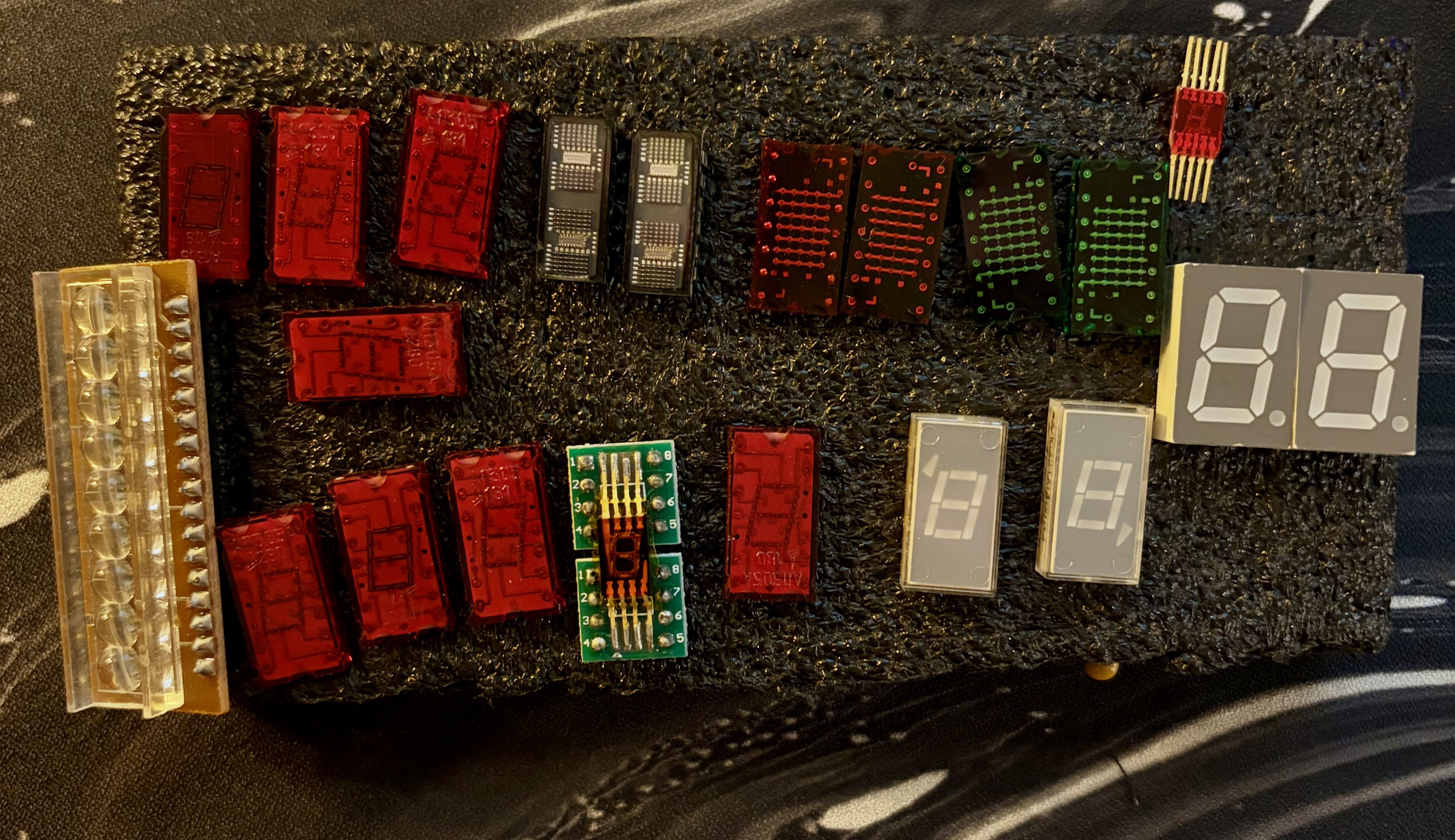

I started by looking through my parts box. I found a few DSP2913 and HSP200 modules, but they were a little too small for the space available. The LTP-305G and LTP-305R 5x7 LED matrix modules looked like a much better fit, and I already had some on hand.
The matrix displays give me more flexibility than a fixed 7-segment digit. The same general idea could also be adapted to other display modules, but this version is designed around the LTP-305 footprint.

Reusing the original controller would still be a bit of a gamble for me. I sourced some supposedly "new" MM5450 LED drivers from a well-known marketplace. Sure enough, the one I soldered in, despite my efforts not to stress it too much, does not seem to be fully functional. It shows signs of at least two defective or shorted segments.
That has also been my experience with quite a lot of "new old stock." The odds may not be exactly 50/50, but there is still a very good chance of receiving rejected, counterfeit, or partly defective ICs.
For that reason, I focused on making a solution based on modern LED drivers. I also wanted it to be flexible, so I could later replace the 5x7 matrix displays with 7-segment displays in the same physical space and keep the same character alignment.
