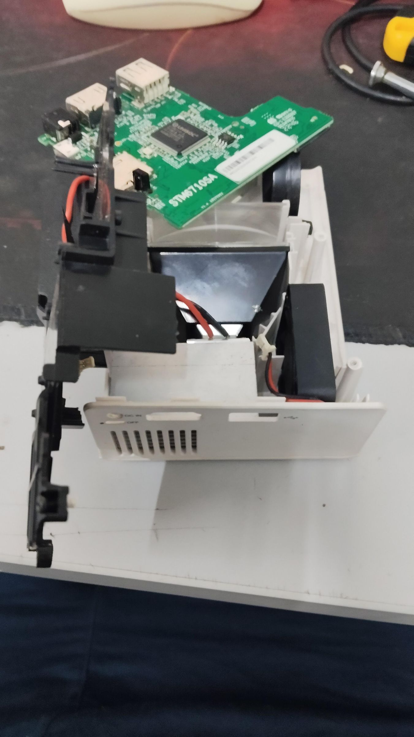

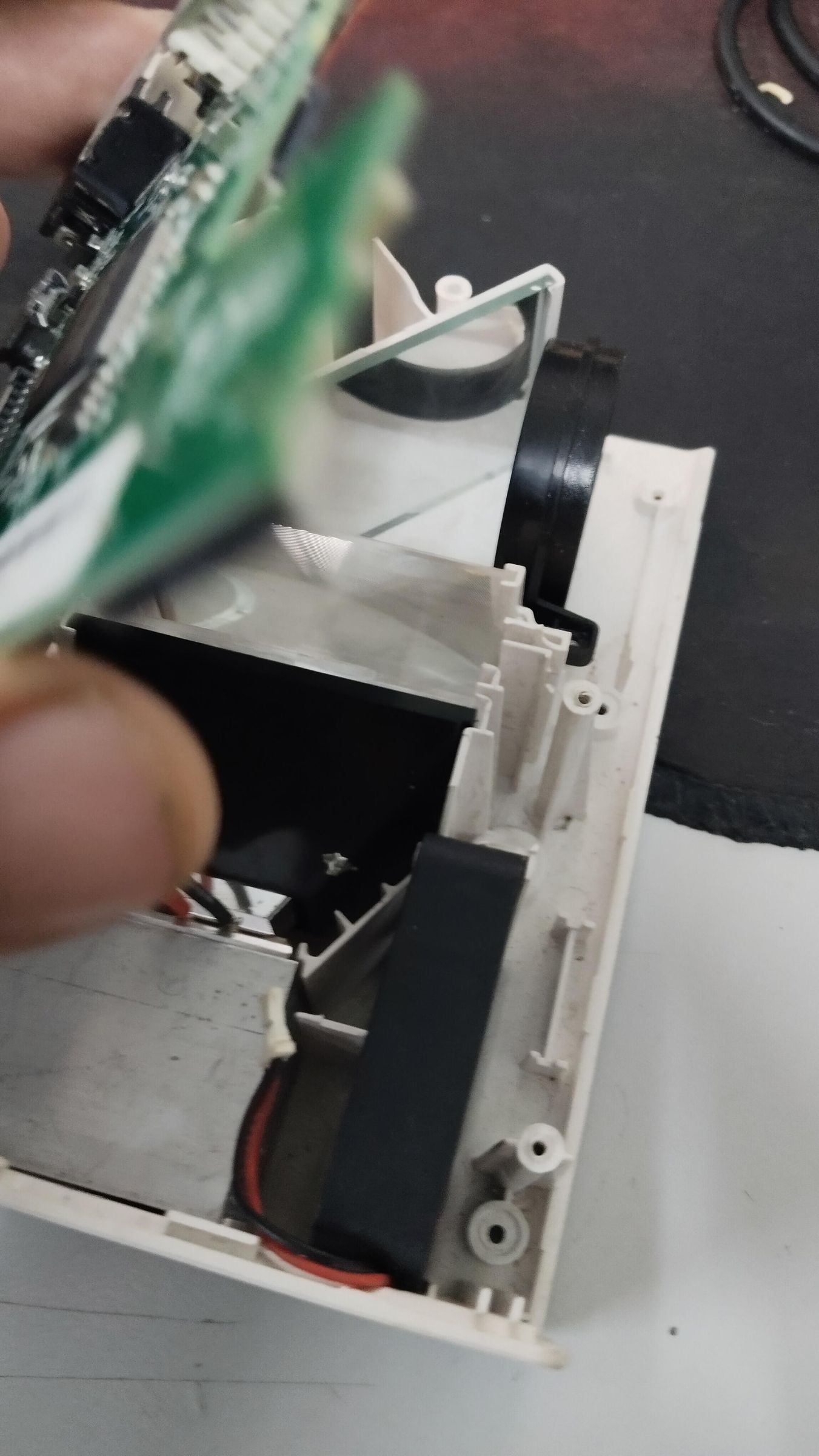

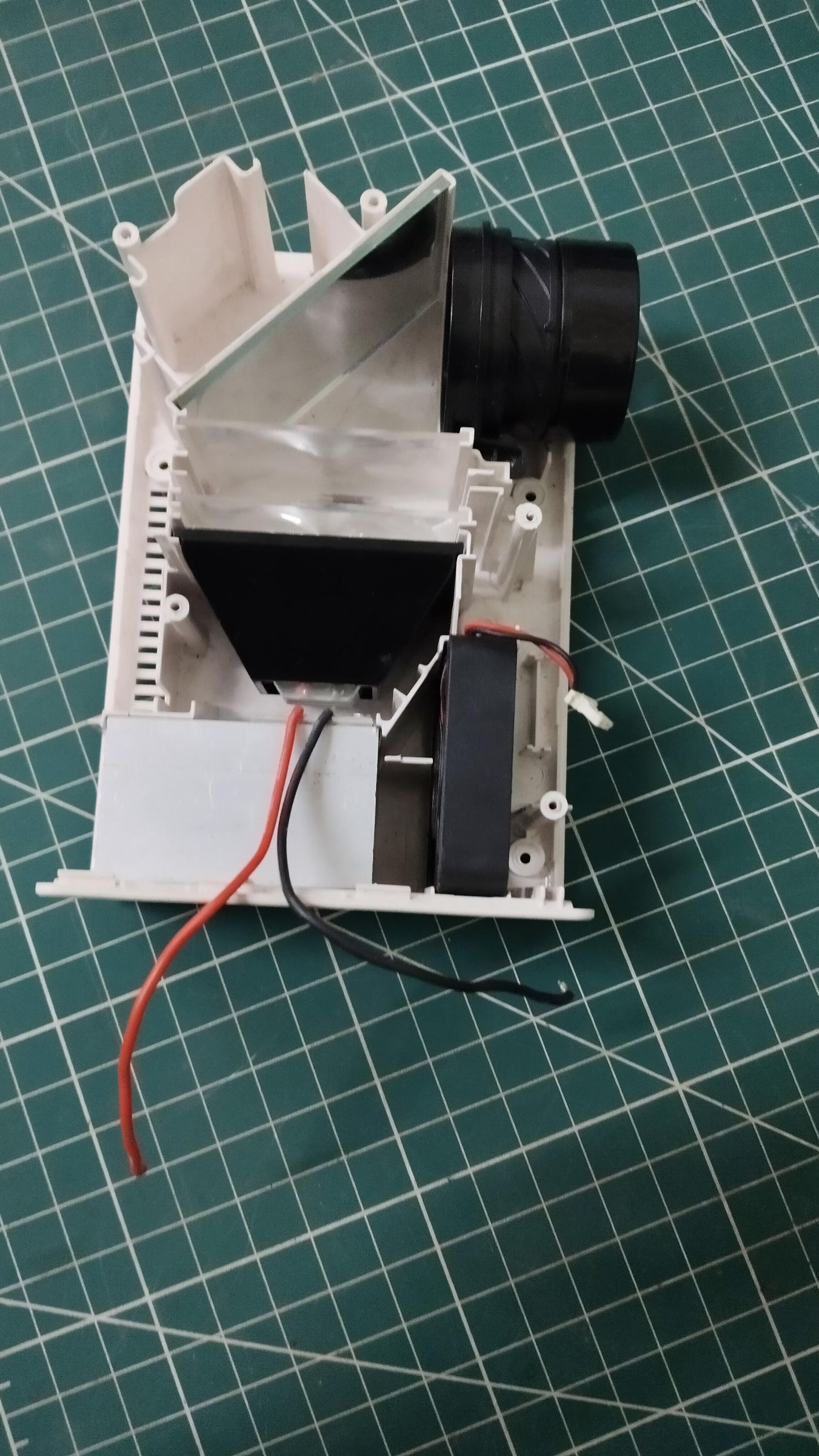

Step 2: OPENING THE PROJECTOR

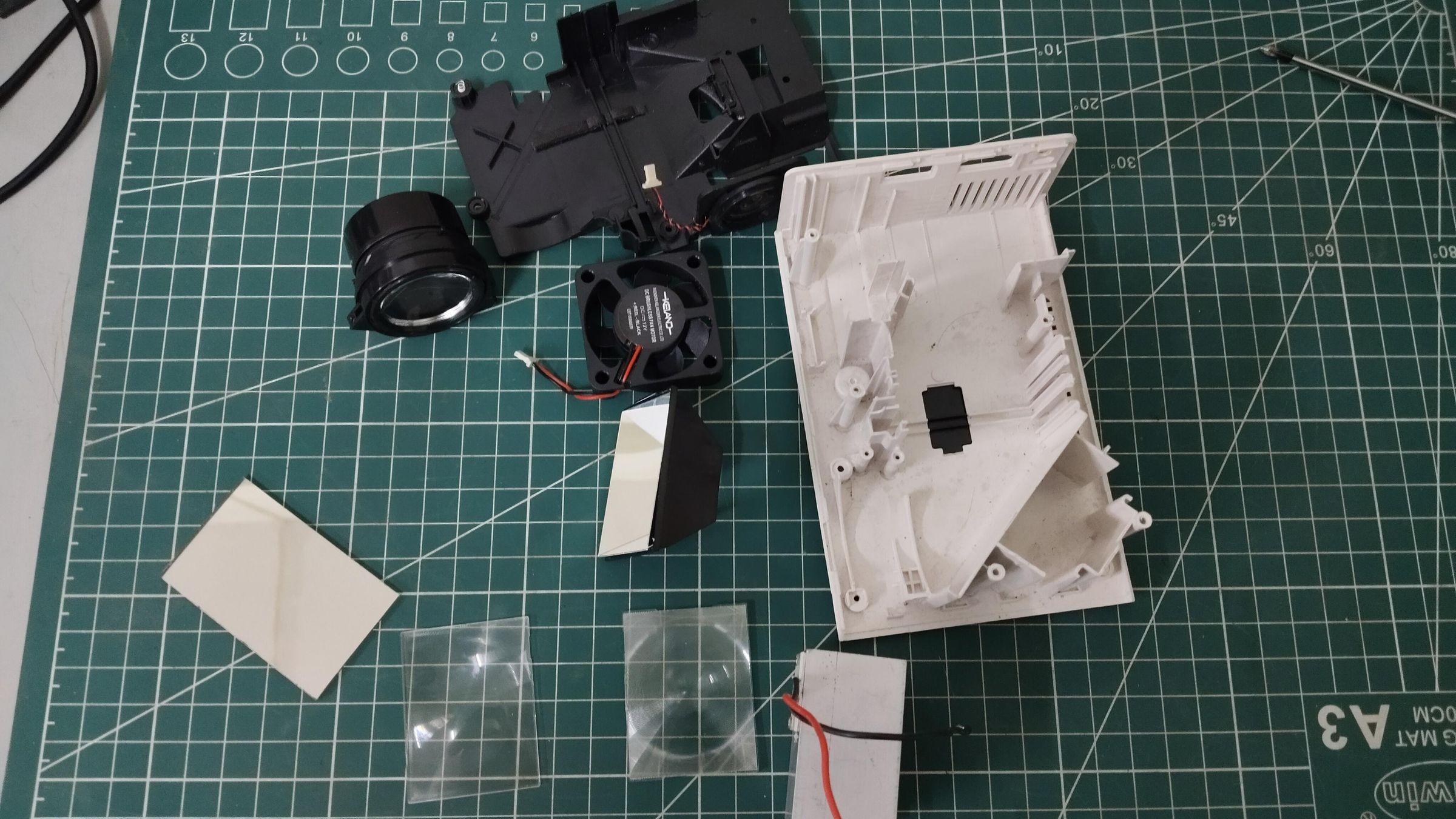

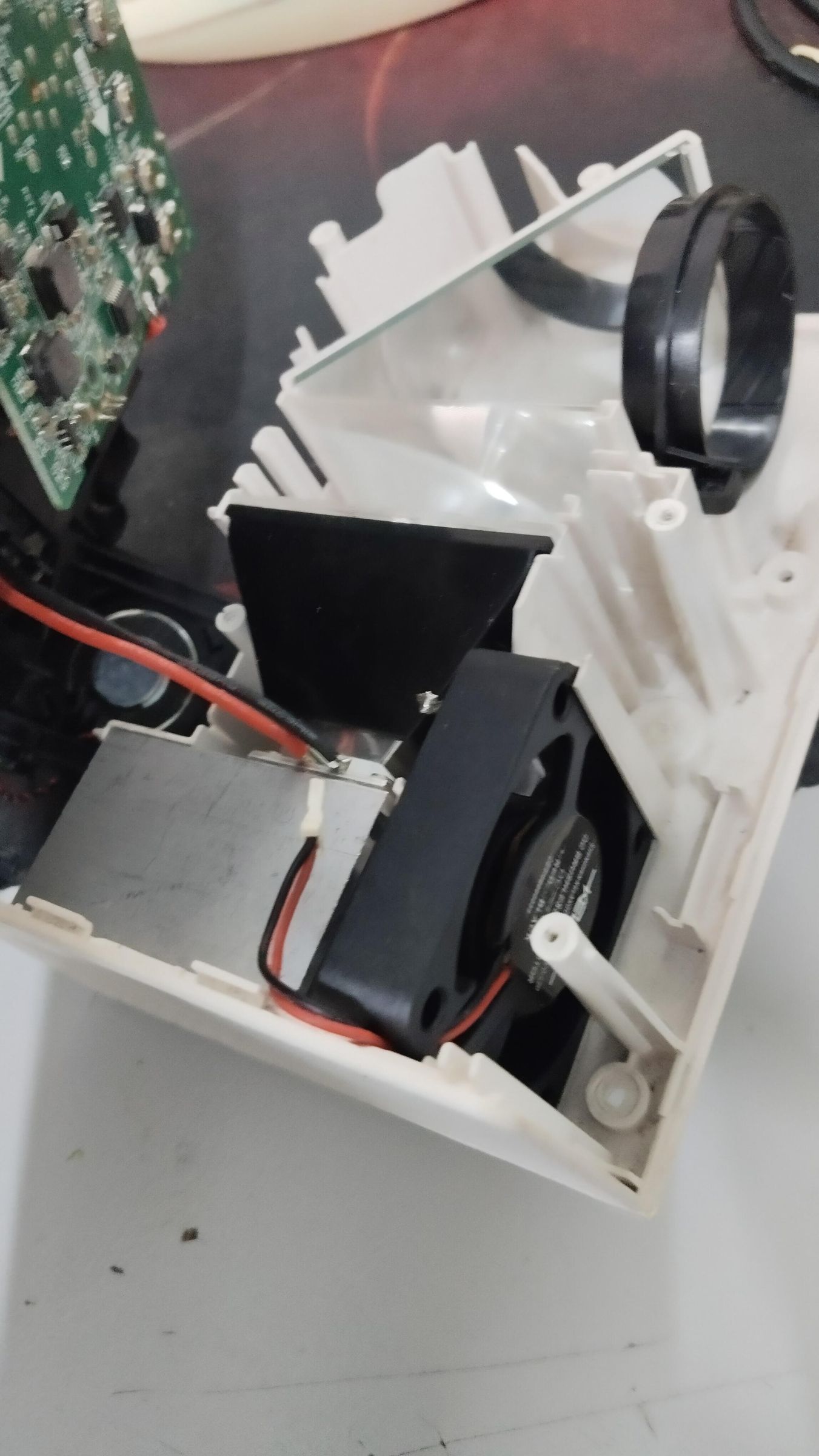

I opened the projector and inspected the internal components.
The main control board was no longer working, but several important components were still usable.
The optical system, projection lens, mechanical parts, cooling system, and other components could potentially be reused.

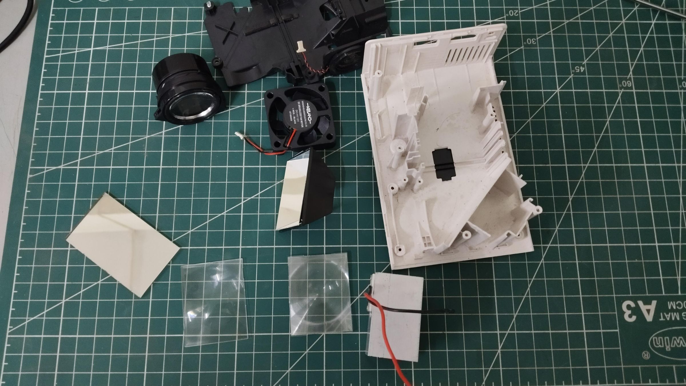

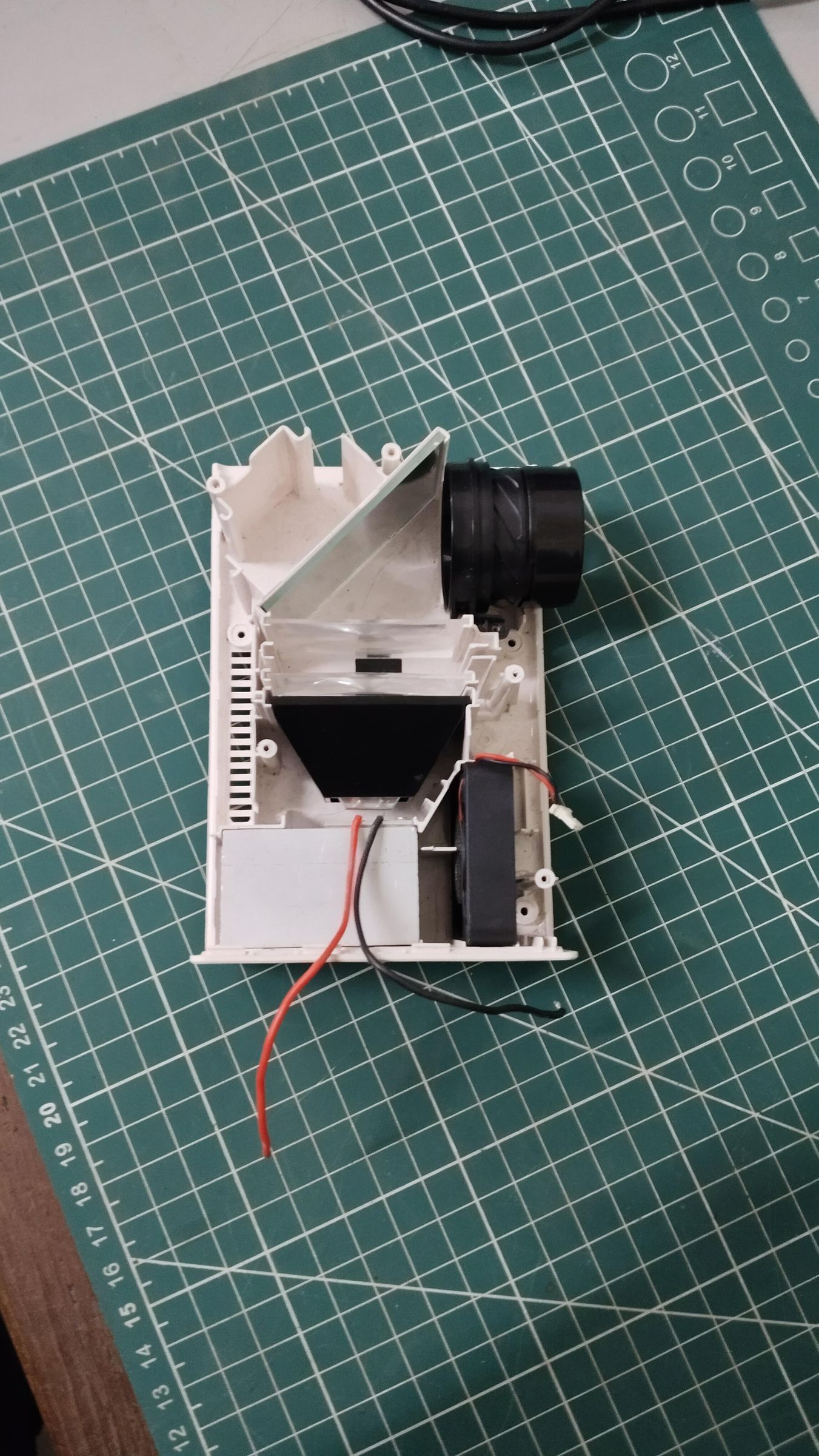

Step 3: DISASSEMBLING THE OPTICAL SYSTEM

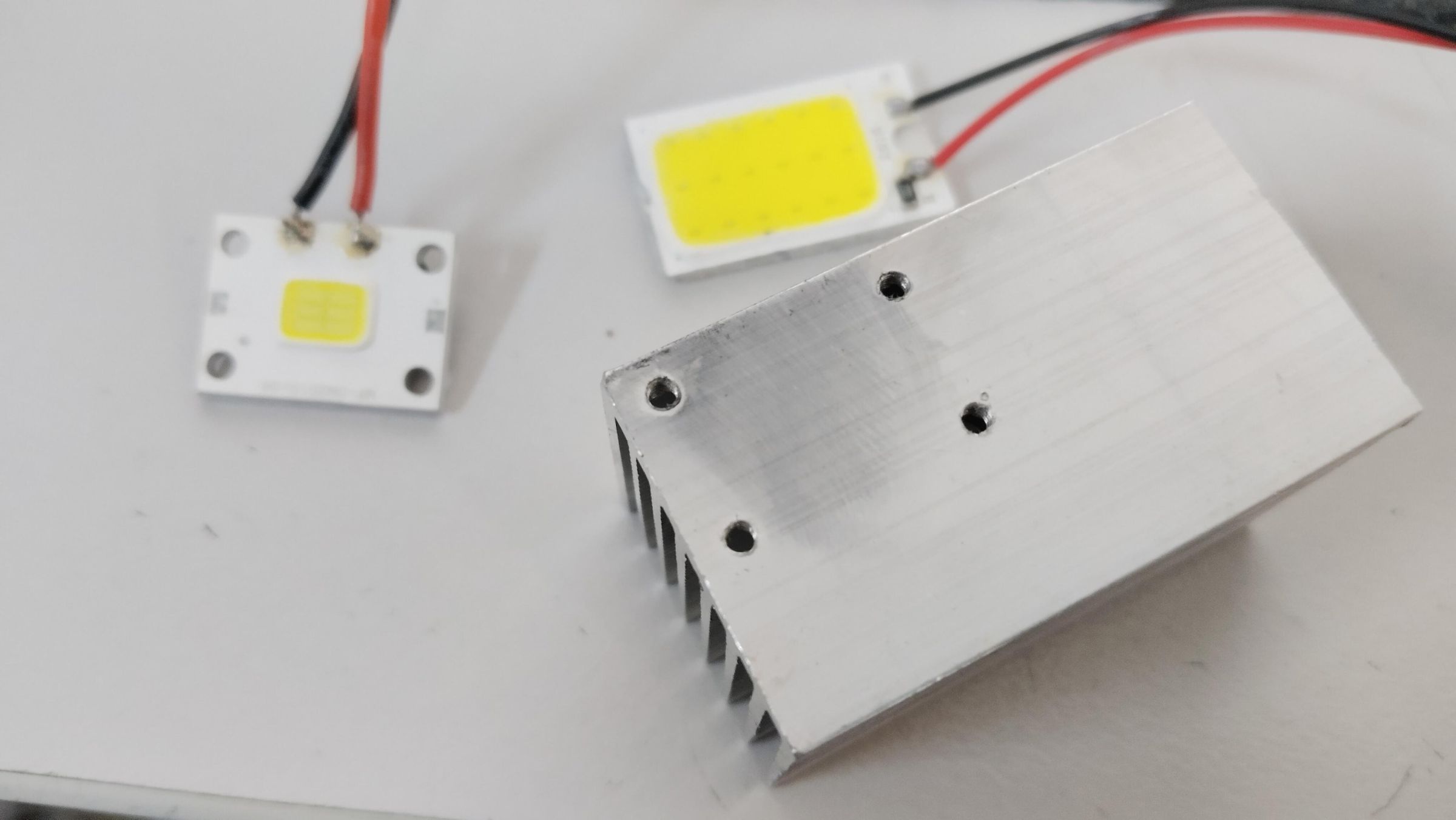

I carefully removed the optical components from the original projector.
The goal was to preserve as much of the original optical hardware as possible instead of replacing everything with new components.
The useful parts included the projection lens and optical elements used to guide and focus the image.

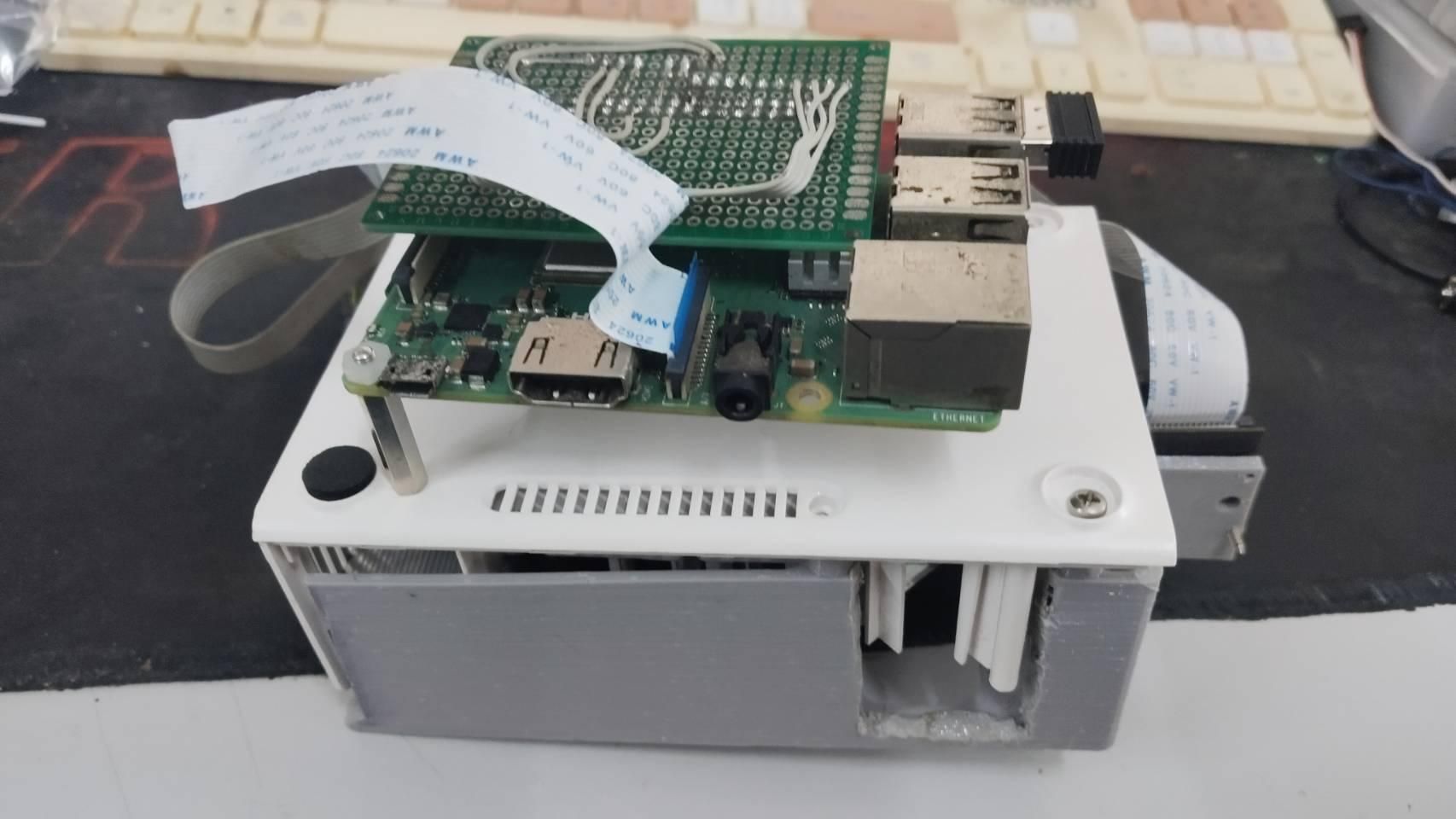

Step 4: BUILDING a NEW CONTROL SYSTEM
Since the original control board was no longer working, I decided to build my own control system.
This allowed me to reuse the working optical and mechanical components without having to purchase another complete projector.
The new system would provide the control and processing needed for the new application.

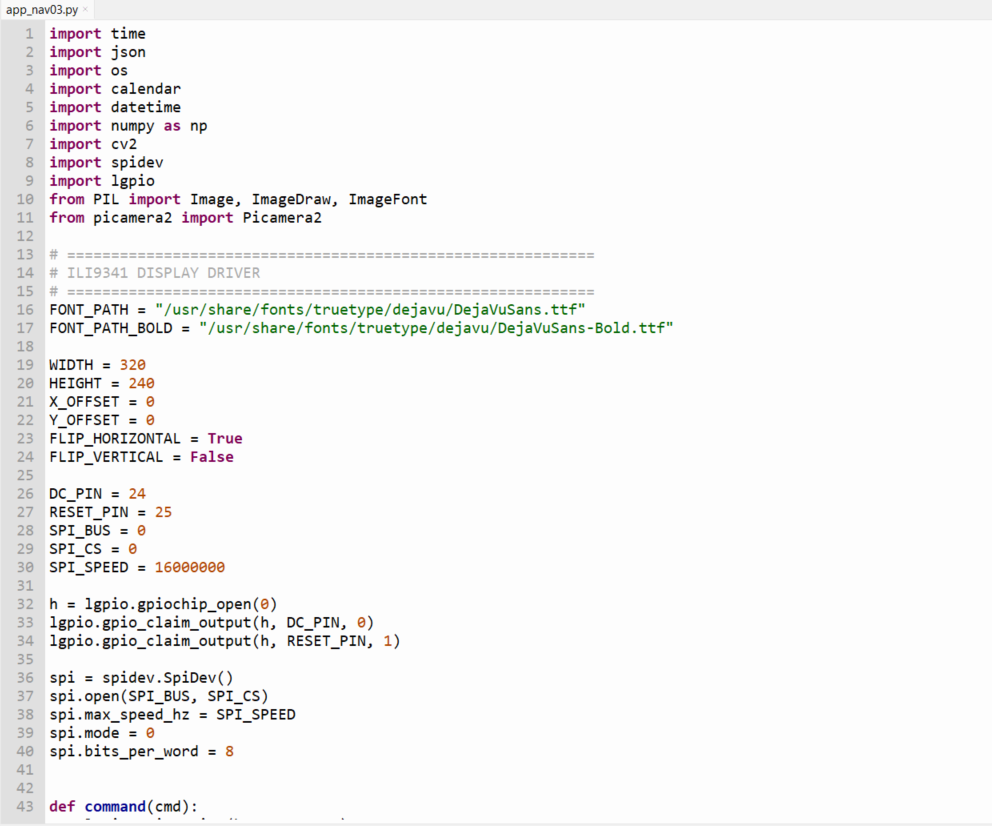

Step 5: ADDING THE ILI9341 DISPLAY
I integrated an ILI9341 TFT display into the modified optical system.
The display provides the graphical content that is processed through the optical system and projected onto the floor.
This allowed me to create a completely new image source while continuing to reuse the original projector optics.
Step 6: ADDING THE RASPBERRY PI 3
A Raspberry Pi 3 is used as the main computer for the project.
It handles the graphical interface, camera input, interaction processing, and communication between the different parts of the system.

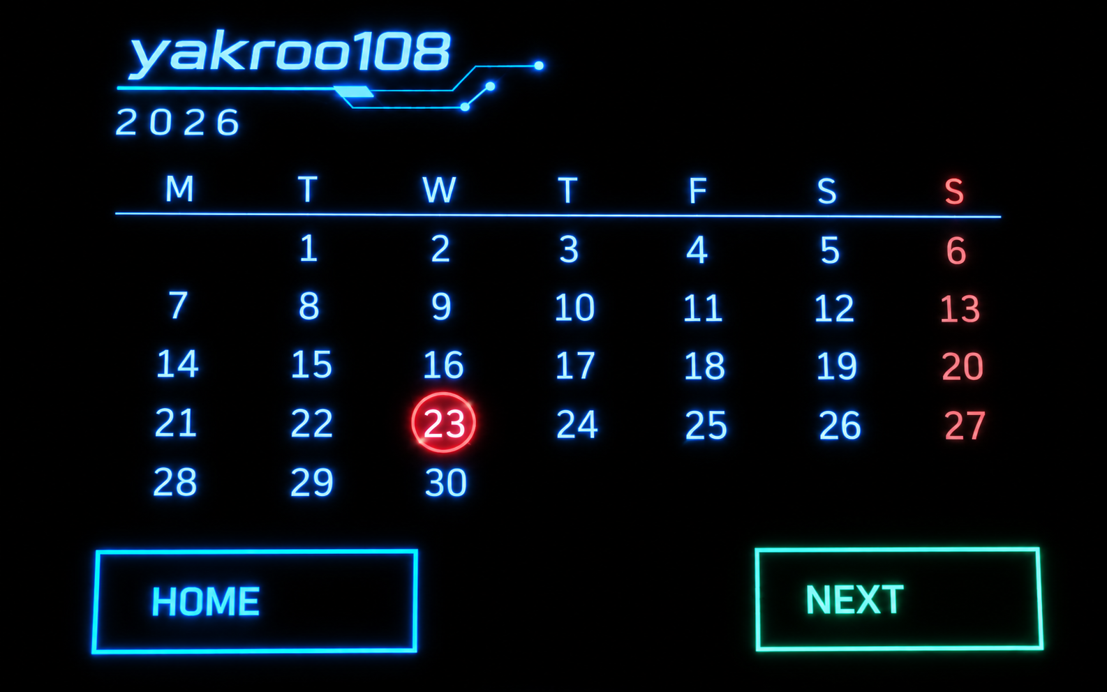

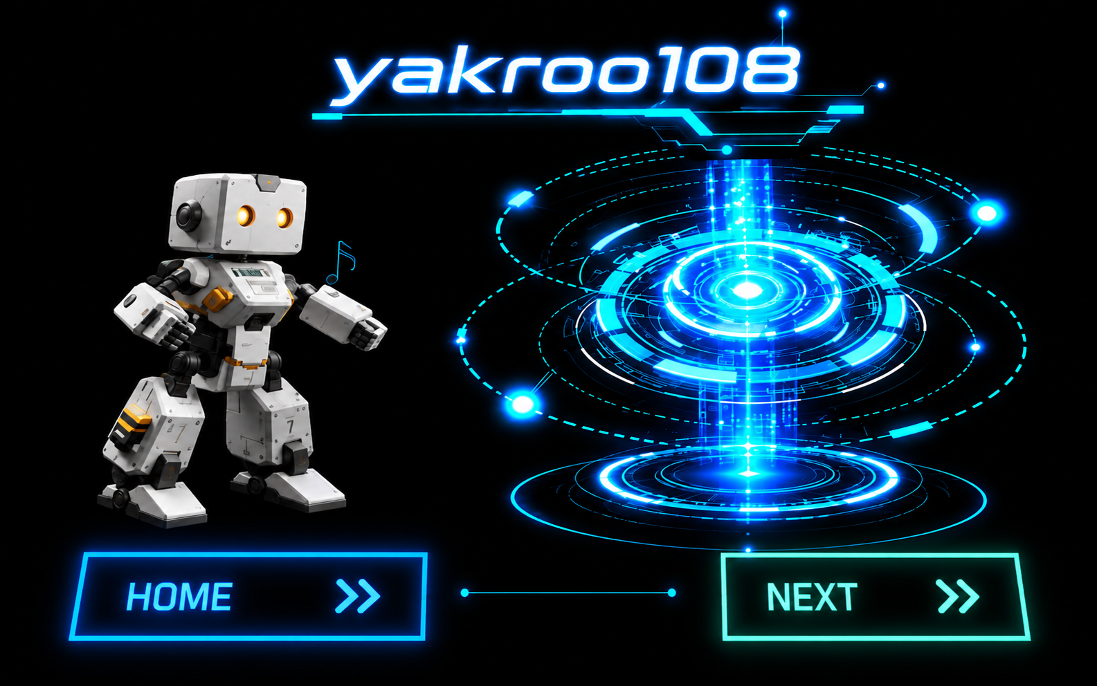

Step 8: DESIGNING THE INTERACTIVE GUI
A GUI Designed for the Floor
The next step was creating a simple graphical interface designed specifically for projection onto the floor.
Large, clearly separated buttons make the interface easier to see and easier for the camera to detect.
Example interface:
  1. Video
  2. Calendar

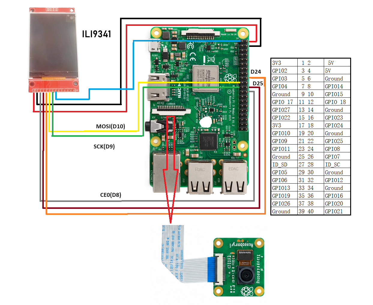

Step 9: Circuit
Circuit
This circuit connects the ILI9341 TFT display to the Raspberry Pi 3 Model B while preserving the original pin configuration used in the project.
The ILI9341 provides the visual output, while the Raspberry Pi 3 handles the display control and processing. The circuit uses the required SPI communication lines, together with the control signals for the display.
The Raspberry Pi Camera is connected separately through the Pi 3's CSI camera interface. It is used as the visual input for the computer-vision interaction system.
The wiring shown in this diagram follows the actual circuit used in AI HoloProject X1.
Key connections:
  1. ILI9341 → Raspberry Pi 3
  2. MOSI (D10)
  3. SCK (D9)
  4. CE0 (D8)
  5. D24
  6. D25
  7. Power and Ground
  8. Raspberry Pi Camera → CSI interface
Step 10: Code
Code
