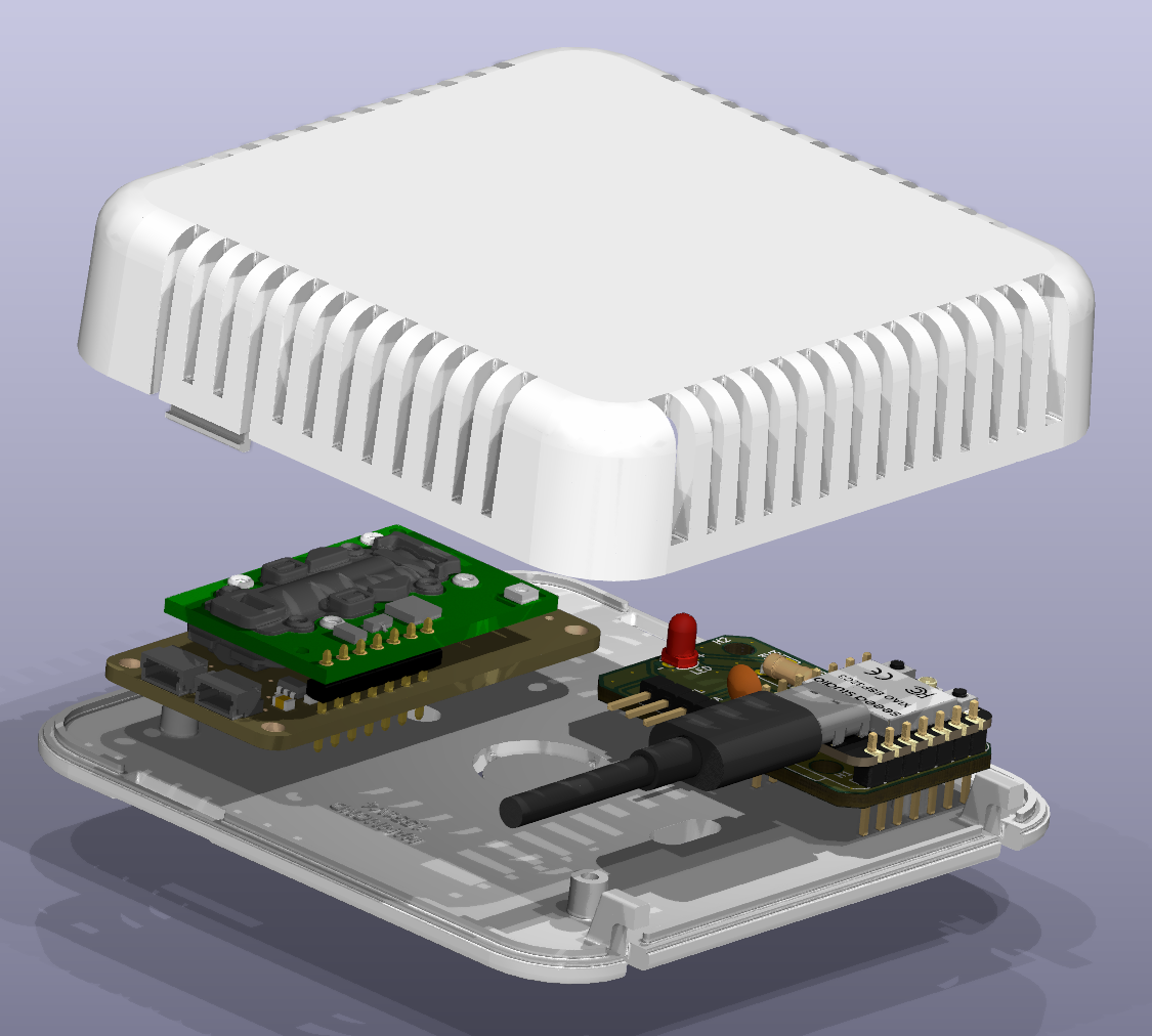

KiCad 3D render of the fit-check model, not a photograph - no node has been built yet. The standoff height is not final, and the model doesn't show how the USB cable leaves the box.

Fit in the enclosure - the open question
The 1551V4 is 15.30 mm deep inside. Both boards sit on standoffs on the enclosure floor.
- The SCD30 is the tight part. On 6 mm standoffs it clears the cover by 0.735 mm nominal. Its height tolerance is ±0.70 mm and the cover's moulded lettering stands 0.20 mm, so the worst case is a clash under the lettering. On 5 mm standoffs the worst case is 1.035 mm, or 0.835 mm under the lettering. The SCD30's standoff height is still open.
- The carrier on 6 mm standoffs leaves 0.95 mm with a XIAO soldered on pin headers. A socketed XIAO doesn't fit, and the screw under the XIAO has to go in first.
- The floor has a 1.0 mm recess at its centre (±7.53 mm). Keep standoffs off it.
Fit-check model with the cover lifted. Render, not a photo.
