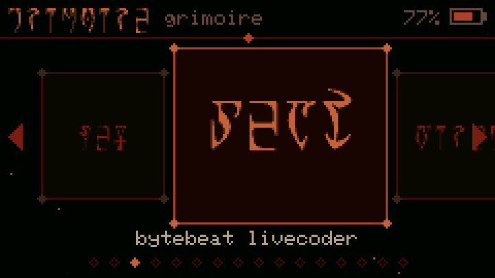

DIVINER is an experimental firmware environment for the M5Stack Cardputer ADV, transforming a pocket computer into an occult cyberdeck with 16 unique applications. Explore generative synthesizers, bytebeat livecoding, ASCII 3D, procedural visuals, Wi-Fi and Bluetooth reconnaissance, LAN discovery, Gemini browsing, and experimental motion sensing. Featuring a custom Daedric interface, animated glyphs, and atmospheric sound design. Open-source C++ firmware with a native desktop simulator.
Rather than treating the Cardputer as another disposable collection of utilities, DIVINER approaches embedded computing as something worth exploring for its own sake. Every application belongs to a shared audiovisual environment, complete with hand-rasterized Daedric typography, responsive sound effects, and an interface that gradually translates itself into readable English. Wireless networks become constellations, Bluetooth devices drift like familiars, and mathematical expressions turn into sound.

02 // THE DISPLAY AND GRAPHICS PIPELINE
The Cardputer ADV provides a display resolution of 240 × 135 pixels.
That is 32,400 pixels.
Not an enormous canvas, especially once text, menus, status information, and interactive elements start fighting for space.
DIVINER deliberately avoids treating this resolution as an excuse to implement a conventional smartphone-style interface at miniature scale.
Instead, the rendering system emphasizes high-contrast typography, minimal ornamentation, procedural geometry, and controlled animation.
The visual design is based around a limited blood-and-ember palette, with dark backgrounds and bright details used to establish hierarchy.
Rather than storing every visual as a bitmap, several applications generate their imagery mathematically.
This includes:
  • Rotating wireframe geometry
  • ASCII-based three-dimensional objects
  • Plasma effects
  • Animated glyph fields
  • Kaleidoscopic patterns
  • Tunnel and perspective effects
Procedural graphics are particularly appropriate for constrained embedded hardware because they allow visual variety without requiring large collections of stored image assets.
The challenge moves from image storage to computation and rendering efficiency.
The Daedric Typography System
One of DIVINER's central visual features is a custom rasterized Daedric font.
The glyph system is integrated into the interface rather than used exclusively for decoration.
