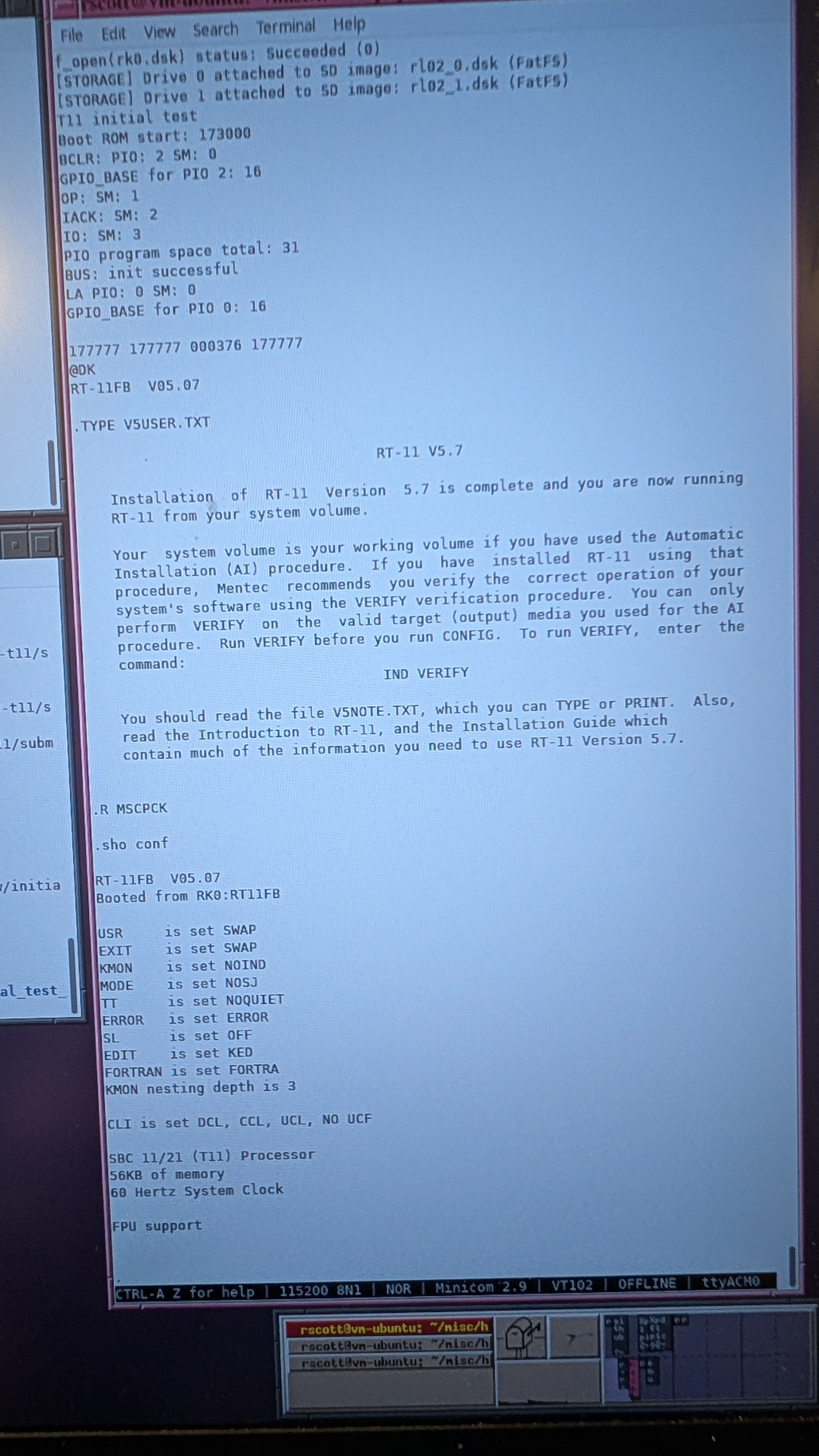

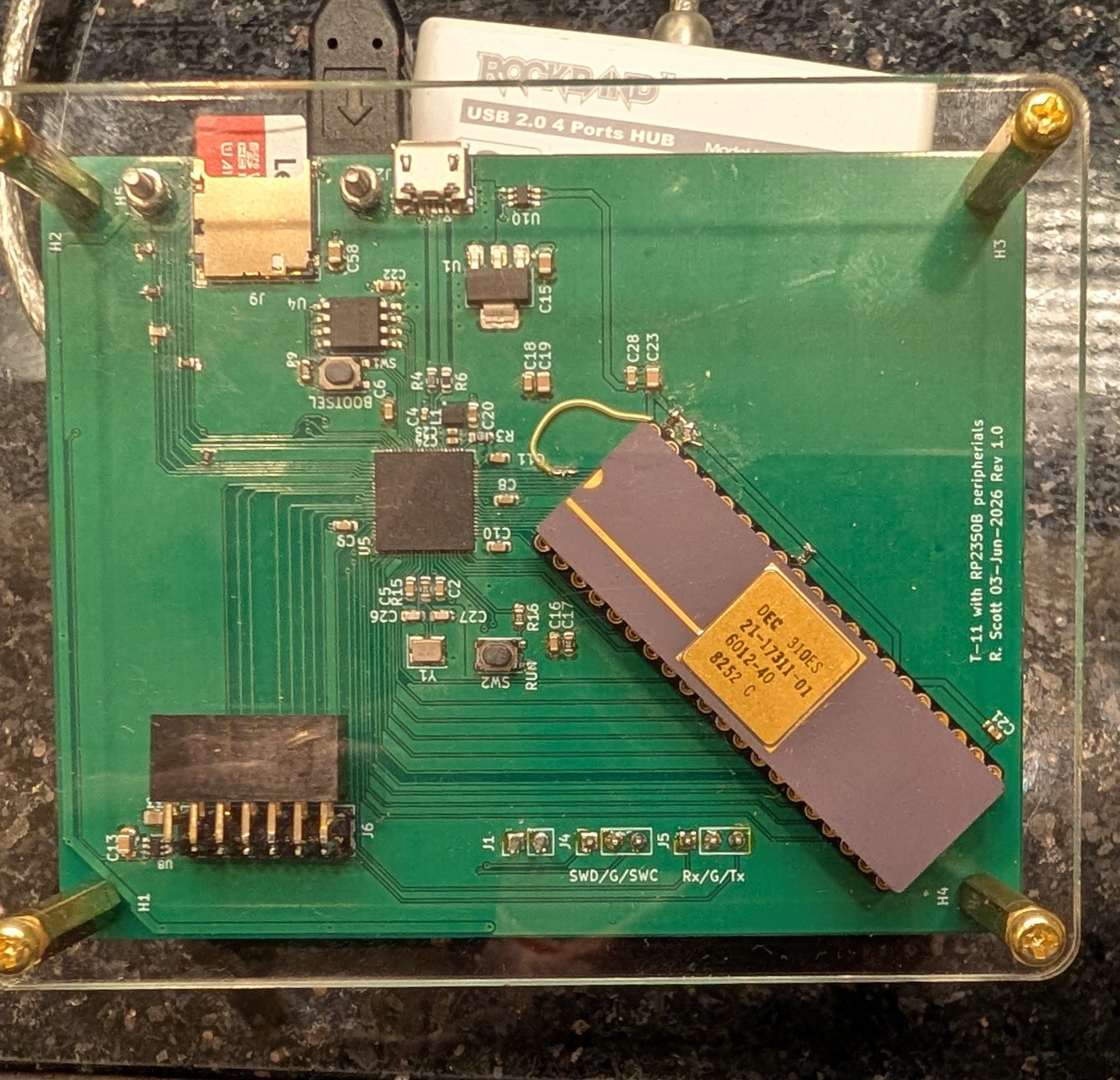

T-11 with RP2350 as memory and peripherials Gallery
