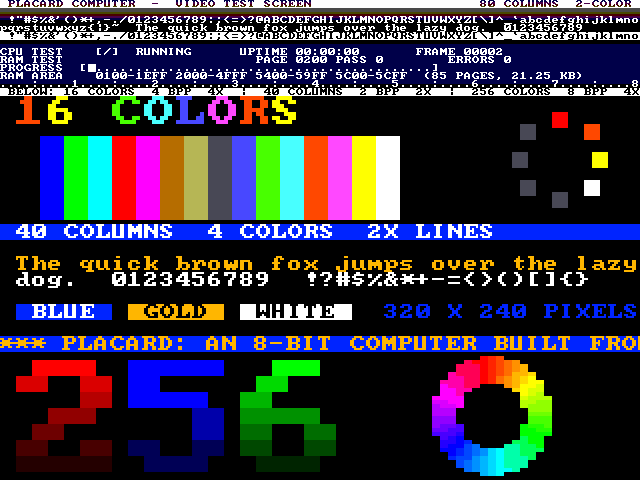

Video
- 640x480 VGA at 60 Hz, generated by H counter, V counter and sync PLDs.
- Uses RAM as raster memory (x6020-xFFFF)
- Video runs automatically - stalls CPU when it needs to read from RAM
- Colors modes are adjustable per line:
- 640 monochrome pixels or
- 320 4-color pixels or
- 160 16-color pixels or
- 80 256-color pixels
- RAM can be conserved by select lines to repeat
- 1x mode reads every line
- 2x mode skips every other line (half of required RAM)
- 4x mode skips 3 lines at a time (quarter of required RAM)
- Modes mix freely down the screen: 80-column text above a 256-color picture, for example.
- Each row can be tinted with another 8 colors
- Gives colored text backgrounds and raster bars for free.
- Provide some background color in monochrome mode
- Provide color gradients in other color modes
- Each RAM byte is processed by the Color Decoder PLD which turns it into RGB with a resistor DAC.

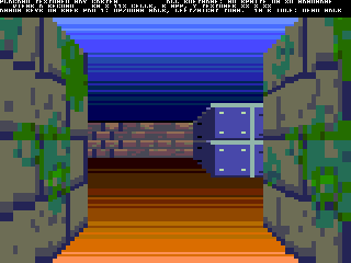

- Wolfenstein-style textured ray caster at 60 frames per second with no sprite hardware

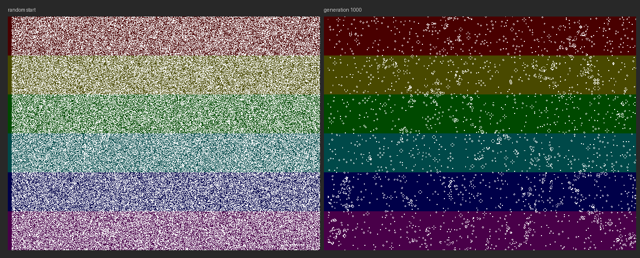

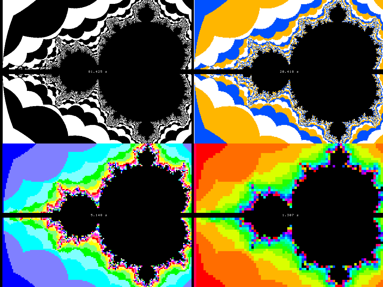

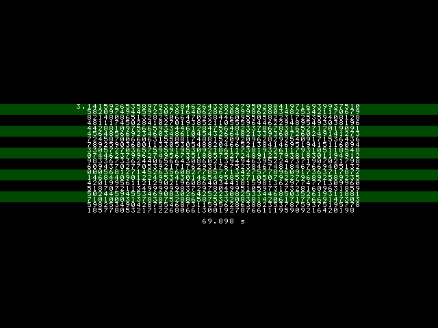

- Mandelbrot, pi digits and the Game of Life for benchmarking
