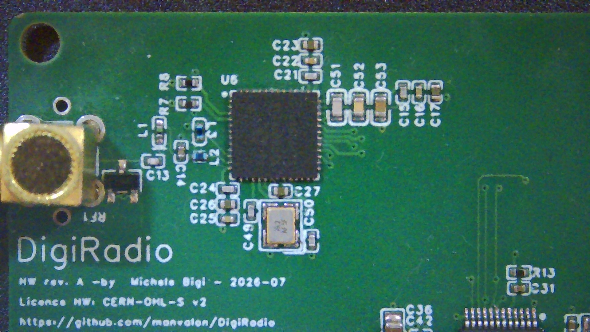

- Si4684 (Silicon Labs) DAB+/DAB/FM tuner, antenna on SMA

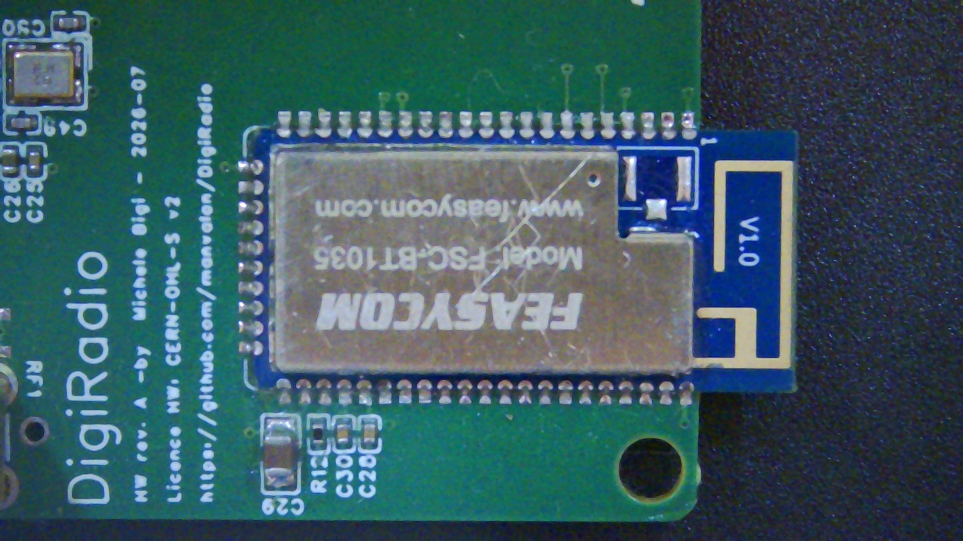

- Feasycom FSC-BT1035 (Qualcomm QCC3056): Bluetooth 5.2 with aptX, aptX HD and aptX Adaptive

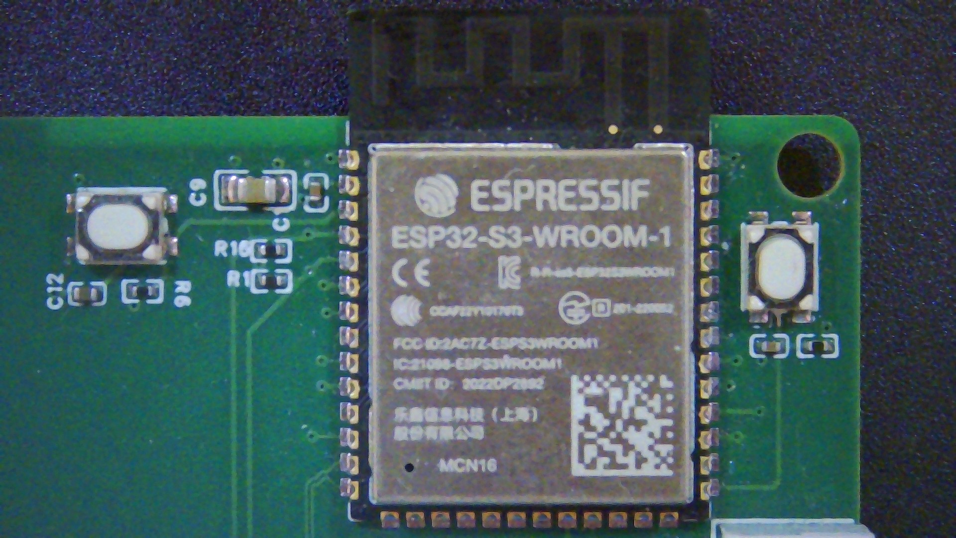

- ESP32-S3: host controller with Wi-Fi and BLE. It boots the other chips, runs a REST API, streams web radio into the DSP and handles OTA updates with automatic rollback
FM/DAB antenna → Si4684 → I²S → ADAU1701 → I²S → BT1035 → aptX

- 6 layers, impedance-controlled, 50 × 90 mm, two solid ground planes under the RF, crystals and USB
- Three antenna zones: the ESP32 and BT1035 2.4 GHz antennas on opposite corners, FM/DAB on SMA, with keep-outs on every layer

The board was fabricated and assembled by PCBWay, who sponsored part of the cost ($100). With a QFN tuner, an LQFP DSP, two 2.4 GHz modules and a USB-C connector on a 6-layer stack-up, hand assembly wasn't realistic. The lead times were the normal technical ones for this kind of job. The only part they don't stock is the FSC-BT1035, which I soldered by hand.
What helped me most was their support. During bring-up I couldn't get the Si4684 tuner to work, and on a board like this it's hard to tell whether the problem is hardware or firmware. PCBWay's support team helped me check the board and the assembly, which let me rule out hardware problems and find the real cause.
