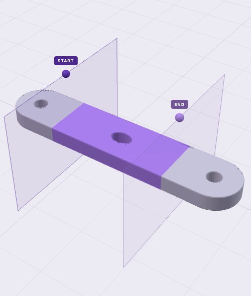

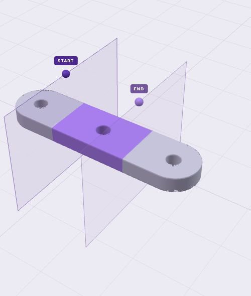

The Files section includes a bracket before and after the edit. In this example the direction is X, Start is 30 mm, End is 70 mm, and the change is +20 mm with the start side fixed.
The selected section goes from 40 mm to 60 mm. The full part goes from about 101.20 mm to 121.20 mm long. The middle hole stretches. The two end holes and the ends keep their shape and size.
Before: 40 mm sectionAfter: 60 mm section (+20 mm)
Before stretching: circular middle holeAfter stretching: longer middle section and stretched middle hole
