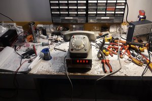

Displays consist of small OLED display, three different colours LEDs and a buzzer. A module ESP8266 is included as well.
Raspberry Pi collects information and monitors events at your home and compares them to your pre-set limits and priorities. Subsequently the device sends an information to multiple parallel displays. The particular event can switch a LED or a buzzer on. If there are no incidents at your home, the wheather or a time information can be displayed (according to your preferences).
