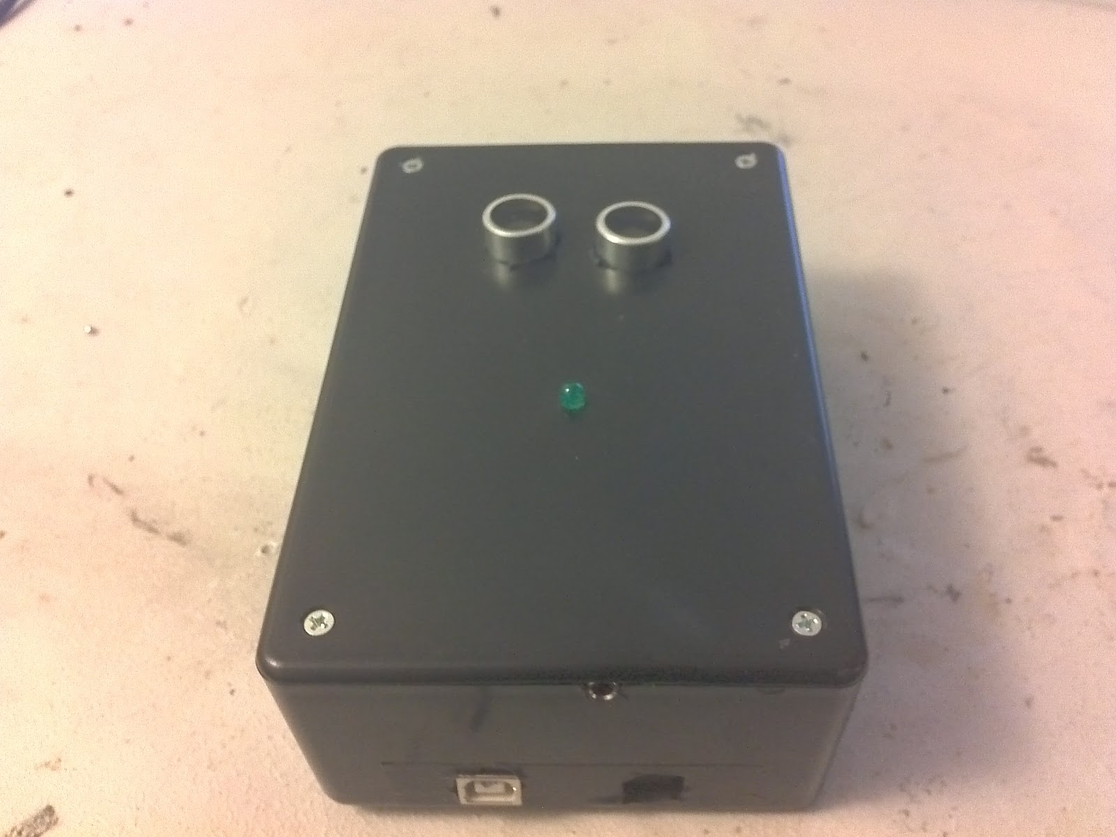

Assembled:

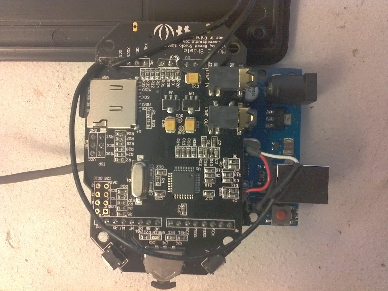

| Parts Used |

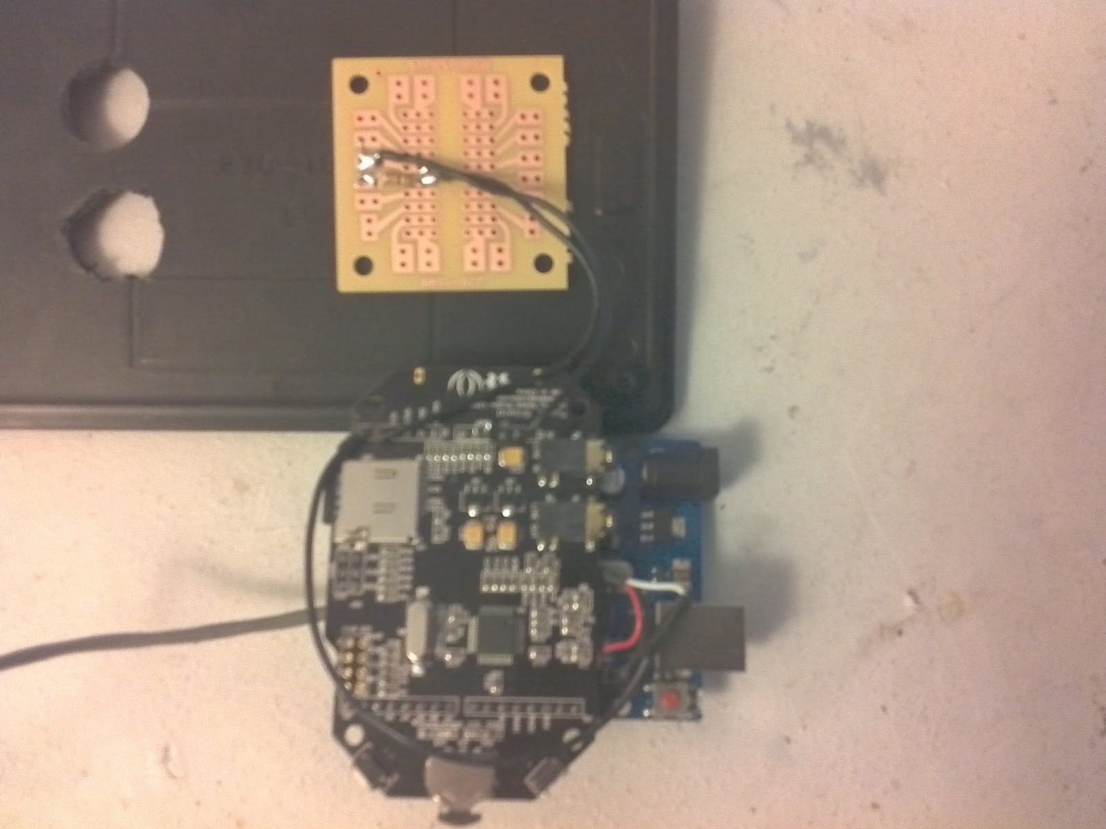

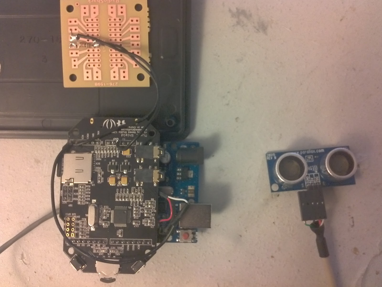

| The music shield only leaves two analog pins available (A4 & A5). I used one for the LED and one for the ultrasonic |
| Also had to hijack some pins on the ICSP for USB header (for 5v and ground) |

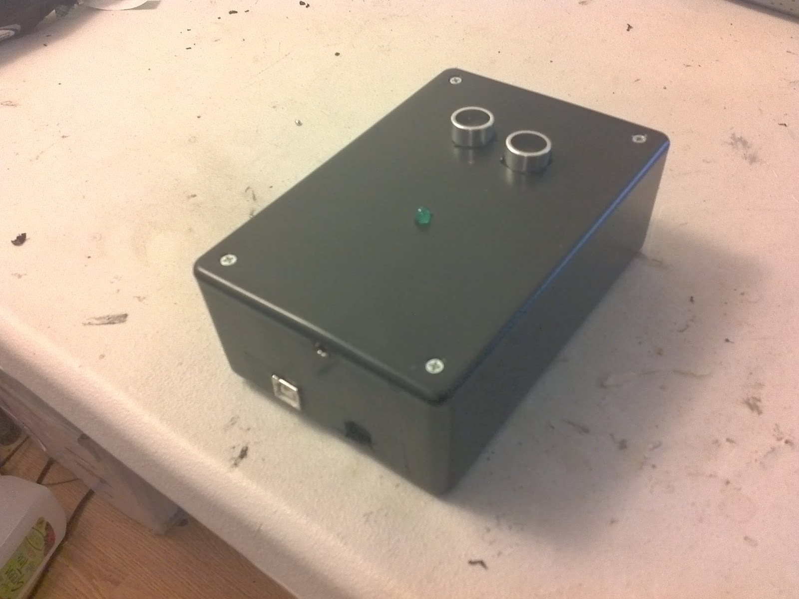

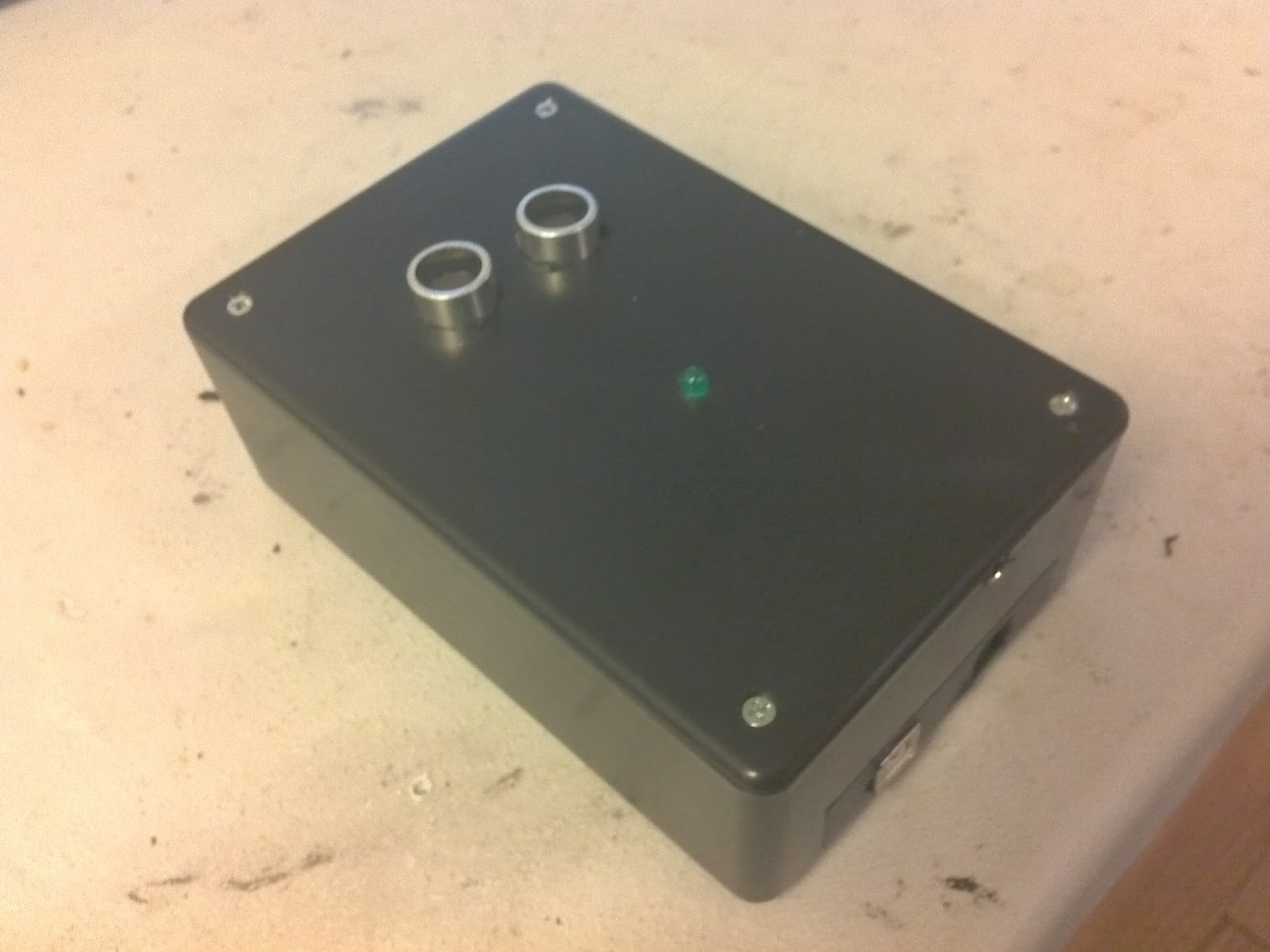

| A resistor and an LED indicate when the music is paused (OFF), at maximum volume (ON), or in vol+/- (DIM) |
